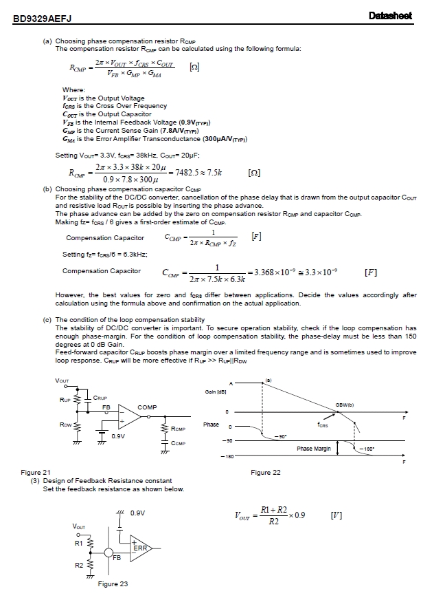

      The voltages measured don't mean much if we don't know what the pin out name is.
        Re: Vizio E320i-A2: Power on, on-screen logo, nothing else
        Page 11 of the spec sheet tells you how to calculate what the output Voltage will be based on the known values of the two resistors connected to the FB pin 5 then you can tell if the circuit is putting out the correct Voltage or not.
          It looks like he is referring to the two buck converter ICs BD9329.
              Ah perfect-- I will look at this and report back.

                I ended up ordering a replacement board off of eBay as the output voltage checked out using the datasheet from the BD9329. The new board fixed the issue of course, so I'm assuming it was most likely corrupt memory.
                Kind of a bummer for me I wasn't able to locate a specific fault (this was a learning project after all), but I'm certainly not going to complain about a working TV. I'm sure there will be many more
