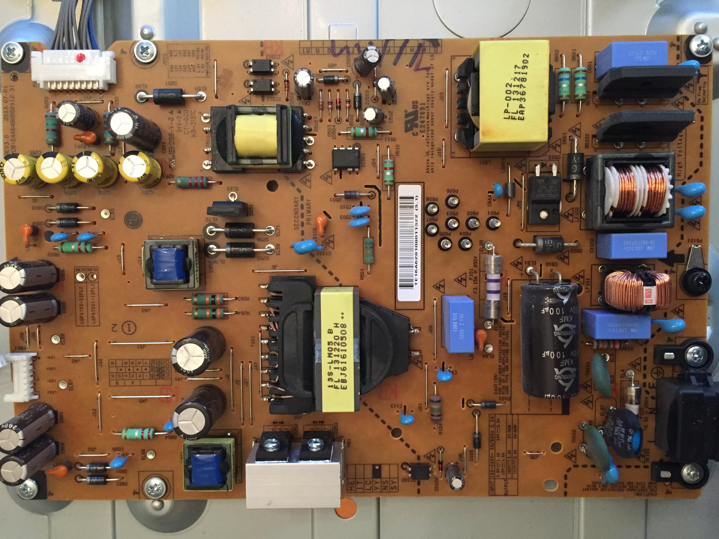

    Greetings!
    I seem to have the "rare" (LOL) issue of the LED backlight being out also. TV powers on, Audio there, flashes quick and no pic. I can see it somewhat if i look on an angle and use a flashlight.
    I removed the back cover and disconnected the connector from the Power/LED power PCB to the LED strips and I still read NO DC voltage at the 2 outputs of that connector.
    Should I replace the Power/LED PCB or could it still be a LED strip?
    THX
    Steve

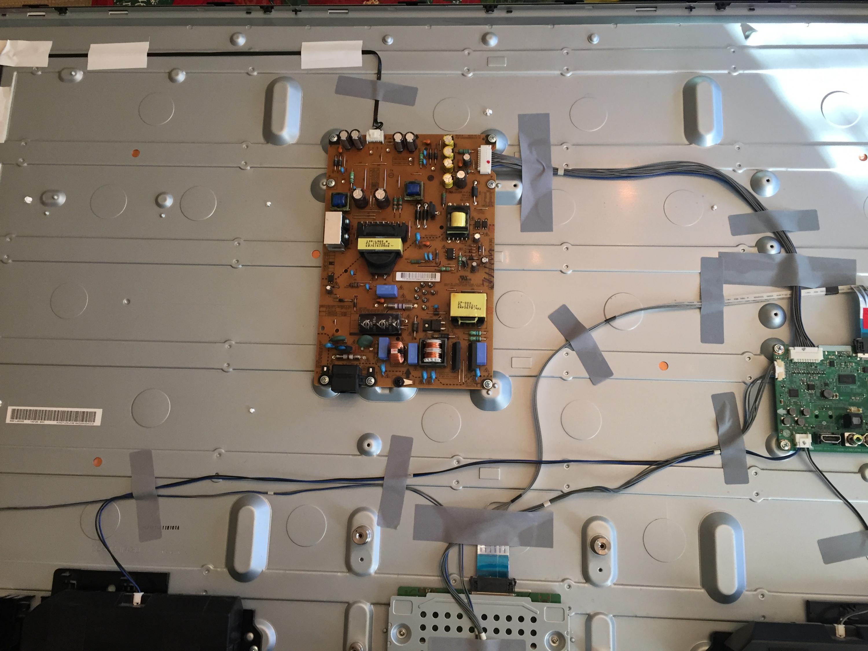

    Posting pictures of the back of your tv showing the boards with clear pictures may help you more with fixing your problem

                      The ground on the Led goes through a return line so best to use chassis ground and we needed to know. Now you need to get us a close image of the Psu.
                        Re: LG50LN5400 Backlight Issue

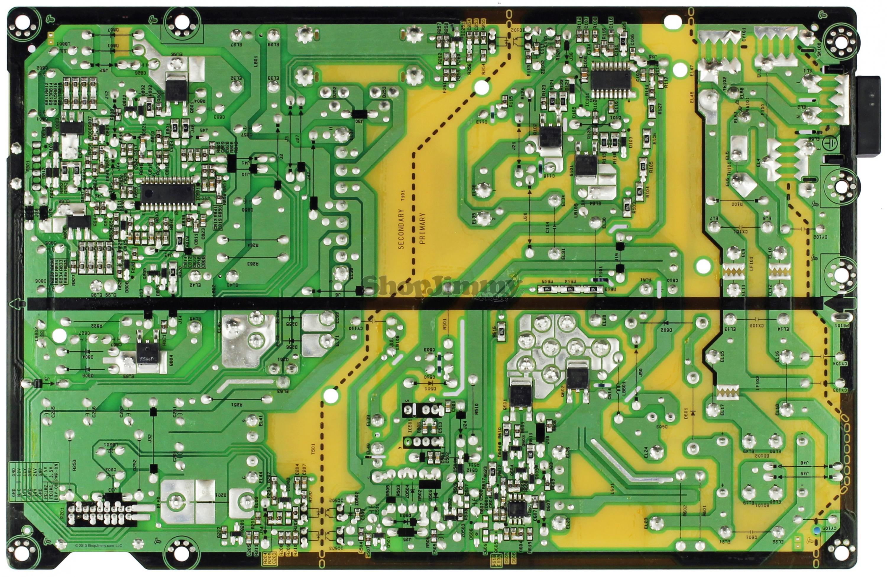

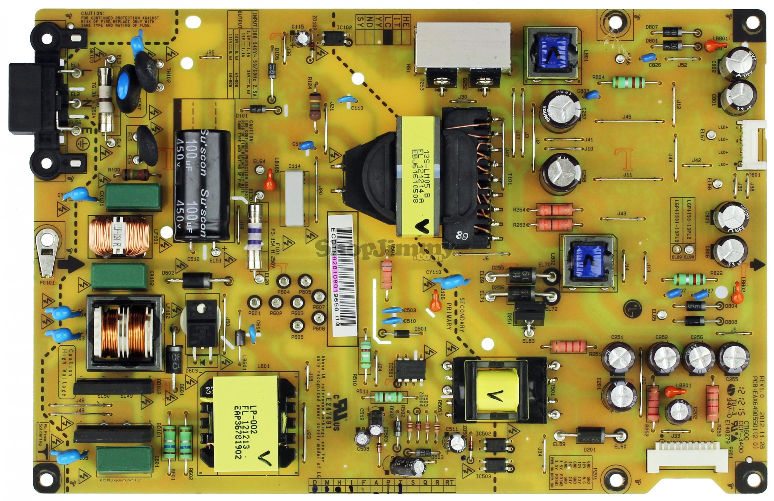

                        Closed up pictures of the power supply-LED driver board? I cannot read the P/N on the barcode sticker and on the board? LG EAY62810801 (EAX64905501(2.0)) Power Supply / LED Board?
                        How about the readings on all 4 pins of the LED connector?
                        Are these boards used in your TV?
                        http://www.shopjimmy.com/lg/50ln5400-ua
                                LG EAY62810801
                                http://www.shopjimmy.com/lg-eay62810...pply-unit.htm#
                                Pictures provided by shopjimmy.
