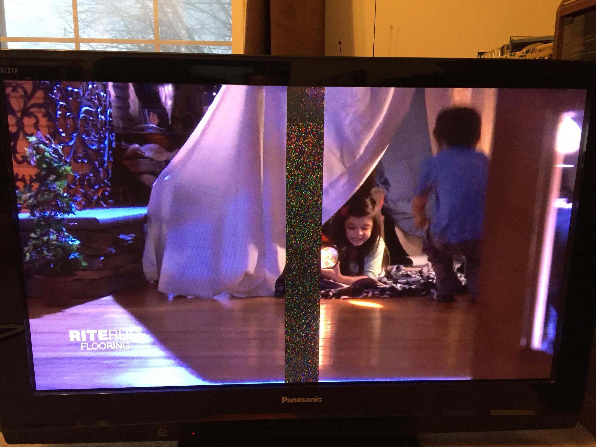

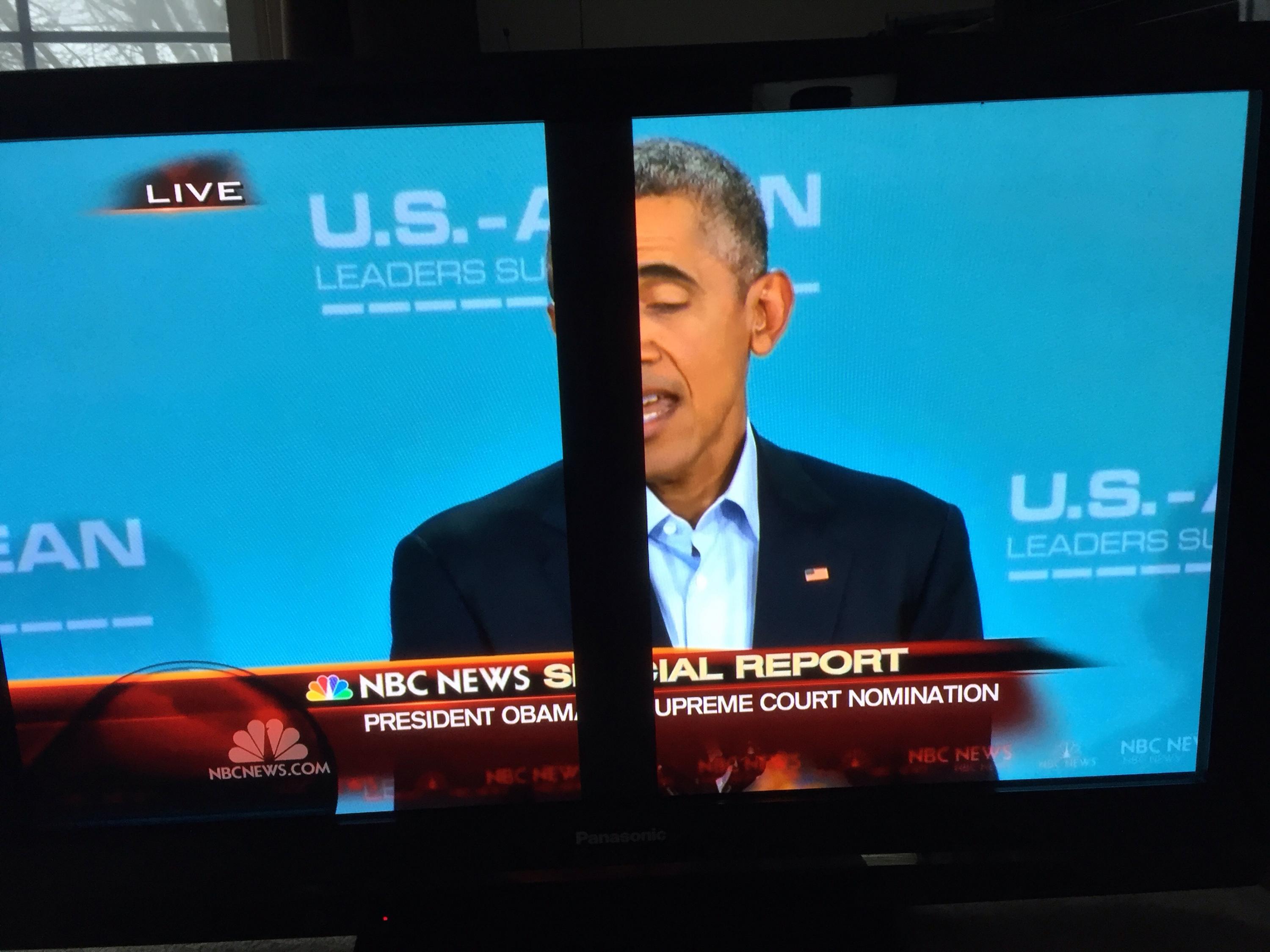

I have this TV that just developed this black bar today.
Panasonic th-42pz80u black vertical bar.
Re: Panasonic th-42pz80u black vertical bar.
Ohh dear, as its fully black I would say the panel ribbon cable going to that part of the screen has come lose if reseating it does not work the panel has failed but doubt that as these are quite reliable.
Take the back off and reseat the address driver going to that section of the screen its on the bottom of the screen.Please Do Not PM My Page Asking For Help Badcaps Is The Place For Advise, Page Linked For Business Reasons Only. Anyone Doing So Will Be Banned Instantly !
https://www.facebook.com/Telford-Tel...7894576335359/ -
Clean the contacts with ipa and reseat it a few more times they are hard to get in perfectly.Please Do Not PM My Page Asking For Help Badcaps Is The Place For Advise, Page Linked For Business Reasons Only. Anyone Doing So Will Be Banned Instantly !
https://www.facebook.com/Telford-Tel...7894576335359/Comment
Bad Panel, you could try and swap the lower C buffer board but that looks like the address IC in the ribbon cable has failed due to heat.
I have had a couple of these and while they are a decent panel they are known for this sort of failure.Comment
Not worth a new buffer bad panel then a shame too
On last thing do the pins of the ribbon cable look corroded at all ?Please Do Not PM My Page Asking For Help Badcaps Is The Place For Advise, Page Linked For Business Reasons Only. Anyone Doing So Will Be Banned Instantly !
No, really clean. I just bought a new mainboard for it in January as I followed the trouble shooting in the service manual for the blinking led.
I narrowed it down to the a board. It ran for a month now this.
I'll list the parts on eBay, hopefully I can recoup what I spent on the board and new fans for it.
Thanks for the help.Comment
