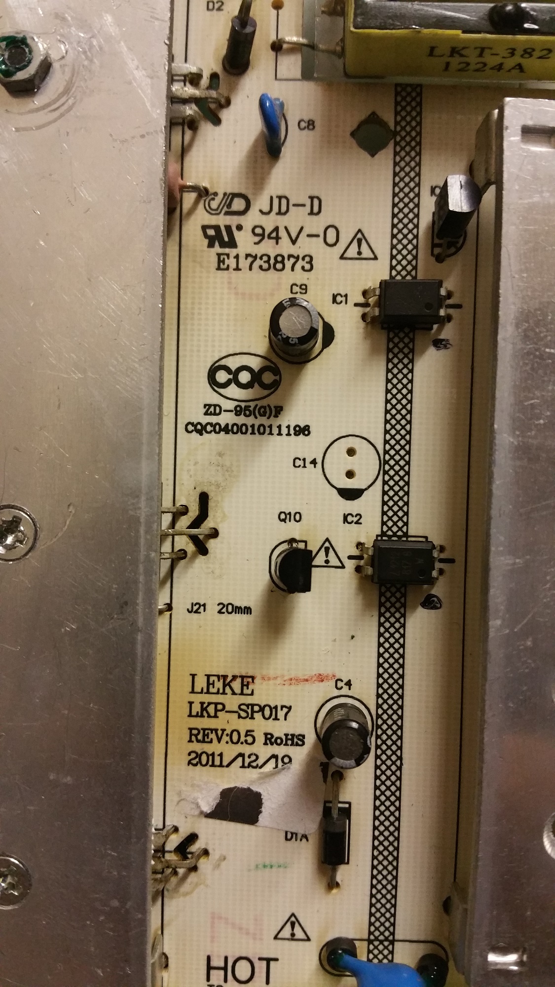

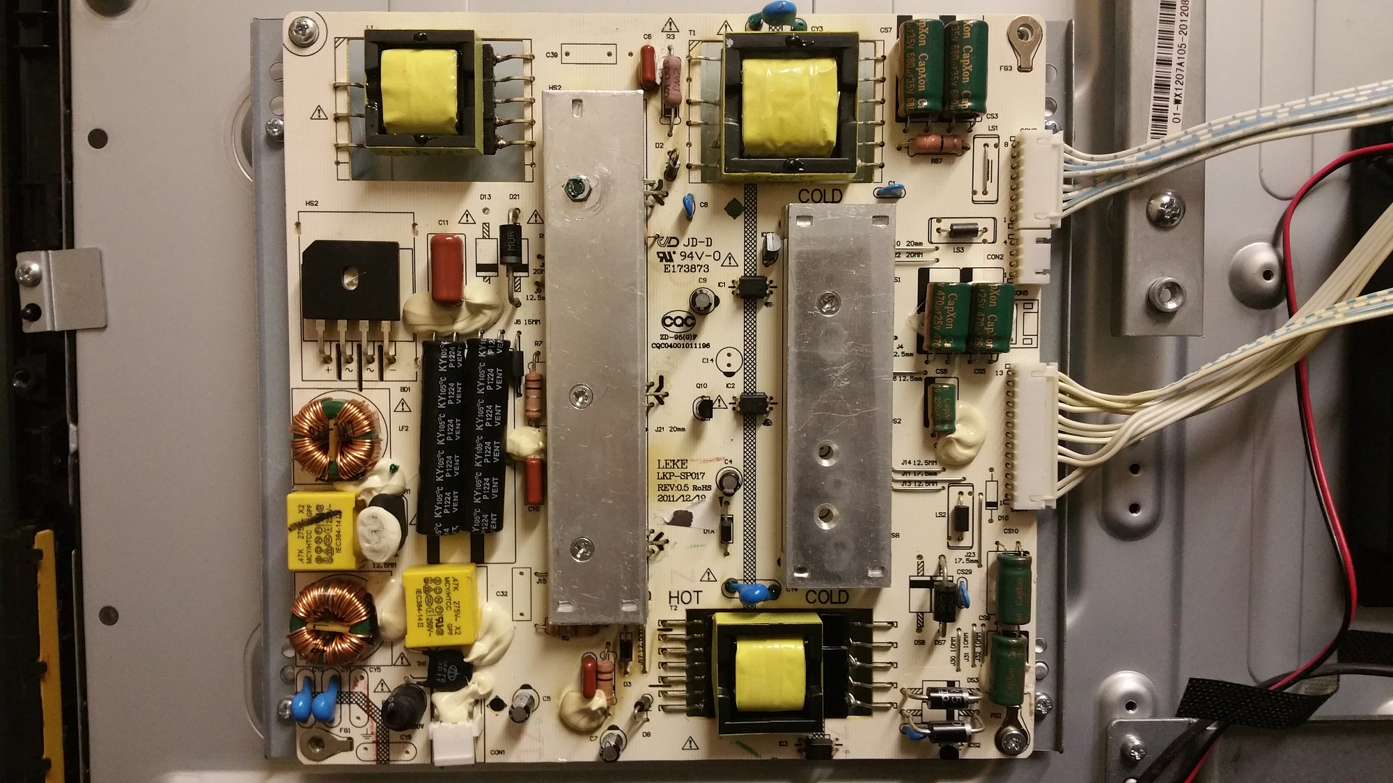

    hi Guys. i have this tv here with power board LEKE LKP-SP017 REV:0.5 and i can't find schematics at all.
    Tv switch on and working fine but no backlight.
    No +24V on power board for inverter.
    I have switched on TV, disconnected +24v cables from power board and used external power supply with 24V for inverter and all working fine.
    Thanks very much.
    Re: Schematics & Help Needed. No Backlight Voltage
    Make and model of the TV?
    What control signals (PS-ON, BL-ON, etc.) do you have feeding the power supply board?
    We also need to see the whole back side of the TV to see how all the boards are connected together.
