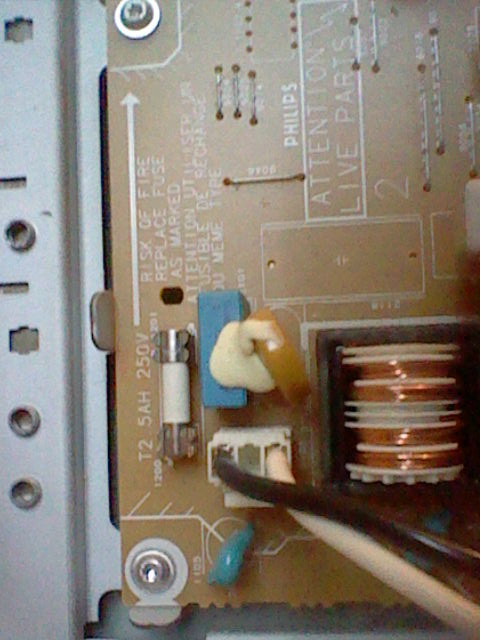

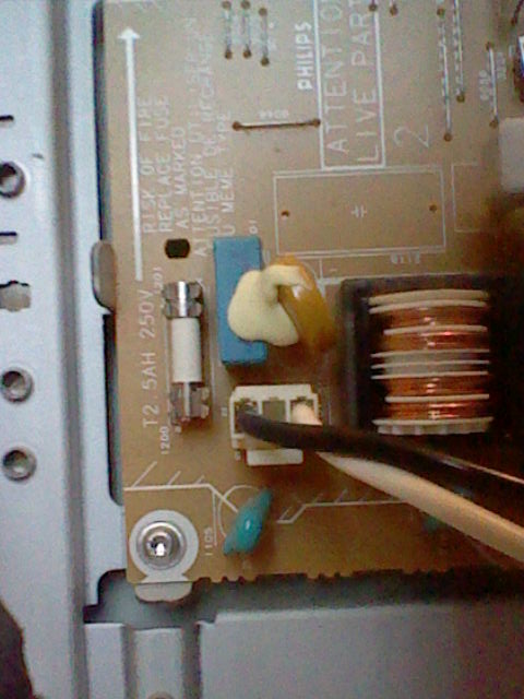

    i had it on the wrong setting so its at 246.2 v at the mains so is that about right for UK ?
    Where do i start testing from here ? a little basic guide for what components are important to test first on the board would be great , Thanks in advance

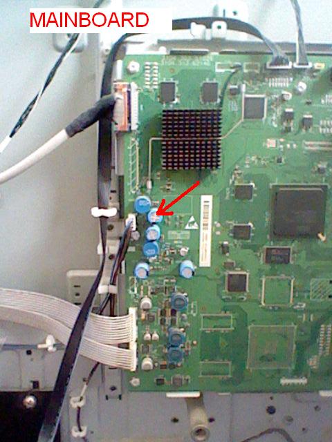

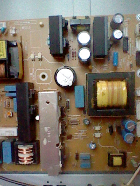

      OK , First sorry for all the double posts i should of taken my time and just posted once.

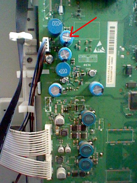

      So, I have inspected every cap on the power supply and all of them have current running through them .
      I inspected all the caps on the main board and all of them are them have current running through apart from one which shows 0 M OHMS.
      I have pointed out in the included pictures which capacitor is displaying 0 value at all.
      Have i possibly found a failed cap , as im very new to this and still learning .
      I am aware that i need to be finding continuity through the board but i need to read up on what im testing and what the values (readings ) should be .
      As advised earlier in the thread i have the .pdf of the service manual but i dont know what im looking at .Can someone point me out what i should be looking for as now i am eager to learn more

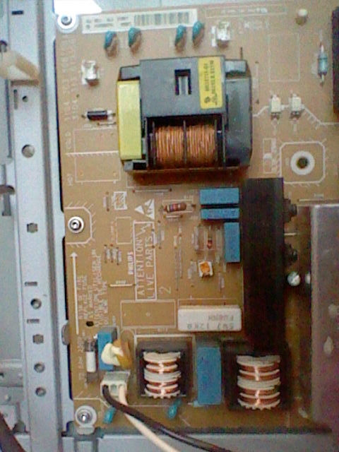

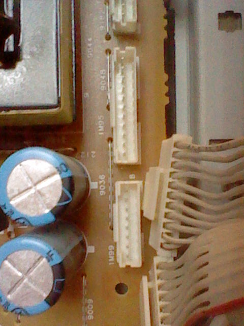

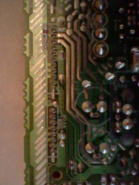

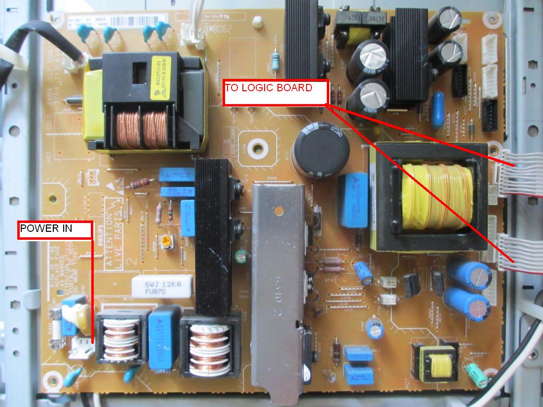

                I have included some more pictures of the connectors and board. The first picture is one i found on google images at a better quality resolution as my camera is poor.
                ive noted where the AC power connects to the PSU and where the cables leave the PSU and go to the logic board .
                Thanks again
                  Re: PHILIPS (42PFL7623D/10) 2 BLINKING RED LED's
                  Look at the bottom side of the board to see if there are any labels for the connectors pins as Vince suggested.

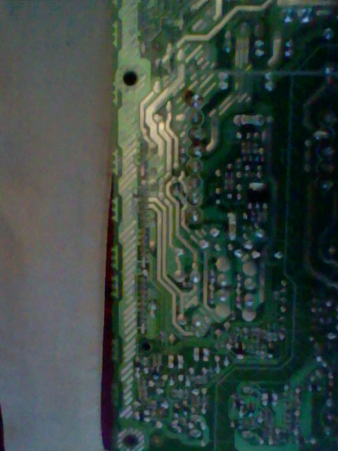

                      Well hopefully there will be something on the bottom side otherwise I will have to trace board using his pictures of the bottom side of the board.

                        I know what you mean on the not much info on the 2 blinks , Ive searched for ages but there is only a handful of threads i can find that seem to have the same problem .
                        I have taken a picture of the underside of the board as you mentioned but unfortunately no markings or anything .
                        Cheers

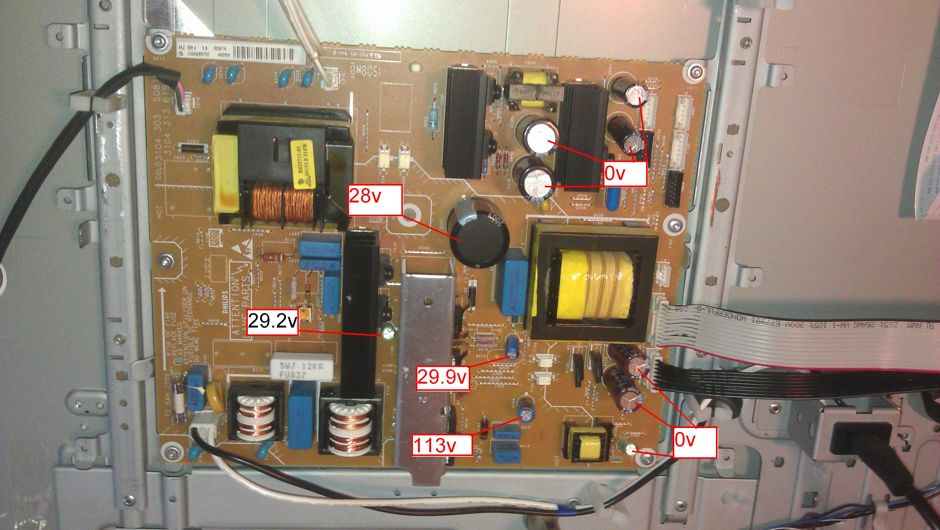

                                  Ive been testing the caps on the PSU and the results i have marked on the following picture .
                                  Does this seem abnormal readings ?
                                  Thanks alot in advance in the meantime im going to take the readings of the caps on the mainboard.
                                  PS. Quick question. Am i reading the voltages correctly as i am using the black probe on the chassis and the red on the top of the cap. Is this correct way of measuring or should i be measuring between the + and - legs?
                                  The thing is its kind of hard to get the probe under there , Thanks again
                                    Hey Rigby. You definitely do not measure anything on "top" of the cap.
                                    Even though we don't know the pin designations yet, it may be best to measure each pin and post the results.
                                    Starting from the top of the 11 wire connector, measure every wire one-by-one. Hold the black probe on the chassis and push the red probe down into where the wire enters the plug. Push it in there good enough that you know you are touching the metal not too hard.
                                    Do the same for the 8 wire connector. Then post the results like this:
                                    1 - 0v
                                    2 - 0v
                                    3 - 5.2v
                                    etc...

                                      So this is the 11 pin Connector first , strange
                                      +7.5v raising to around +7.8v
                                      +7.2v raising to around +7.8v
                                      0v
                                      0v
                                      0v
                                      0v
                                      0v
                                      0v
                                      0v
                                      0v
                                      0v
                                      And the 8 pin connector nothing
                                      0v
                                      0v
                                      0v
                                      0v
                                      0v
                                      0v
                                      0v
                                      0v
                                      Think we might be getting somewhere now , The transformer thing right close to the connections is buzzing quite a bit i have noticed as well . Thanks again
                                        #39
                                        So does this seem to indicate the psu is faulty as its not supplying voltages correctly to the connector that goes to the logic board?
                                        obviously i am new to this but it seems to me some components have shorted/failed in the circuit from AC power in to the output socket that goes to the main board.
                                        Im thinking of replacing the psu completely if this seems to be the board that has failed .
