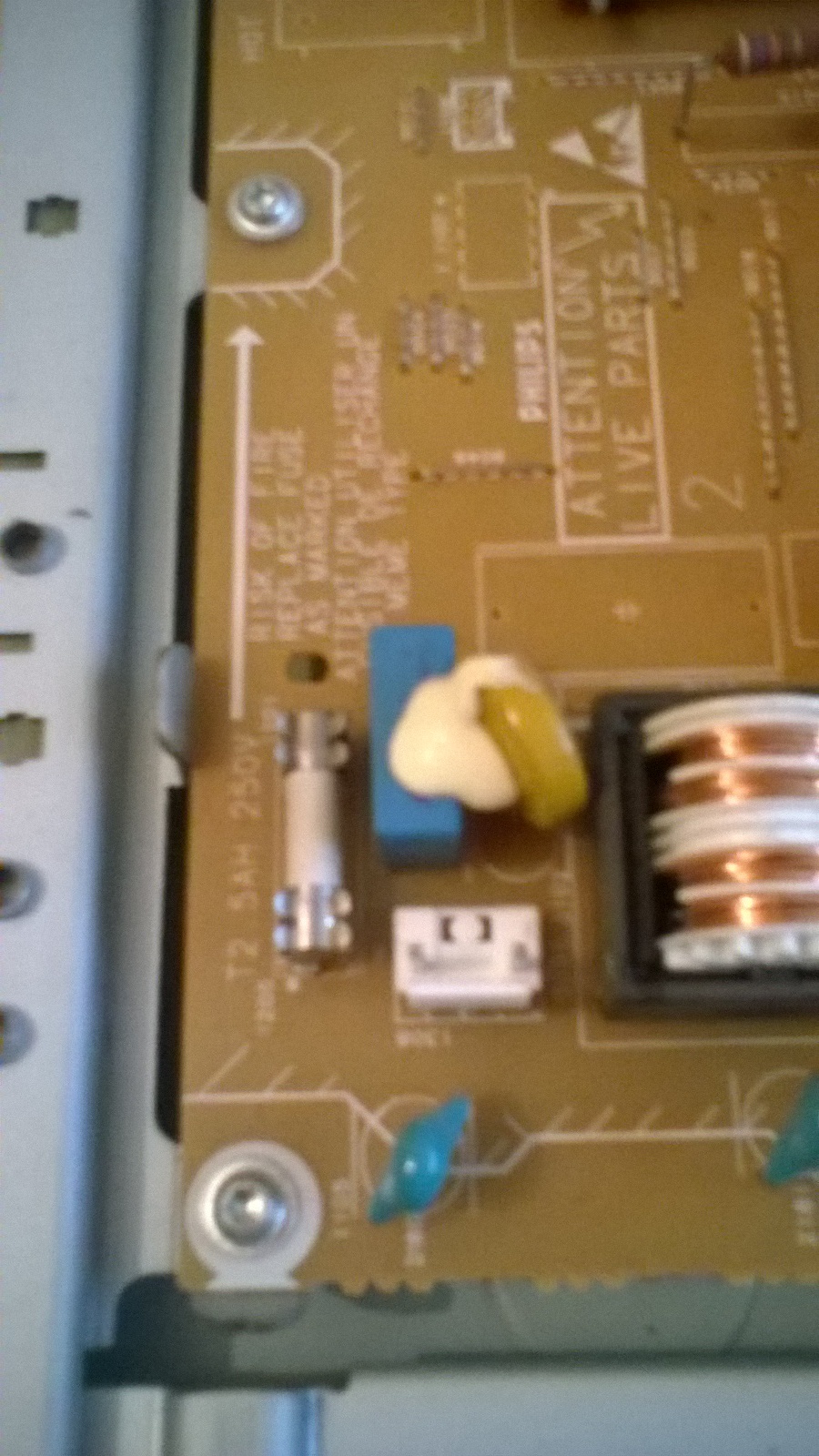

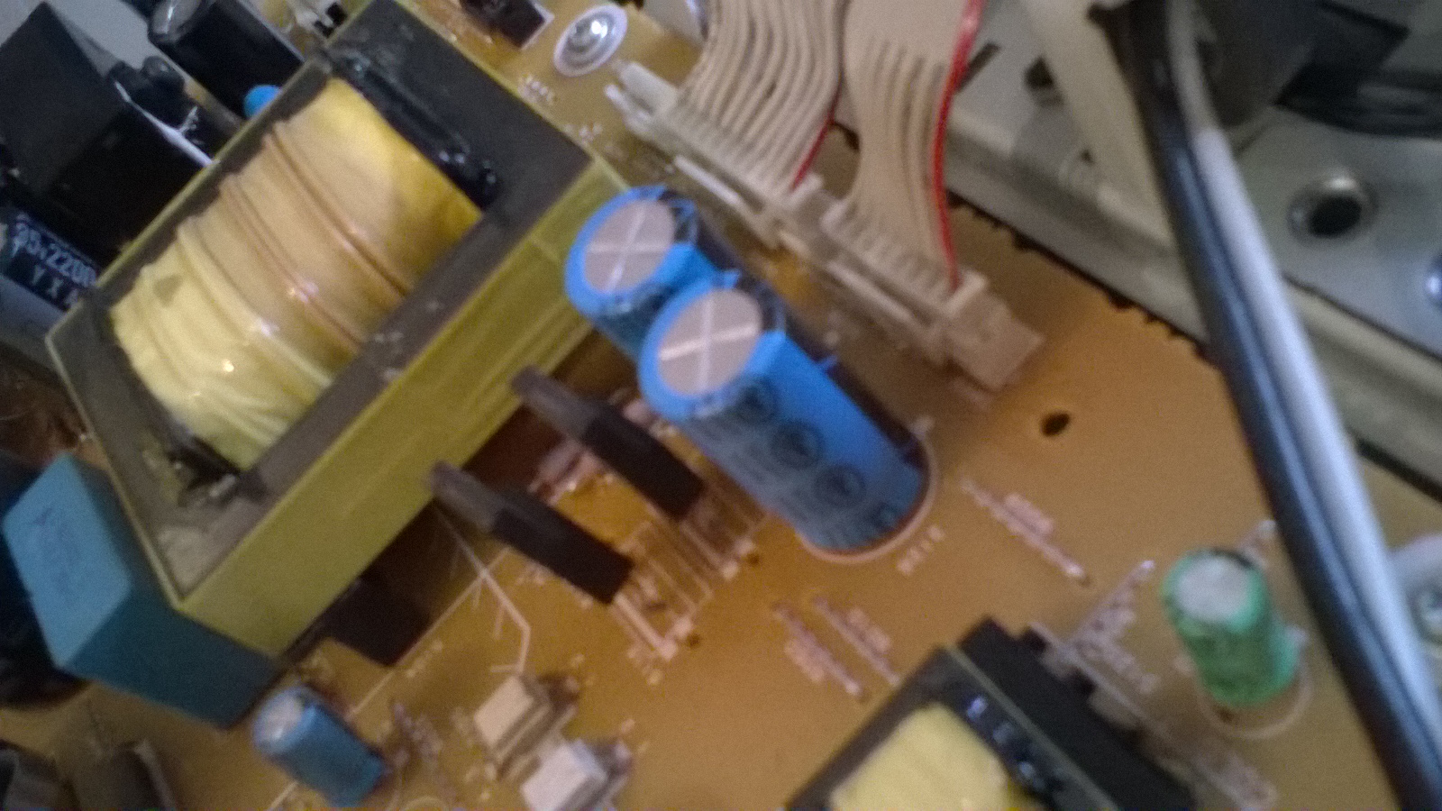

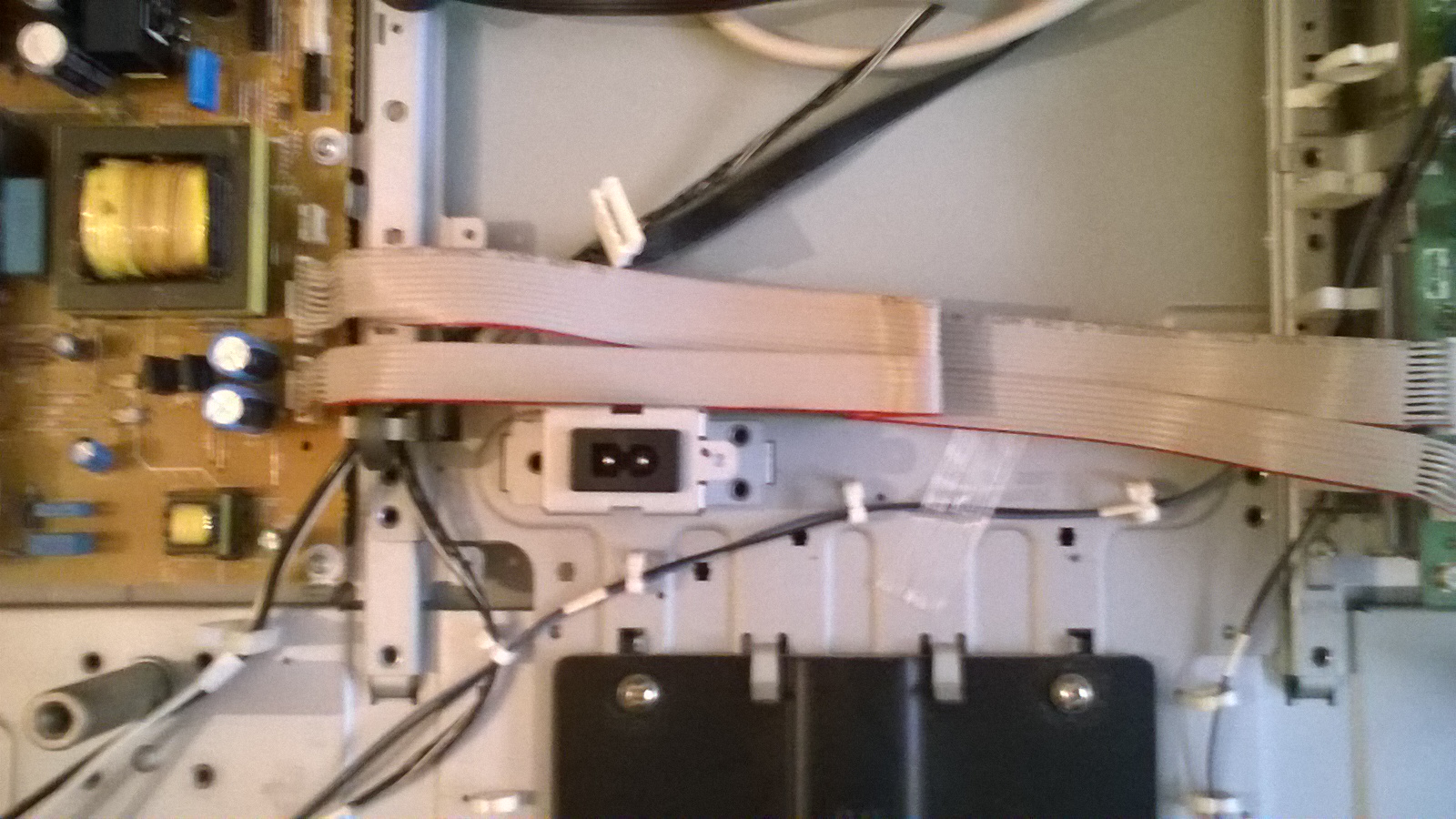

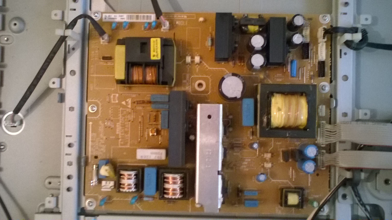

    Hello and first of all thank you for welcoming me to the community .
    So the problem i have is with a PHILIPS AMBILIGHT 42" MODEL :42PFL7623D / 10 .
    a few weeks ago the set would turn its self off randomly and when i noticed it had turned off the lights would be blinking . This went on for a week or so but not all the time .
    At the time to get the tv working again i would unplug it from the mains supply for a few minutes and then plug it back in , this worked a good few times .
    However in the last few days i cant seem to reset it with this power cycle method anymore .
    The problem i am facing now is that when i plug it in there is no display whatsoever and there is 2 blinking red led's then a pause then 2 blinks again and just keeps doing this .
    I have had the back of the casing off to inspect the caps but none look noticeably bad or bulged . I have included some pictures of the Power board and what the caps look like .
    I am an experienced solderer so i was hoping to find the bad ones and replace them hoping that may fix the issue .
    If not then maybe replace the power board completely , i just would like to know what everyone thinks the problem may be before i go about ordering caps or if there is anything else i can try to fix it .
    Thank you all in advance for the replies and once again thanks for welcoming me in .
    Rigby
    e2a: sorry for the bad quality photos

    well... we need better pictures than that. Everything is just blurry here.

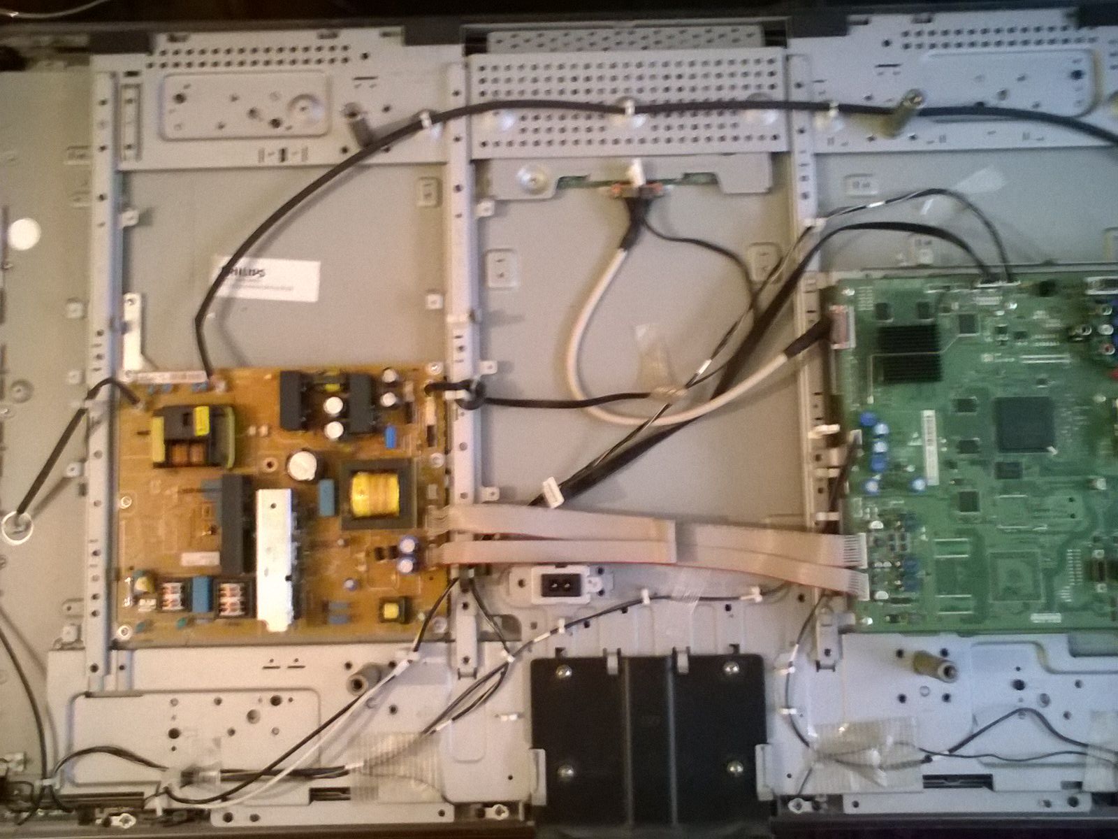

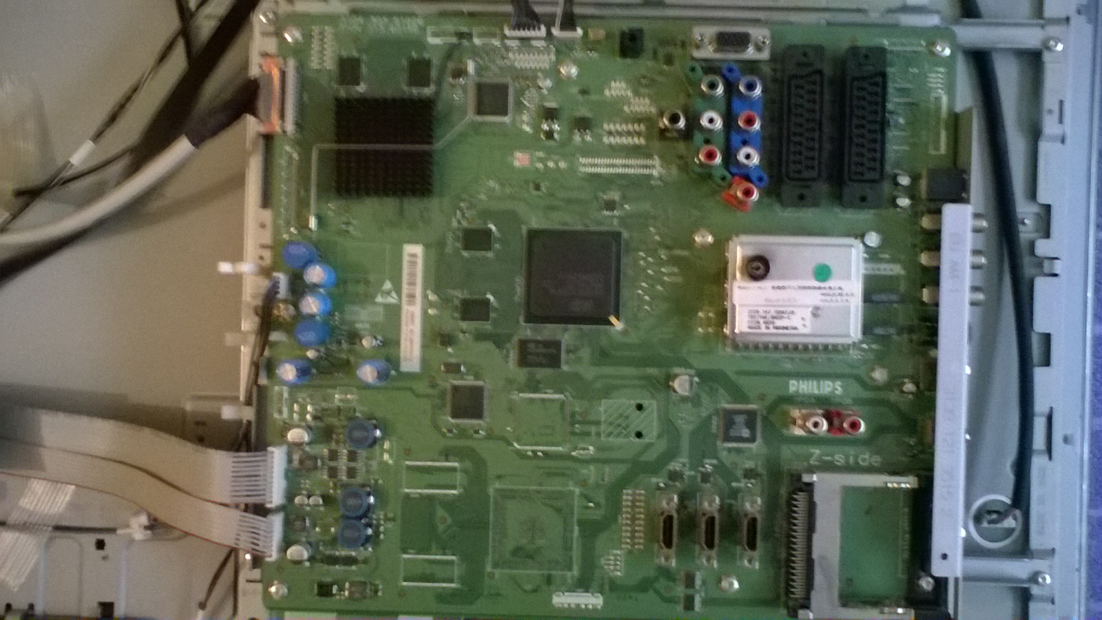

        While i sort out clearer images of the boards is there any chance anyone can tell me what the led blinking codes mean ?
        I mean does anyone know in general what 2 blinks of the led means?

                        Rigby do you have a multimeter? If so, you can start by checking for standby voltage on the connector of the power board. DC Volts mode with black lead on any metal of the chassis.
                        If no standby is present, try heating up the caps with a hair dryer then try to turn on the set. It's a crude test but it just worked for me the other day! Make sure to heat up the smaller caps around the lower middle portion of the board.
                          Re: PHILIPS (42PFL7623D/10) 2 BLINKING RED LED's
                          Looks to be same power supply as this one: Please read the bulletin.
                          https://www.badcaps.net/forum/showth...ilips+bulletin

                            Isn't code #2 almost always a PSU issue? (Likely a dead rail)

                              This is just one of the threads i saw the mention about two blinks being a mainboard issue ive not saw the error codes in the service manual for this set..
