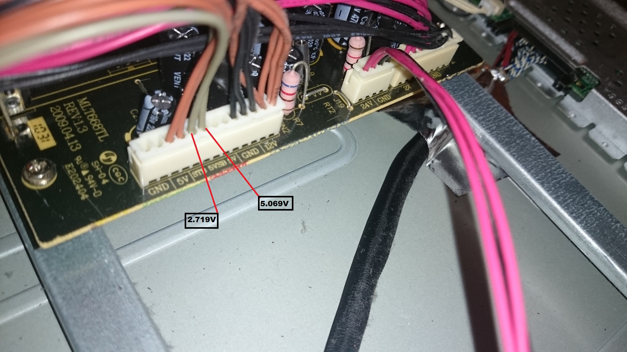

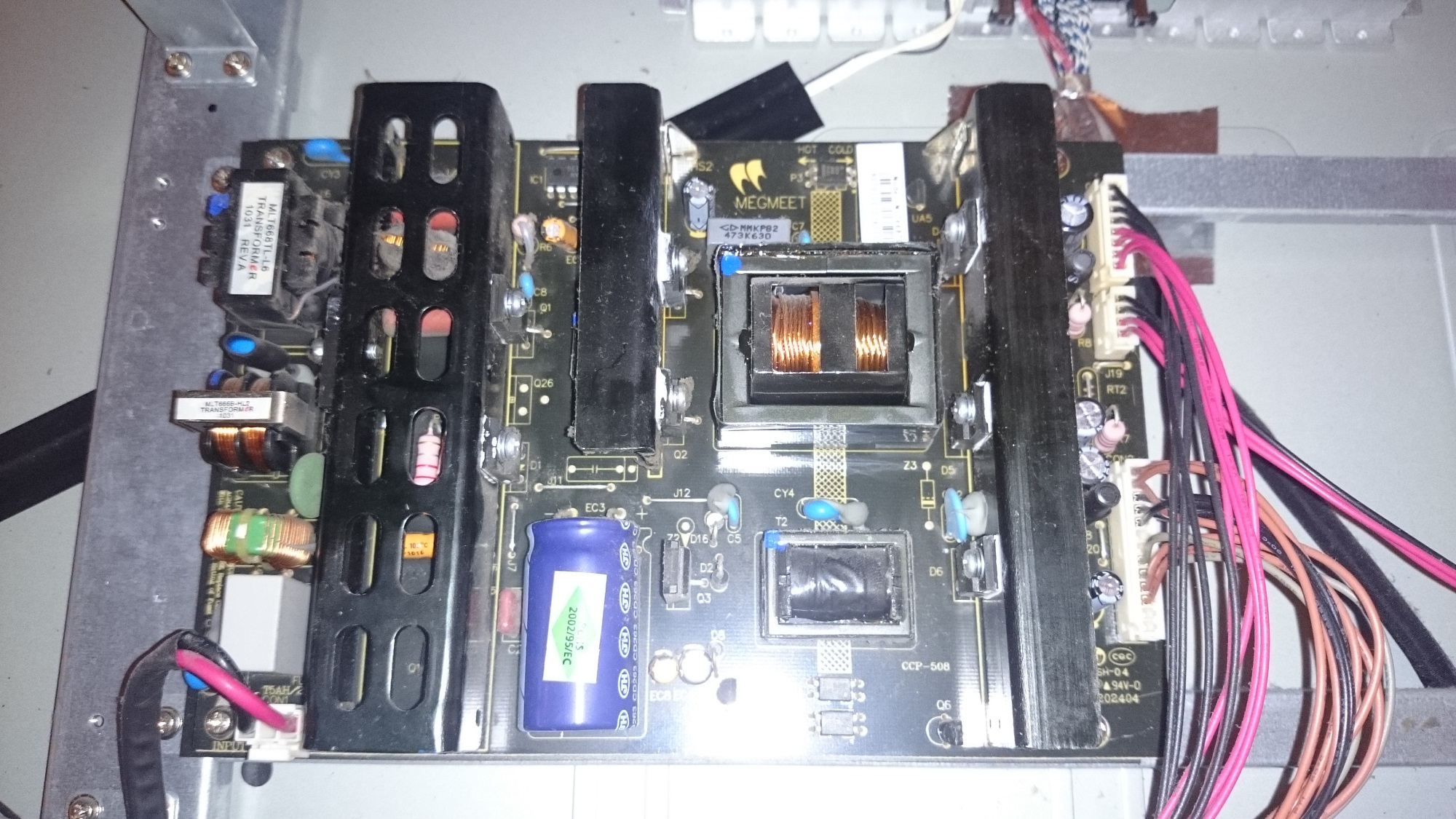

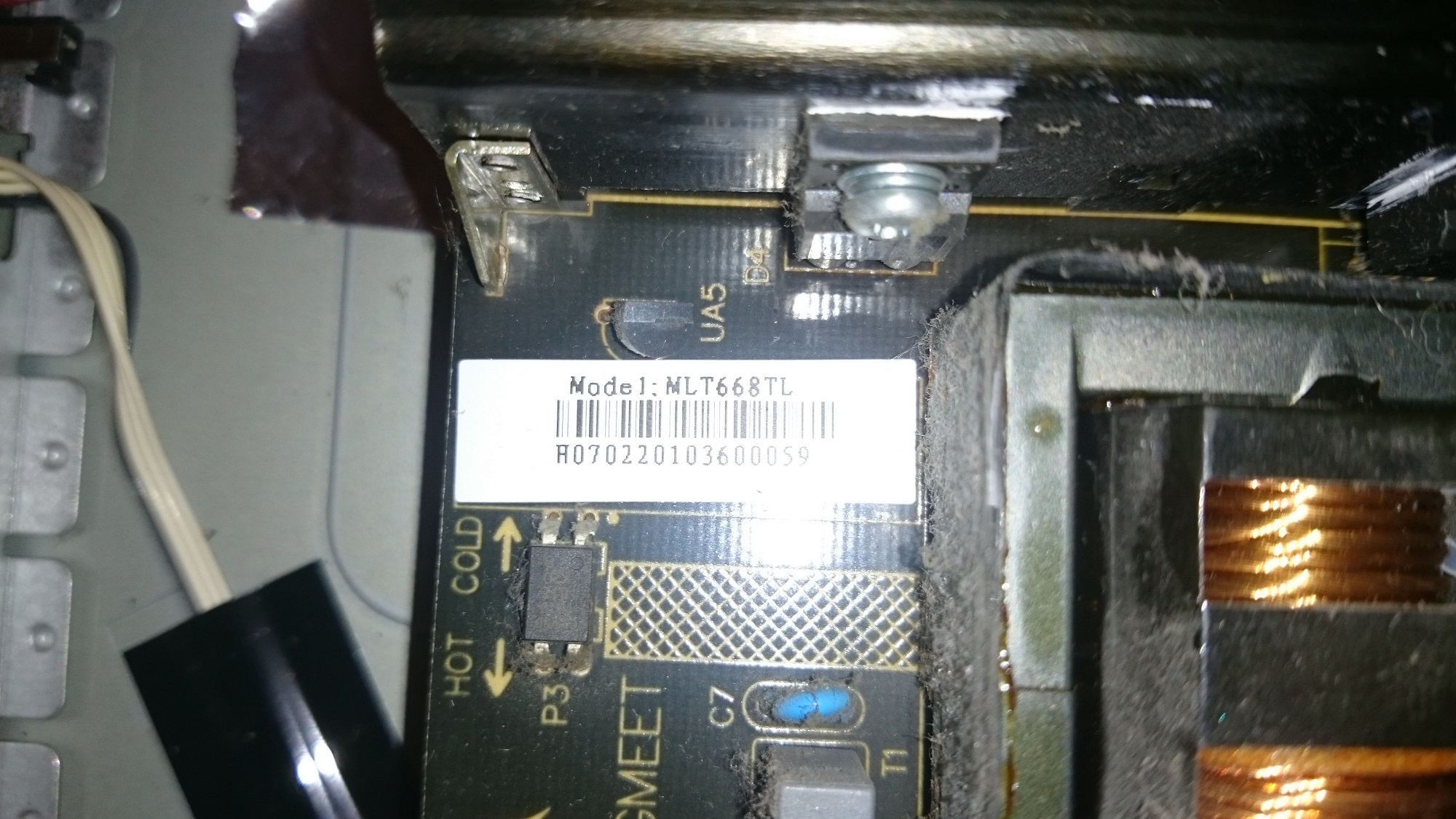

    Hello,I have this Logik model: L40DIGB20 and it wont power on .
    I have just the red standby light ,When try to power up the tv from remote and side buttons nothing happens
    The power supply model: MLT668TL
    I have only 2 reading from the power supply picture attached with this readings.
    Should I have the two 12v pin going to the main board some power ?
    Any help would be much appreciated .
    Re: Logik L40DIGB20 Lcd tv Wont Power on just red standby Led on

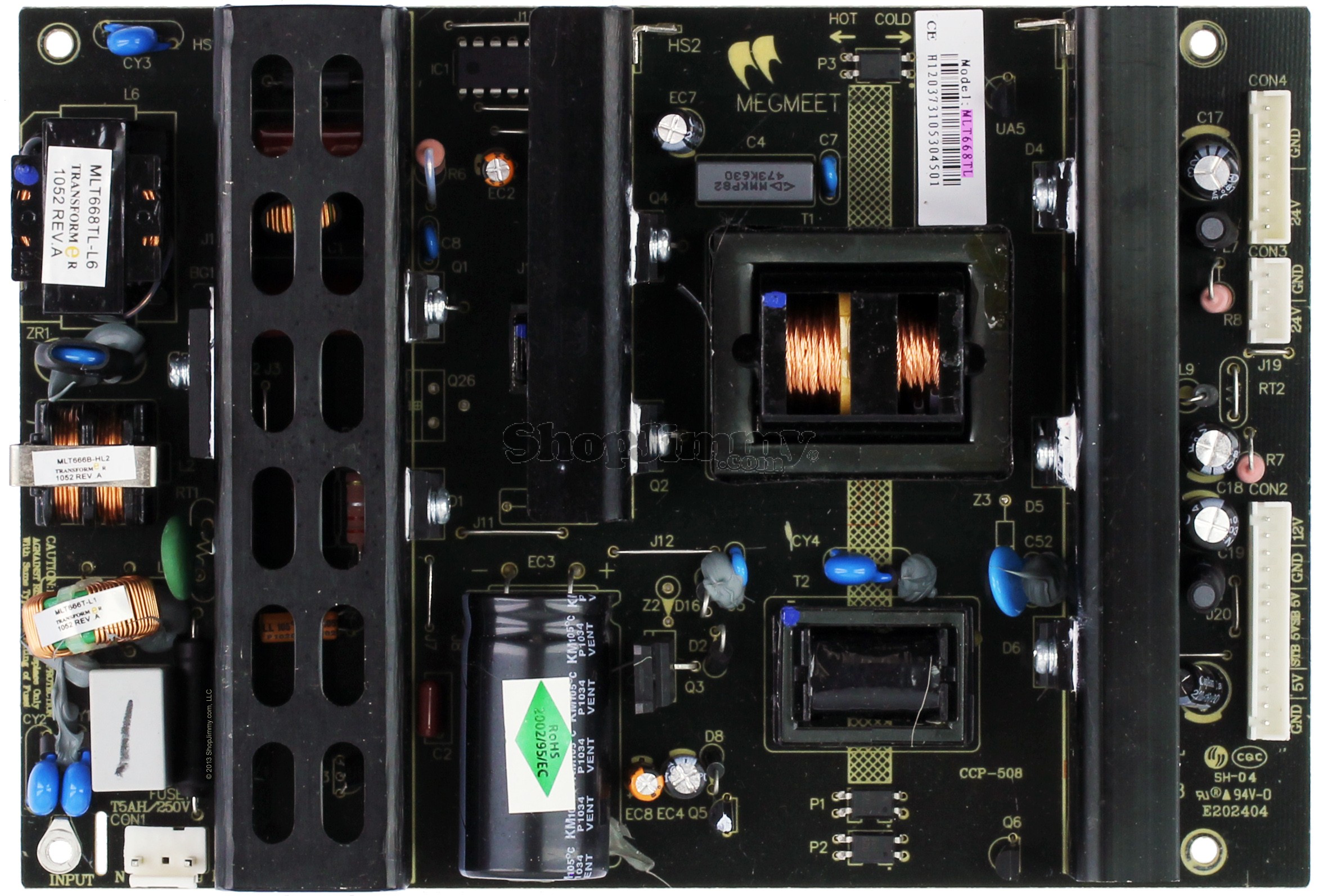

    The power supply board has to receive the PS-ON (Power supply ON signal) to turn on the 12V/24V SMPS power supply section to get the 12V for the main baord and the 24V for the inverter board but for that to happen, the PFC Voltage booster has to function first.
    Per your picture, you do have 2.719vdc at the PS-ON (STB) pin, so you need to check the DCV between the two legs of the main filter cap (450VDC CAP) see if you do have close to 400VDC on the two legs of that filter cap or not.

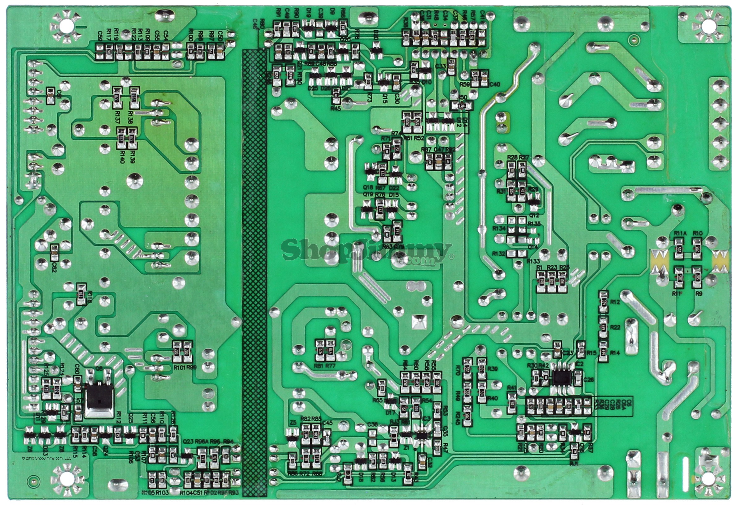

    Is this the exact match of your MLT668TL (top and bottom side)?
      Hello and thanks,I have between the two legs of the main filter cap (450VDC CAP) 392VDC on the two legs of that filter cap.
      Sometimes will drop to 385VDC .
      What would be the next step ?
      Yes the picture are the same top and bottom side (MLT668TL )

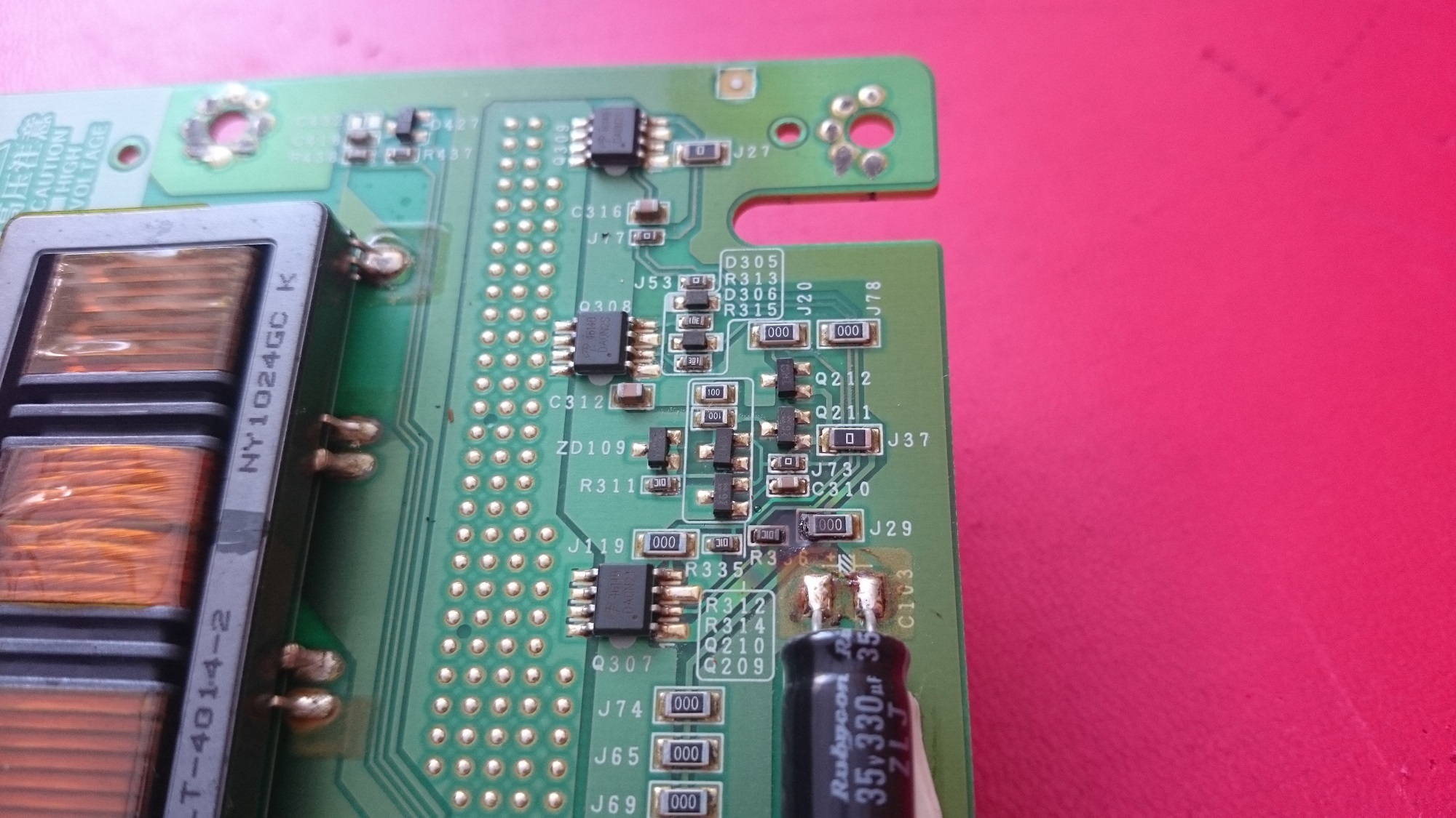

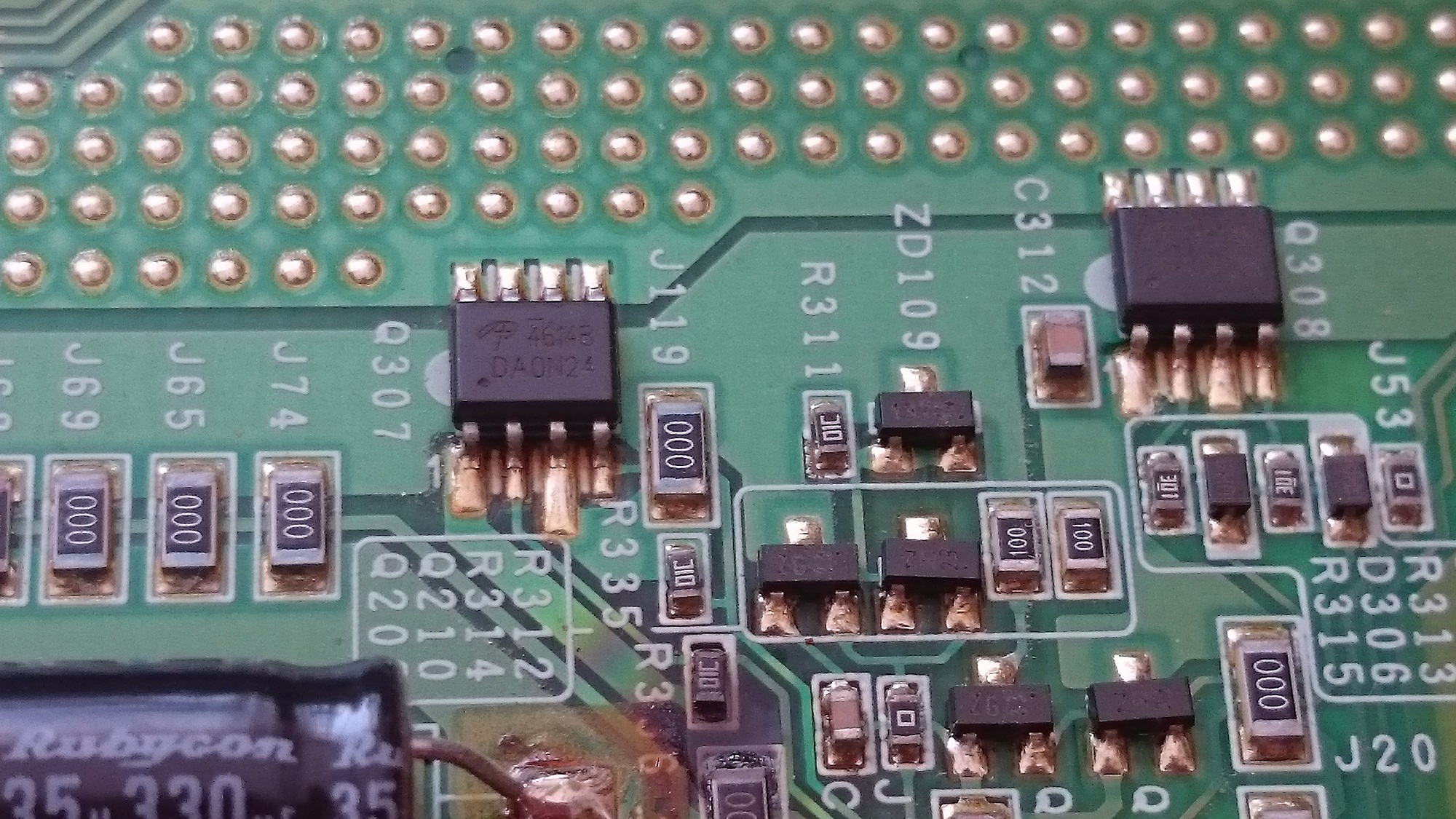

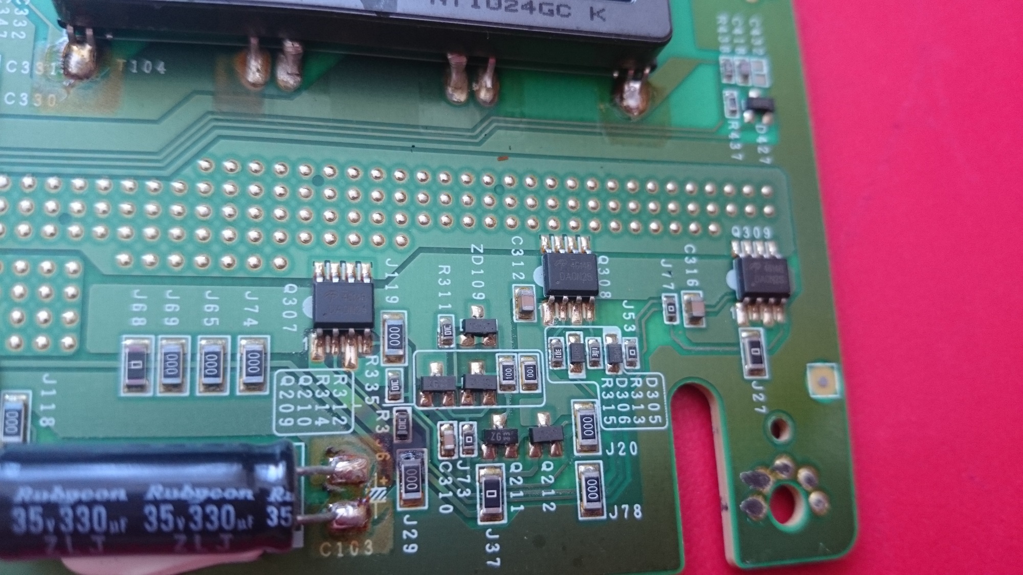

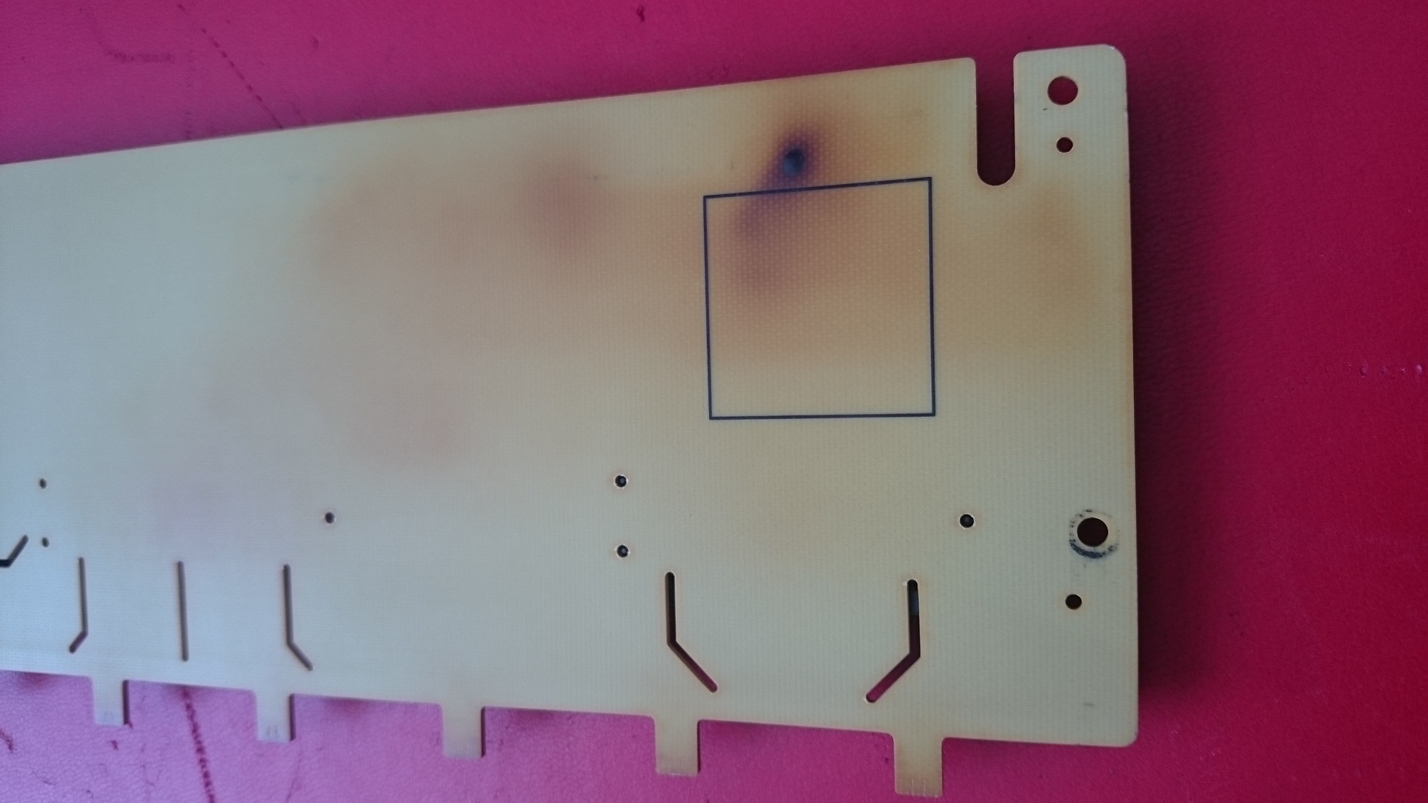

                Thanks for all your help ,I have checked and yes on SSI_400_14A01 inverter has 3 fets shorted .
                I have attached some photos to see the damage on the back .
                I order 3 fets and ReeceyBurger123 advice to replace the IC SEM2107
                I will let you know when the parts will arrive .

                  Nice one also I really urgue you to resolder ALL the little SMD resistors and jumpers buddy if they become lose they can cause the fets to blow. Also replace the caps too, with brand new ones like rubycon ZLJ or Panasonic the caps can be affected when the fets short.

                    You also have some resistors to replace that are in front of the fets. The attachment I have of them wont bloody upload

                      Hello,I have fix this tv after changing 3 fets part no A04614 and 2 10kohm resistor .Tv been running now for 3 days and still working.
