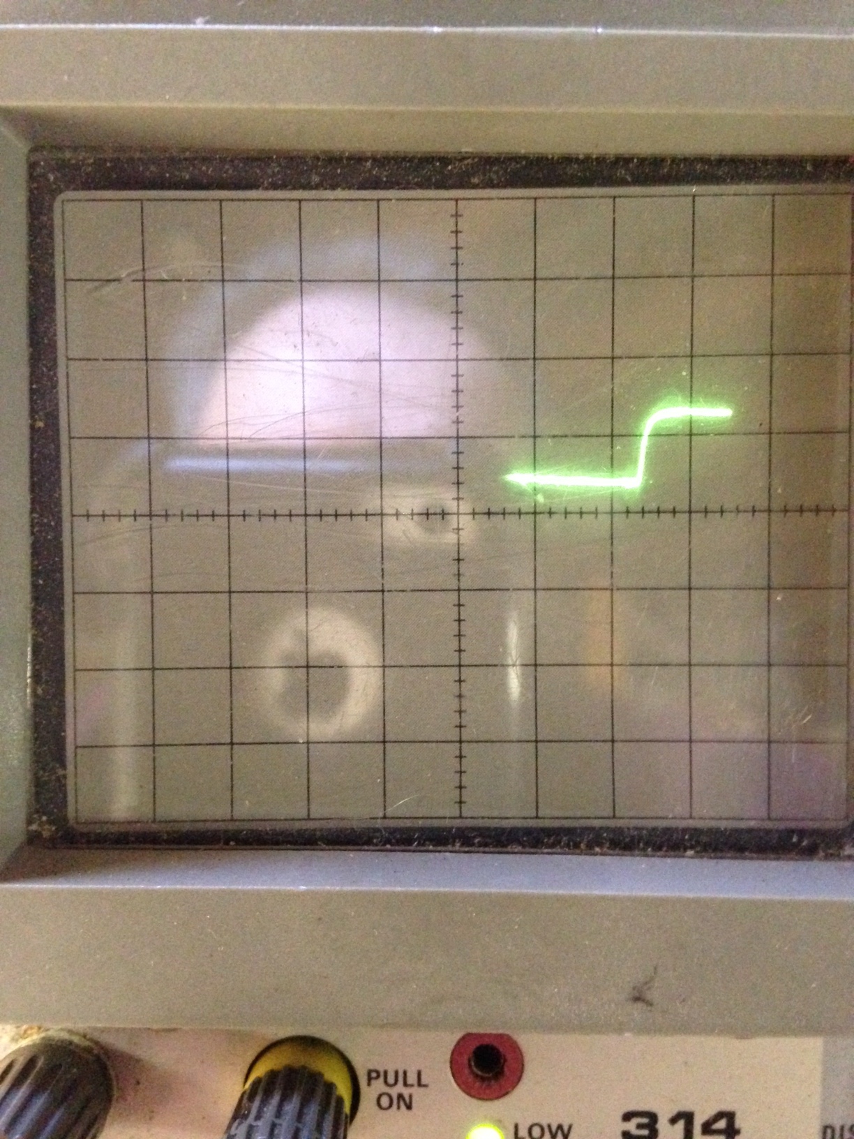

      hmmm... not sure what to say. The "5v thing" looks like the scope wasn't triggering and hence the waveforms were all over the place. Might want to "line trigger".

        remember, I spread those two signals out so I could capture on camera the fall and rise of the signal. It does not look like ripple. it's almost like a square wave or a degrading square wave signal that has a definite cycle of low to high. we're talking about a 2V swing from low to high. when I switched the time back the other way (to the left), you see two solid lines jumping up and down.
        where could that kind of signal be generated from?
        on the 5V vsb, that's a jump of about 4.75V to 5.36V. is that signal a being generated on the 1W small 5V board? both boards have separate signals that are jumping around. I'm really confused. what other measurements can make with the scope??
        can we determine if the problem is on the HOT side or the COLD side of the PS, any guess? how can we determine if the problem is on the HOT or Cold Side? I'll be glad to make more types of measurements, just give me some guidance.
        I can reconnect all cables and put TV back to normal. recheck the output voltages with the scope and see if they remain at +10-11v on the +12 and 20-22V on the +24 with the TV in normal operation.
        what do think is the cause of the 5V VSB signal, cap 616 on the 1W PS board, 470uf at the output? I'd be glad to change that out and also the Main cap 180uf 400v if you think that may help?

          I am a little bit late today, but there is something wrong with the 5v supply. It should 'the do that. Change the 5v output capacitor for now, retest.
          Now for the other 2 rails: they really seem to go up and down in voltage. Question is: do they do that in a repetitive timely manner, or erratically?

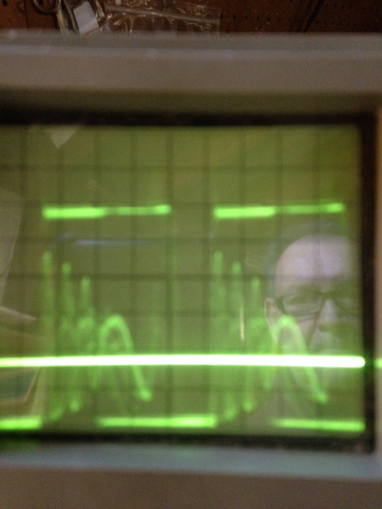

                  Here is a funny thing I noticed. It got mentioned now a few times that when the TV is back together and turned on, the 12V rail is showing 2V, while now it is showing 10 ror 11V unloaded?
                  Make another snapshot of the secondary DC, when then the voltage goes up and down, so I can see the almost square wave. 3 of them hops in one pic would be nice.

                    However, The +12 and +24 still have the voltage changing with about a 2V swing as shown on the scope photos previous.
                    I started to poke around DS3 and DS5.
                    I couldn't see a signal on the anodes of DS3 and DS5. like you had suggested, the scope may not be able to display the higher frequency signal.
                    I did manage to get the scope to view the common cathodes of DS3 and DS5. wow, this was a total shock to me. attached are photos of the +12 captured on the screen like yesterday and of the signal at the common cathodes of DS3 and DS5.
                    the scope was set to .5V per V/division, 20ms for time/division
                    the common cathode signal as you can clearly see goes from the GND line at the very bottom of the display, up to about 10V, with a huge spike or clocking/square wave riding on top going up to almost 30 volts. I don't get it.
                    what do you think is going on?

                      O.k. on the capacitor on the 5V rail and I've told you before that a bad cap will jump right out on a scope. Another thing we knew that was bad and it's off the check list. The early give away was the rising voltage when the set was cold and rising voltage.

                      With the first picture, I can't do nothing much. However in the second picture is some evidence I was hoping for.
                      The spacing in between... is that always the same, or is that erratic?
                      Do you have the scope set to AC or the DC coupling?
                      I am not sure what's going on yet, still trying to sort things out. I kinda can't believe that there is a 30V spike on top of 10VDC. That would knock the caps out on the secondary in a hurry. Unfortunately the picture is too blurry.
                      What I see is this: There is a square looking wave that turns sharply on and off. At 0.5V per division, it is 3V high (not 30) and it is roughly 70ms long followed by a 20ms break to the next one. I also see squiggly lines inside the square, but it's just too blurry.

                        with voltage/div set at .5V per division, using a 10X probe, that would make each division 5V, NO? second pic, clearly shows an approximate strong 10V level, with the big clocking/square wave looking pulse jumping up to almost 30V. that's what it looks like to me.
                        it's hard to hold the scope probe on the cathode of DS3 and fiddle with scope. the clip on the end of the scope probe cannot get enough of a bite on the center leg of the diode. I may have to improvise.
                        if I'm getting a funky signal there, where can it be coming from? do you think it's before the transformer? how do people troubleshoot SMPS's on the HOT side?

                            O.k. on the 10x probe. That would indeed set 0.5V to 5V, unless the scope is set to x1, x10 or x100. Some scopes do that even automatically.
                            When you look at a (working) PSU lets say 5V and you set the scope to DC coupling, and 0.5V per division, you should see 1 division, correct?

                            The funky signal what you see I have no idea yet, but it is (what I could see of the blurry pic) at the same time there than the square.
                            I know there is something called Back EMF, but that doesn't fit this case, as the squiggles are within that square and not after. Also the PSU doesn't turn off and on.
