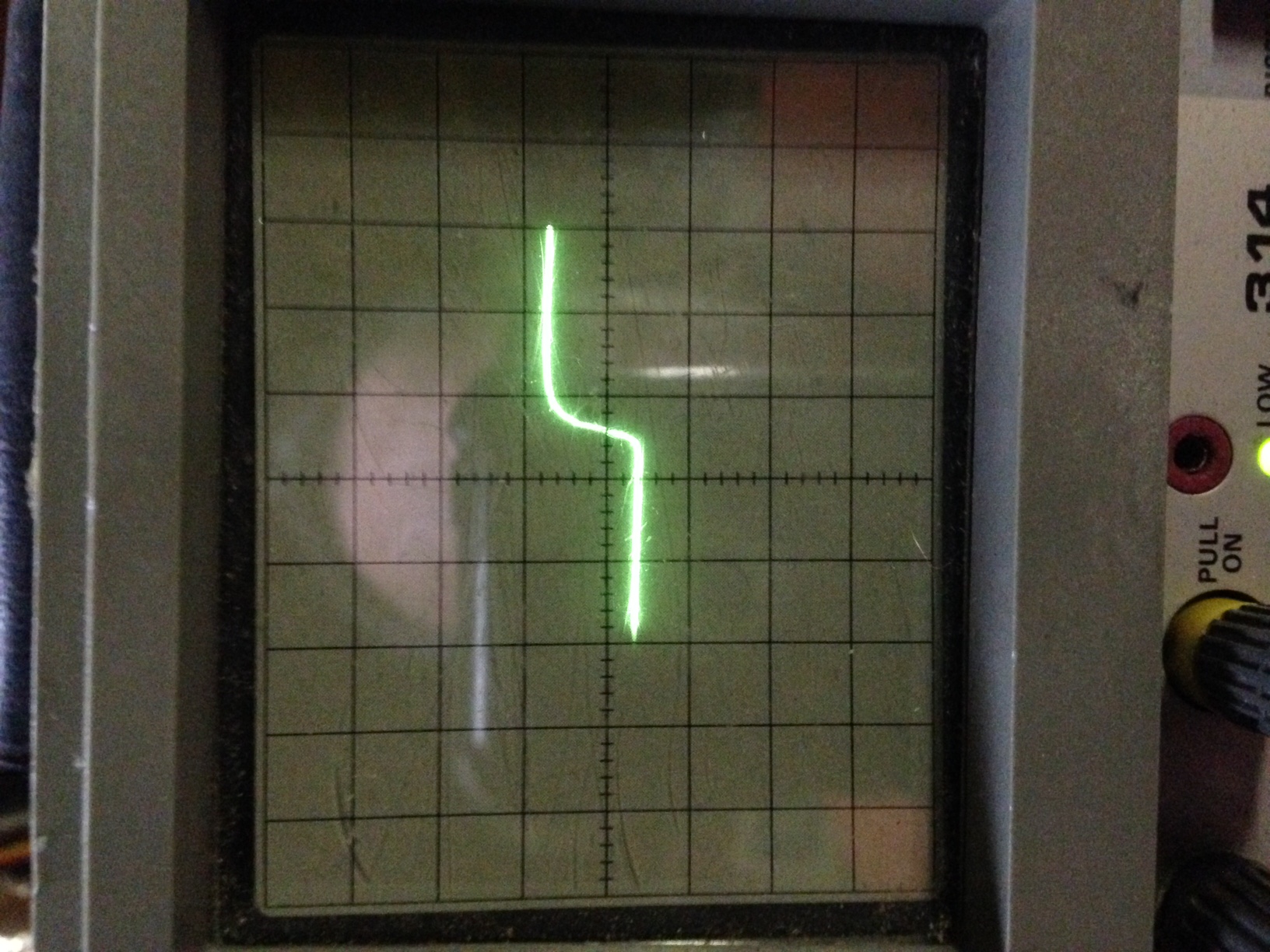

                              • CapLeaker
                                Leaking Member
                                • Dec 2014
                                • 8068
                                #135
                                Re: troubleshooting TV SMPS sequence
                                Check both of the secondary rails. Also post the Voltage / Time per division you used.

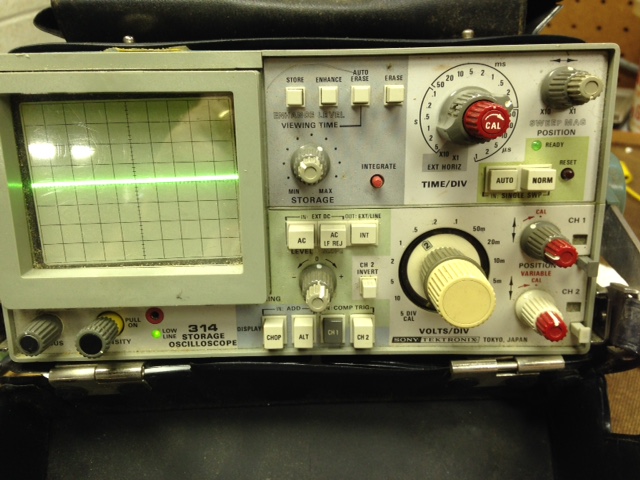

                                  • CapLeaker
                                    Leaking Member
                                    • Dec 2014
                                    • 8068
                                    #137
                                    There is no problem on the secondary to put the o'scope GND to the Secondary GND.
                                    However DO NOT hook up the scope GND to the primary. You run the chance to blow up the scope, unless you have the power supply on a isolation transformer. You can also check with your DMM between scope GND and the point you want to hook up your GND to and see if you get voltage.
                                    TO check for ripple just shorten up the time and voltage on the o'scope. Every cap has some ripple. Maybe you should test that on a different PSU that is working first.
                                    also check youtube for "ripple on capacitor".
                                    W2AEW has something on youtube over the AC and DC coupling... also something to watch.

                                      • ilikesteel
                                        • Jul 2012
                                        • 284
                                        • usa

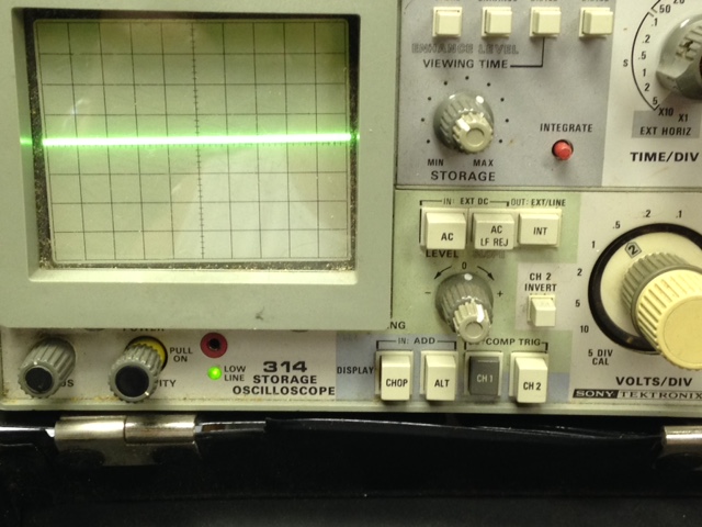

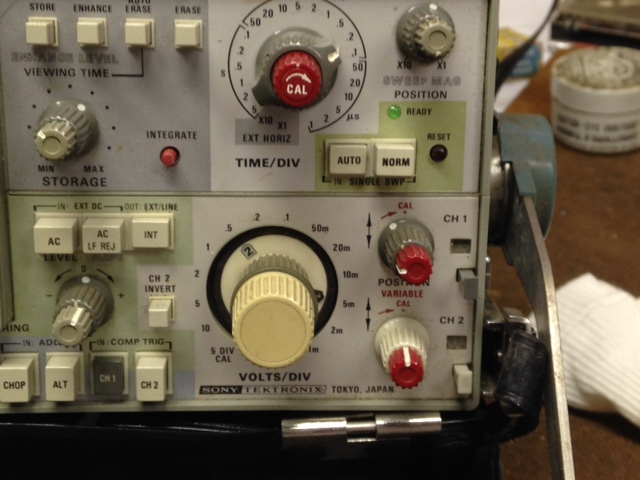

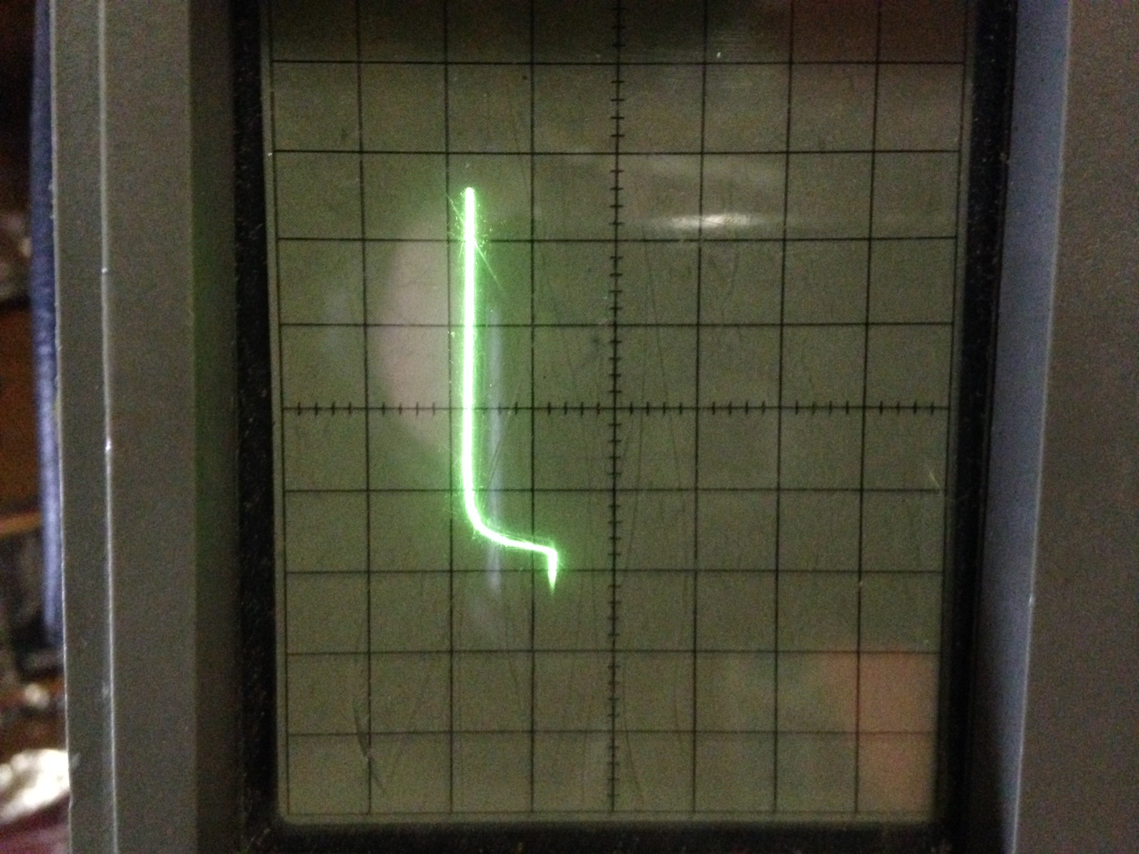

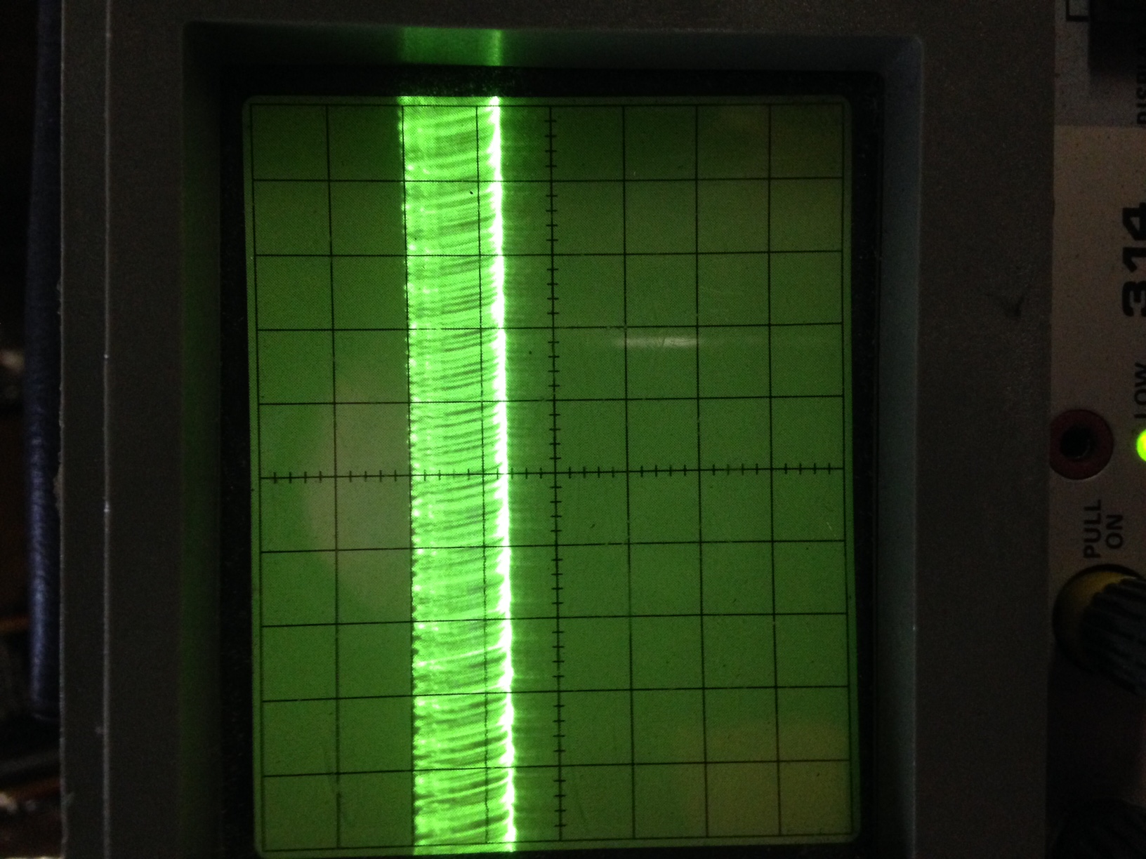

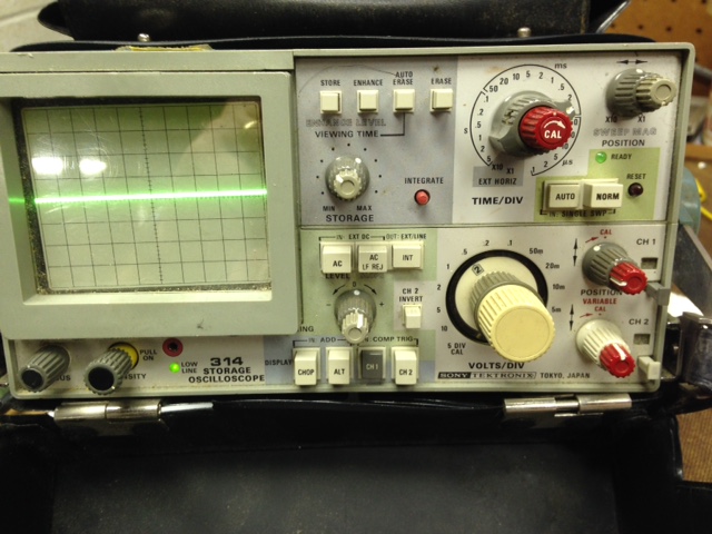

                                        #139
                                        CapLeaker and Co,
                                        here we go again.
                                        powered TV on, NO LOAD on the PS, +12 and +24 are only on the PS.
                                        attached are 3 photos of the results I received.
                                        I used a X10 probe. and the GND line is the very bottom line on the scope screen.
                                        The first photo is the +24V.
                                        .5V per voltage/division
                                        .1 of a volt Time/Division
                                        looked like 18V-22V change, note the photo.
                                        The second photo is the +12V
                                        .2V per Voltage/Division
                                        .1V Time/Division
                                        looked like 10V-11V change, note the photo.
                                        There really isn't any ac ripple that I can tell. it looks like a square wave with the lower reading going up to the higher reading and back down.
                                        Both voltages exhibited the same as did the DVM readings.
                                        here's the KICKER. I decided to check the 5V-VSB.
                                        .1V per voltage/divison
                                        .2 MS Time/Division
                                        That's the 3rd photo. wow, what's going on here?
                                        thanks,
                                        ilikesteel

                                          #140
                                          CapLeaker,
                                          Guess photos didn't attach. here theya re.
