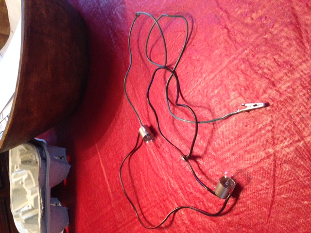

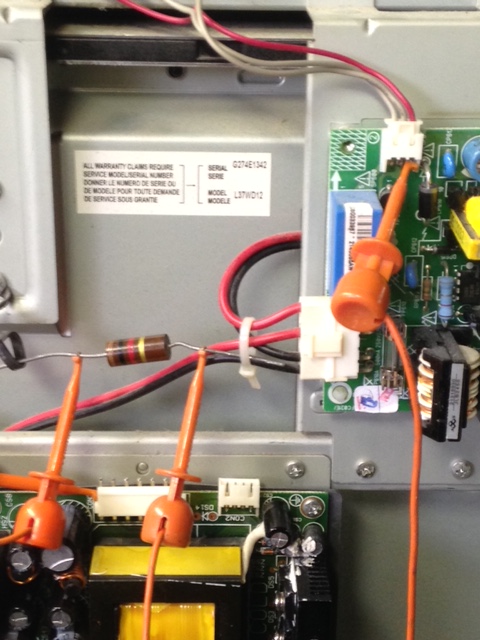

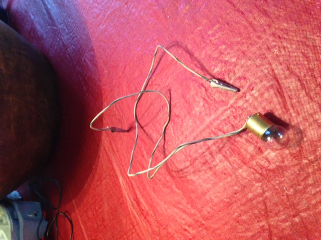

                          #52
                          Re: troubleshooting TV SMPS sequence
                          CapLeaker,
                          Before attempting the experiment of the voltage measurement, here's what I have rigged so far. I'm ready to do it, just want to make sure what I have is correct. I don't want to blow up the PS or me!
                          enclosed are 3 pics, one each of the wiring rigs I made and the other for the 5VSB through a 1K resistor to Pin 7 of the PS.
                          I checked the wiring rigs for operation by connecting them to my car battery. they worked perfectly. the single 12V was nice and bright. the two in series using the 12V were dimmer. I took one of the two in series and connected it directly to the 12V and it was bright.
                          The lamps I'm using are #89 automobile bulbs, rated for 7.5W, .5amps, 12.8V
                          the cables from the PS conn3 to the scaler board bp103 are completely removed.
                          what do you think?
                          Thanks again,
                          ilikesteel
                            #53
                            Ok. Here is how this bulb trick as a load works. One bulb 12V lets say 1A. Two bulbs in series are 24V, 1A. Two bulbs in parallel are 12V, 2A.
                            So you put the single bulb on the 12v tail and the 2 bulbs in series on the 24V rail. Fire this thing up and measure the voltage on both rails.
                            A half an amp is a bit thin, but the idea is to see what the PSU does when there is a little load on it. When under load, also check the main filter cap again.
