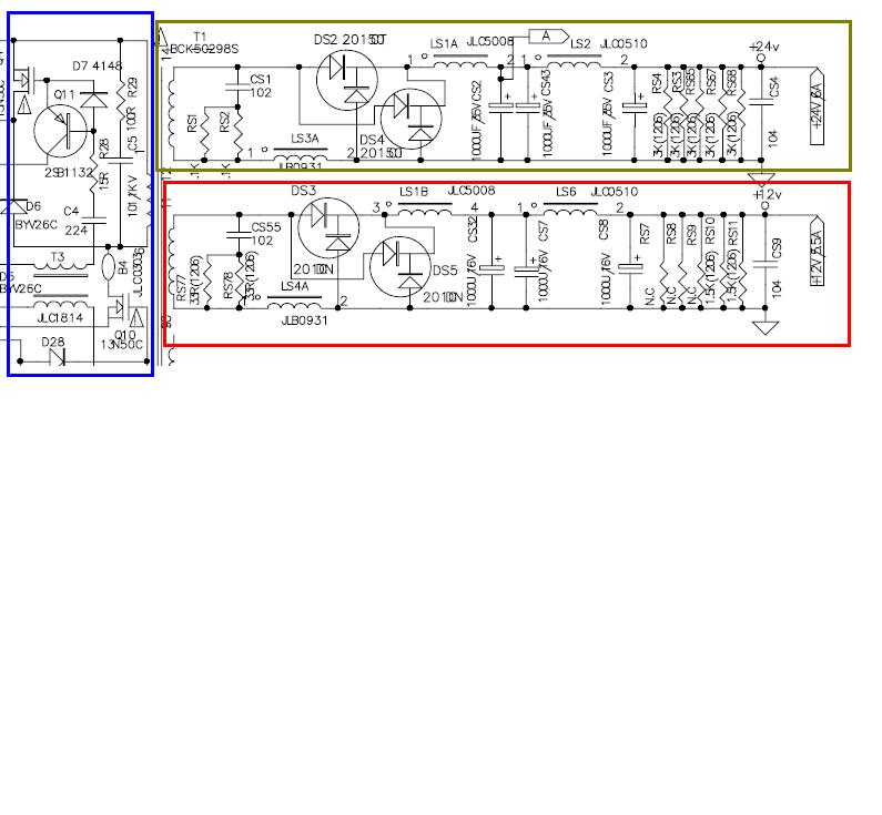

    I posted a problem with an RCA L37WD12 TV awhile ago. It's definitely has a PS problem. I've followed a logical sequence of troubleshooting and now I've run into a dilemma. I'd like to troubleshoot the problem further. here's where I'm at:
    1. standby 5V good, standby LED on red.
    2. PWR-ON works, PS gets AC applied to main PS, led flashes green continuously.
    3. the output voltages should be +24V and +12V. the output is actually +20V and +2V respectively.
    4. checked across main cap 180uf, 400V, I get 360 DC volts.
    what is the next logical sequence to check voltages with DVM, I don't have access to a scope. I know there is the HOT side and COLD side with different ground references.
    What would cause both DC supplies to be affected with low voltage output? that's where I need to get too.

    Re: troubleshooting TV SMPS sequence
    Look at a different way: What could be dragging the 12V down so bad?
    I would disconnect everything from the PSU and force the PSU on by itself, then check the secondary voltages again. Maybe resurrect the previous thread again.
        I would suspect a shorted diode in the 12 volt section, ds3 or ds5.
        The primary circuit is working fine because the +24v is at +20v. its only a bit low because somthing in the 12 volt section is causing it to be droping a bit.
        I guess you could have a shorted cap. in the +12 circuit but I doubt it.
        The area in blue is the primary that drives both the +24 and the +12 and is working fine.
        The area in green is working although a bit low. the area in red is where your problem is. (unless there is something connected to the +12 that is loading it down) but it does not look like it if you disconected con3 and it was still low.
          ds3, ds5 and check those three 16V 1000uF caps. matter effect, unhook the 24V and the 12V, take your ohm meter and measure those two against GND. Probably the 12V almost measures a short.
              before you take them off, what reading do you get with your DMM in Ohms on the 12V and on the 24V output (TV off of course)? Well voltage measurement? We know already that the 12V is putting out 2V. Sure you can measure the 2 diodes in circuit with your DMM in diode mode. Lets see what you get.
                You should be able to compare the resistance readings in the 12 volt circuit with the ones in the 24 volt circuit as they use the same diodes. both circuits are almost identical except for the cap. voltages, and resistor values.
                with power off, check the resistance between ground and +12, it should be about 700 ohms give or take. if its low like 10 ohms, you have something shorted.
                          Have you checked the coils Ls1b, Ls4a, Ls6. If the diodes are ok you could have an open coil. also check the continuity of the transformer winding 10 - 11 , it should be low around a 1 ohm, compare to the winding 12 - 14 they should be close to the same resistance.
                          12v to ground around 7 k seems high it should be at least measuring the two parallel resistors (rs10,rs11), 1.5k each = 750 ohms aprox.
                          when checking the diodes you should be using the diode test on the meter (the diodes are dual diodes) so ds3 has 2 diodes ds5 also has 2 diodes.
                          The 24volts is working so a slight charge in the caps could throw off the 24volt readings.
                              There are 2 off 1K5 resistors in parallel on the 12V line at its output point so I would expect you to read 0.75K (750 ohms). There are also 5 off 3K resistors in parallel with the 24V output so I would expect you to read 0.6K (600 ohms)
                                  Hello ilikesteel,
                                  The parallel combination of 1.5K resistors on the 12V line would give you a reading of .75K so that reading is close to what you would expect.
                                  (I assume you mean .700K ohms and not ohms.)
                                  If so the 5 resistors in parallel which on the schematic are 3K would give you 0.600K ohms (600 ohms) so the readings you have given above would be correct.
                                      Assuming the +5V standby is working and you have you unplugged the power supply from the rest of the circuits, put a link to ground from the "On/Off" pin (junction of RS22/RS23) via say a 1K ohm resistor to bring the other supplies up.
                                      If they come up and the +24V is working but not the +12V then I would have a good look at what has already been mentioned and check DS3 & DS5 and associated caps CS32, CS7, CS8
