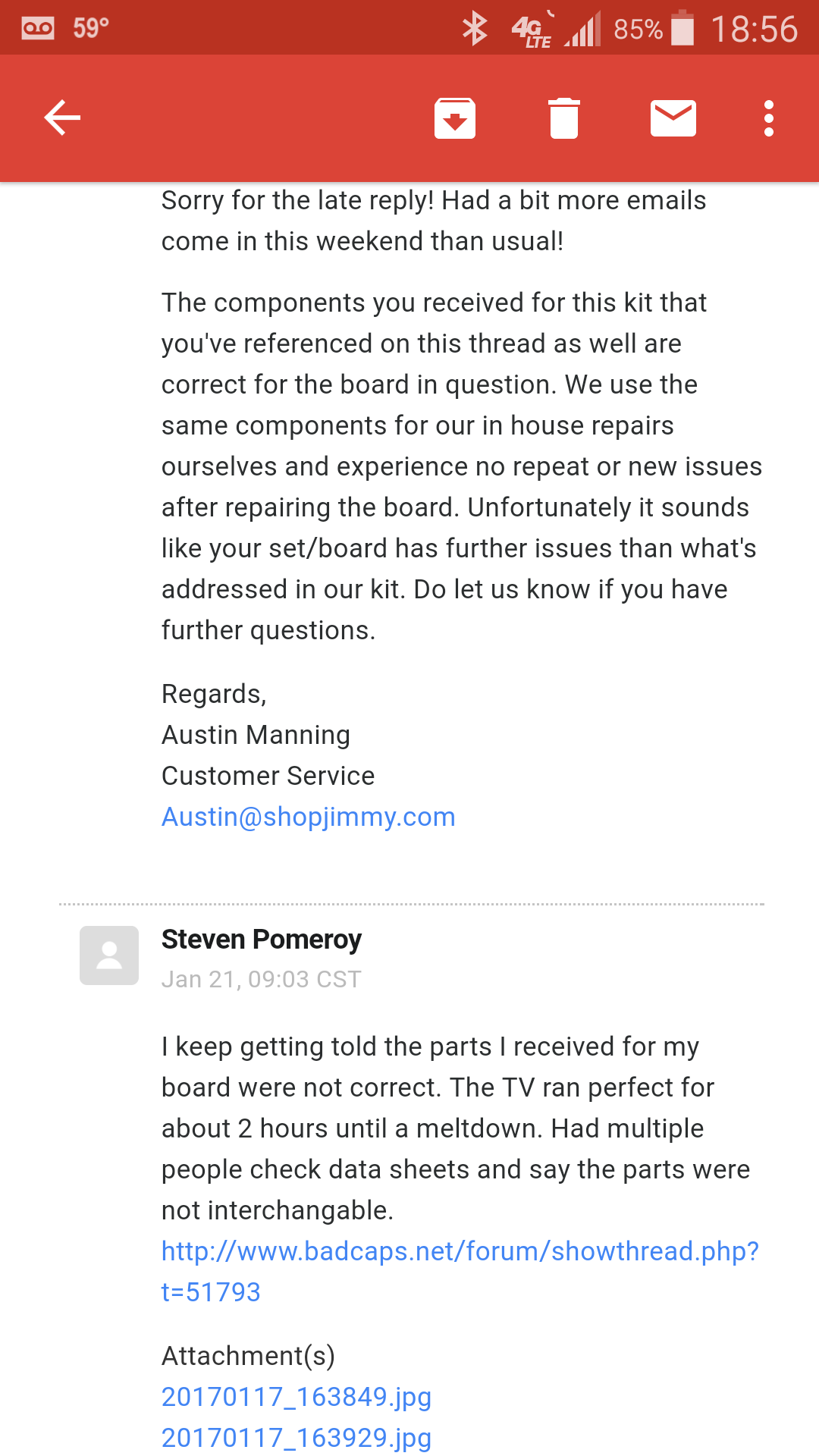

                                      #78
                                      Re: Yet Another TC-P55GT30 7 Blinking Light Error
                                      Here is my reply from shopjimmy
                                      • Moreno83
                                        • Jun 2014
                                        • 2008
                                        • The Netherlands
                                        #79
                                        You got the same problem as Jeff has. If you have a scrap board then you can repair your own board. You need Q600 + resistors + other igbt's. Your board took a massive hit.
                                        Also , if you look at the reply Jeff got they said he got the wrong repair kit and its his own fault.
                                        Im pretty sure they dont know what they are selling.
                                        In your case you need a new/repaired sc board.
