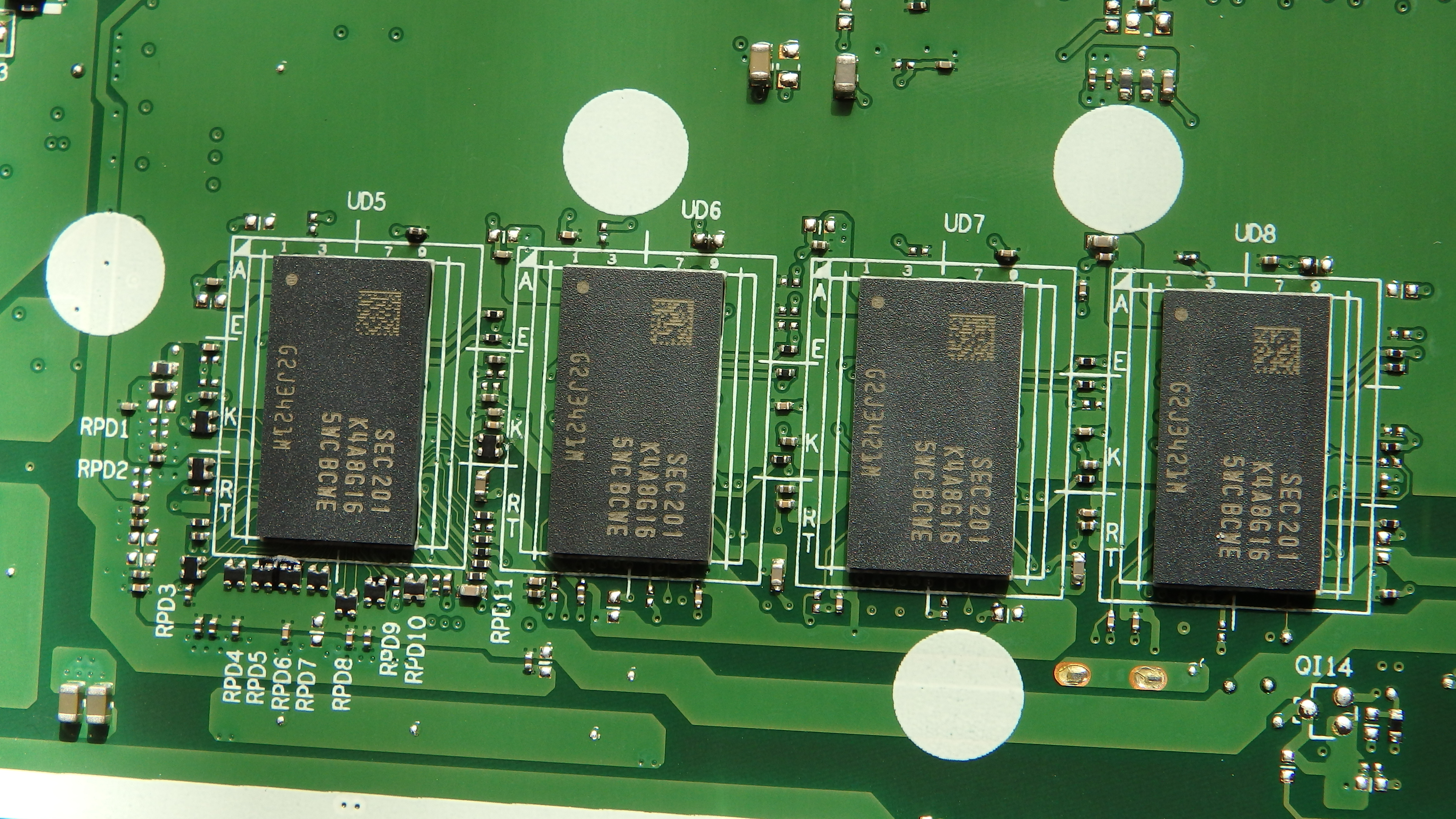

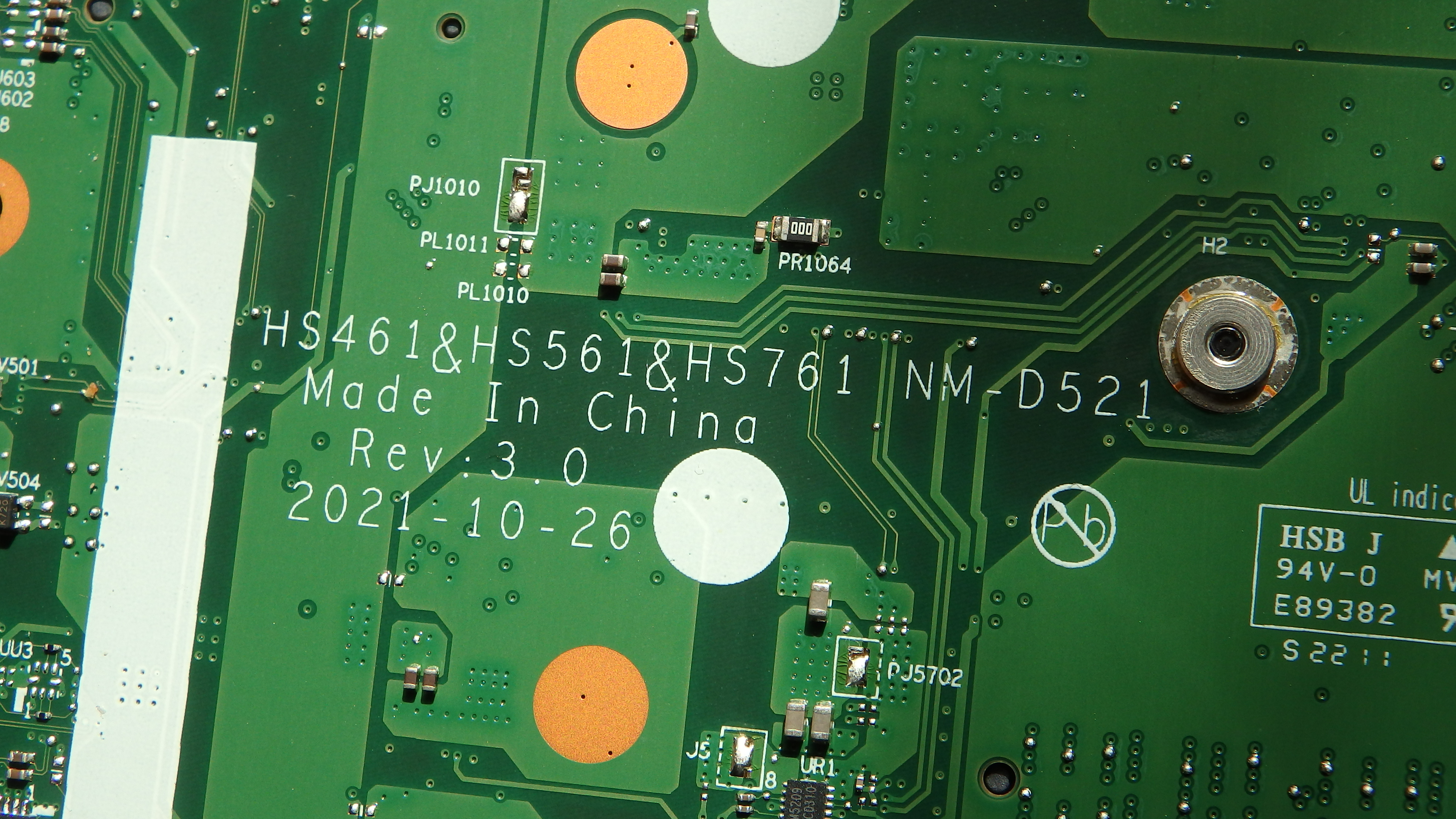

    Hello friends,
    I have this laptop AMD Platform starting & not posting, fan spinning.
    When i press power button, the board get almost immediatly 0.5A ~ and board get stuck at 0.5A with power button led blinking indefinitly.
    If i stop the computer (pressing 5s power button), board stop and when i restart i get approx 0.37A ~ and
    I try to reflash the bios with no luck, same result, and i try disabling onboard ram (i remove resistors accordling schematic), no more progress.
    CPU and his area heat, maybe the cpu is dead?
    I look for some signal:
    SLP_s3 => 3.28V
    ALW_PWRGD => 3.3V
    PLT_RST_N => 0V
    Of course i get no display (internal or external), no caps lock indicator.
    What can i look for ? is it dead?
    links for shematic:
    https://www.badcaps.net/forum/troubl...-hs761-nm-d521
    Thank you ! 😀

    did u managed to resolve it? I have two lenovo with the same problem. Starting no immage just the power led blinking forever. In both cases i reflashed bios and IT chip. All voltages are ok

        I fixed mine. The problem was with the onboard ram. I disabled by modifying 3 resistors positions. I think there is a modified bios with disabled ram but i couldnt find it

          I shared the schematic and the combination depending of what type of ram you have. On the boardview the exact possition can be found by selecting the resistor that needs to be moved

            I have such a motherboard .
            • adiasterix81
              • Aug 2017
              • 40
              • Romania
              Most likely u have samsung ram chips, soo they are all in position 0000 and you need to move them to 1111. This means that R272, R273, R274 and R275 (or 266 if u have 8gb ram) needs to be moved to R263, R264, R265 (in case of 8gb ram R266 is not moving)
              See position from Boardview
