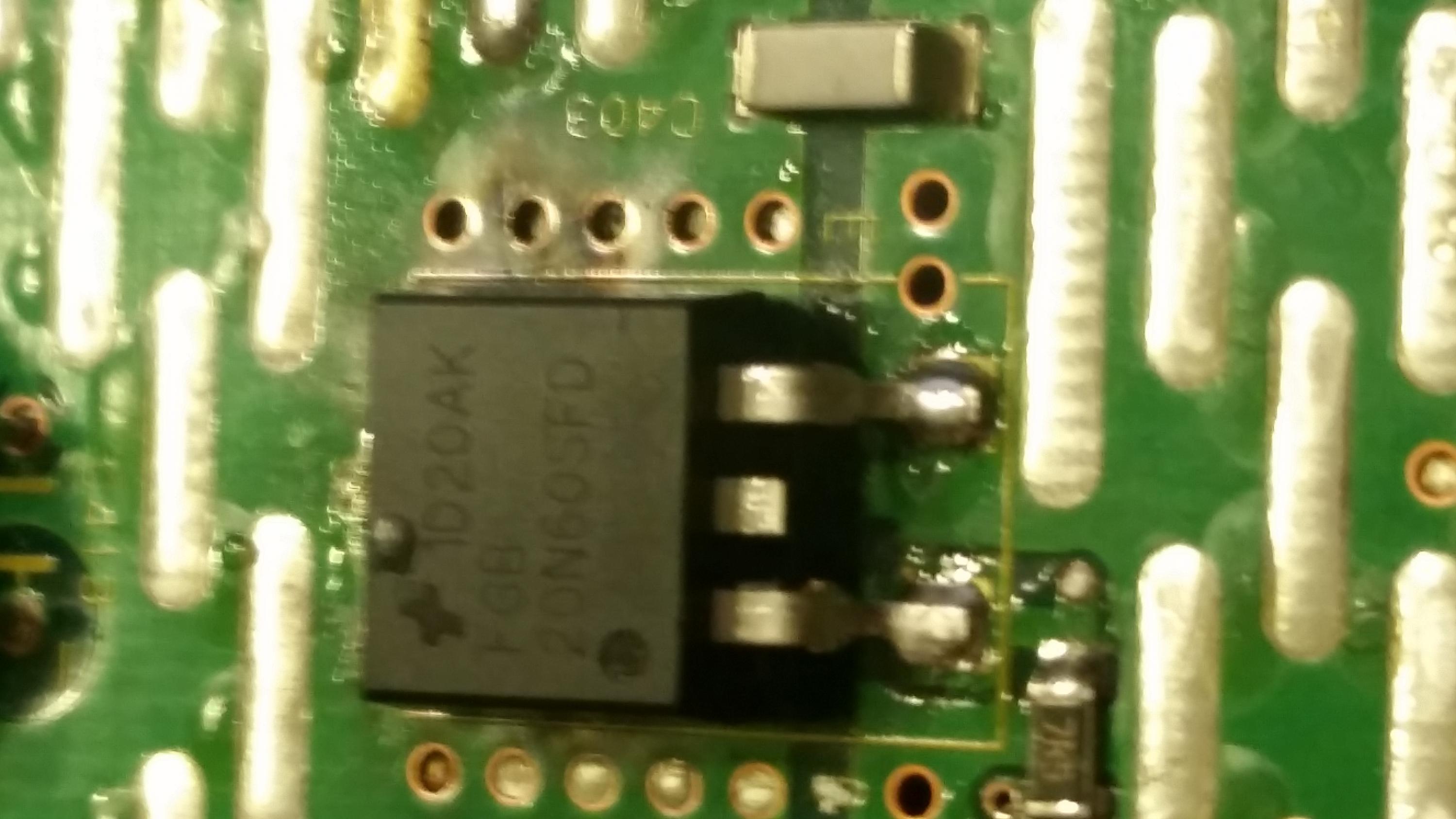

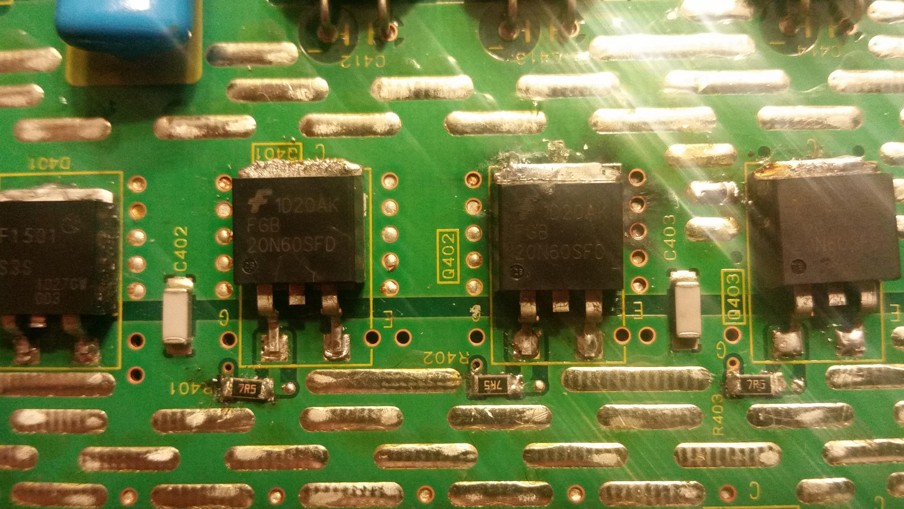

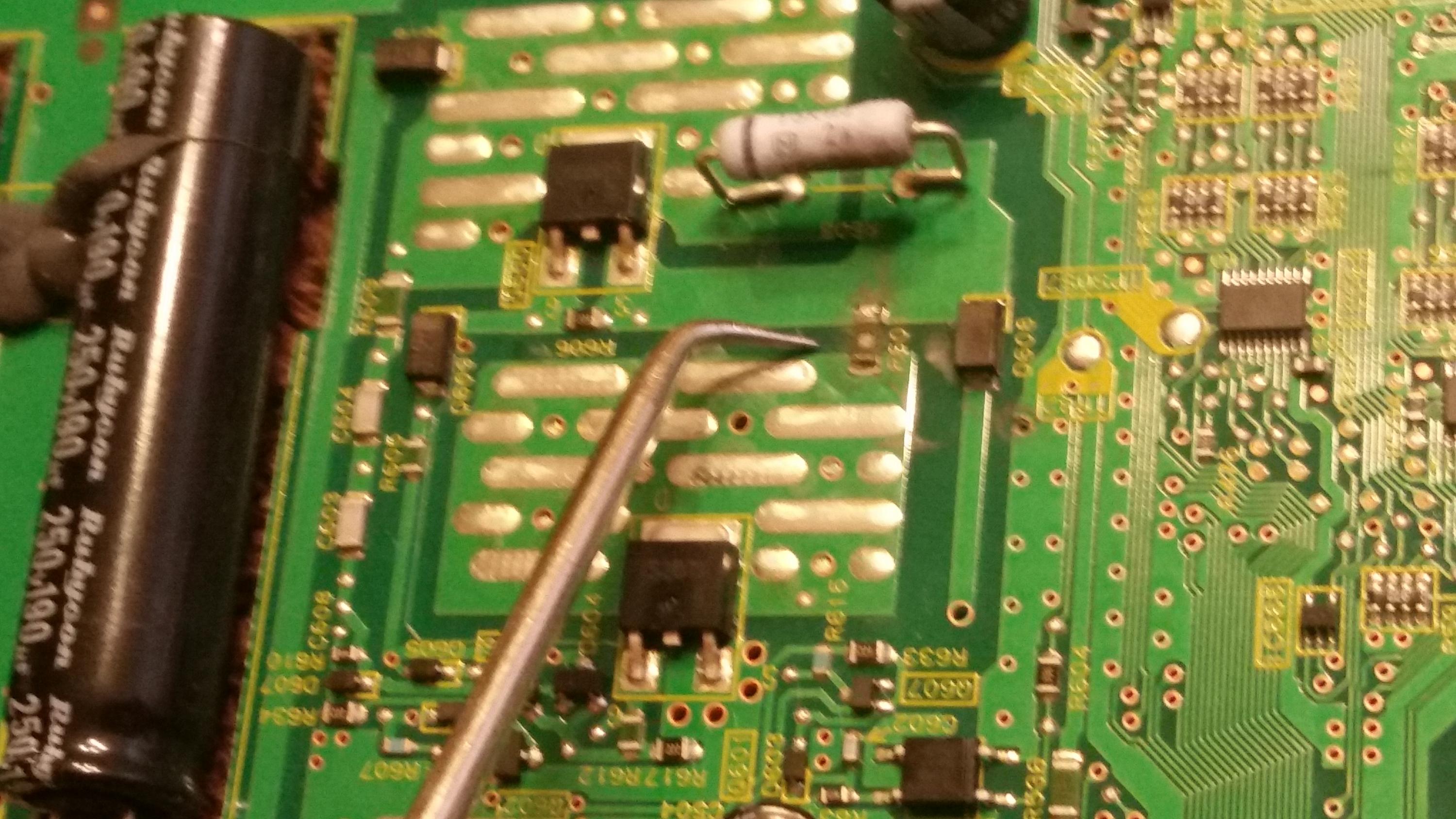

                Re: Yet Another TC-P55GT30 7 Blinking Light Error
                I'm new here just searching for some ideas. Been struggling with a 50 Panasonic myself and a faulty SC board. Swapped out parts with parts kit worked for 2 hrs the 2 loud pops and it went dead. Obvious resistor at R60 gone but no clue of value to replace. Also HD a transistor come loose from the board.
                • Moreno83
                  Then you probably used fake parts. Wat resistor blew? Resistor on the leftist of the big capacitors?
                  Please take some pictures.

                    #29
                    R601 is the one I know blew. Q402 also up in smoke.

                      #30
                      Yes those resistors and diode ( and probably more ) blow because of fake/bad parts. What's that part? ID20AK? Never heard of it.......
                      Where did you buy the kit??

                        #31
                        FGB20N60 is the part --> 600V, 20A, 2.2V, TO-247
                        30F131 is the original --> 360V 200A / TO-220
                        Im not that good in reading those data sheets but thats a big difference. I don't think its a suitable replacement part for your board.
                          t0-220 wouldn't fit there ..
                          neither would a TO-247
                          more likely a TO-263
                          had a quick look at data sheets and was confusing ... igbt versus mosfets ... ..
                          just get genuine original parts .they are available .

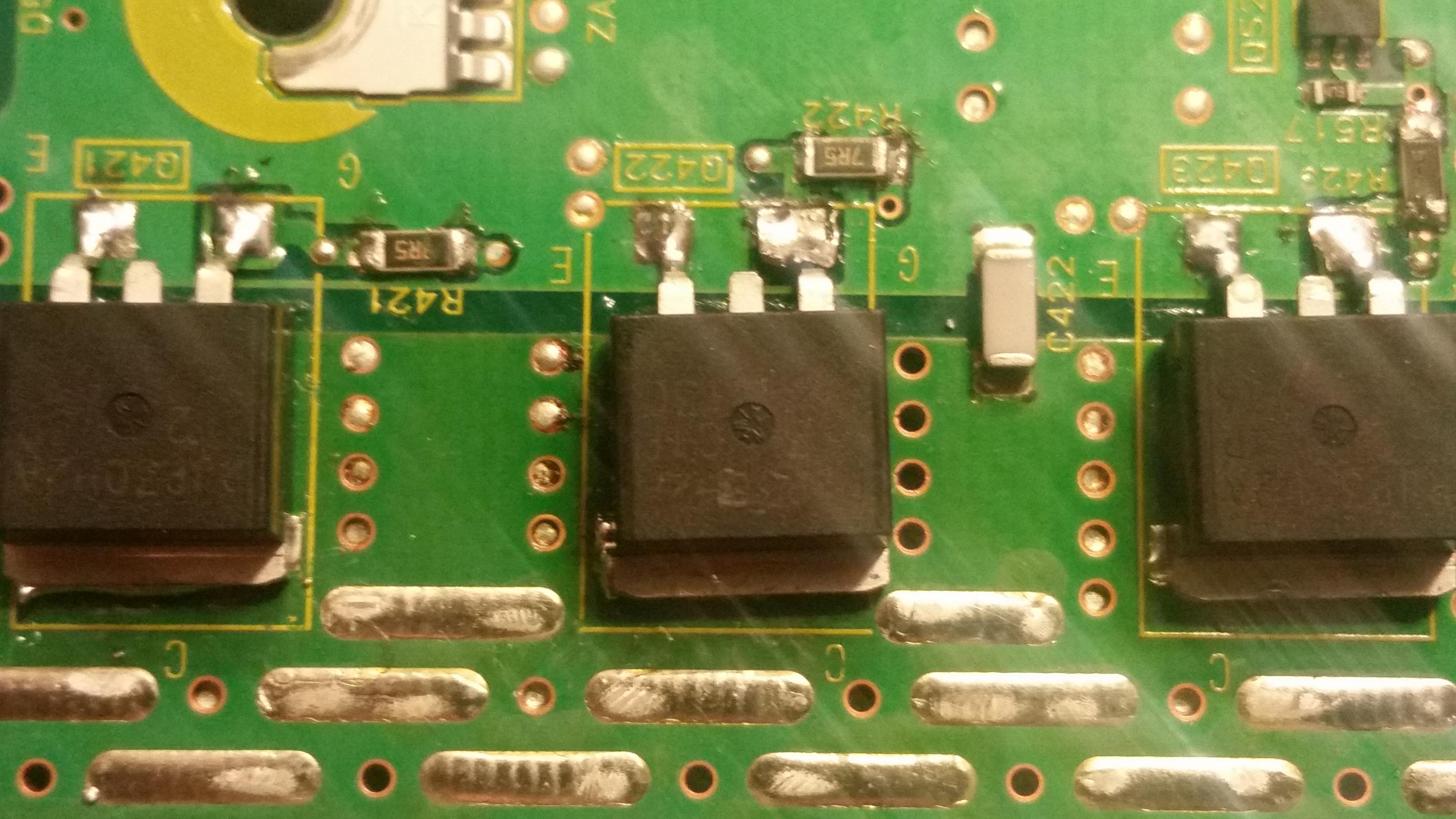

                                        #39
                                        I'll list the parts I swapped per kit instructions as soon as I'm home. Thanks for the help so far
                                        • Pomeroy
                                          • Jan 2017
                                          • 16
                                          • United states
                                          #40
                                          Q421 Q442 Q423 Q403 Q402 Q401 D401 are the ones I swapped out. There was a resistor beside each one except D401 that was changed out
