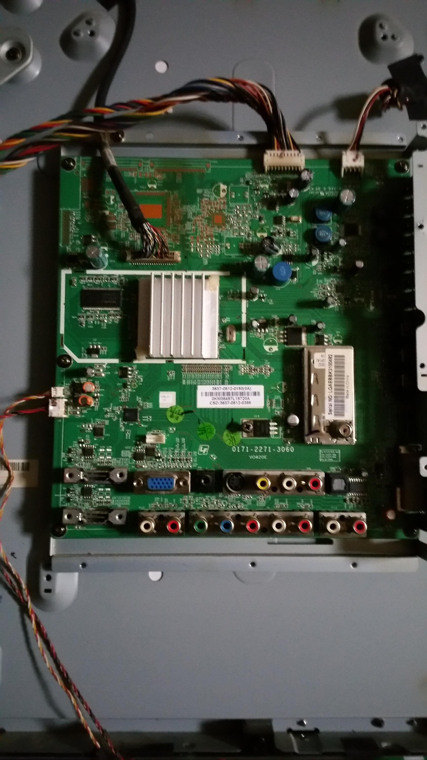

    The Main board # is 3637-0512-0150 (0A) which I have been unable to locate.

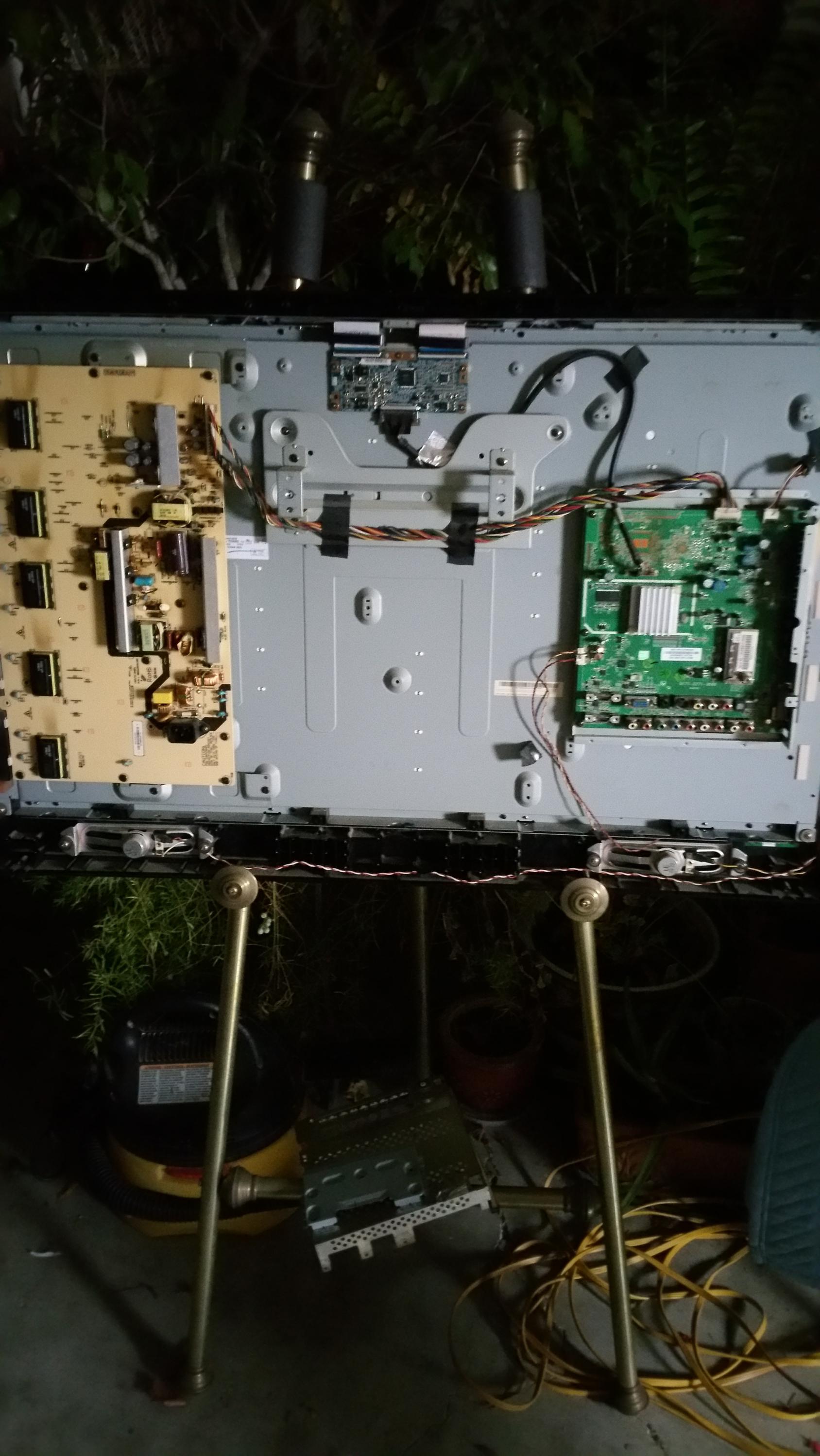

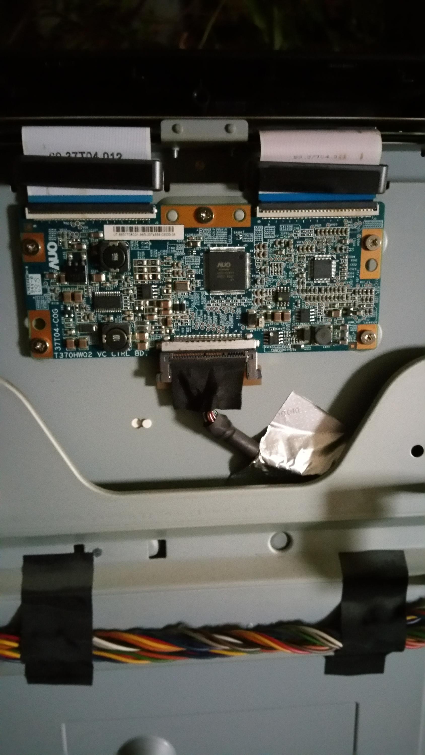

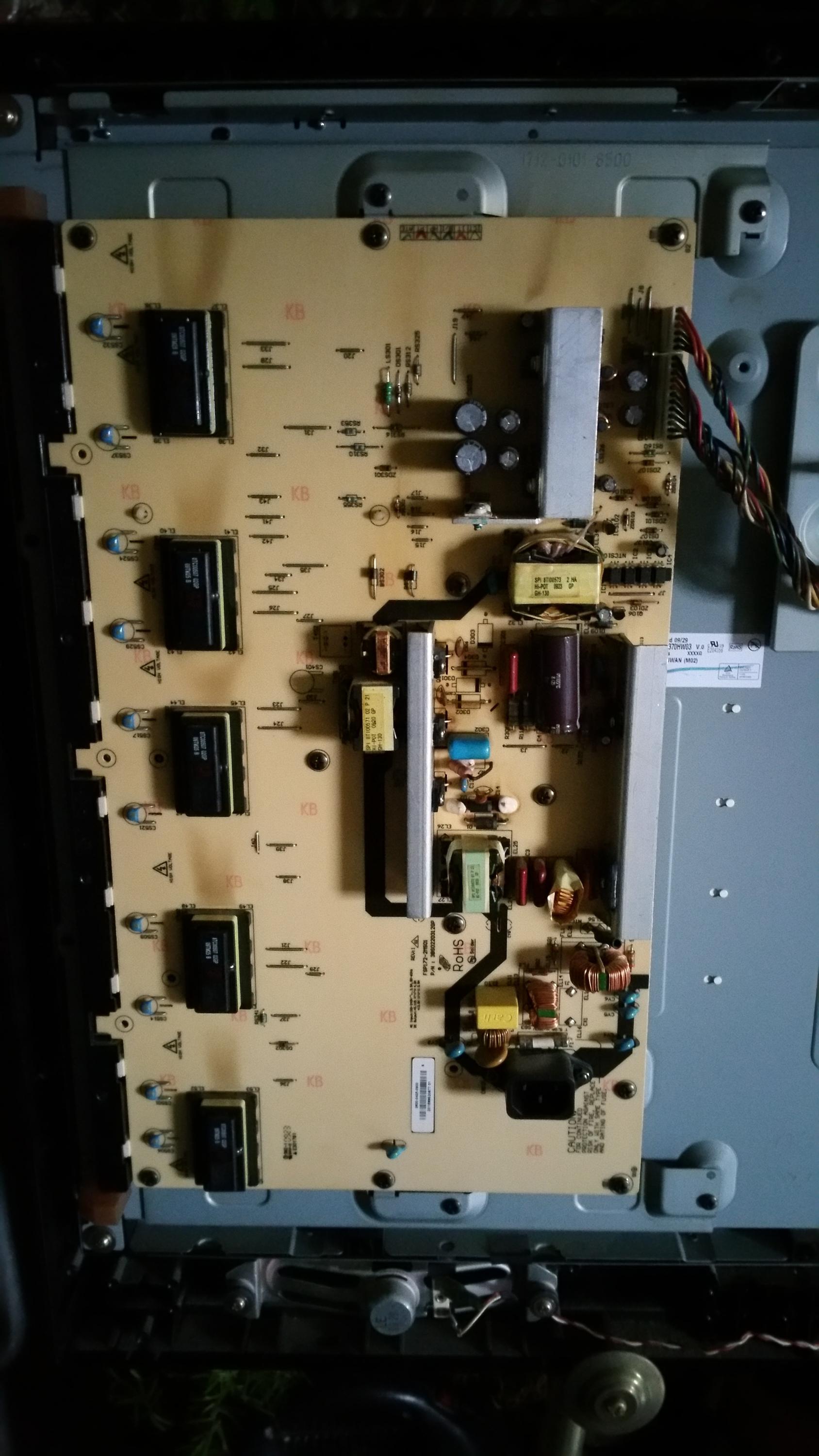

    Re: Vizio V0370M Backlight no Picture
    Haven't gotten any feedback on this so thought I would do some attachments since it is up and running. Thanks
      Just wanted to let all know it was the Main board. Working fine now.
