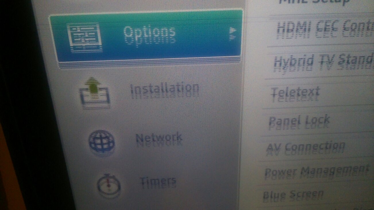

                this is a picture of it its like ok for 5 secs and then goes blury and then normal again and its like that all the time switching back and forth and there is a line going left to right where the bluring occurs

                    It looks like the description of a panel fault as Double Image Distortion Page 39.

                      Re: Toshiba 50L4353D 50 inch LED... panel or t-con fault?
                      but it pulses normal/double/normal/double same time like 5 secs normal 5 bad and so on
                        Hmm I said panel to the first guy as his vid had a solid line on there. But your might not be tbh bud could be solder joints failing etc. Maybe buy it and have a play ? Also I feel bad now as I sold two of these now just waiting for them to go lol

                            there is a solid line too going across where the fault starts
                              Yeah thats panel then tbh, gate in glass driver is breaking down and causing the rest of the address lines to mess up. I say aviod it at all costs. Maybe chuck her £20 for the parts but I would say its scrap.
