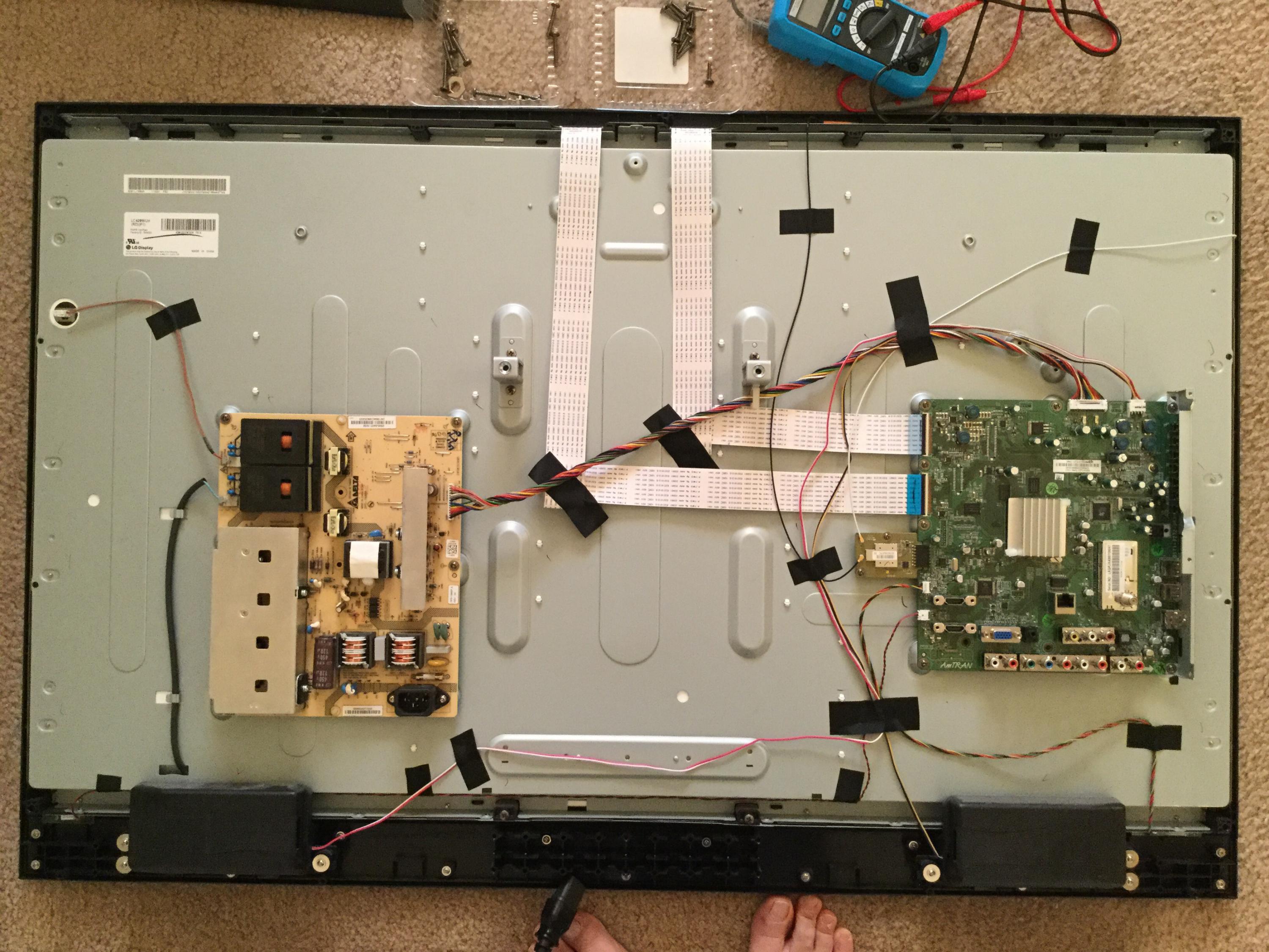

    Hi, I have a Vizio TV E3D420VX and it has symptom as below:
    1. When I press power button, backlight on, power white light on and Vizio V logo is on the screen
    2. Logo goes off, power white light blink one time.
    3. Power goes off by itself and doesn't come up
    4. Same symptom in every time when I press power button.
    Is it an exactly same symptom as you?
    Can it be solved by replacing the power board?
    Or, do I have to replace the main board??

    Posting pictures of the back of your tv showing the boards with clear pictures may help you more with fixing your problem

                          Re: Vizio TV E3D420VX, No picture, power led on+blink 1time+V logo shown=&gt;turn off
                          BTW, we still need to see the whole back side of the board so we can see how all the boards are connected together.

                                    Hi Bud
                                    This picture is back side of tv. Nothing wrong of connection.
