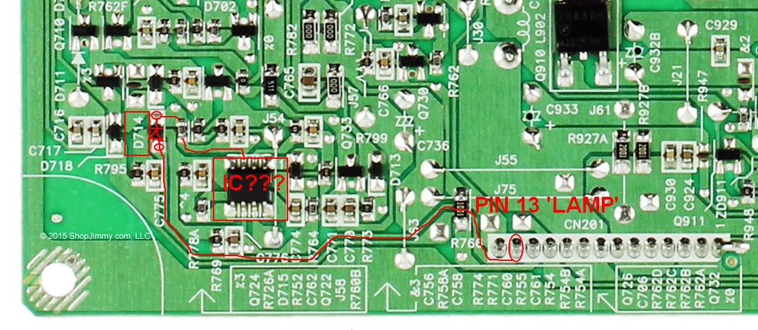

              Sorry, It is pin on, it was late last night tracing the board from the pictures.

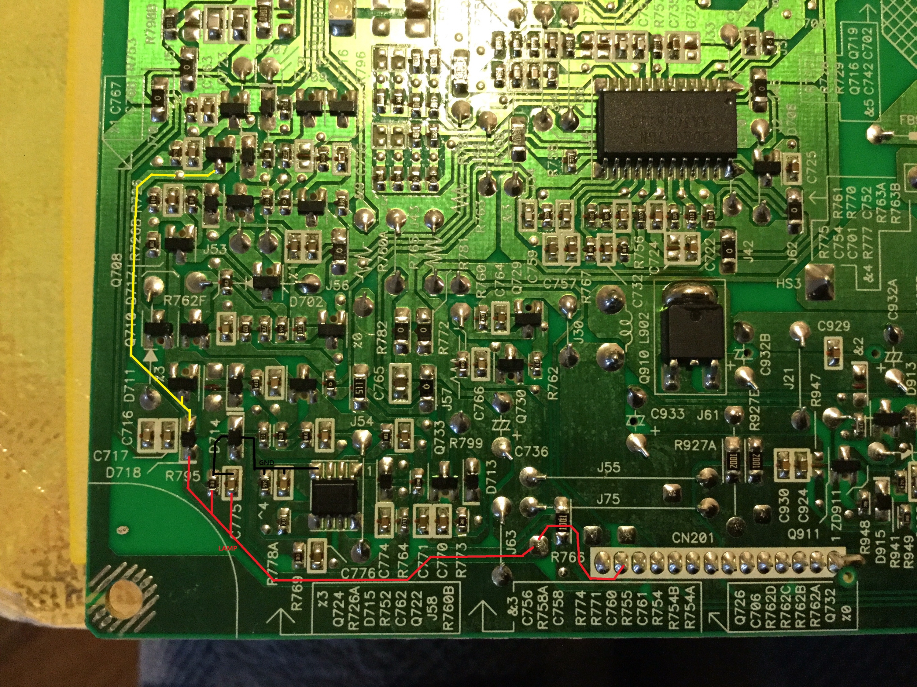

                I examined LAMP trace today morning. Please refer the attached picture.
                RED is LAMP Line
                Black is GND
                YELLOW is after Diode 718. not 714
                LAMP trace isn't connected OpAMP LM2904. It's GND pattern.
                  Re: Vizio TV E3D420VX, No picture, power led on+blink 1time+V logo shown=>turn off
                  So if you Ohm out between pin 13 and the Cathode of D718, shows 0 Ohm, right?
                  If that is the case, then the power supply board is the source sending the HIGH to pin 13.

                    #29
                    Yes, from pin#13 to Cathode of D718 is connected by PCB pattern only, i.e 0ohm. In that case,,, power supply sends 3V to main board and the anode of D718 is connected to the base of Q724. Therefore, in that case, power supply may detect the problem by itself and send the alarm to mainboard?

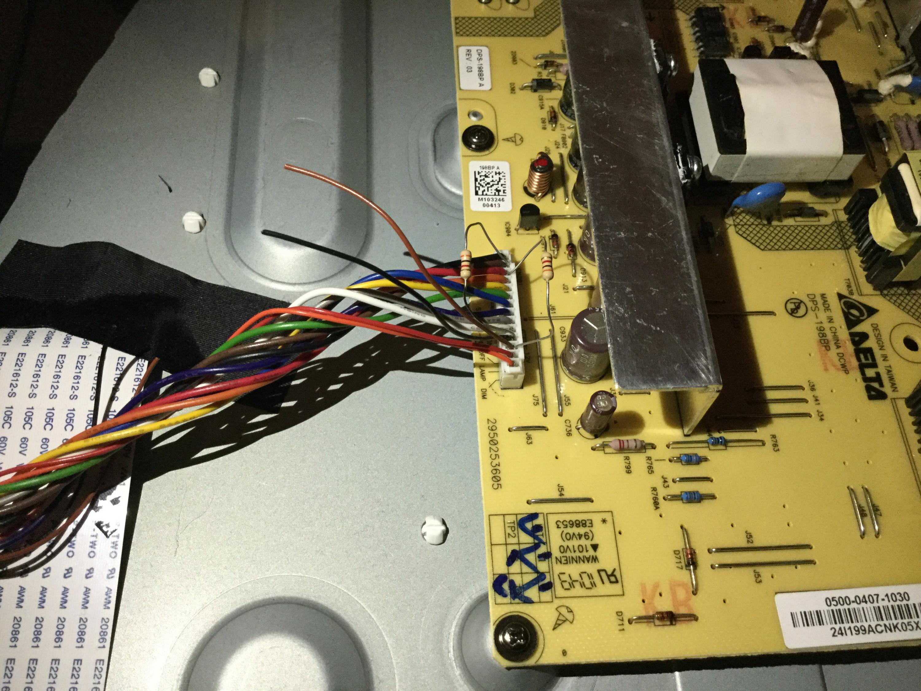

                              Result of post#23: https://youtu.be/6V7tXe7iCeY
                              1.cut wires of PSON & ON/OFF
                              2.measure LAMP (power supply and main board side both)
                              R1. power on and backlight on
                              R2. DCV of LAMP goes over 2V and immediately power & backlight off.
                              R3. At that time, no power_white_led is no blinking.
                              R4. No more stays than no cut off PSON & ON/OFF wire. Immediately power & backlight off after on.

                                        I'm sorry, but it's true. Please see this youtube link. http://youtu.be/6V7tXe7iCeY
                                        You can see power & backlight off immediately after power on & backlight on.
                                        And check the picture. I cut PSON & ON/OFF wires.
                                        In my case, I use 3K instead of 1K which I have. (I think it's no problem)
                                        When I was testing the power supply using the resistor, no connection to main board and putting resistor between 5V--PSON & 5V--ON/OFF. No connection for other signals.
