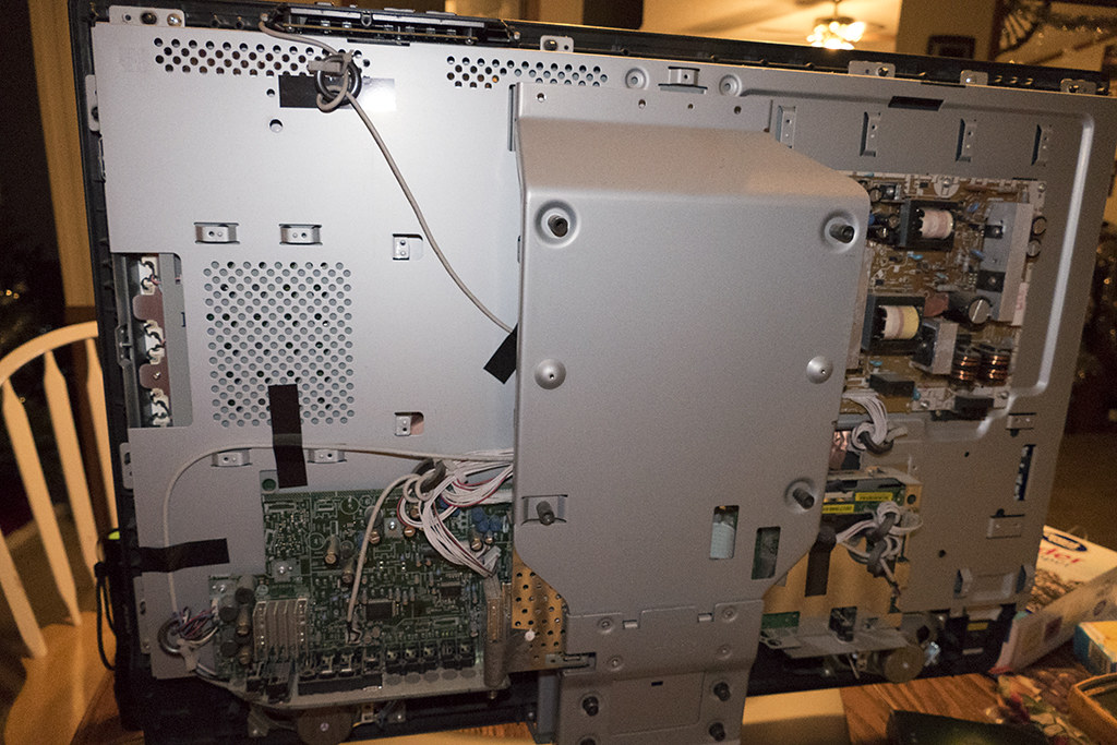

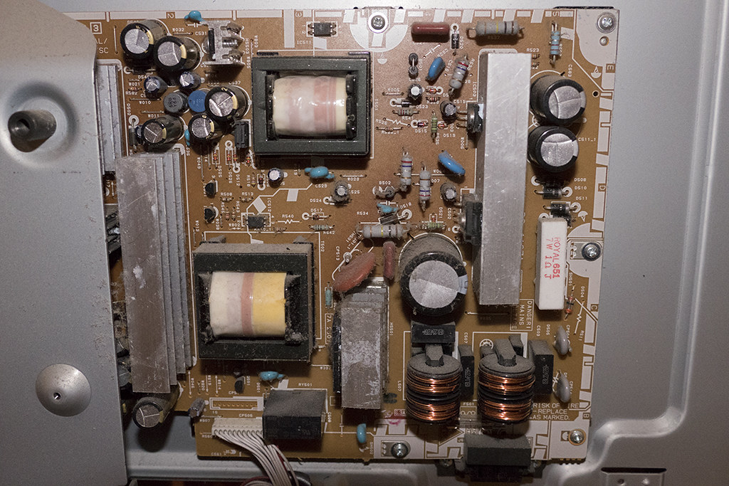

          OK, Here's what I got.
          Whole back:
          P1020080-sm
          by Alan Mars, on Flickr

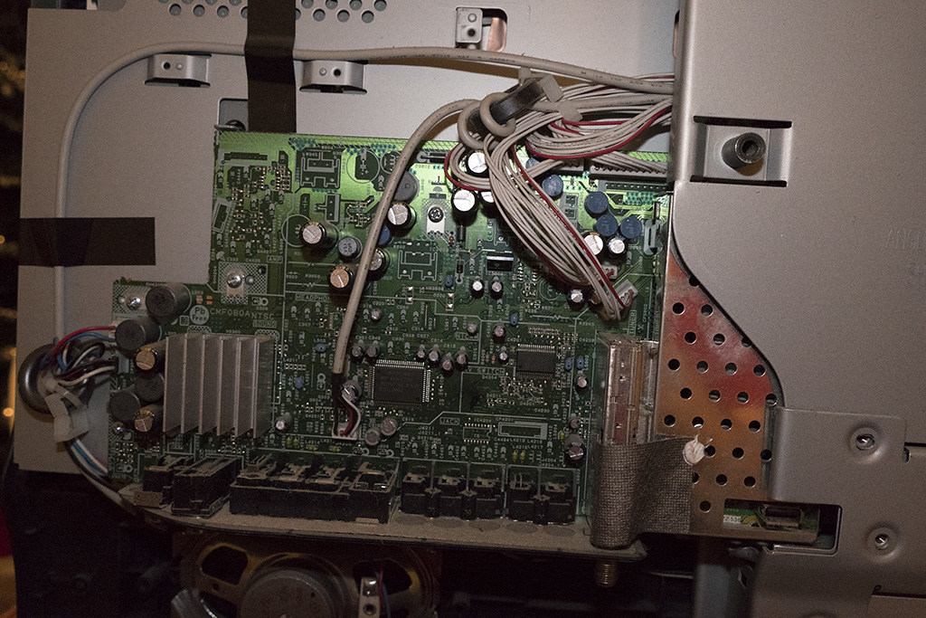

          Left Side Board:
          P1020082-sm
          Right Side Board:
          P1020077-sm

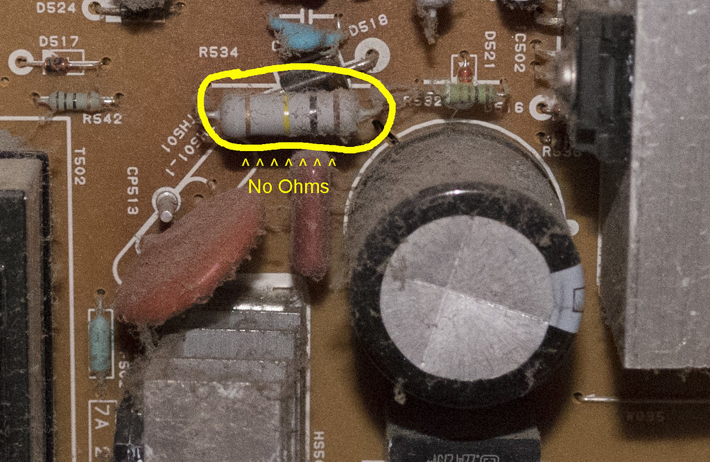

          Found one resistor that didn't Ohm out:
          P1020077-No Ohms

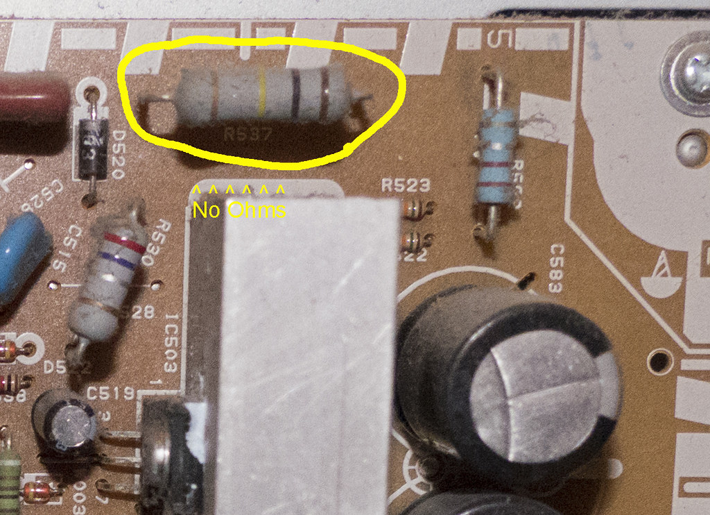

          Found another Resistor that had no Ohms...:
          P1020077-No Ohms 2
          So, I'm assuming that is what's wrong with this. I'm not getting any Ohms through these resistors.

            Re: Friends Sharp LC-32SH2OU Fades to White
            That is 100K (Brown Black Yellow) resistor, what scale on your meter you set it to?
            T eh T-CON is hidden under all those sheet metal.
              I'm using a Fluke 114. I had it set to audible. When I set it to regular Ohms I get 82.4 on the first one and 99.9 on the second one.
              I guess I'll need to put the TV on the floor to get to the T-Con. That metal is connected to the base stand.

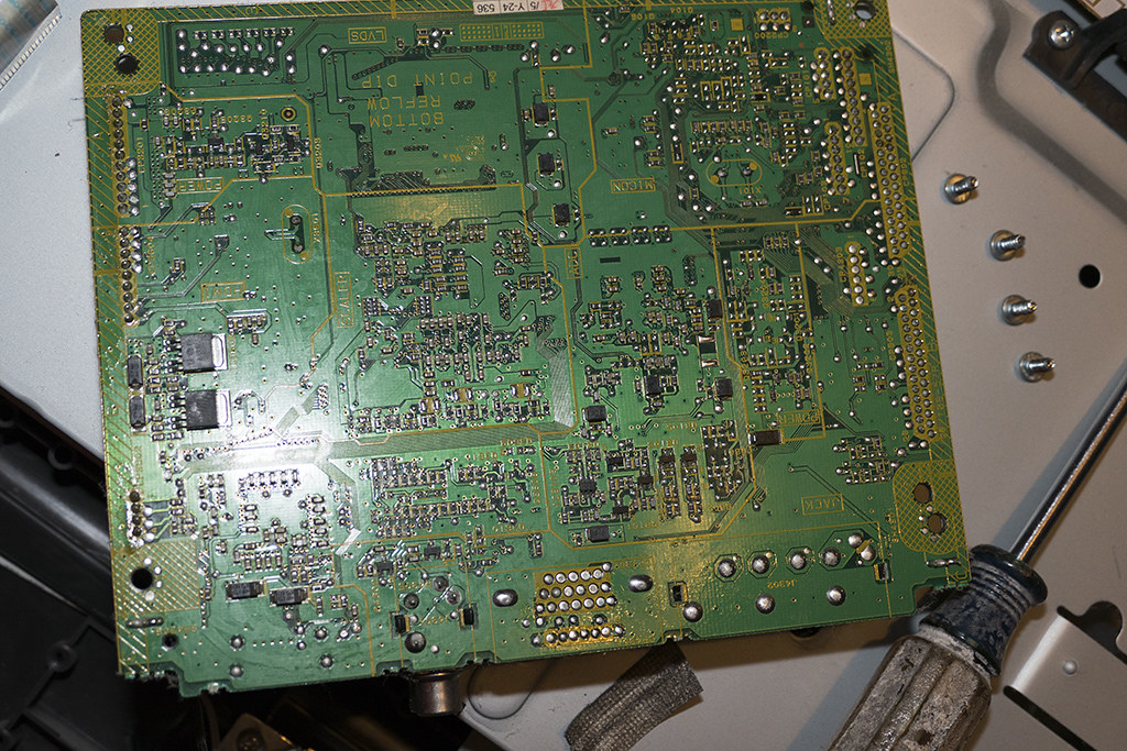

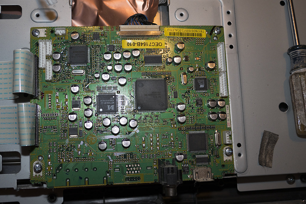

                Here's a photo of the T-Con board.
                P1020085sm
                And the underside...
                P1020086-sm
                    When you check the resistance of the resistor, always put it on the Ohm mode.
                                        I put the new (used) Scaler board in yesterday and everything seems to be OK. I haven't really tested the TV yet with a movie. Maybe I'll get around to that today or tomorrow. Seeing the "PLEASE WAIT" message was a huge relief!
