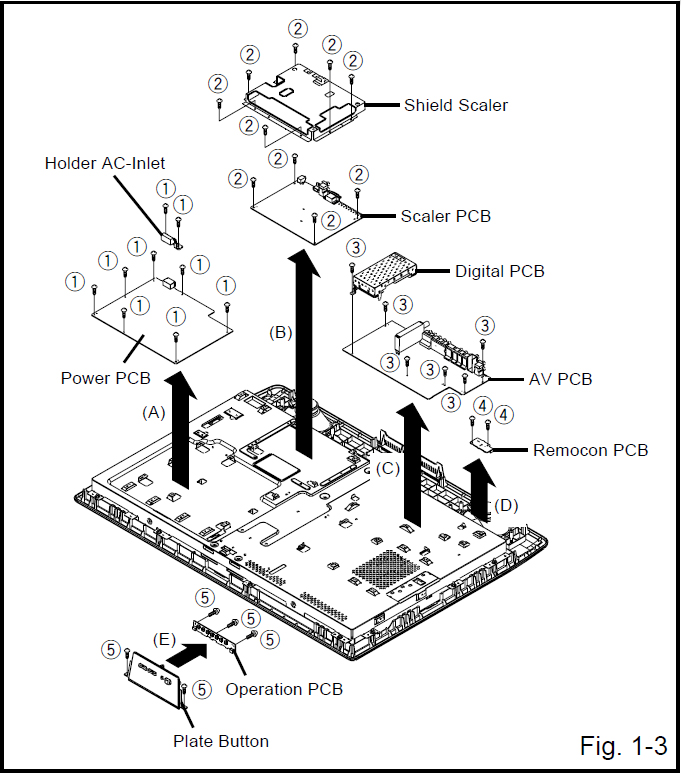

      According to these photos there is no T-Con board on this unit. There's a Power PCB, a Scaler PCB (which is what I've already replaced), a Digital PCB which is mounted to the AV PCB and there's also a Remocon PCB. Is the Remocon PCB what you're referring to as the T-Con?

        Now... there does appear to be an Inverter Board that I'm not seeing on the diagrams in the manual...
        Update: There is no reference to the inverter but I am seeing it on the left side under the LCD cover.

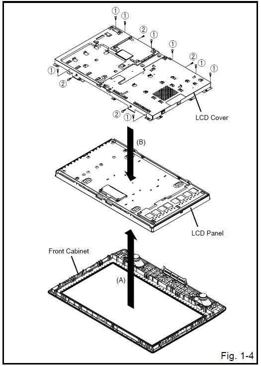

          Re: Friends Sharp LC-32SH2OU Fades to White
          See what the T-CON board looks like:
          http://www.shopjimmy.com/catalogsear...harp+LC-32SH20
          You need to lift up the LCD cover as shown in pic #2 of post 22, then you need to remove the metal shield to get to the T-CON. This set is not designed to be easy repair.

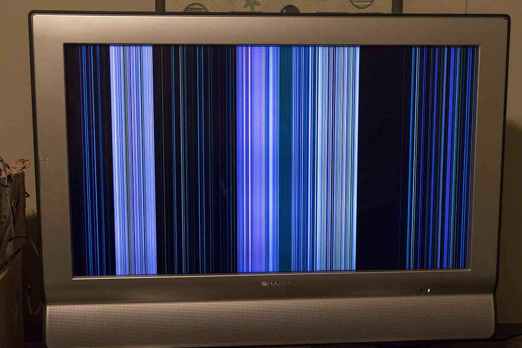

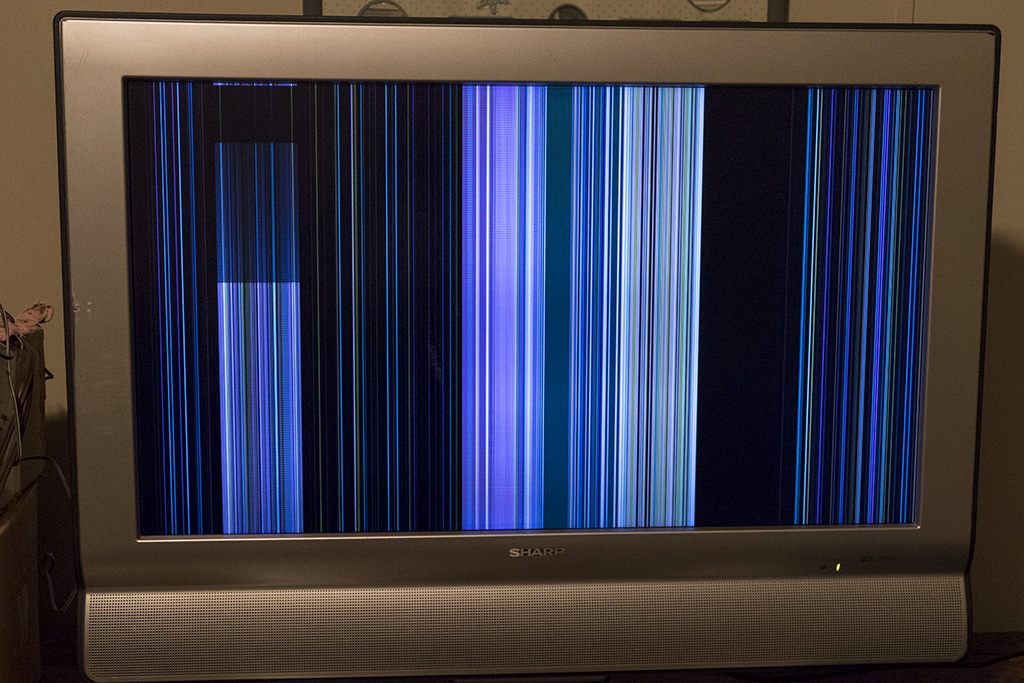

              New T-Con Board came in...
              Not good...
                Is that what you're seeing right away? Not even good pictures for seconds? If that is the case, this replacement is worst than the original one.
                    Yeah, this was right from the get go. I will check the connections tomorrow but I am quite sure they're all tight.
                      Must be a bad T-Con board. I checked all of the connections, turned the TV back on after I had it assembled and got the same results. Put the old T-Con board back in and it worked like it did before I switched the board. So it is a bad board.
