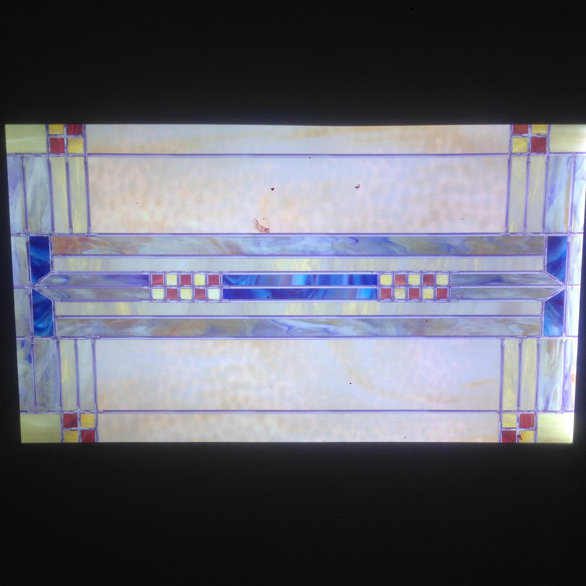

          here is what it looks like turned on

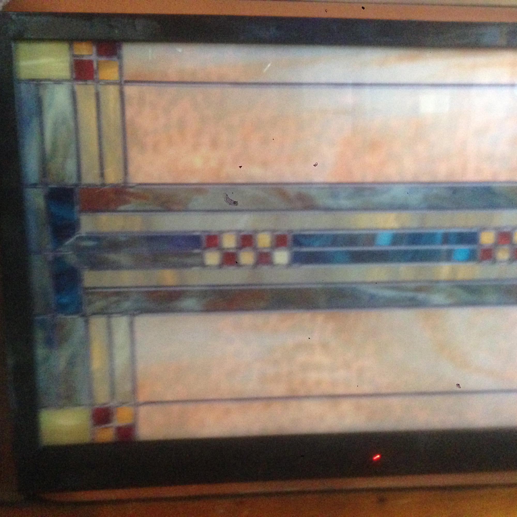

            Turned off
