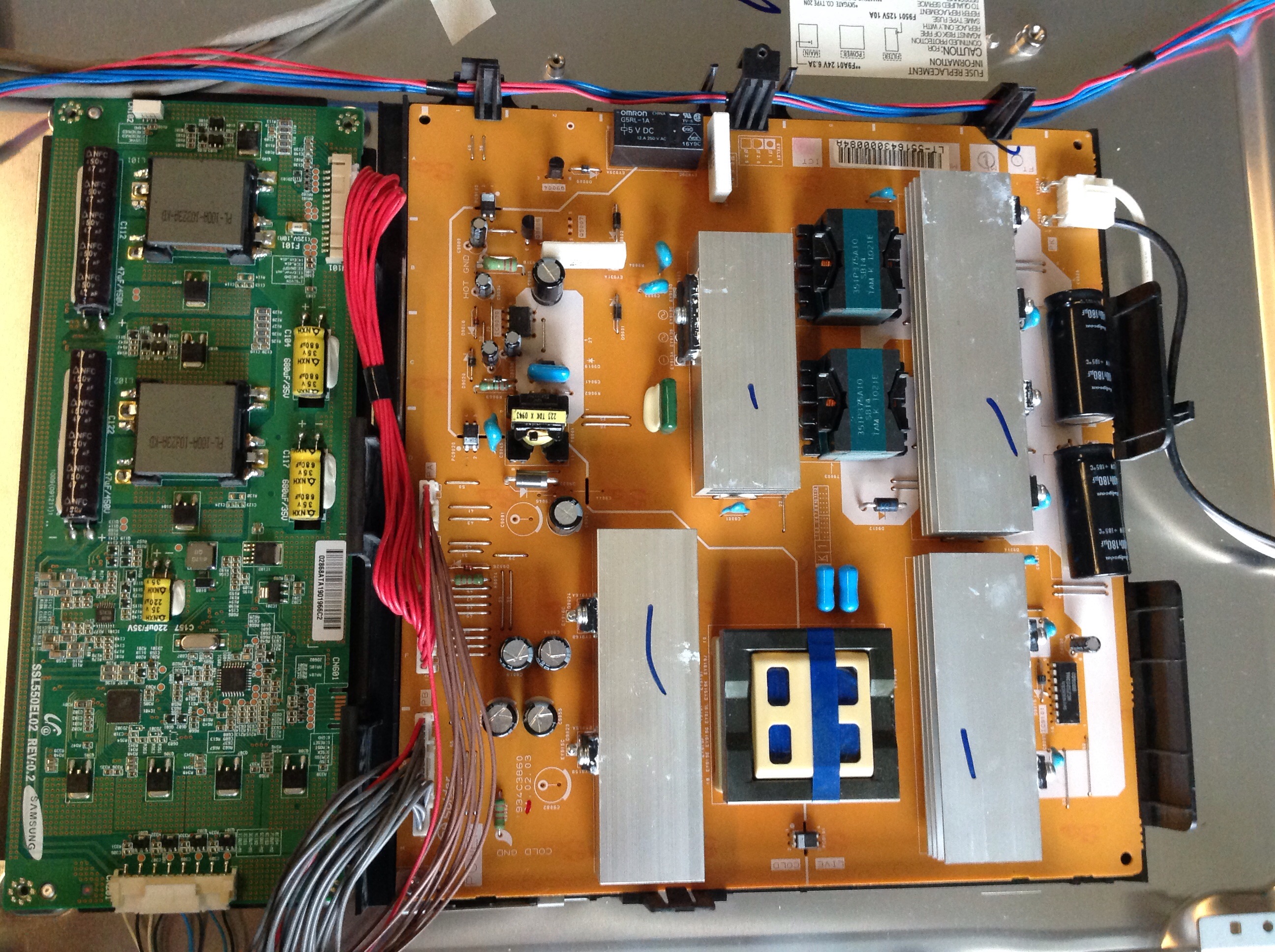

        Ok can you upload some pictures of th boards inside the Tv. Either there isnt a voltage present or the Inverter is faulty by the sounds of it.
          Re: Mitsubishi LT 55-164 constant green flashing light
          Here is photo of power and inverter boards.

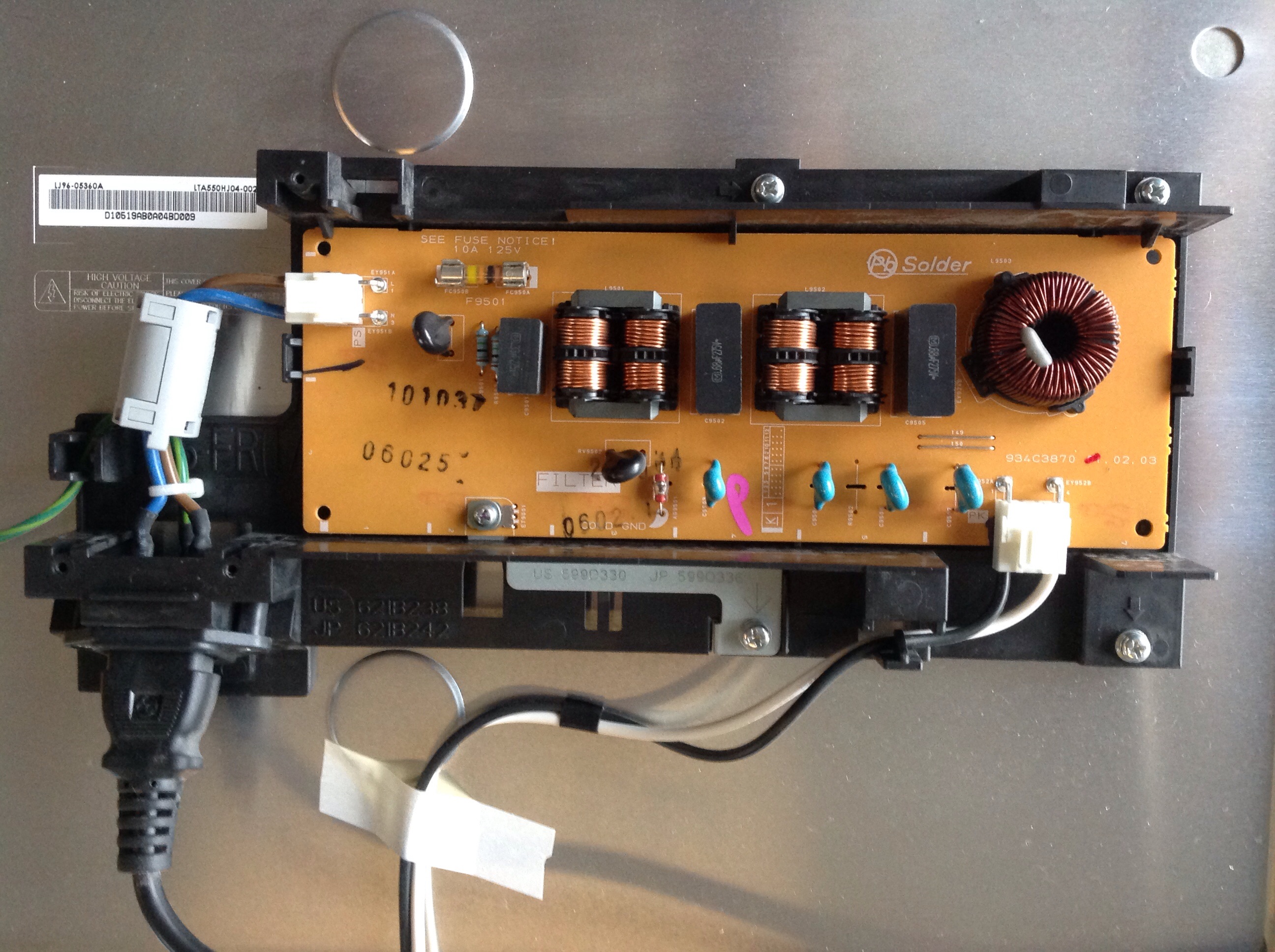

          Can't see any obvious signs of bad components on any of them. Checked and got 120v at filter board coming in and goin out to power board as well as going into power board, all ok. Output connectors of power board are not labeled with their voltages to make checking easy.
            Filter board photo

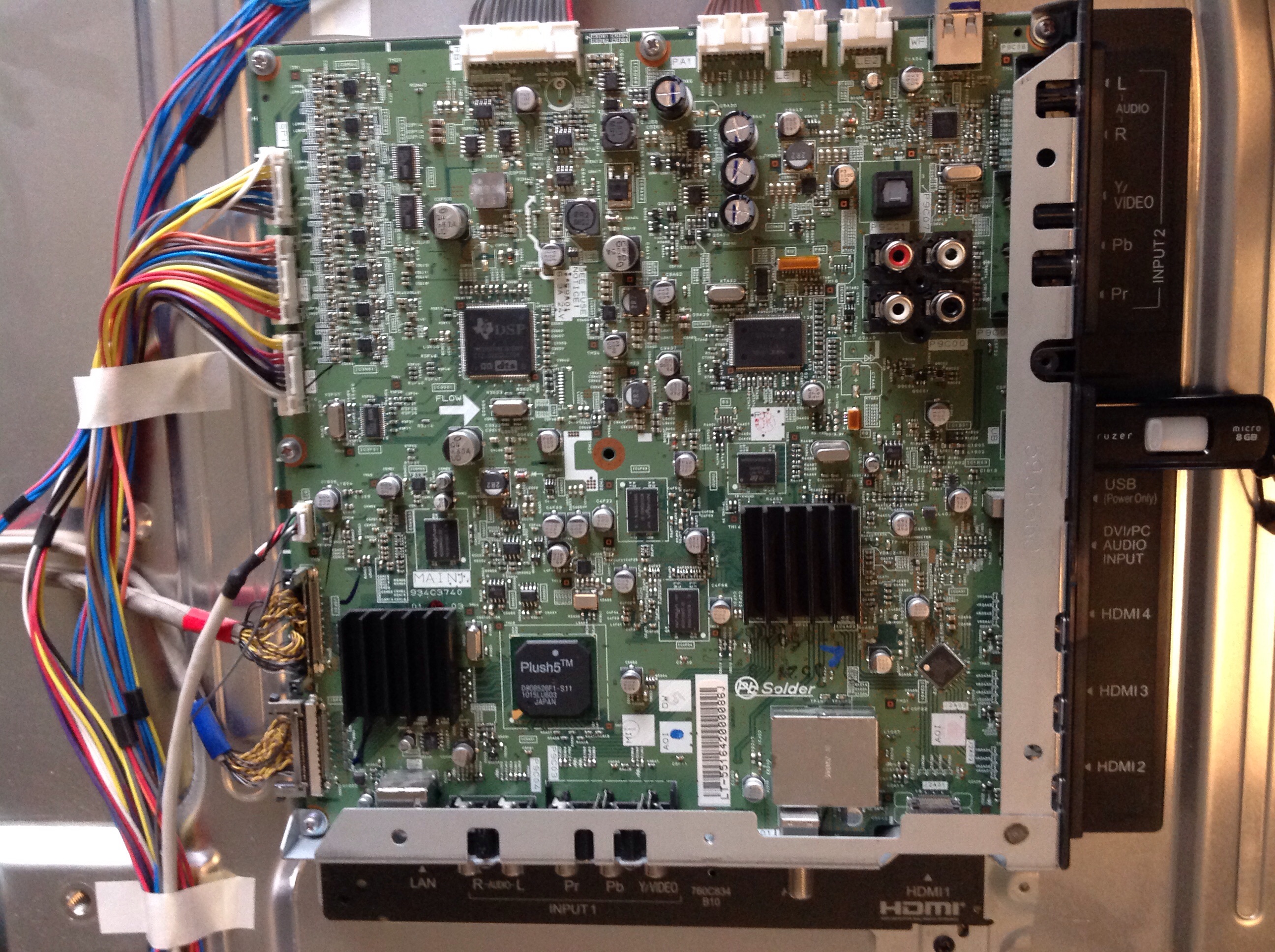

              Main board
                Well, no real suggestions from anyone so I did what I swore I wouldn't do...started swapping boards. Replaced power board...no difference. Next replaced inverter board and absolutely no difference. Unless someone gives me some good reason to change the main board, I think I'll just keep searching for someone who has had this problem with an LCD/LED Mitsubishi and successfully repaired it! Would even settle for a definitive "can't be fixed". Just don't know what else to do. Help!

                    Sorry didnt see your message, you have persistent 24v ?
