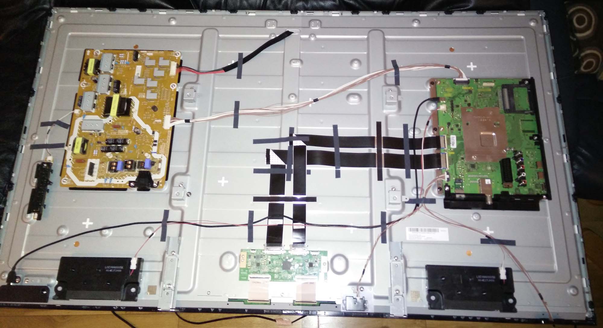

    Hello all
    Have a Panasonic 48" LED TV model no. TX-48AS640B. Just over 1 year old. When switched on the backlight comes on but no picture is displayed. Can hear the menu being navigated. Suspecting main board, any ideas ? Hope someone can help.
    thanks
    Mal

    Re: Panasonic 48" LED TV, backlight on but no picture

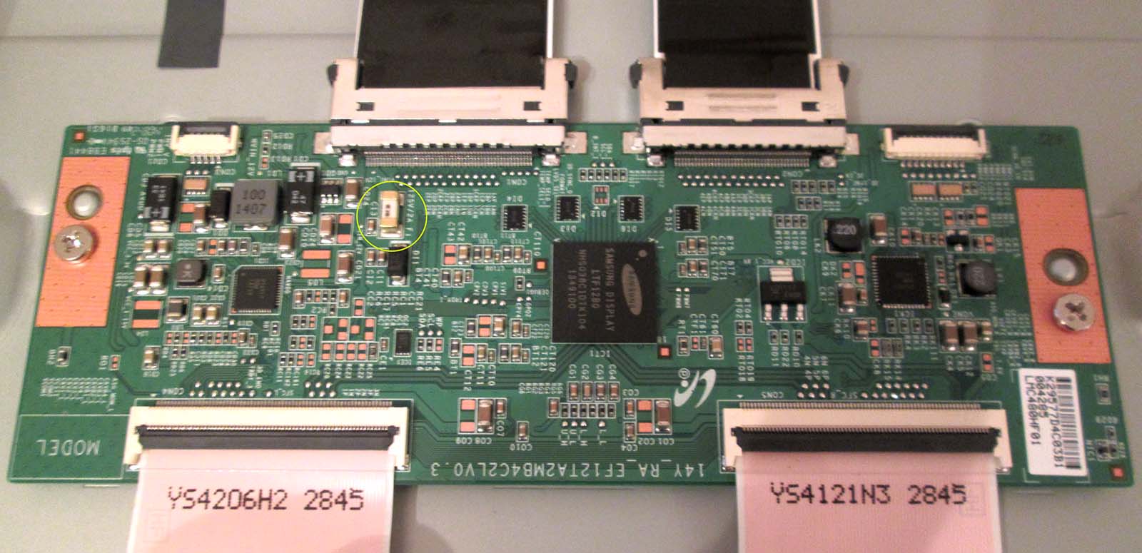

    Check for voltage on both sides of the TCON fuse. It should be near one of the connectors
    going to the main board. If you send a clear picture of the TCON board we should be able to point it out. (it's the one at the bottom of your picture) There should be 12V or 5V on both sides of the fuse. Some nay not have a fuse though.

      Hi
      Thanks for that. Think I identified the fuse (circled). 12v both sides !
        Try having one ribbon cable between the T-CON and the LCD panel connected one at a time to see what you get on the screen.
          Hi
          Tried disconnecting individual and both cables from the T-con to the screen. Made no difference.
            Hi all been a while I too am facing this blank screen issue on same tv any info and tcon fuse tests fine
                              well thats the main board and tcon replaced for good working ones and still nothing but a blank screen
                              also checked out all screen tabs etc no damage faults etc
                              im starting to think its the psu but nothing visual or blown
                              does any have a service manual or know the voltage the power board gives to main
                                Fuse on panel FRP boards?
                                • wreksta
                                  • Aug 2013
                                  • 508
                                  • england
                                  fuse on frp where is this fuse like mate
                                  • freakaftr8
                                    • Oct 2012
                                    • 3743
                                    Located in the long boards that are attached to the panel itself. They are concealed within the frame.
                                    Of course this is just a hunch. I have seen panels that have fuses built on to these boards as a precautionary secondary step incase t-con fails
