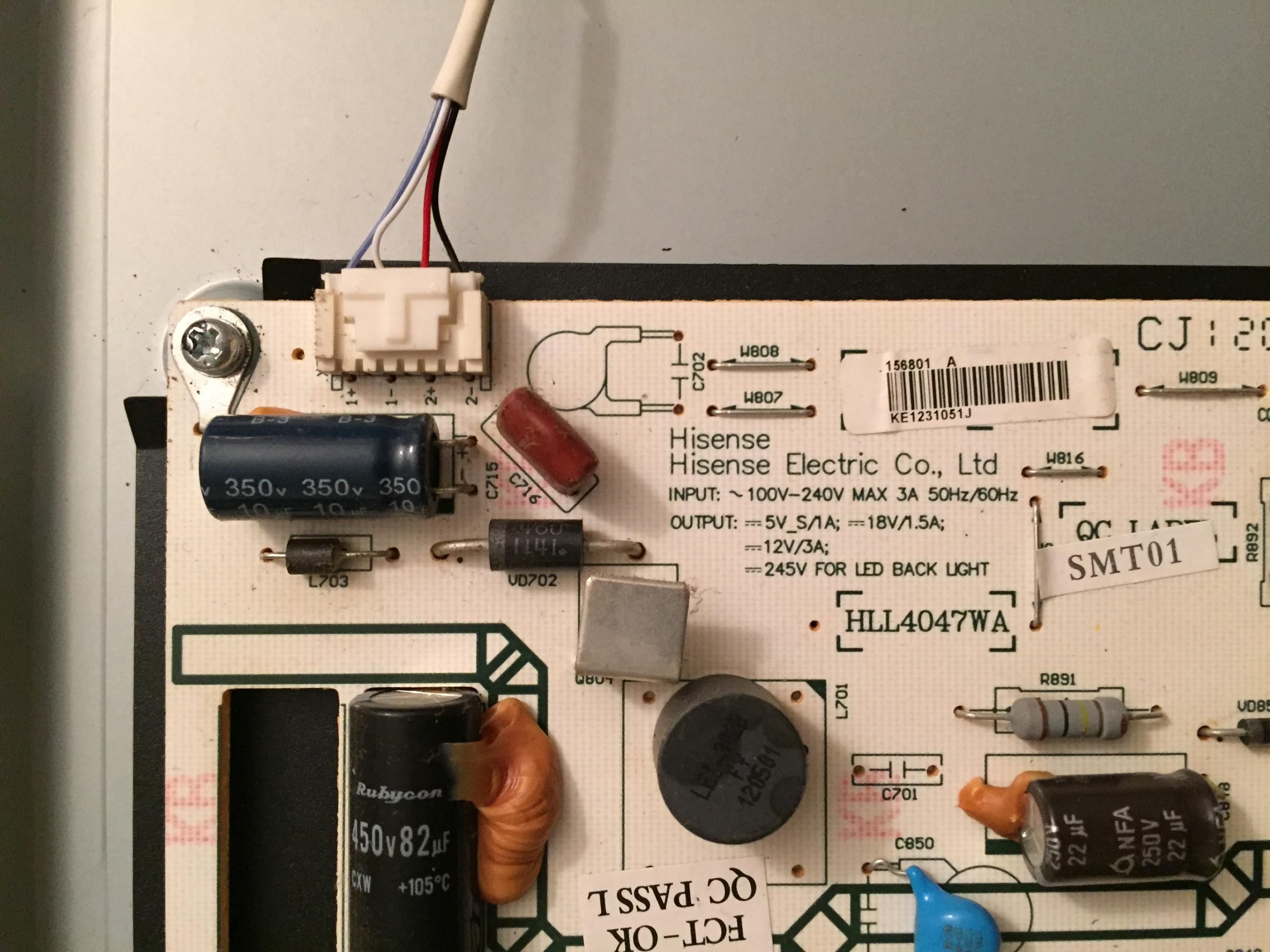

    Powers on and there's sound but no backlight. This is my first time troubleshooting an LED backlit TV so I'm a little lost as to what to look for.
    The backlight connector with the +/- do you probe those points or keep negative lead on cold ground?
    I probed the capacitor c715 right next to the connector positive side and measured over 300v that quickly decreased while the Tv was on, this was both with led connector plugged and unplugged. When powered off and back on, the same behavior happens. Not sure if that helps determine something?

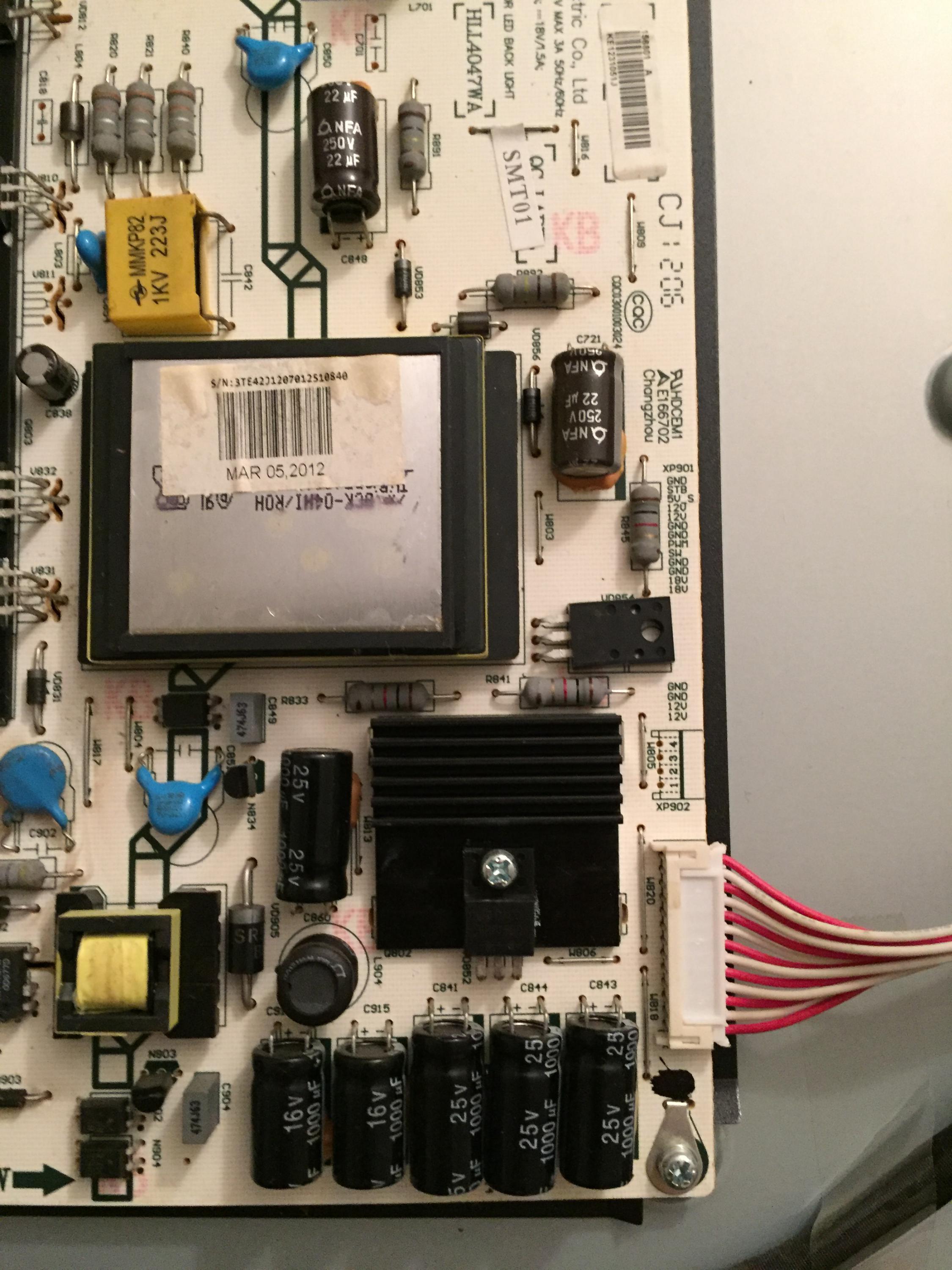

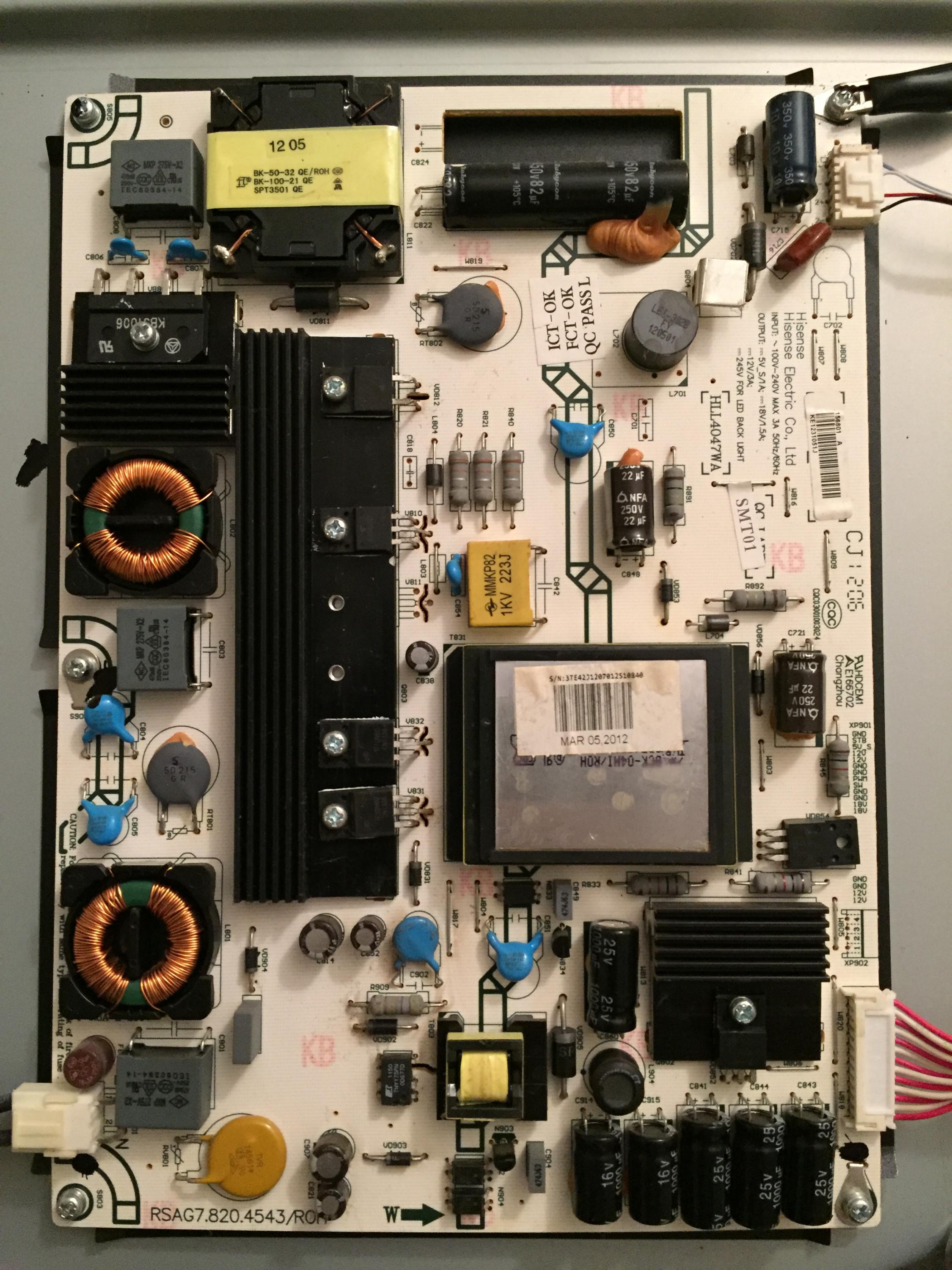

    This psu looks intimidating for some reason, can someone explain each section to me? I'm used to looking at a CCFL psu

    c715, and c716 should be checked.
    716 looks bulged.

          Re: HISENSE F42K20E LED Tv - No backlight
          The LED Voltage output went up to 300V because it does not have any load due to open circuit in the LED string somewhere then it goes into OVS (Over Voltage Shutdown).
          As you can see the Voltage should be 245V (with load) as printed on the board. The filter cap C715 for LED power supply is rated at 350V.

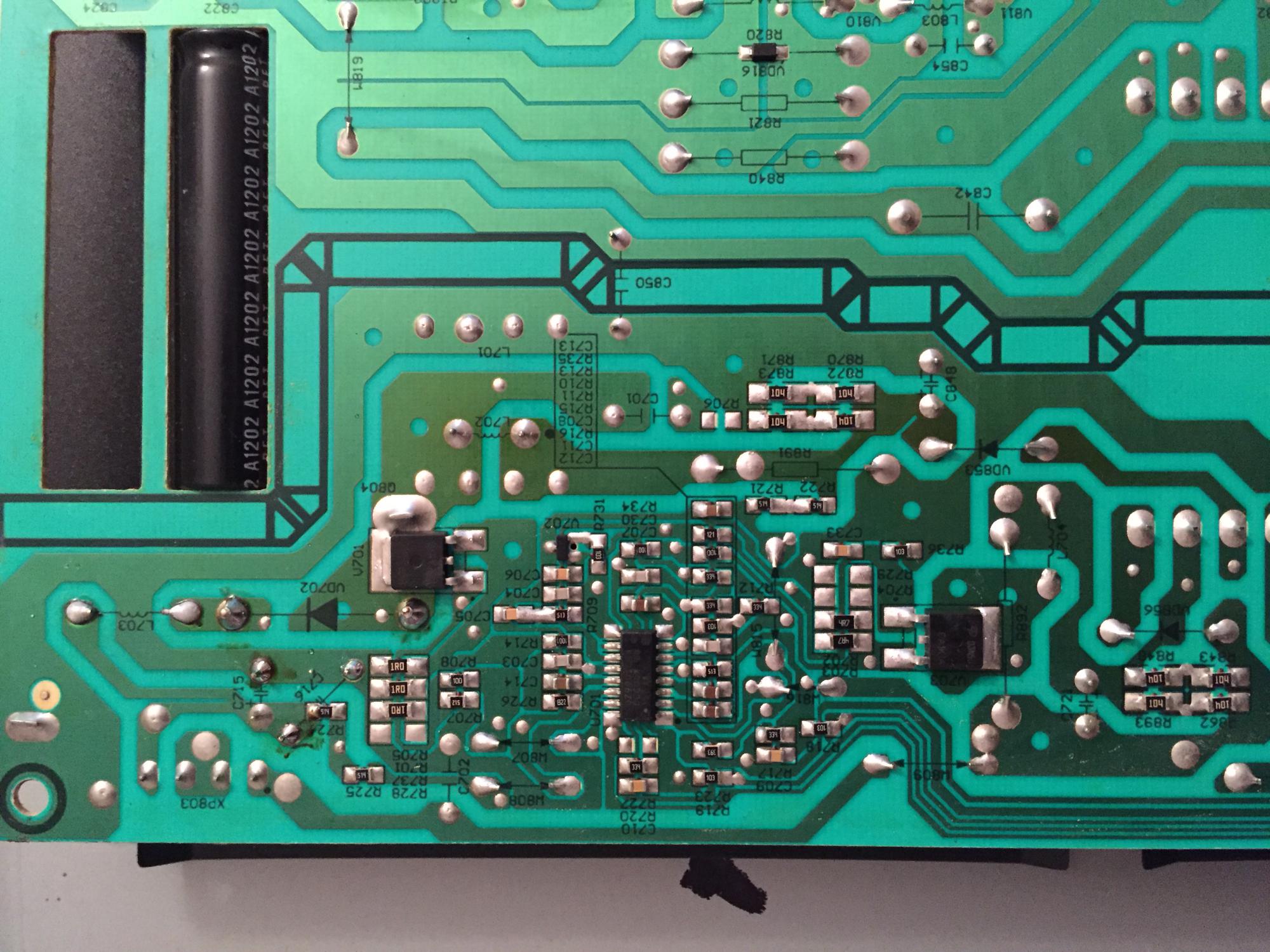

                                I must have misdiagnosed originally, when I probe + of the 10uf 350v capacitor connected to 1+ terminal of led strip it measures in millivolts and slowly climbs to 1v then drops.
                                Here are some pics of backside of the board, some connections looked questionable so the flux residue is from my resoldering some points.

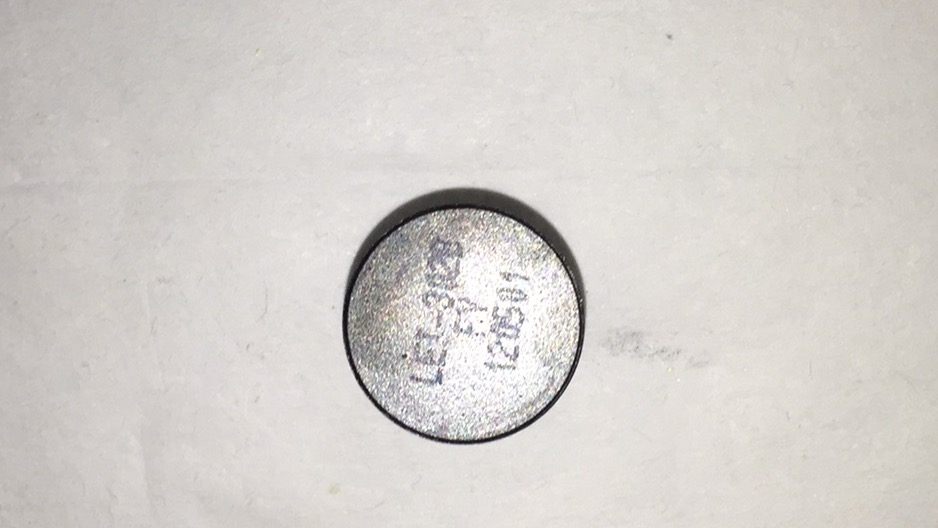

                                        Removed L702 and it tests open. Problem is I can't find anything online using the part numbers. Ended up soldering in a .02mH inductor from a scrap board and backlights came on. Reads 134v to 1+ of led connector.
                                        Is it safe continuing to use this inductor? It's smaller, most likely the original was a higher value
