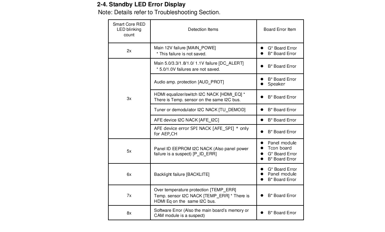

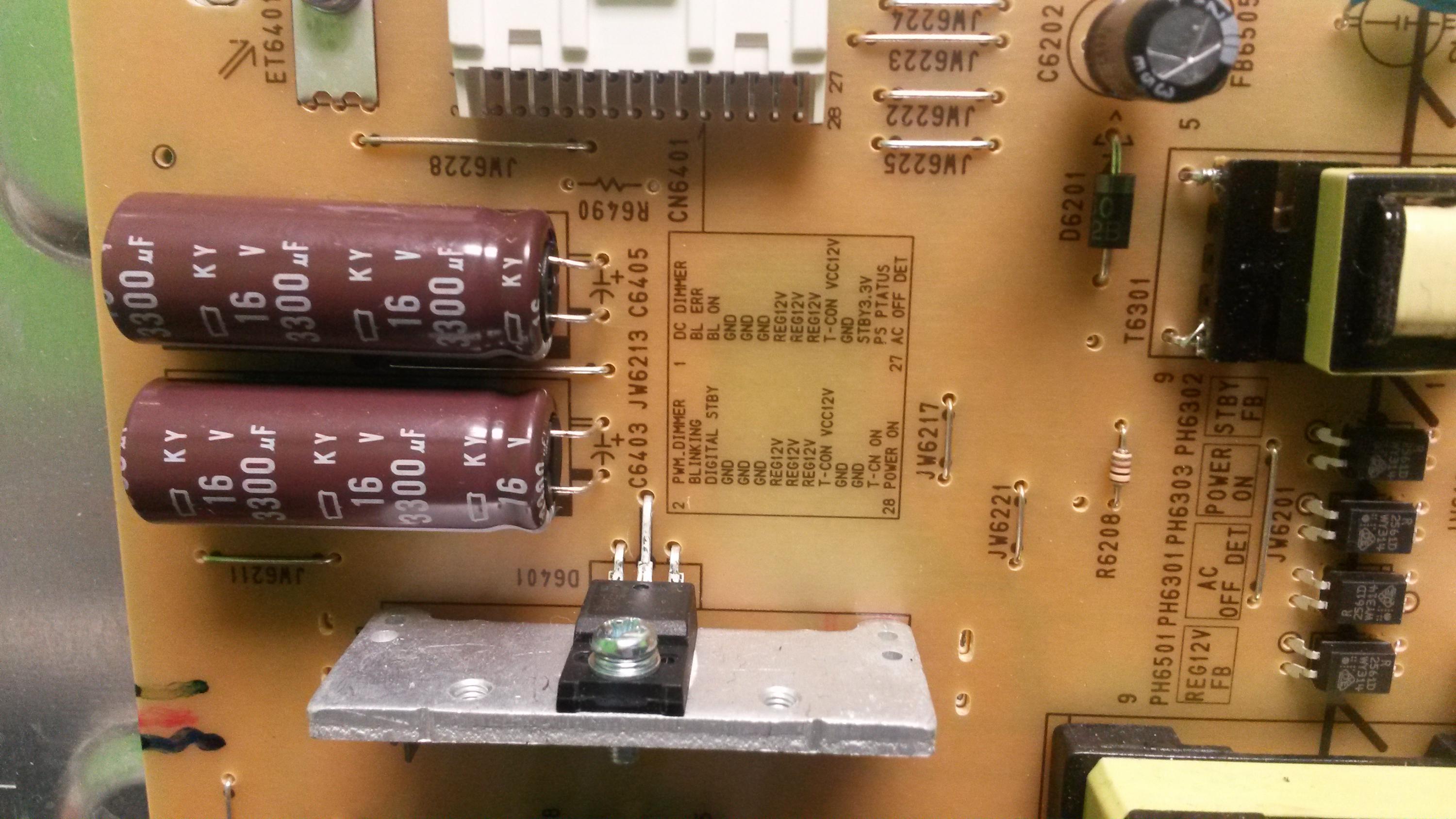

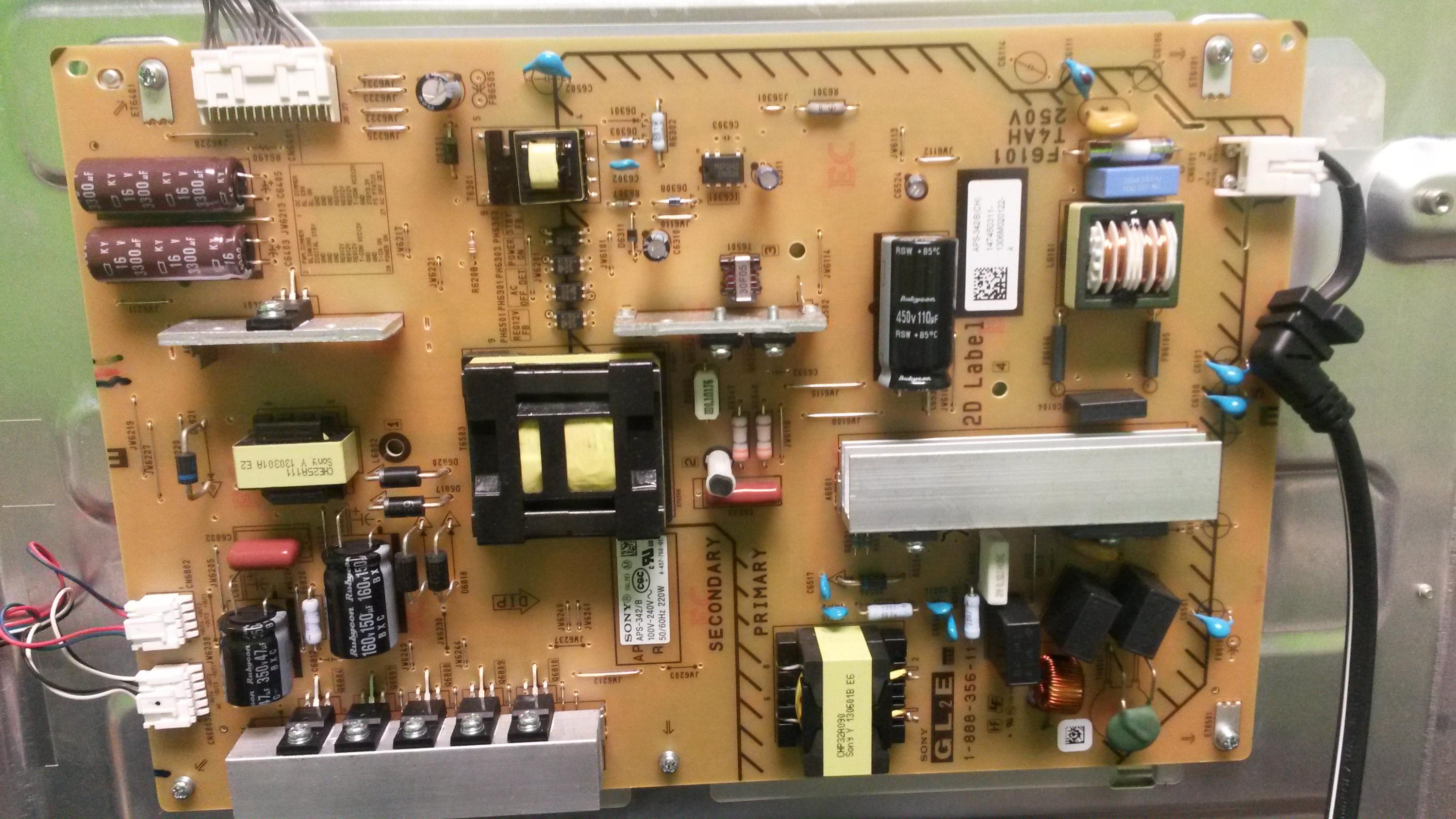

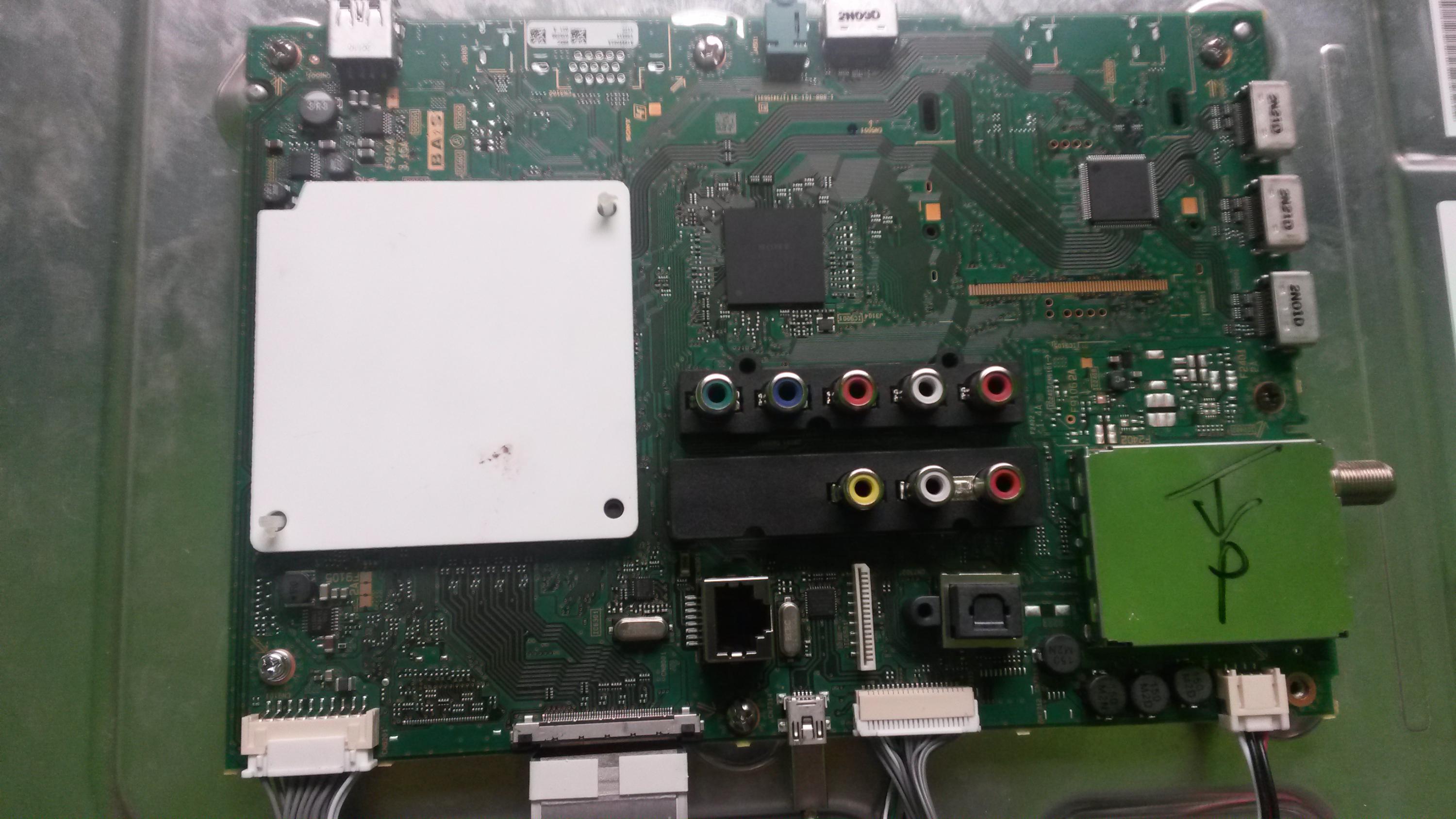

    kdl-55w802a 8 blinking light
    hi i have a sony kdl-55w802a it starts up with quick flash of light on the display then the error light with the sony log on it gives off a bright white light then turns to green and amber then it stops and gives of 8 red blinking lights any help would be help full

    Re: kdl-55w802a 8 blinking light
    this is the picture if needed
      Service manual, big download:
      http://elektrotanya.com/?q=showresul...at2=schematics
        it is software error.
