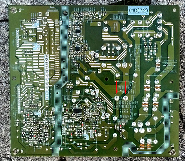

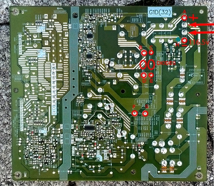

Re: SONY KDL-32NL140 no power light

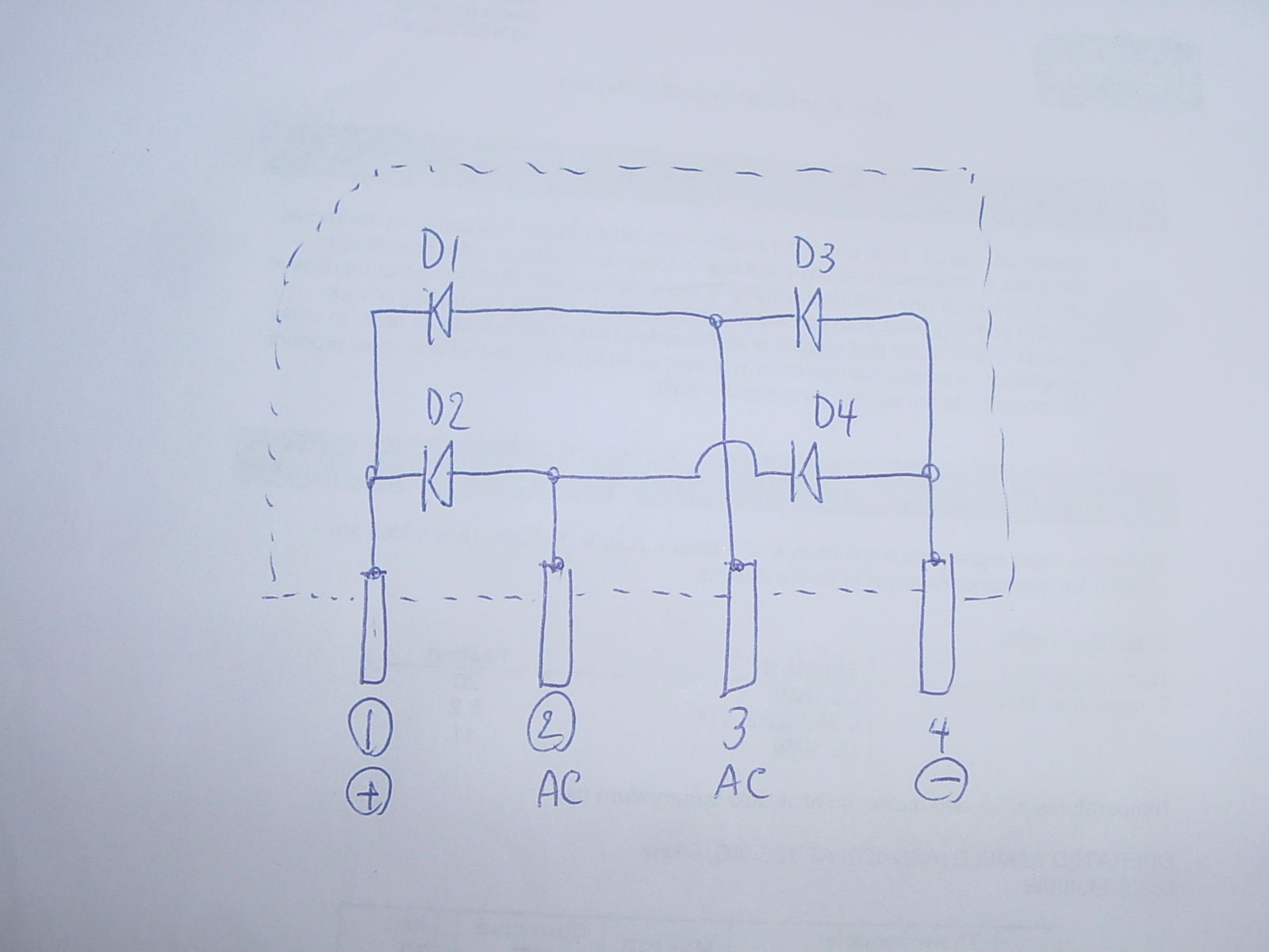

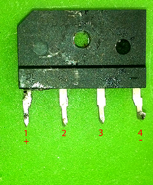

The readings look bad, especially this one:
Diode mode
Pin 1 =
Pin 2 = Black or Red
Pin 3 = Red or Black
Pin 4 =
reading = 0.l
That would have caused the main ac fuse to blow since pin 2 and 3 are the AC input pins.
Please pull the bridge off the board and test it again.
This one is also wrong:
Pin 1 = Black
Pin 2 =
Pin 3 =
Pin 4 = Red
reading = .478
