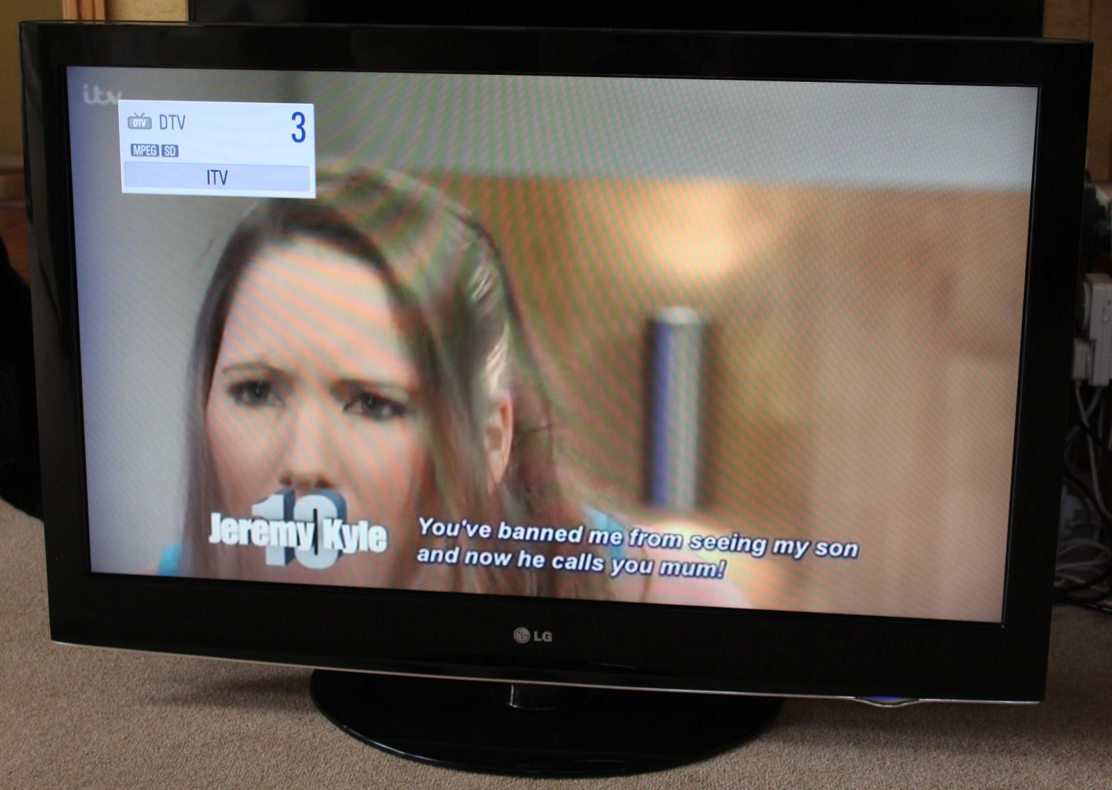

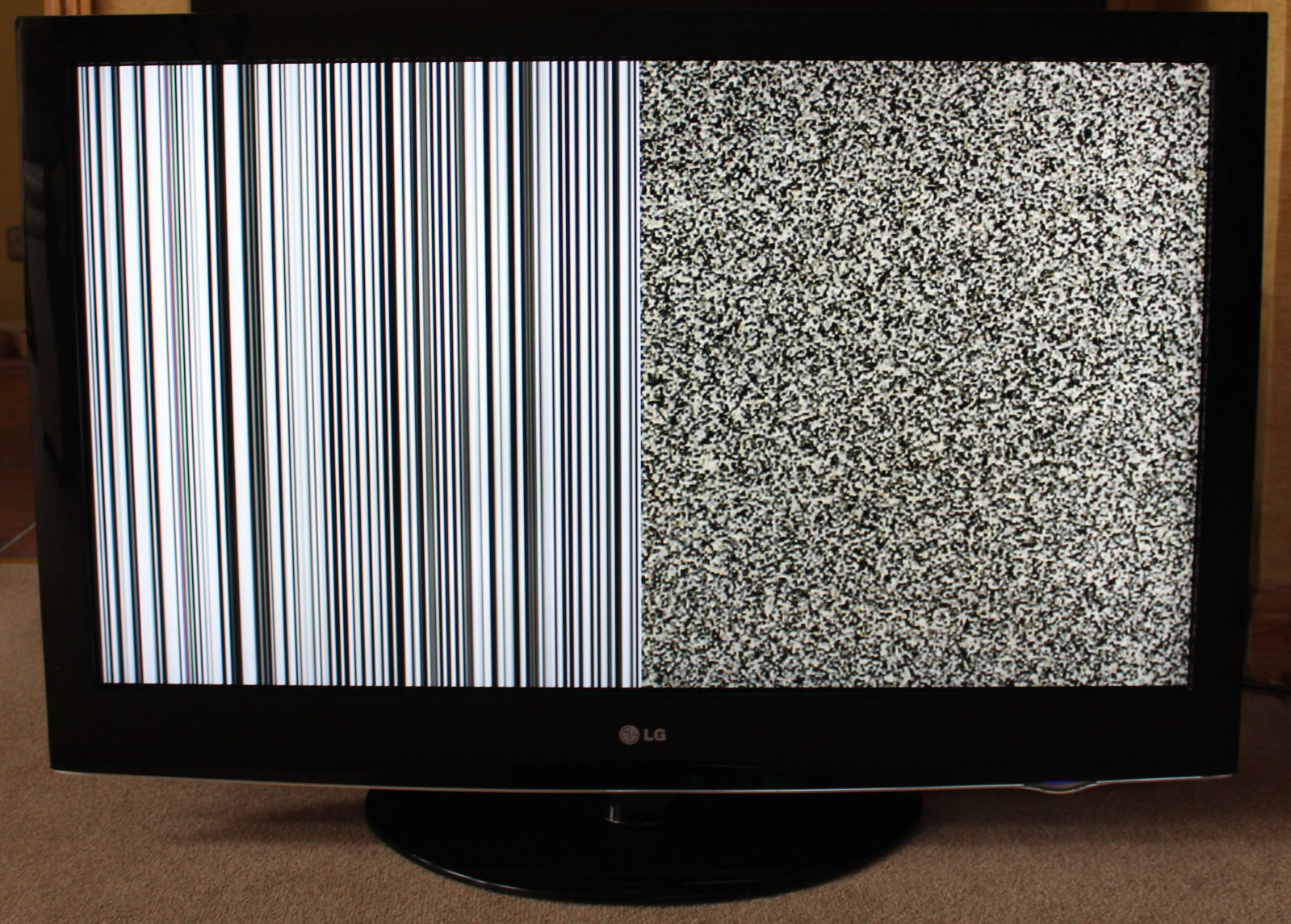

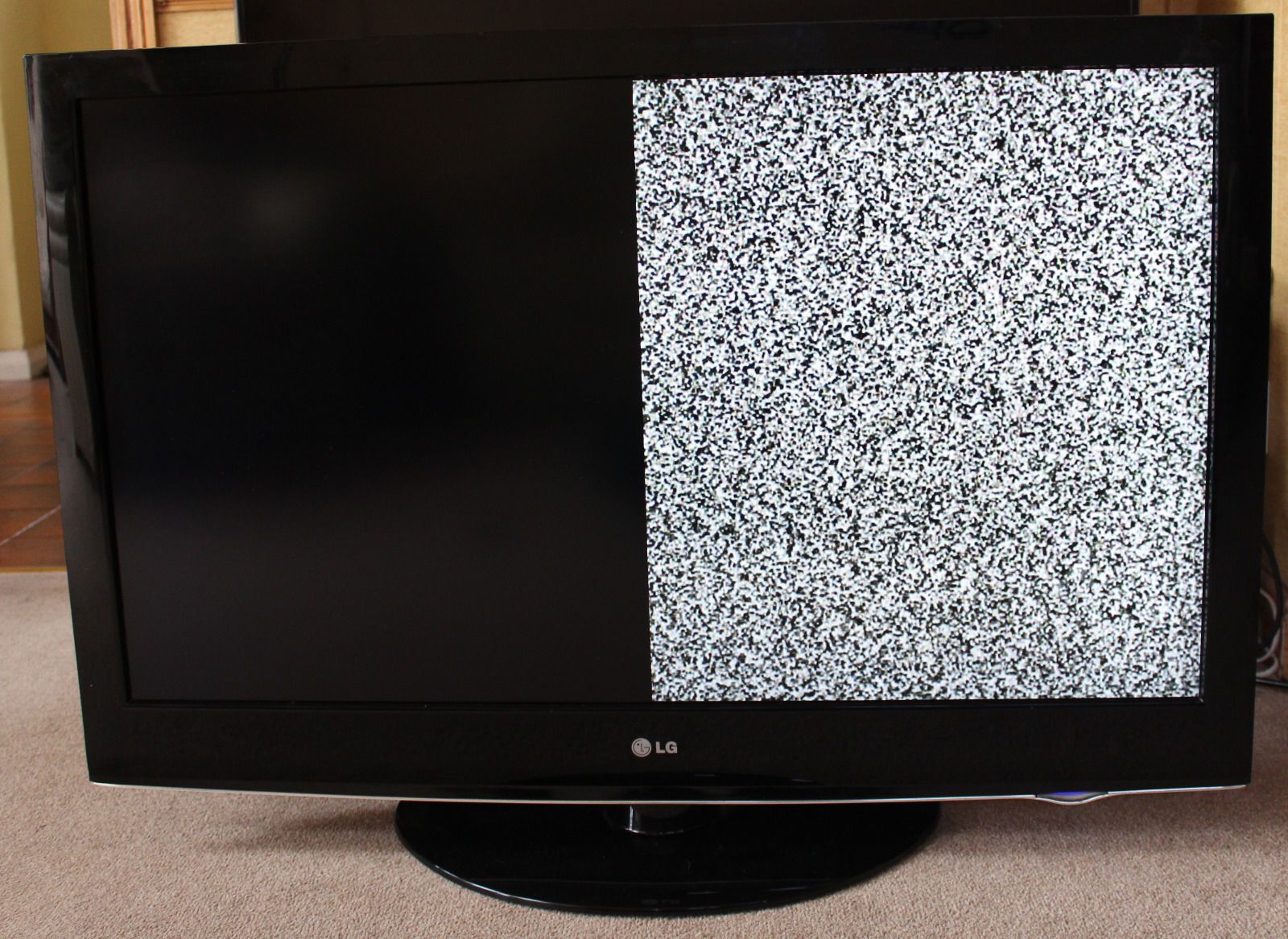

    what do we think, i would say TT-CON, as the problem clears up after ten mins

    Re: LG 42LG3000, T-CON or Screen
    Ahh I have recently fixed one. The tab bond on the top left hand corner is probably at fault a tcon wont cause this issue. I have a youtube video I will upload.
