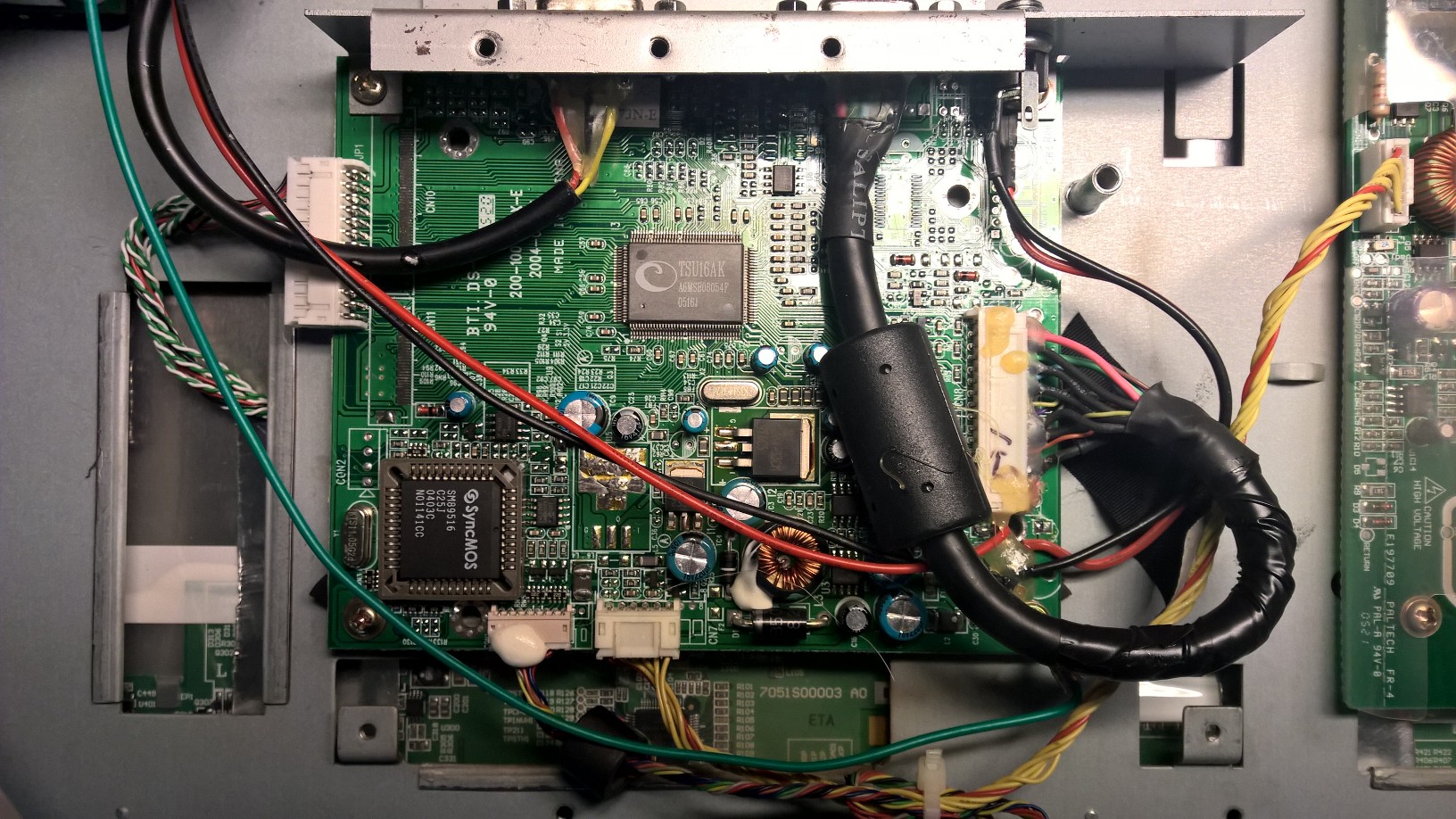

    Hello
    In front of me I have an industrial LCD monitor, brand is General Touch PL1501.
    It works for a few minutes then starts to make odd colours and behave bad.
    I traced it to the chip "TSU16AK" DSP overheats, if I use freeze-spray on it, the operation will be restored a few minutes until it overheats again.
    I might think of replacing the entire pcb, if I just could locate it.
    I haven't got a clue where to search for this, since it has got no readable numbers on it.
    Replacing the chip only might be a solution, but only locate the chip on E-bay (China).
    Any advice is appreciated!

    Check all nearby voltage regulators for stability.
    It is unusual for such a chip to fail in such a way. Not impossible but very unusual.
    Freeze spraying it may reduce the current it uses, this may affect regulators nearby.

      'Check all nearby voltage regulators for stability.' +1
      Does it get hot if you disconnect the LVDS cabl going to the LCD Panel?

        are you assuming it overheats, or can you burn your finger on it?
        if you can put a finger on it then it may just need a reflow.

          The SM89516C25J SyncMOS microcontroller runs off +5V, so I expect this would be provided by a switchmode converter consisting of the toroid (L3), U3 and D1.
          The TSU16AK requires a 1.8V core and a 3.3V I/O supply, so I'm guessing these are provided by linear regulators near the crystal.
          You might consider attaching a heatsink to the TSU16AK.

            Thanks everyone for good advice.
            I don't burn my finger on it though.
            Already tried a heatsink but it does not help much.
            I will focus on the voltage regulators.

              Apart from a reflow, could a wonky crystal (X2) produce the observed symptoms?
