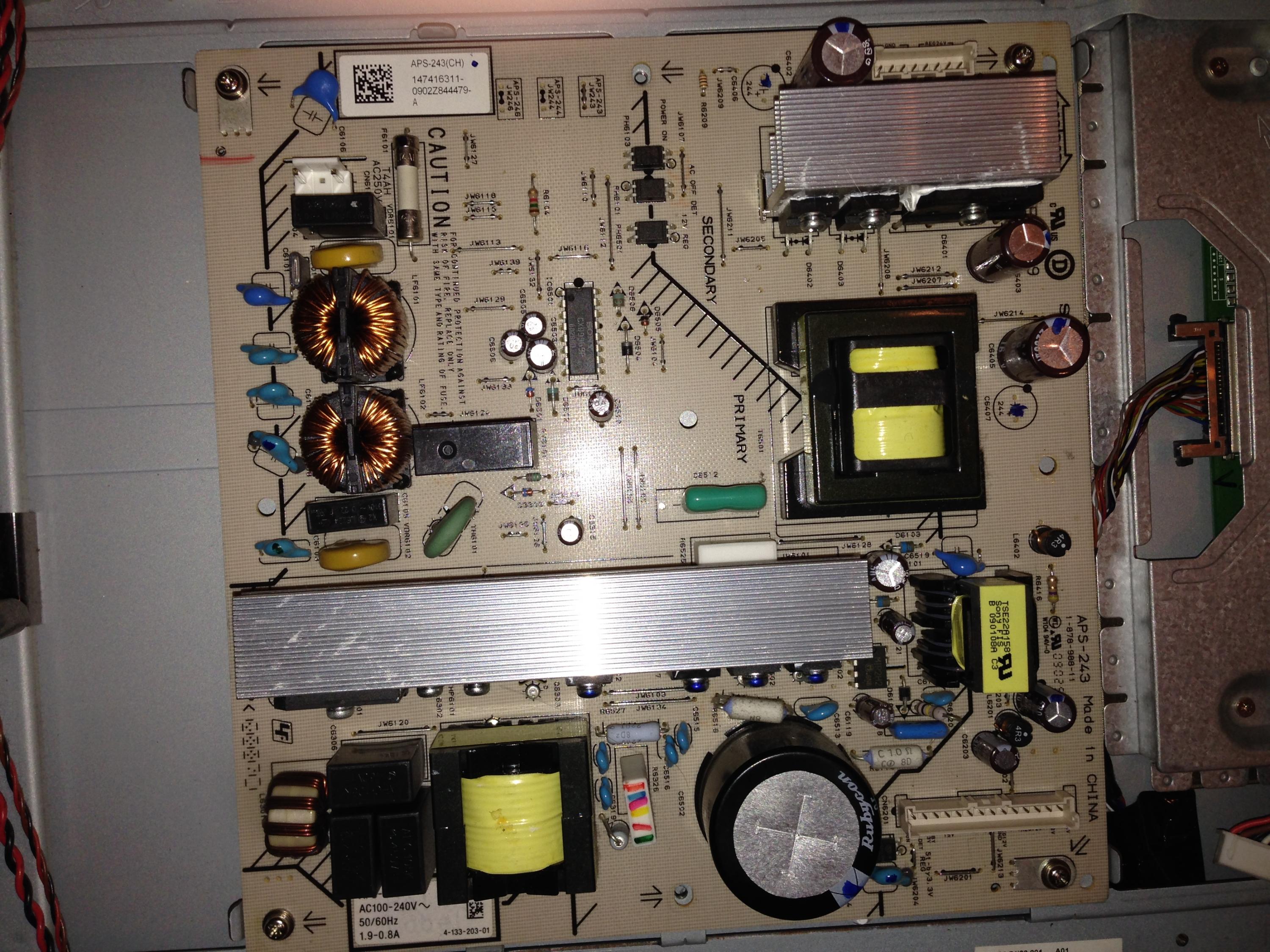

                          Power Supply # APS-243/C(CH)
                          147416341-
                          090Z155402-A

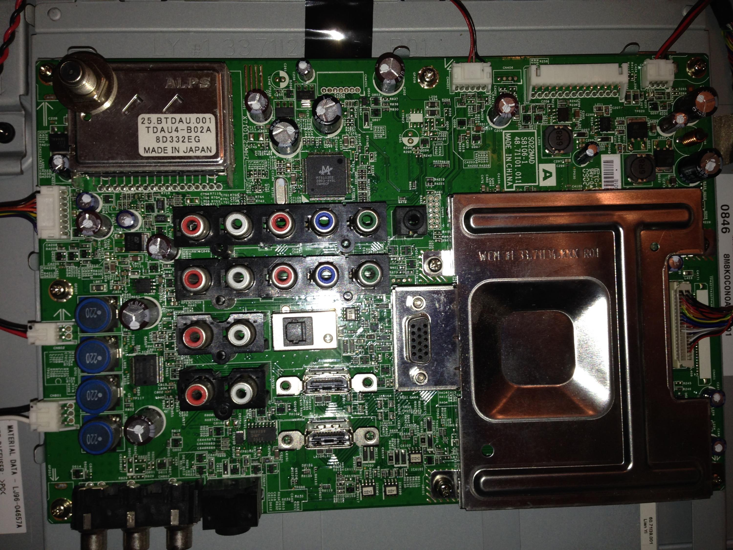

                          Main Board #
                          S022MAD
                          S8106-1
                          48.71I01.011
                          Sorry I don't know how to upload photos.
                          • Malachi
                            • Dec 2015
                            • 1077
                            • Usa
                            Re: Sony KDL-32L5000 No Power
                            Hit post reply, then go down to manage attachments.
                            • Newbie62
                              • Apr 2015
                              • 27
                              • usa
                              IMG 1877 Power Supply
                              IMG 1876 Main Board

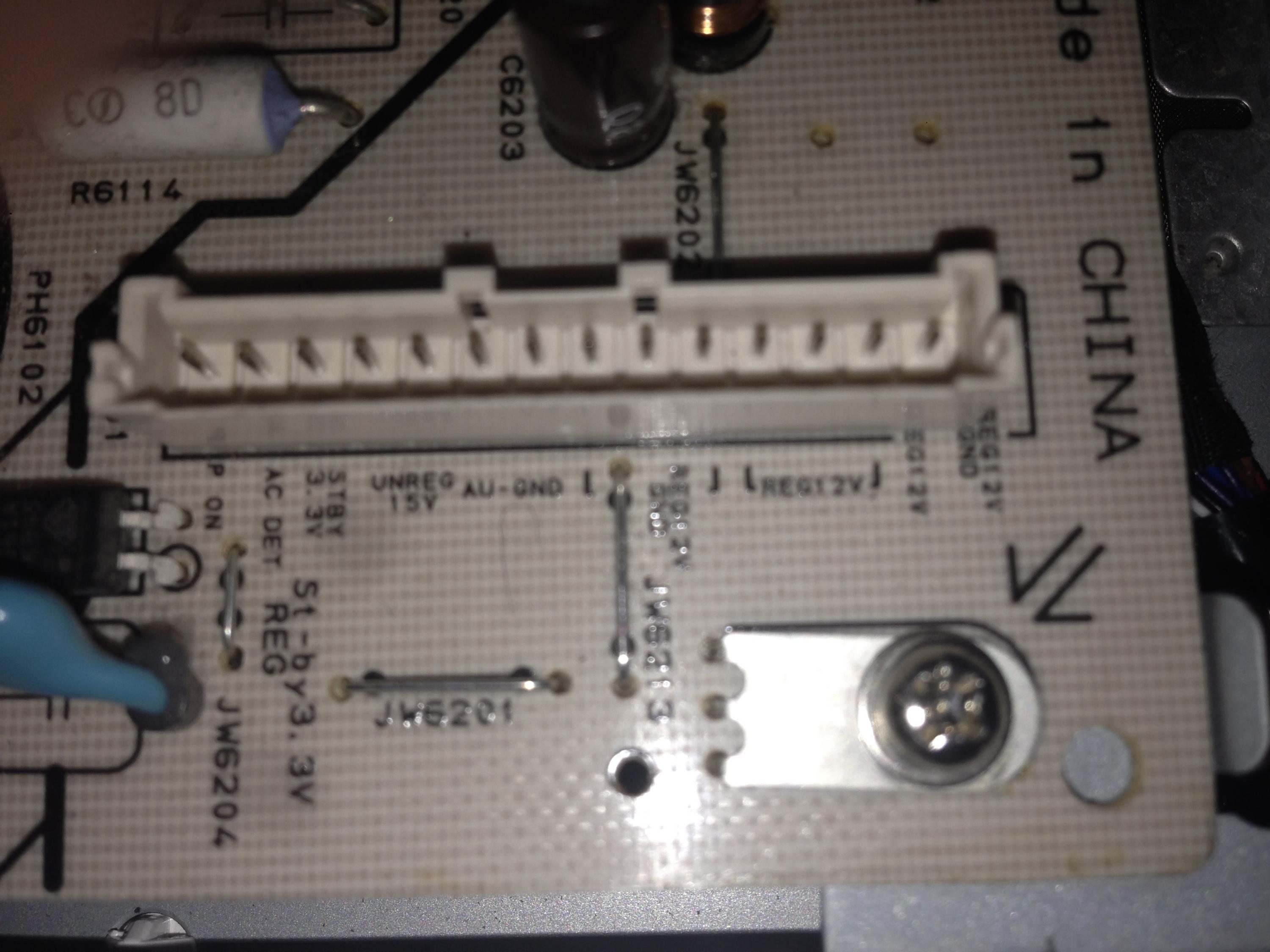

                                Thanks for updating the thread with pictures etc could you also if possible re connect all the wires and then test the voltages on the two white connectors on the power board if you can right down the marking on the pcb ie 5vstby- measures 5.00 volts etc do this for each pin on the connectors so we can see what each pin does what the voltages should be and are now measuring many thanks

                                  Connect pin1 to pin3 on CN6201 (Power On to STBY3.3) with the power supply disconnected from the main board and check that the 12V & 15V come up.
                                  • Newbie62
                                    • Apr 2015
                                    • 27
                                    • usa
                                    Hey Dick Barton
                                    Thank You so very much for your help!
                                    OK here we go with the voltages:
                                    Pin #
                                    1 (P ON ) = 3.40
                                    2 ( AC DET ) = 3.36
                                    3 ( 3.3V STBY. ) = 3.40
                                    4 THRU 10 = ZERO
                                    11 THRU 13 = 12.21
                                      Please can you post a well focus picture as in post #18 since I cannot make out what the legends are alongside the connector so can't tell you if all the readings are good.
                                      You don't list 15V so I suspect that's what's missing so check your diodes, any smd fuse close-by any bulged capacitors or any burnt resistors.

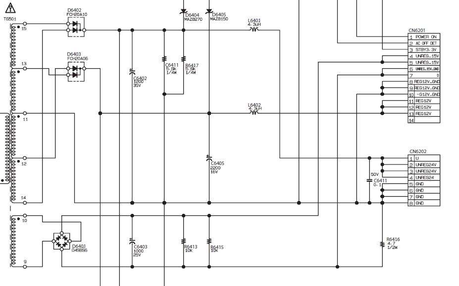

                                        There's literally just a handful of discrete components to provide the 15V which is missing and I suspect R6416 may have gone O/C. The 12V is up and running so the DC-DC inverer circuit is working. There's not much left to check out. D6401, C6403 and finally but highly unlikely to lose the supply, R6413/5
