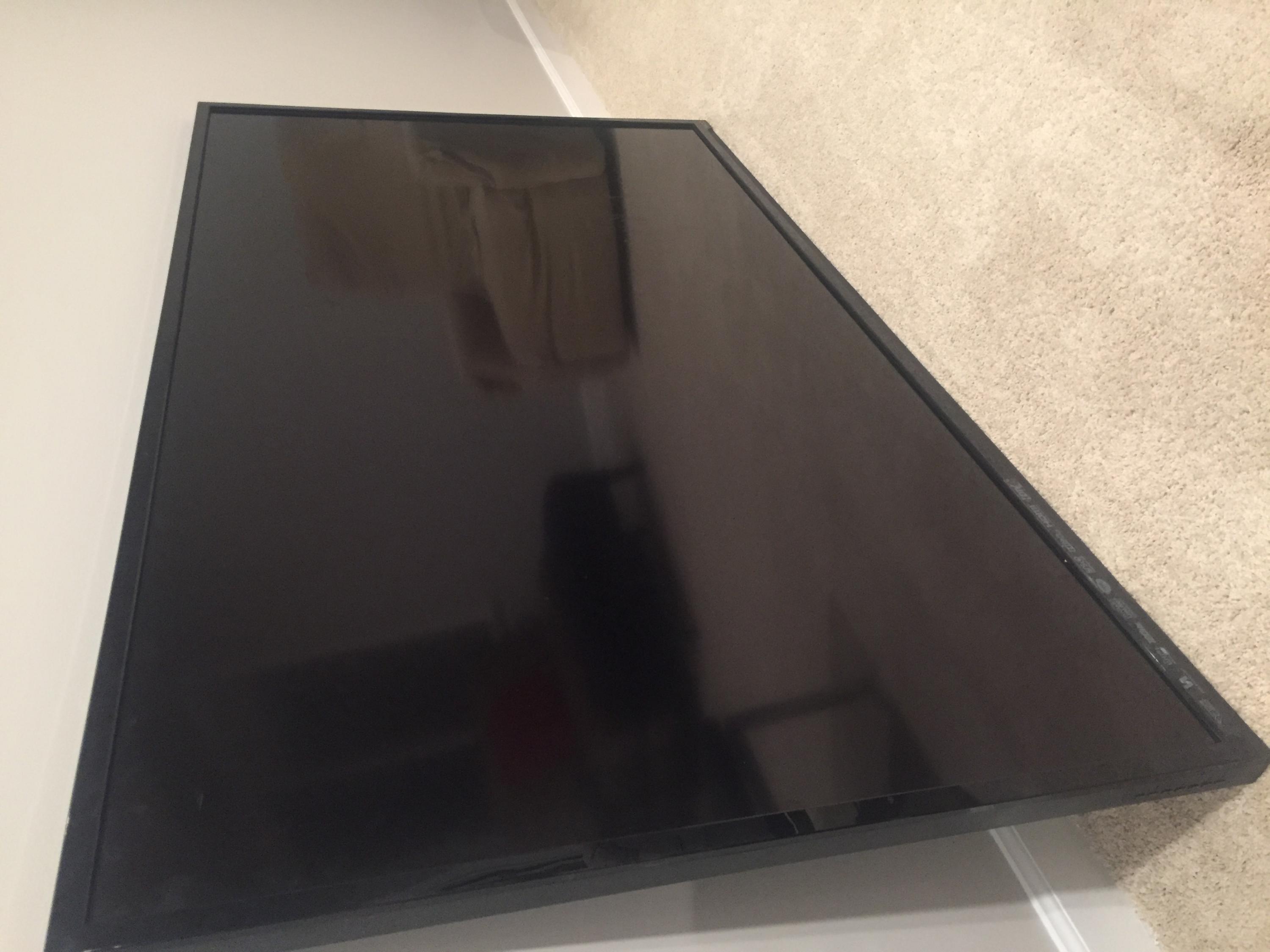

          First off, great post. Lots to read through, but very informative. Acquired a 70" vizio with no picture. Followed the posts, right side display drivers seemed to be the problem. Detached right side drivers, still no picture. I may have left the TV on for too long with the new tcon in while troubleshooting. I'm getting a short on the "bottom right" pin of the transistor. Here's the question: Replace the TCON again? or just the transistor?
          Or: Am I missing something that would warrant a retest?
          Background:
          70" vizio for free (Pic 1)
          previous owner replaced T-Con with no results.

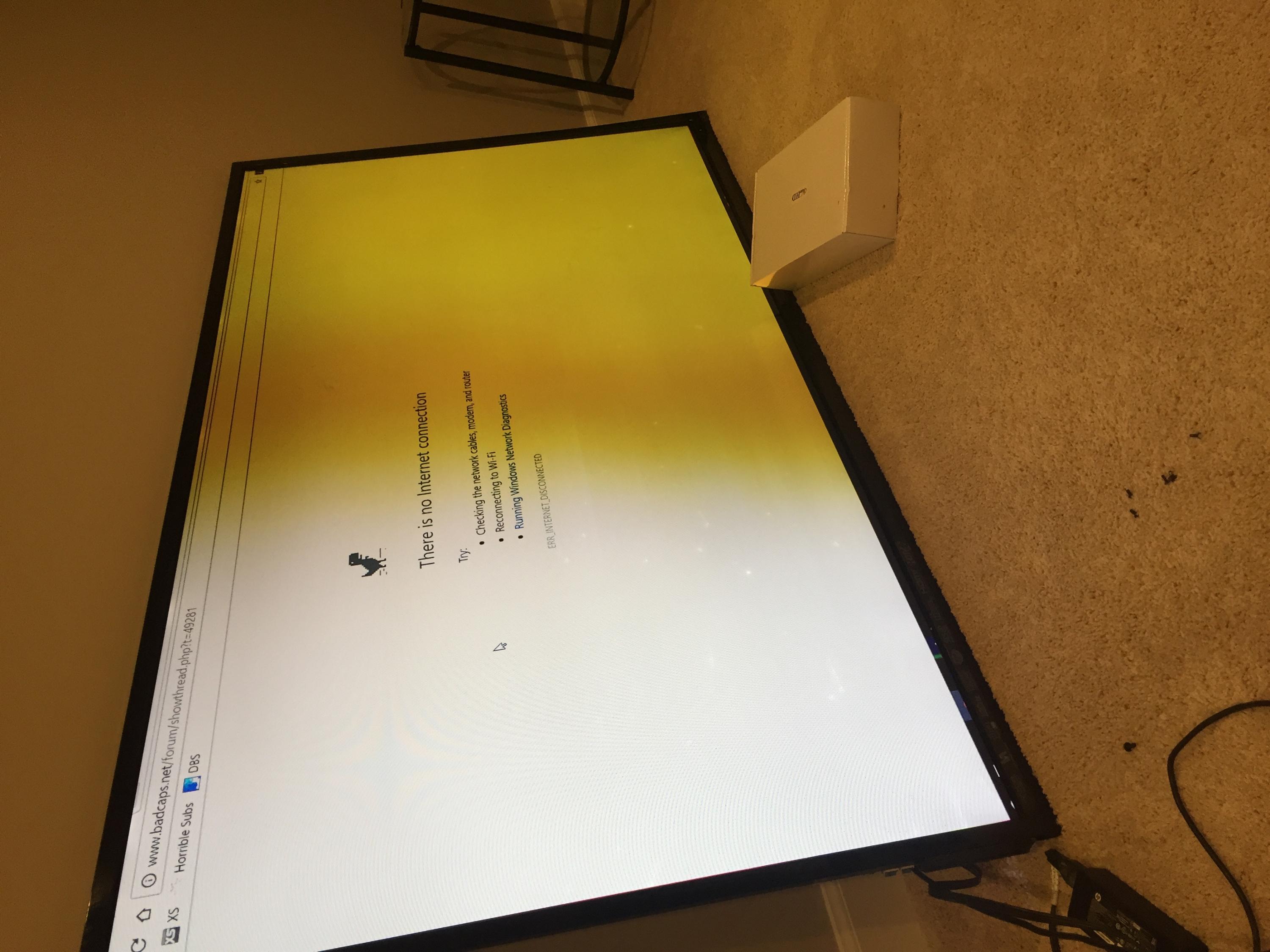

          I powered it on when got it home, confirmed no picture (Pic 2)(left it on for more than 4 secs, was before I happened upon this site and wanted to see if I had sound)

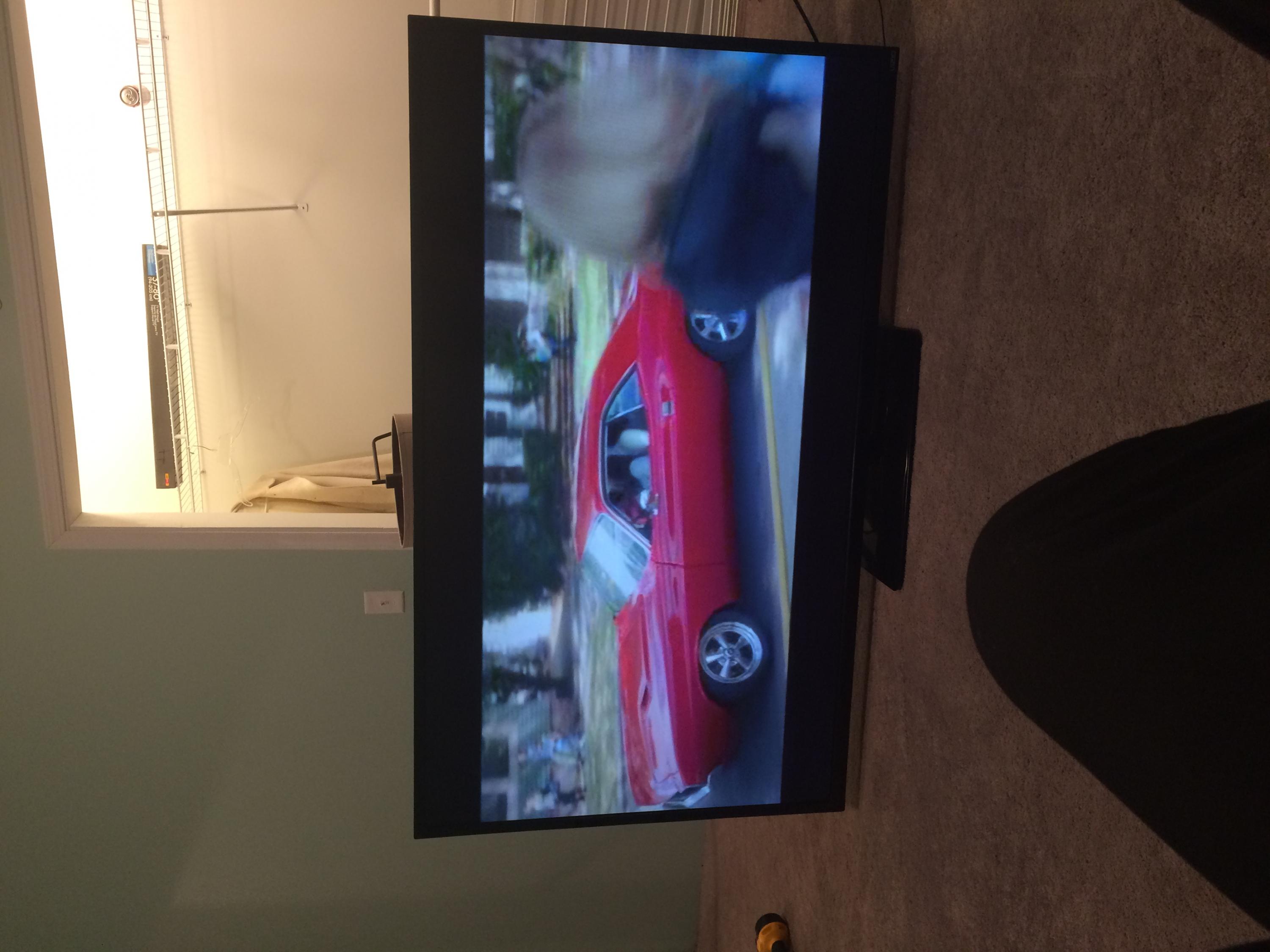

          Disconnected right driver ribbon
          powered on
          right side was dim/distorted etc, left side seemed good.(pic 3&4)
          reconnected right side, disconnected left side
          powered on, blank (no pic)
          reconnected both, powered on, blank (dont ask why i thought i magically fixed it)
          removed right side driver tabs
          powered on, blank
          tested T-con Transistor, appears short on bottom right pin(if pin on side by itself is up)

              Gabe,
              Be sure to unhook one side of driver tabs before you power it on with the new board. If you have a multimeter, you can check the new board before installing to ensure it's good. Then if you're super thorough, you can unhook both sides of the drivers, test the voltages on the T-Con(I would say unnecessary if it passed bench test).
              If you unhook the right side drivers and get no picture, that's your good side.
              If you unhook the right side drivers and get a "weird" picture(see my pictures above). that's your bad side.
              and vice versa

                left side was bad, good to go now
