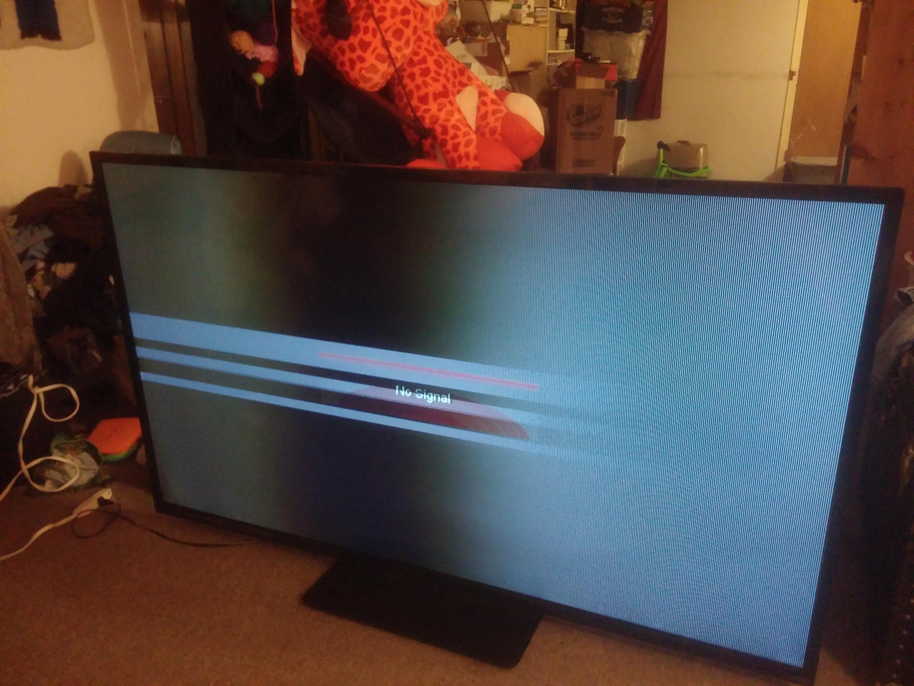

        • euroryde
          • Nov 2015
          • 9
          #404
          Re: e701i-a3 no picture but backlights
          Ya the picture posted is after cleaning the cables with a alcohol resea ting them. Same pixalation issue with just the menu, Netflix, hdmi and reseting. Will order up a main board and give that a shot. Thanks
          • budwich
            • Jul 2015
            • 3097
            #405
            hmmmm... thanks for the interesting picture. As Freakaftr8 indicated, I don't think you have a tcon issue (or at least, a bad fet is not likely). Related to the "cable disconnection", not sure if I now know where things lie, so maybe a recap if you don't mind. The picture you posted is with one corner flex cable removed... correct? If you disconnected (ie switch sides) the other side, you get no picture... correct? Although, I understand you don't want to do that for too long as it could take out the tcon.
            IF the above statements are still true, I would still say you have at the very least a panel issue. Things to note from my limited experience and readings, that the failure of a tab driver is NOT uniform and can provide a broad range of "visual sypmtoms". BUT the disconnection of the corner cables is usually a pretty reliable "mode" for determining that the panel is the problem especially after checking / changing other items out.
            • budwich
              • Jul 2015
              • 3097
              #406
              Further on all this. As suggest by freakaftr8, double check your cable "clamping" on the various cables... WITH YOUR GLASSES ON.... :-) .... there have been some here that have had "visual challenges" and have caused their own problems.... so either glasses or magnifying glass... compare all the connectors, physical positioning / placement... all "markings" / "visual references" should look the same.
              After that, if things haven't improved, and you are now relatively sure that you have disconnected the appropriate corner cable to indicate that side is the issue, I would carefully disassemble that side frame / bezel to get clear access to the tab driver cables on that side. Carefully, "unclip" the boards (board holder clamps) so that you can readily / carefully turn them over to look at the undersides of the tab cables / driver. What do the 5 cable drivers look like.... any heat markings? Do this very carefully as you don't want to actually make a "failure"... :-)
              DO NOT TRY to disconnect the tab drivers just yet!

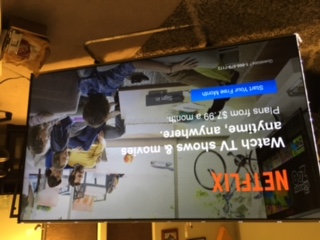

                Originally posted by freakaftr8
                First I would check and make sure you didn't blow out your teeth on morning. Sounds like possibly you didn't have the ribbon cable seated Properly. When you plug in the bad side you might have taken out the transistor again But yes once you find your bad side the good side will show a decent 1/3 half of a picture precedent dark and blurry with most likely a few lines going through the screen. So it kind of sounds like your Right side facing the front might be the failure point However before you do this why don't you try supplying and some input or signal to it while you say goes blank. These TVs will go into immediate standby if it's set in PC mode where it's trying to accept a VGA signal so make sure that's not the case
                I re-seated all of the cables and I swapped the main board with another one that came with the tv. Figured why not. The following pictures are with the left side looking at the display (right side when looking at the tcon) ribbon cable disconnected from the driver boards. I only got the menu up, I do not have any nearby sources, but if it is really needed, I can get one to the tv.
                When I took these pictures, I had no problems whatsoever besides the lines. The TV stayed on and I was able to bring up the menu and such.
                I do have a New tcon that arrived yesterday. I did not want to put that one in until I was fairly confident it would not get fried. The tcon in place for these pictures is my repaired one.
                The last picture is a mostly clear view of the repair.
                Whats my next step?

                    Jim1590 give me a picture with something playing on the screen but you definitely have a bad driver
                    gormanrider8. Go for it. That's your problem

                            • Jim1590
                              • Jul 2013
                              • 98
                              #414
                              Lower left cable is disconnected as we are looking at the TV display.
                              The test signal is actually a video I was running via plex that I downloaded from here:
                              https://vimeo.com/41414940
                              Also concerned about the clarity of the image. I do have a new tcon that I can put in once I know I am not going to short it. Also have another main board tha tmay be working, may not.
                              • budwich
                                • Jul 2015
                                • 3097
                                #415
                                The first three pictures "appear" to confirm that side driver(s) have an issue. The confusing one is the last one, it looks pretty good.... what's up?
                                Never mind... you were just provide a "screen shot" of the test pattern software... :-)
                                As for clarity, you can't judge that until the "operation" is complete as the "faulty drivers" impact the whole visual display. I think you are going to have a spare tcon... :-)
                                • freakaftr8
                                  • Oct 2012
                                  • 3743
                                  #416
                                  Yes Jim that left side is bad. Telltale sign is the nice bright working bar in the middle. Remove the left side drivers and boars off the side of the panel on the left side. This is the left side as you are facing the front of the TV watching it. Watch my video for instruction on how to do so.

                                    • Jim1590
                                      • Jul 2013
                                      • 98
                                      #418
                                      And it is DONE! Removed the left side drivers by the control buttons and have a great picture.
                                      Swapped my repaired board for the new one I got and the tv would not display a picture. V for a few seconds then black. Repeated several times. Hmmm.... put the repaired board back in and enjoyed watching tv on it. Board going back.
                                      This is the first time using this TV, or anything this big. Picture is not as sharp as I was expecting. Not as clear so to speak. Probably the settings or my input.

                                      • euroryde
                                        • Nov 2015
                                        • 9
                                        #419
                                        So got in another main board today tried it out and still the same bad pixelation, wondering now if something could be up with the t-con board. :/
                                        • budwich
                                          • Jul 2015
                                          • 3097
                                          #420
                                          could be ... but as suggested to others, post pictures of a known test pattern. That way people will know a bit better what to expect and may have suggestion on what they see.
