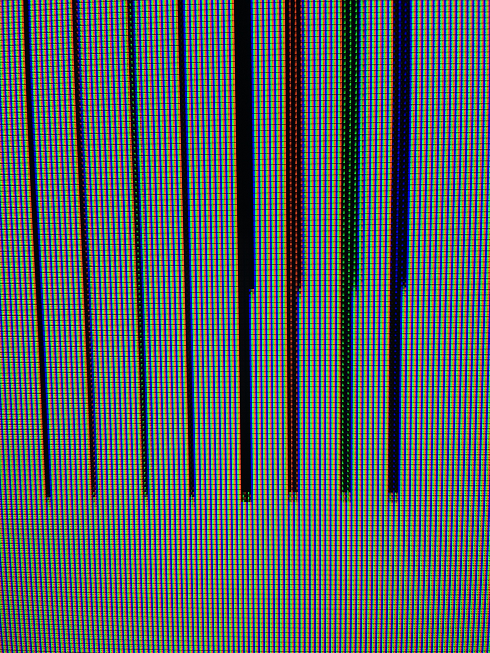

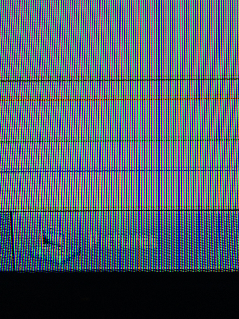

          I just got through removing the side tab drivers and replacing the MOSFET on the t-con board for this TV I've had lying around for the last 6 months. I used a 771-2N7002F from Mouser since I had 12 of them in my pile of parts from another project. Seems to be working, but I have some distortion on the lower left quarter of the screen. The left side of the screen had the bad drivers. Also the last picture shows some distortion on the icons in the notification area. Anyone have any idea of what might be going on or is this normal for this TV?

            Re: e701i-a3 no picture but backlights
            it would probably help to look at the settings on the tv. Of course, it would help even more if you put on a known tv test pattern for resolution... you will likely get your answer quicker.
              I've turned off all the extra image processing things in the settings and stripped it down as much as possible. The pictures that I posted in the previous post are my results. Looks like ghosting. LCD panels can't have convergence problems can they? Don't want to jump to any conclusions or waste anyone's time with it. Everything seems to be working fine otherwise.
                It looks as if you're having a definite vertical distortion problem. First thing I would do is try another input or a source besides a computer. VGA cables are known for having problems with shielding and I have seen distortion issues with those cables before. Can you use some other source like a DVD player or at least turn on the menu and take a picture of that? Is also a slight possibility that you might want to clean the area where you stripped the cables off with some denatured rubbing alcohol and also clean the two ribbon cables going from the tcon board to the panel also
                  I'm using HDMI and I did switch to a different HDMI port, but I didn't try the VGA output. I think you're probably right about needing to clean the area I removed the cables from.
                  Those lines in these pictures, the smallest line is 1 pixel wide and the wider line is 2 pixels wide on the end and 3 pixels wide on the rest. The first picture is the bottom left, the next one is the middle on the right side, and the last one is part of the menu. The menu looks pretty normal, but I'll have to look at the other Vizio I had to see how it looks. I'll get a picture tomorrow to compare it. Next thing I'll try is the VGA output.
                  I do have another mainboard to try in it, but when I had it in it before putting everything back together it seemed like it had a lot of artifacts or something going on with it. The one that's in there right now turns out to be for an E601i-A3. Also I'll take it back apart and clean the cables as you suggested. Thanks for the help. I'll get back with you on what I find.
                  Edit:
                  I can confirm that the VGA output is slightly worse, probably due to its nature.
                    The third picture of the menu looks normal. I dunno could be just a piece of junk still stuck to the panel
