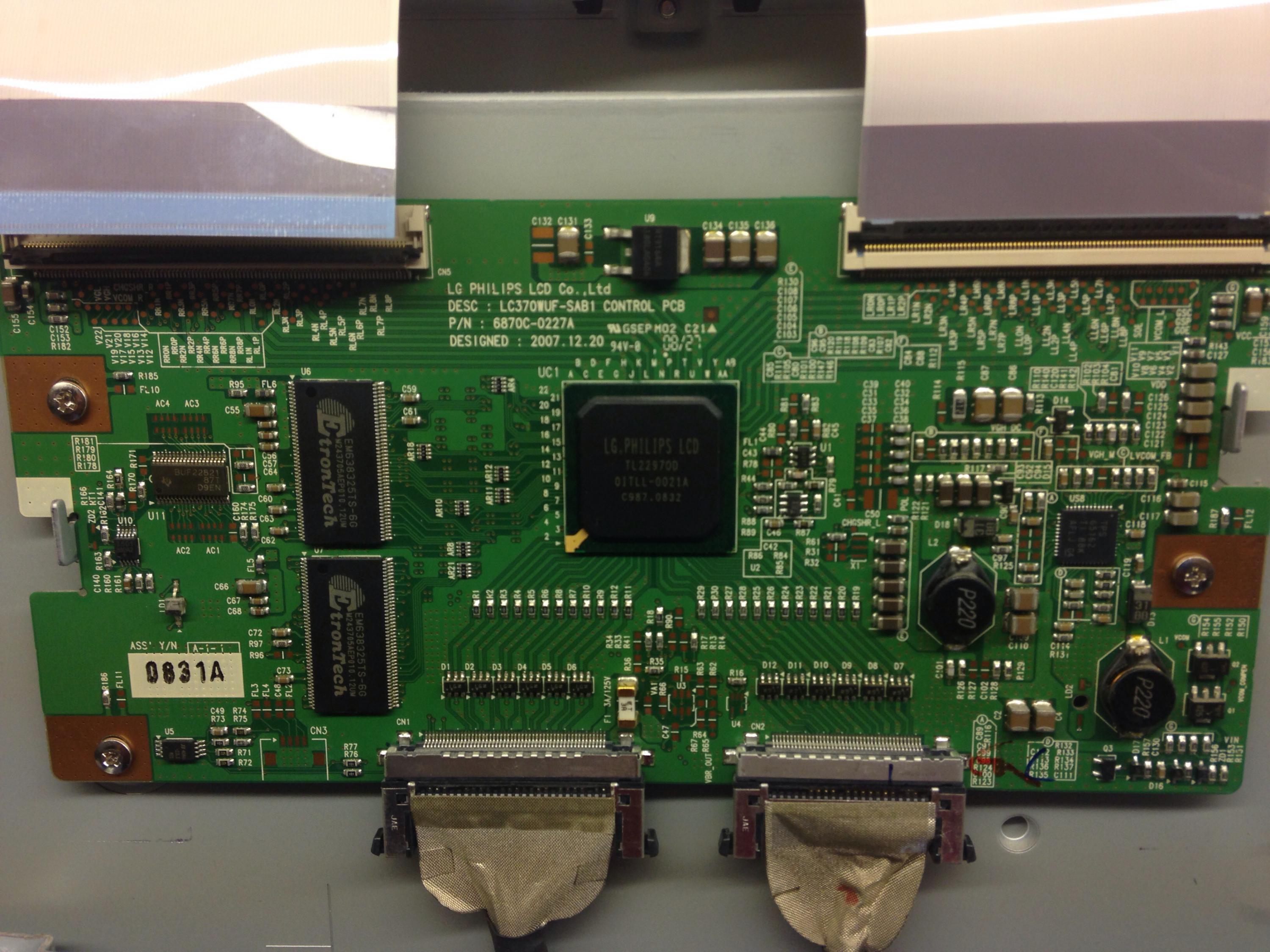

    Include a picture of the t-con.
    Check each end of the pico fuse on the t-con.

                If I unplug half the tcon I get half a white screen on the side I unplug
                • Rickig
                  • Mar 2015
                  • 112
                  • England
                  Re: 37lg7000 sound. No picture but backlight on.
                  Tcon
                  • Hamie
                    • Apr 2014
                    • 1383
                    Check voltages on t-con.

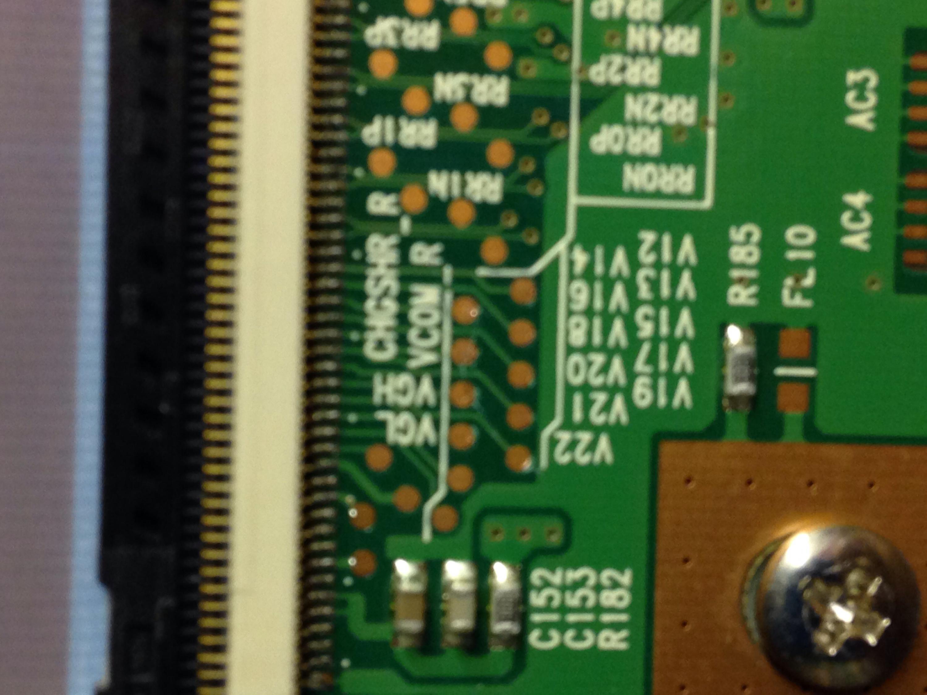

                      Sorry.. Where exactly do I take the reading from?
                      • vinceroger69
                        • Mar 2012
                        • 6714
                        • uk
                        if you look at the tcon where the top white connectors are for the ribbon cables just under there on each side there are the test points marked with a gold test point, put the black multi meter probe on the tv metal chassis and try not to let the probe slip and short anything out.
                        • Rickig
                          • Mar 2015
                          • 112
                          • England
                          Vgl 2.5v
                          Think vcom_r 6.3v or 17mv (there's 2 test points under the vcom r writing not sure which is right)
                          Vcom_l is 12.6v
                          Vgh 12mv
                          Vcc 3.3v
                          Vdd 16.9v

                            i think the readings are meant to be took above the white line just to top left if that makes sence
                            • Hamie
                              • Apr 2014
                              • 1383
                              Vcom is here:
                              Can you check vgl and vgh again as they are definitely not right.
                              Vdd is ok.
                              Vgl should give a negative reading. Ie -6v
                              Vgh should be about 15v
                                Vcom 6.9v
                                • Hamie
                                  • Apr 2014
                                  • 1383
                                  Vcom is fine.
                                    did you see my post 14 you may need to check the readings again
                                    • Rickig
                                      • Mar 2015
                                      • 112
                                      • England
                                      Taking readings from here. The dot under each one and readings are as previously stated
                                      • vinceroger69
                                        • Mar 2012
                                        • 6714
                                        • uk
                                        possible i still think you need to check them above and too the left of the white line as if you count the numbers starting with a v theres just enough gold dots to match under the whie line but above there 4 test points whats hamie opinion?
