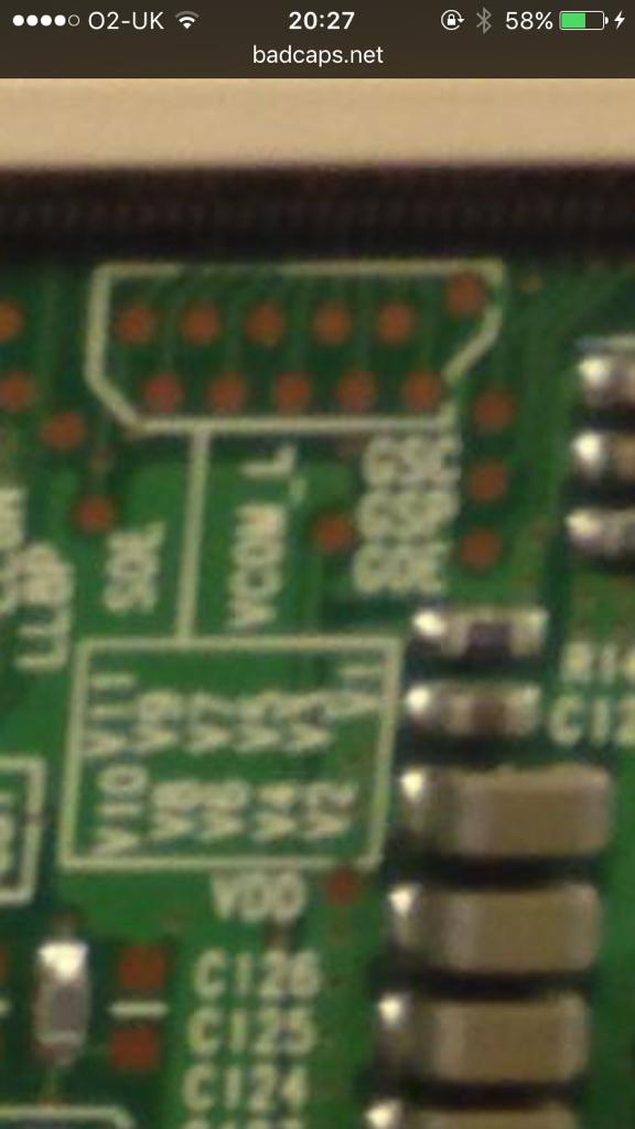

              Finally check the gamma test points.
              Located here, and also to the left (the ones under the white line you were testing previously.)
              22 in total, post back results like:
              V1-
              V2-
              V3-
              Etc

                Re: 37lg7000 sound. No picture but backlight on.
                V1 16.5v
                V2 16.2 v
                V3 14.4v
                V4 13.6v
                V5 5mv
                V6 12.6v
                V7 23mv
                V8 11.5v
                V9 10.7v
                V10 8.7v
                V11 8.7v
                V12 8.3v
                V13 8.3v
                V14 6.3v
                V15 5.5v
                V16 27mv
                V17 4.3v
                V18 27mv
                V19 3.2v
                V20 2.5v
                V21 0.6v
                V22 284mv

                  thers some odd readings there never saw any mv before

                    V10 - V13 don't look right either.

                          In my experience the voltages should drop gradually.
                          So if those readings are correct you have have a faulty t-con.
                          Going by the fact I can't seem to find anyone selling one would usually suggest that this board has quite a high failure rate.

                            Double checked all mv ones and they are all in the mv range. So shall I be looking for a tcon?

                              If this was my set the tcon is usually the cheapest of the boards so yes i would probably change it. Make sure you get one with a returns policy just incase its faulty already failing that you may have to look for a smashed screen working set and use the boards from that.

                                Not really sure what to say. Gamma readings are there, also they are bad, but that shouldn't cause a no picture, bad gamma just causes a bad solarized pic. Would be nice checking the lvds cables in and out of the Tcon..

                                          Bad gamma can cause many faults.
                                          Solarisation being one of them.
                                          Image to dark, image too light etc.
                                          I had one fairly recently where the image started off a bit dark then faded out to to completely black.
                                          Therefore with gamma voltages as bad as the ops I'd be surprised if it wasn't caused by the tcon.
