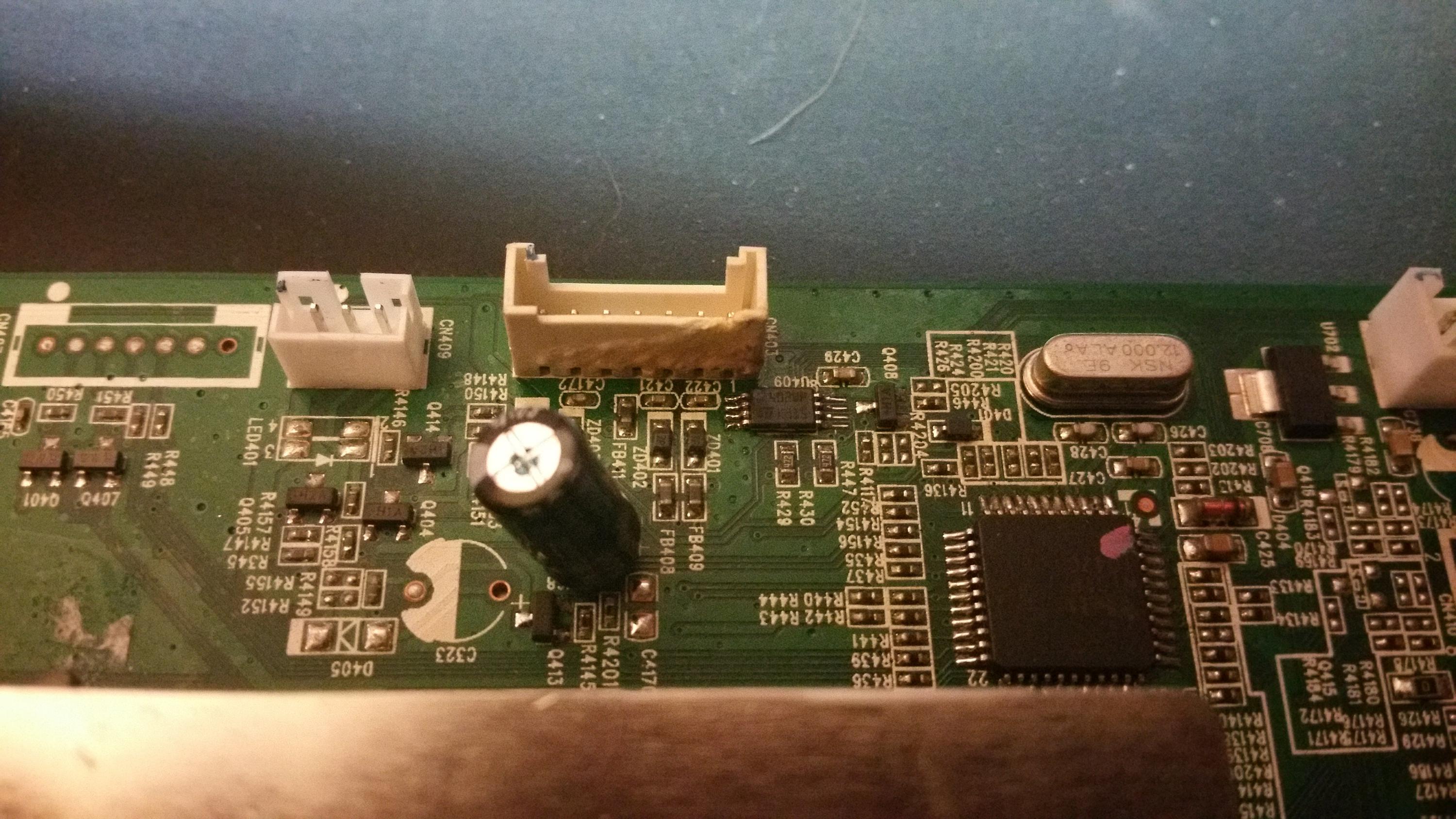

    The above TV will work OK for a while, 10-60mins or so. Eventually, it will develop
    + an issue with sound where the sound seems to get broadcast twice kind of like an echo. The issue will slowly build up worse and worse. At these times I also see a slight flickering of the video but otherwise the video seems fine. I see on this refurbished main board there is some brown discoloring on the audio header (and the plastic looks slightly melted). Any ideas on how to troubleshoot this issue? I've checked the power coming from the power supply board and all lines looked right from there.
    Image attached.
    Thanks.
    Cy

      Re: Vizio vt420m sound issue
      someone had either changed or resoldered U409. I can't see the numbers on it, but looks like it could be the audio IC. That's where the discoloring came from.
      Edit: 402WP = EEprom. So it had a EEprom replacement.

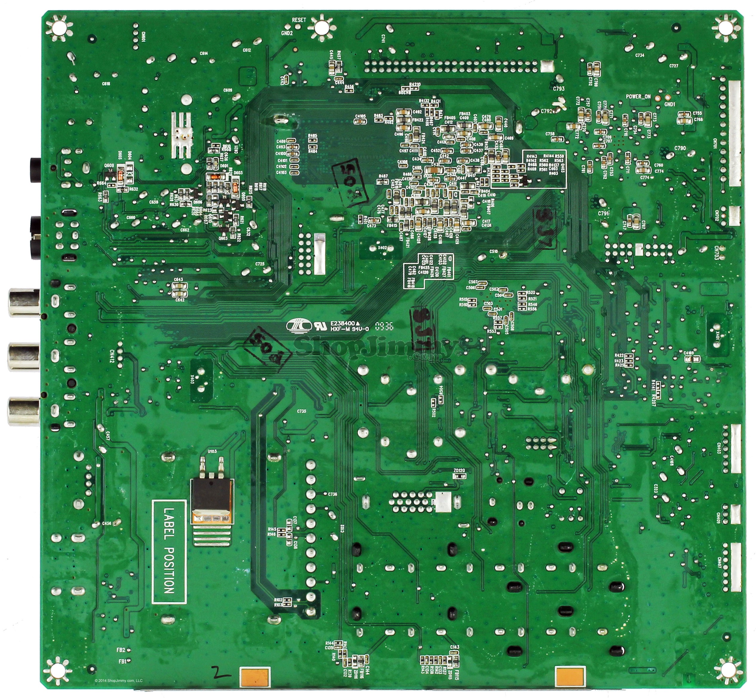

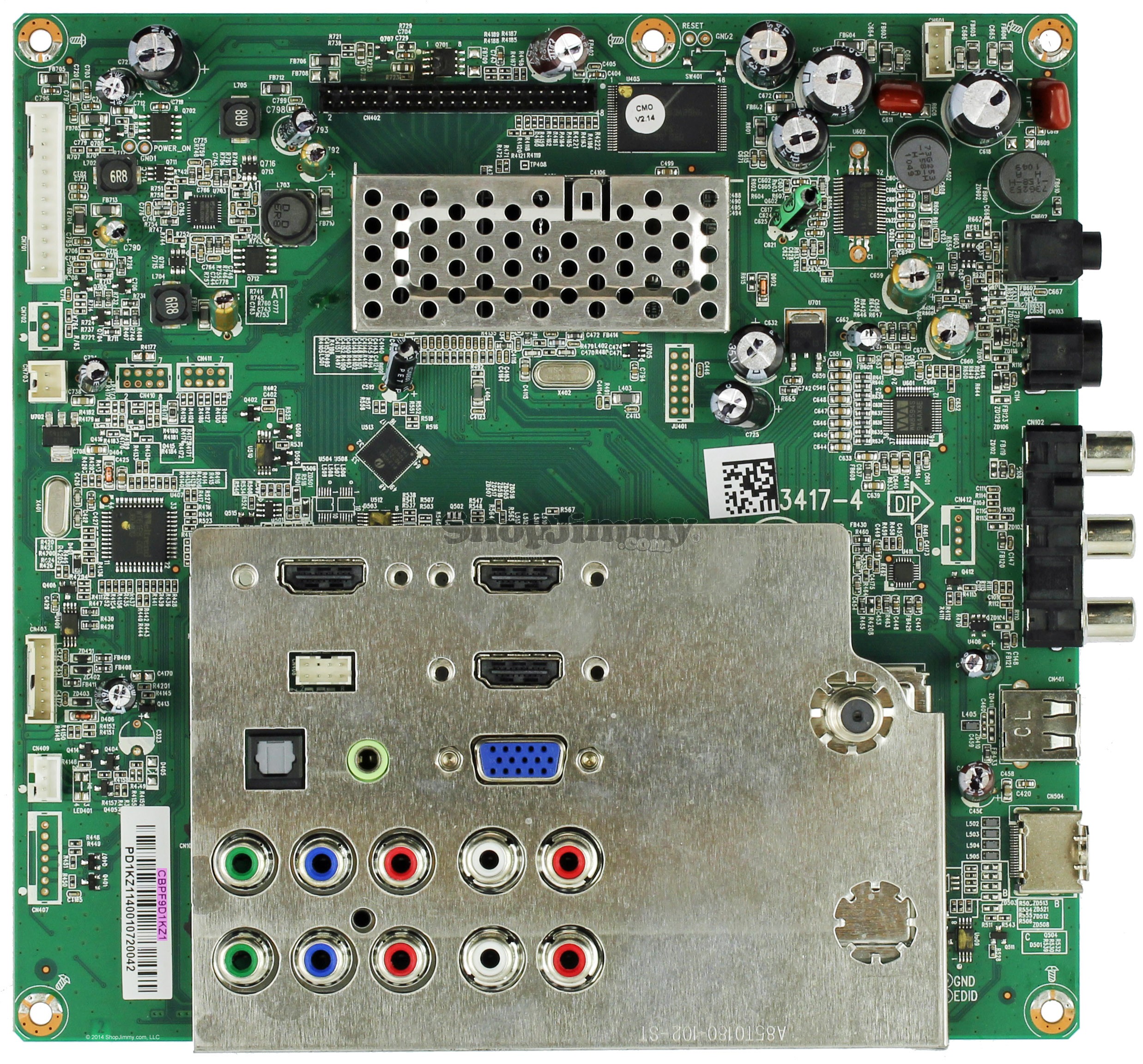

        Which one of these is your main board?
        http://www.shopjimmy.com/catalogsear...q=Vizio+vt420m
          My model uses this main board type:
          http://www.shopjimmy.com/vizio-cbpf9...main-board.htm
          CP
            So you already replace the main board, right? What was the original problem with the old board? At this point the power supply will not cause echoing sound problem, that will be something in the sound processor section.
            U602 is the Class-d amplifiers for driving the speakers.
            Pictures provided by SHOPJIMMY.
              The original problem with the set was the picture would start to get some artifacts over time and the system would eventually reboot itself. I sent the board in for swap/repair (it was swapped for a rebuilt board). The video seems OK now but the audio is having issues. I noticed the brown smoke mark on the audio header and was of course curious about it. No caps appear bad on the main board or the power board.
              Anything I can try to check with a meter or pics I can take to try to help troubleshoot?
              CP
                That CN403 is not connected to audio circuit.
                Show us the pictures of the whole back side of the TV.
                I think the board you got has problems, i hope it is still under warranty.
