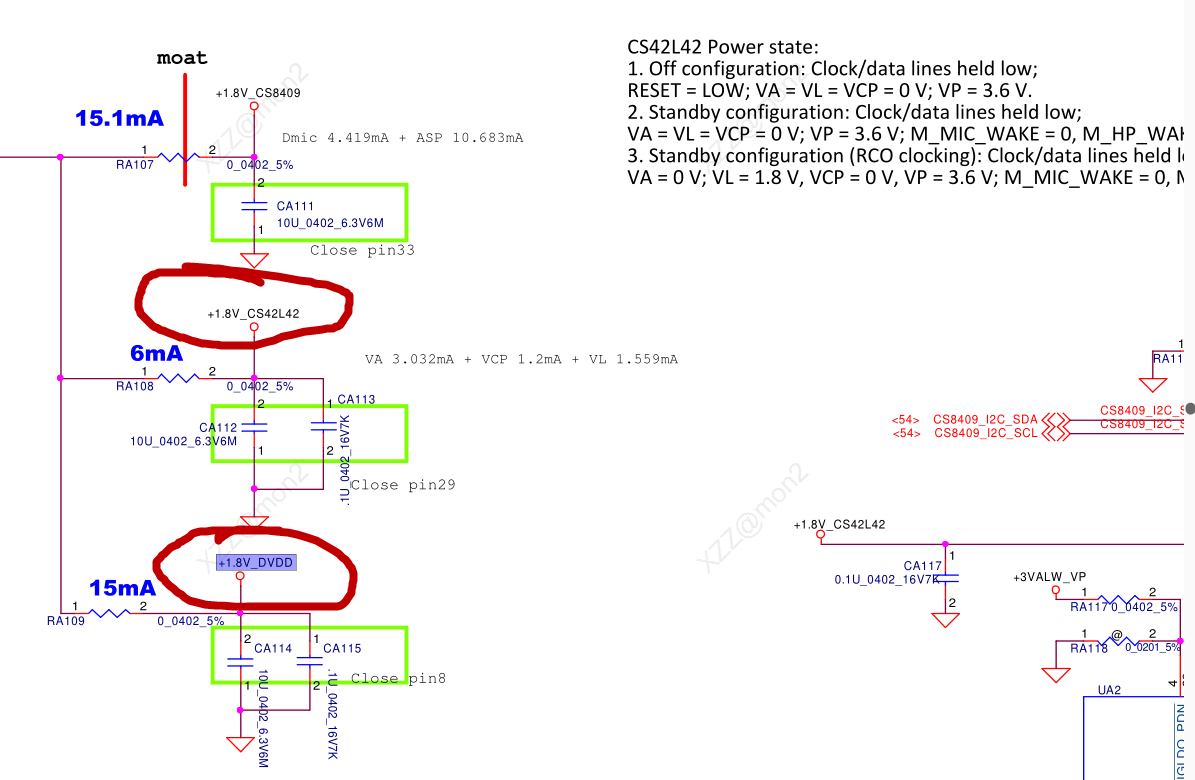

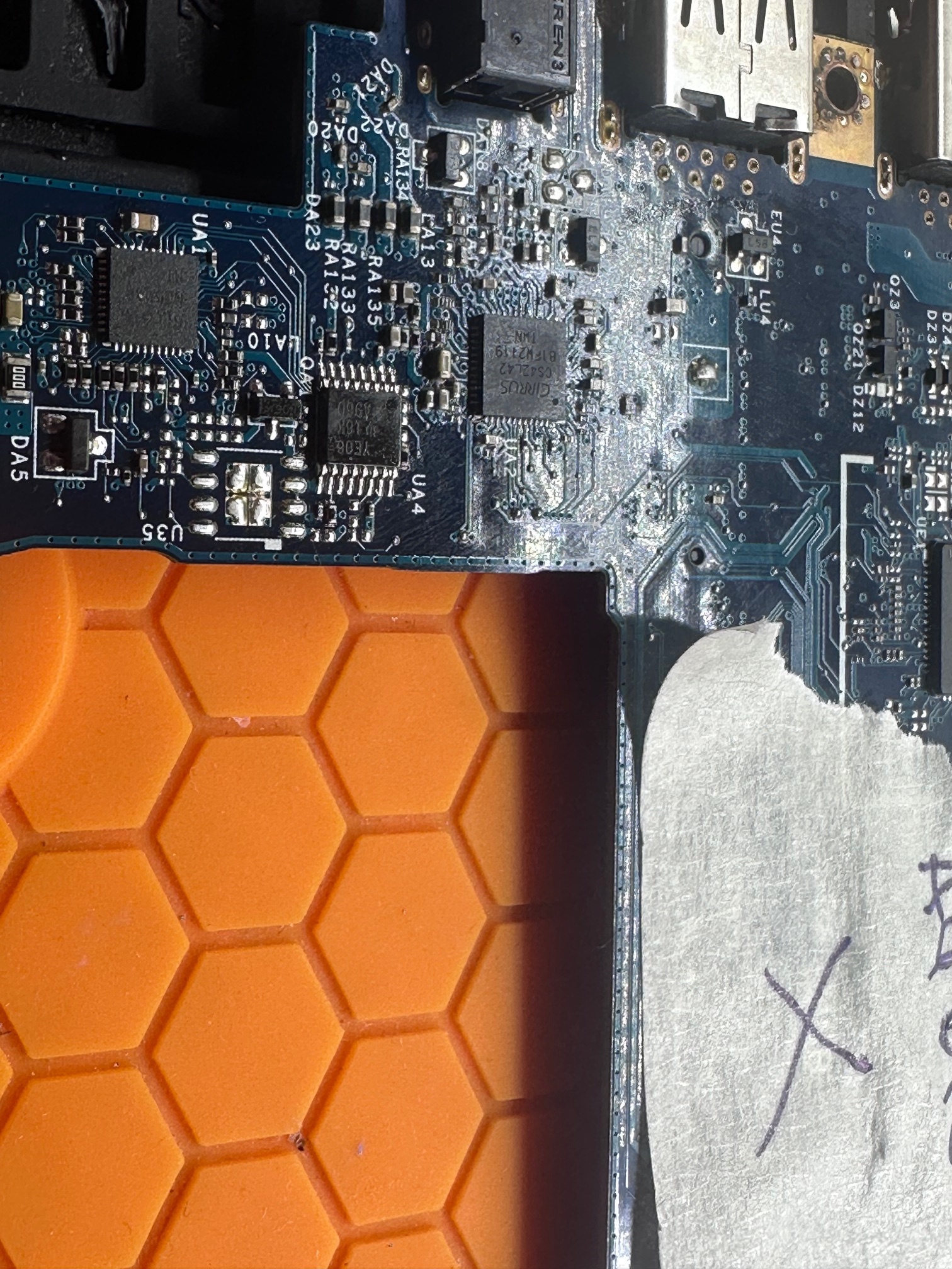

    Hello, I have dell 3501 MB la-k034p with Sound issue RED cross. No sound device in device manager. In BIOS diagnostic everything passes but no sound tone either in bios test. AUDIO chip is CS42l42 and 3.3v, 1.8v is present. Someone have any idea ? Thanks.
