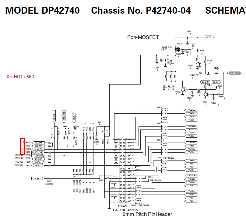

      If you look at the LVDS connections, the two boards are not the same, look at the component with 'X' which means it is not used (installed). There are many 'X' on both boards so the two boards are not the same.
      You need to look at the schematics in details to see if they are really the same or you may cause damages.

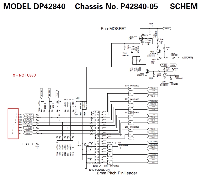

              Re: Sanyo DP42840 P42840-05 set wont turn on
              Look at those two schematics: https://www.badcaps.net/forum/showpo...3&postcount=22
              Sanyo DP42840 P42840-05: Your original
              and the one you are trying to use the P42740-04, add or remove those 'X' to make it the same as your original.
              I also do not know what will happen with the screen resolutions.

                    Do you mean you REMOVE/ADD those resistors which are not supposed to be there and there in your original board? The LDVS connectors pinout are the same, the resistors that are used and not used are not the same.
                    Look at the two diagram again, can you see those 'X' resistors?
                    You are trying to make the board that was made for Plasma to work with LCD, correct?

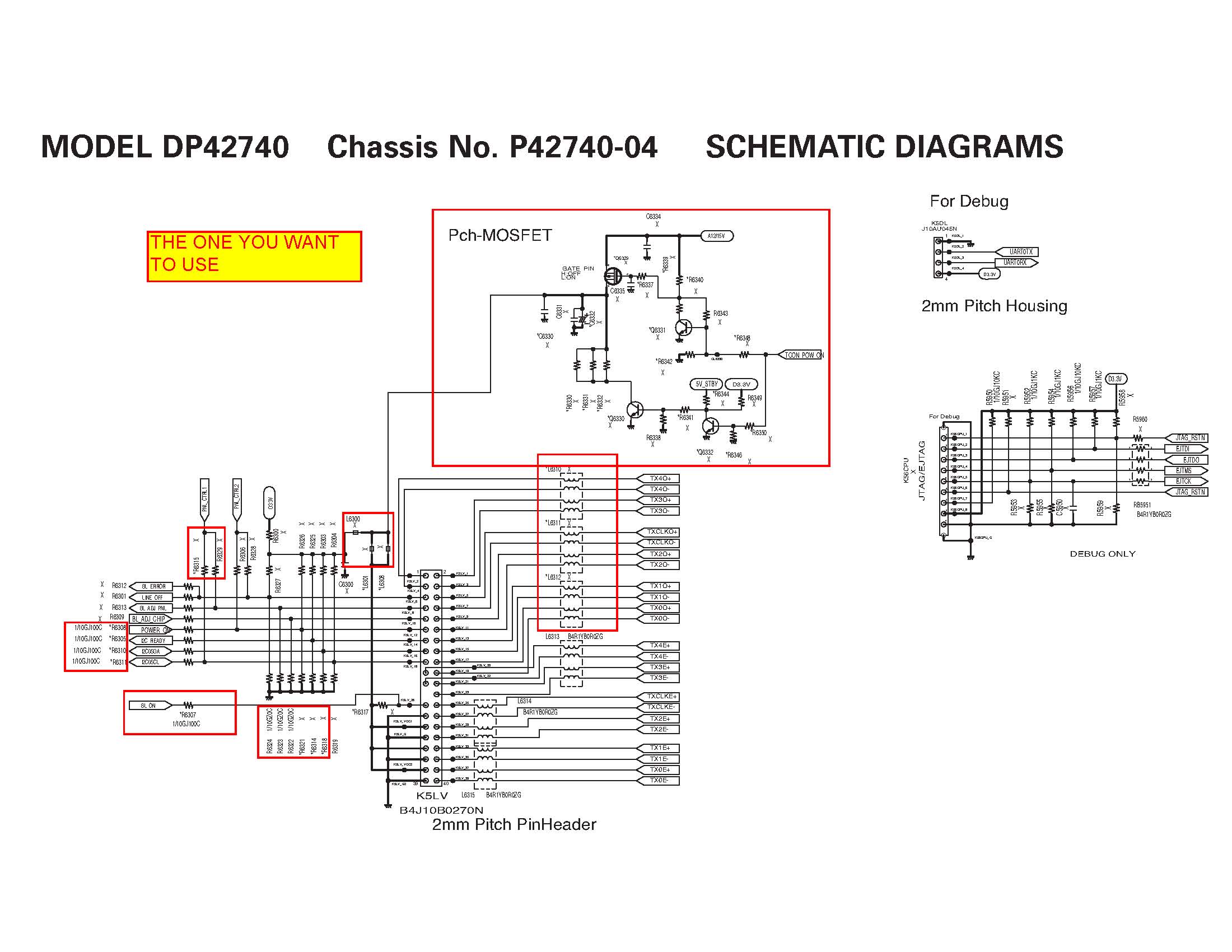

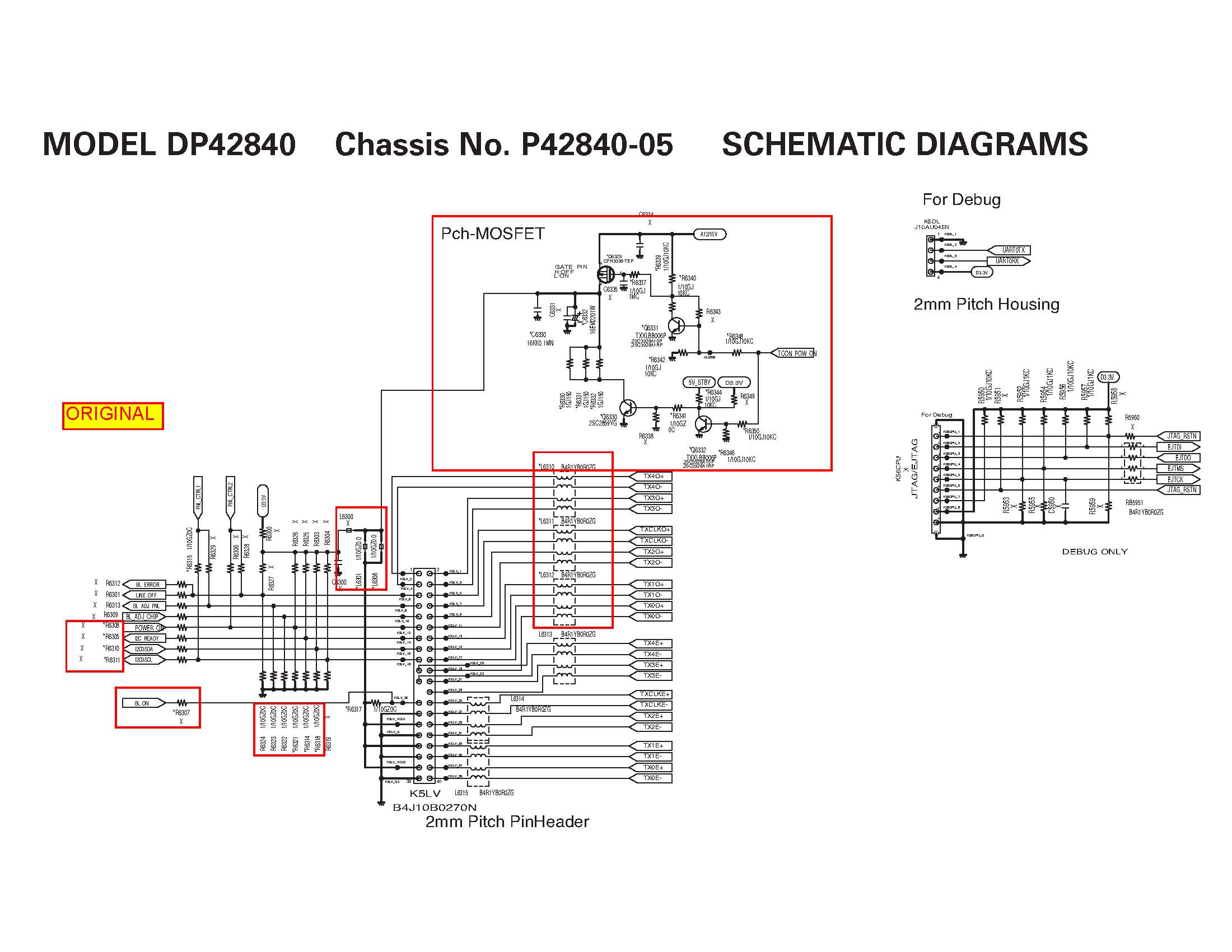

                        Look at the two PDF I attached so you can see what are need to be removed and added, it is tedious works so you need to look at the diagram of both boards and make the board you are trying to use to be the same as the original.
                        Print out both diagram and mark the differences.

                            Did you look at both diagrams? That section is just part of the whole board that I know are not the same, who knows what else in the board that are not the same.
                            You want me to do all the work for you? I provide the marked up for you to look at, so do some works!
                            See how many parts you need to add/remove?
                            Print them out and look.

                                    As you can see, your original board diagram in the 'Pch-MOSFET' section that I marked, it has the 3 Transistor and the MOSFET, resistors, caps to receive the 'T-CON POW-ON' signal. The board that you want to use does not have that section stuffed with the components.
                                    I do not even see how the board you want to use get the 12VDC to feed the T-CON from since the inductors are not in place either due to the fact it is made for PLASMA..
                                    http://www.shopjimmy.com/panasonic-t...ab-d-board.htm
                                    It does not get the power through the LVDS cables, not like your LCD panel.
