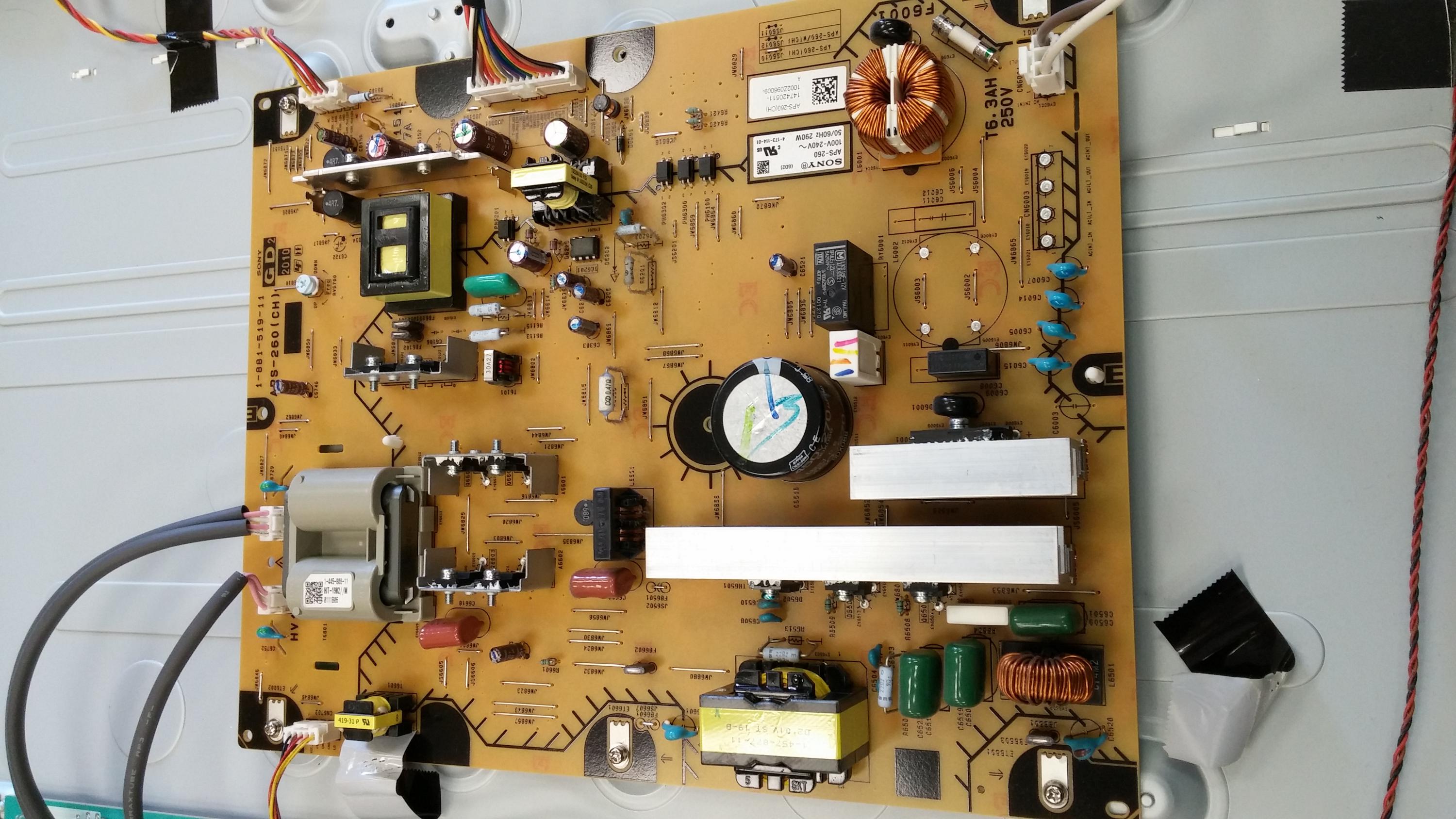

        Check the BLon (backlight) pin on the PSU. Does the backlight come on at all (maybe for a second or 2)? Check the main filter cap for >360VDC when the tv is on. Also do the flashlight trick on the screen if you do see a picture.
        Also post a straight shot of the PSU with the pin out (top left).

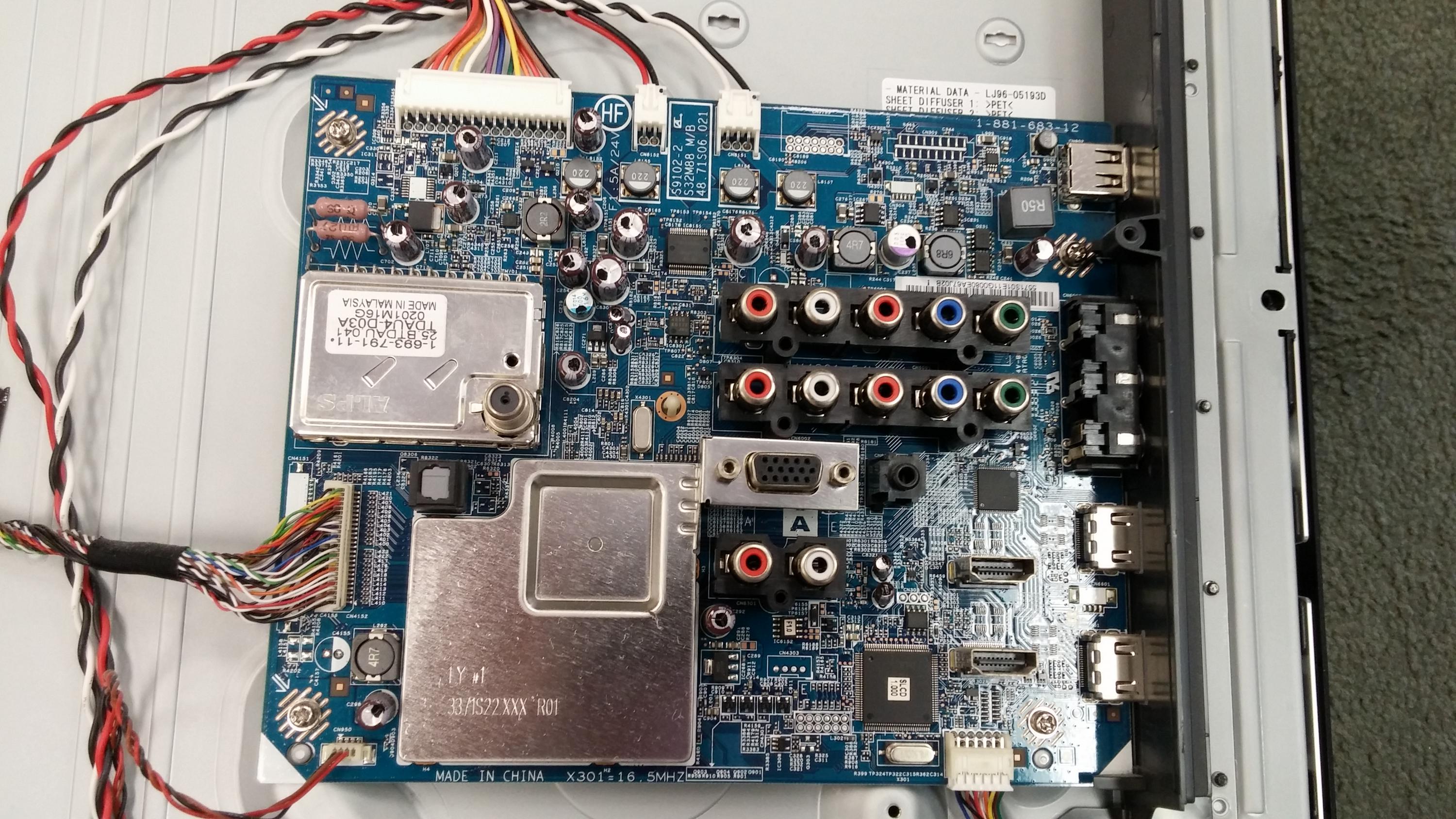

          Just replaced the main board on the TV today and still getting the same issue any other suggestions? I tried the flashlight trick and got nothing so there the backlight I believe is fine. With this mainboard I am getting the red light blinking 6 times when the TV is plugged in but off.

            Also this time the startup scenario it chimes 3 times instead of 2 times like it did before. I am not sure what the names of each of the boards on the TV are. Obviously I know the main board but what are the names of the other boards and where else should I check. Most other TV's that I have fixed have been cap issues or something where I could pinpoint the problem and replace parts I have never had to us a DMM and check voltage and don't really know where to start if someone could help me with how to begin and where to start with this TV to try to track down the route of the problem I would appreciate it.

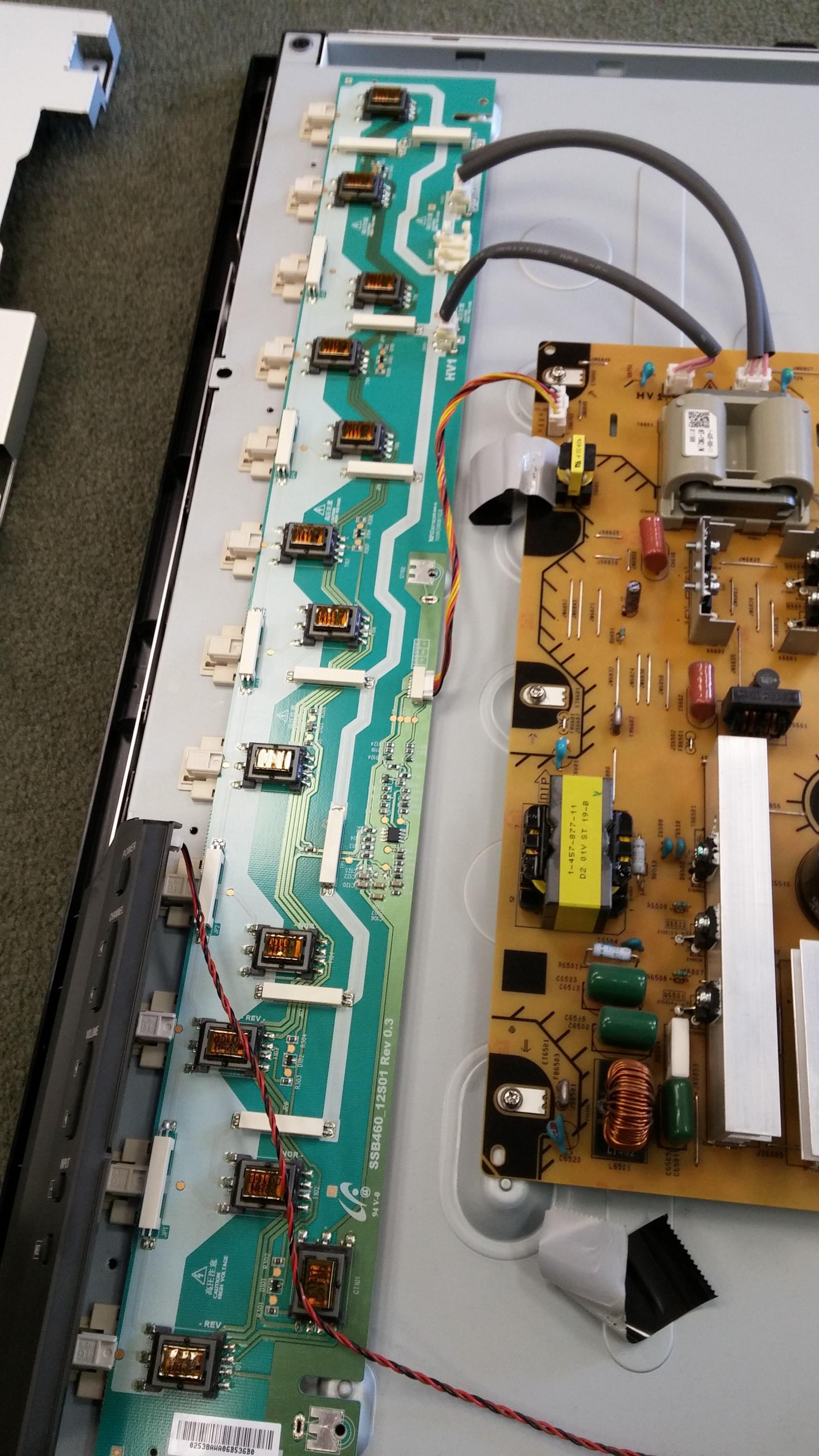

              no sure how to read this as there appears to be some words missing.... "I tried the flashlight trick and got nothing so there the backlight I believe is fine". Is there or isn't there any backlight happening... ever? My "read" would be that you have a backlight issue somewhere.
              check fusing on the inverter board.

                Sorry for the confusion I posted this a while ago and I didn't have access to the TV again to look at it since it is a friends and not mine. I told him that it was a possible main board issue that he could order the board or I would have to look at it further it was up to him so he ordered the board and I just got a chance to go replace the board but that did not work. There was a previous suggestion of trying the flashlight trick to see if I could see picture. I tried the flashlight trick but there is nothing.
                So what is going on is when I first got to look at the TV when you turned it on the green light would come up and flash and the TV would chime twice about 20 seconds apart and then shut down and the red light would blink. There was never any signs of the backlight. My friend bought a new mainboard and I replaced it now I am getting the same symptoms but it will chime 3 times at startup instead of 2 but there is still no backlight and the TV will shut down after the 3rd chime and the red light blinks 6 times.
                I would like to think of myself as pretty mechanically minded and with direction I can usually fix most problems. With TV's I have mainly been able to fix bad capacitor problems and other small issues I have never really tracked down a problem like this and don't know the names of the boards or which one is which. What board is the inverter board and where do I start? Do I need to check voltage? I know how to use a DMM just don't know where to start and what I should be checking. I am kind of learning more and more with each TV that I am asked to look at its kind of a hobby almost I like to be able to fix things instead of seeing them thrown out.

                  You should find the service manual somewhere (and for free)... especially for sony. I think most show that code as issues with the backlighting and since you never see it, I suspect that's where your problem lies. It could be a fuse (doubtful.... but maybe but usually that will mean there are issues further).

                    Page 19:
                    6X Blink - Backlight System Failure (46” Models)
                    The 46” models have both a 4X and 6X blink protection mode. The 4X blink will, in most cases, be caused by a defective lamp.
                    Because all the Backlight HV Inverter circuits are located on the GD2-Board, a 6X blink protection mode will be fixed, in most cases, by replacing the GD2-Board. If the GD2-Board does not repair the problem replace the A-Board. The BL-ON and Dimmer signals come from the microprocessor on the A-Board. A shorted or open BL-ON signal will cause this 3X condition. Also a shorted Dimmer will cause this 3X condition.
