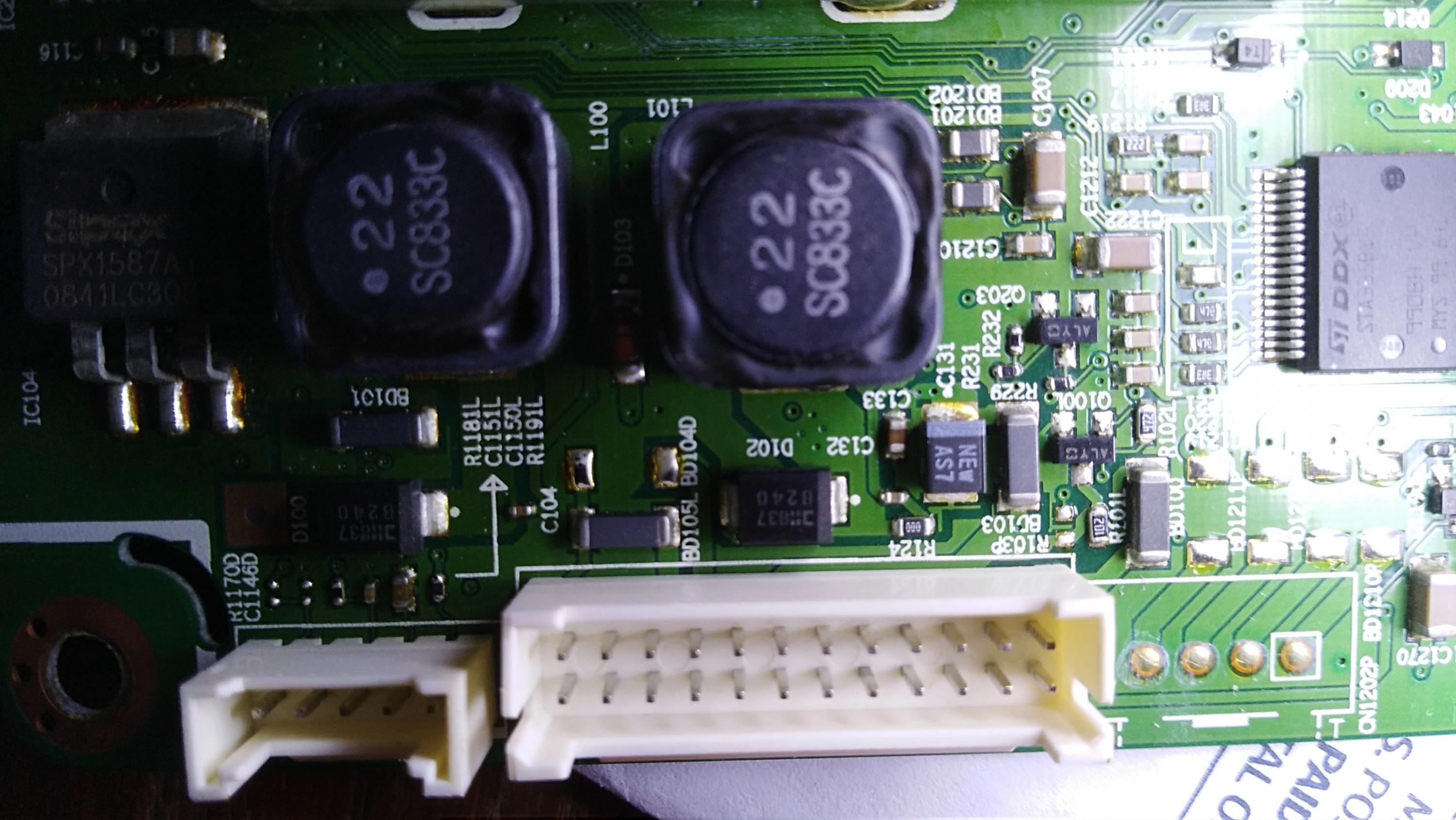

      Re: Samsung LN52A650 Visual Artifacts & Repeatedly Power Cycles
      Originally posted by Shane711
      OK, so I had 2 of these TVs power cycling. I changed out CAP C132 on both main boards and then played a 2 hour movie with each main board and there is no power cycling. Success!
      were can i buy this part ( CAP C132 )
      • tv_guy6969
        • Sep 2015
        • 3
        • united states
        where can i buy this part CAP C132
          See POST 14 if c132 has the same marking as indicated in post 14, otherwise show us good clear pictures of C132.

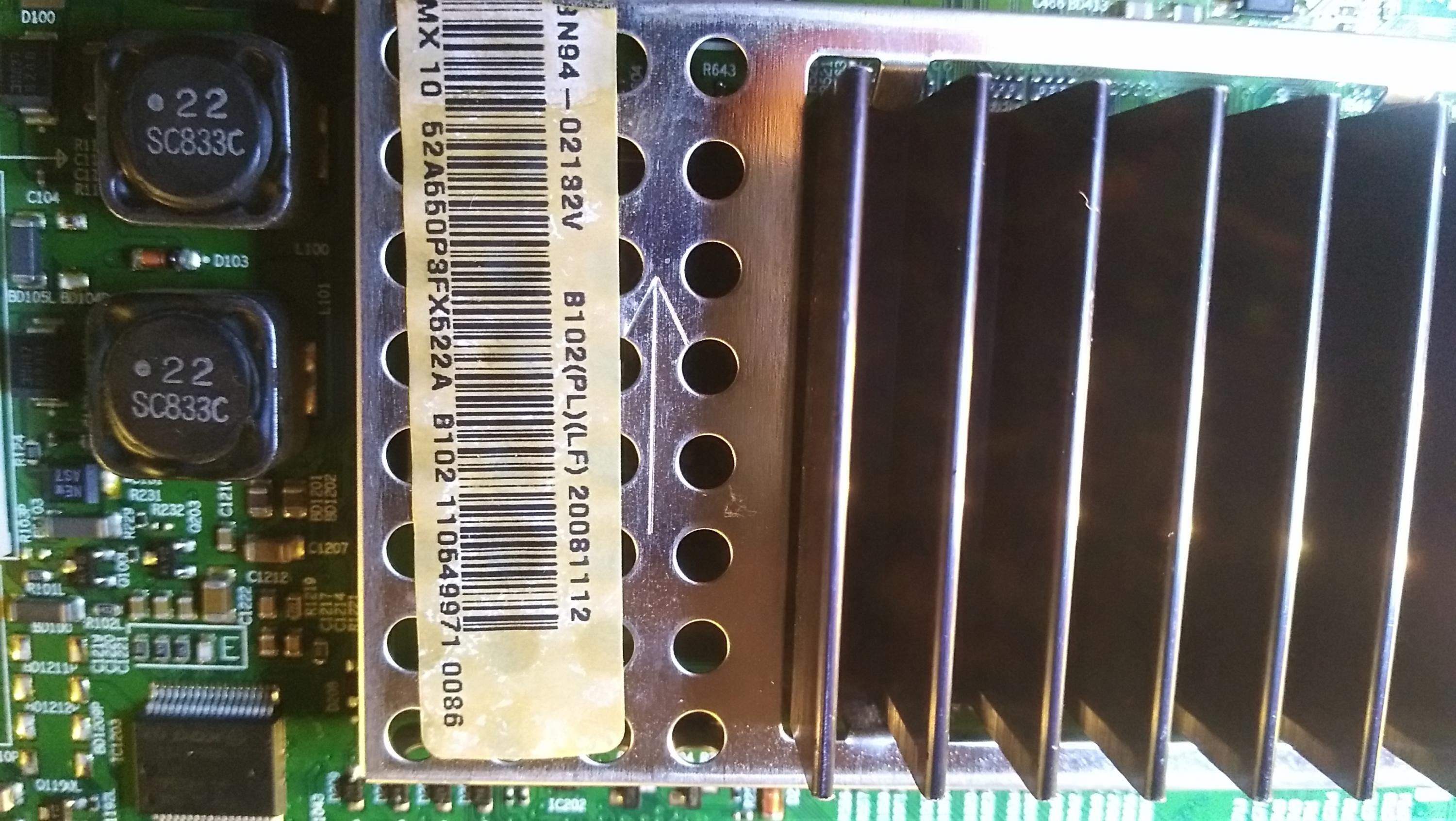

          • captainKKK
            • Sep 2018
            • 287
            Ok, I am about to try the C102/C131 cap replacement fix. The C132 is shown in the best pic I can make and it is beside the C131 and I would like to know if its replacement is necessary? Last 2 pics are my board numbers.
            • captainKKK
              • Sep 2018
              • 287
              Thanks BudMan, your info fixed my LN52A550P3FXZA perfectly....THANKS
