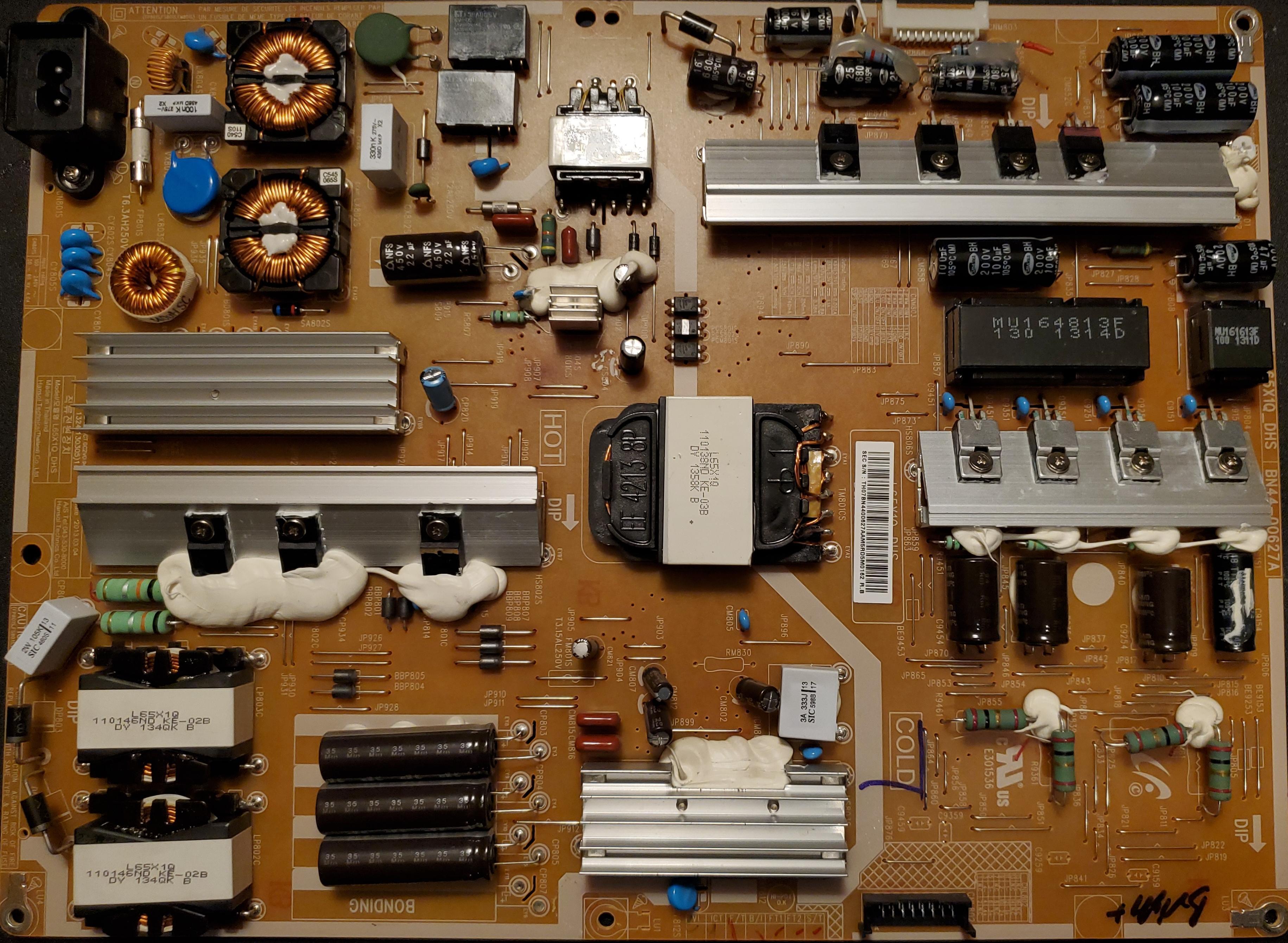

    Hello all,
    Samsung 65" TV that randomly power cycles. It could be a few hours or a few minutes and then I hear a click sound and reboots. I have updated the firmware to the latest. I'm suspecting the power supply might have bad caps (hoping 🙏...). Inspected the PSU board and none of the caps have any bulging, leaking, or unusual noises that I can hear. Any suggestions? Thanks
    PSU: L65X1Q_DHS / BN44-00627A
    Model: UE65F6400AFXZA
    Ver No: MH01

    bulging caps not the only sign of bad one.. ESR measurement the correct way, if you are not able to measure ESR, i would suggest you to replace all caps at the Cold Area, they are not expensive.
    • lotas
      • Jan 2016
      • 4759
      • Russia
      Check the cable and its connectors that connect the motherboard to the power supply (burnt contacts, poor contact), a common problem in this chassis.
