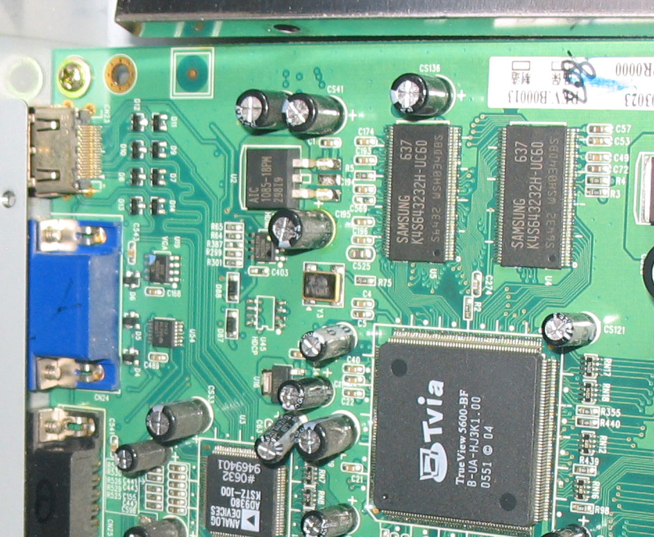

        Re: HDMI Headscratcher Hannspree 37" YTO8
        Look at the main board where the HDMI port is, there is should an IC close by.

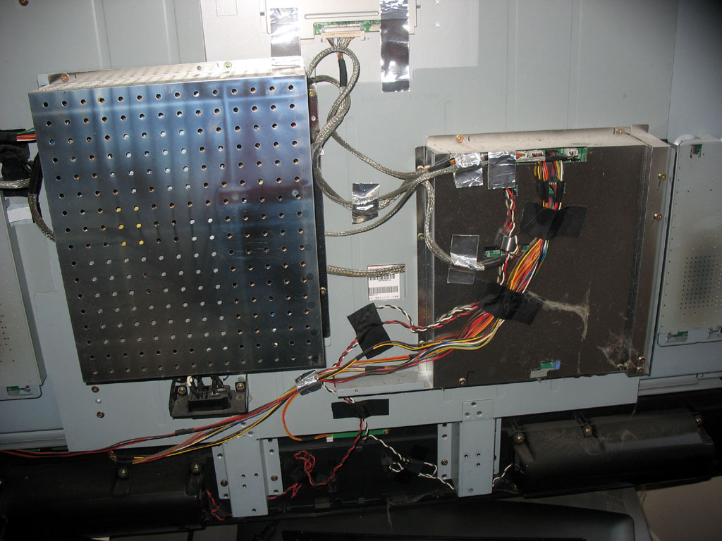

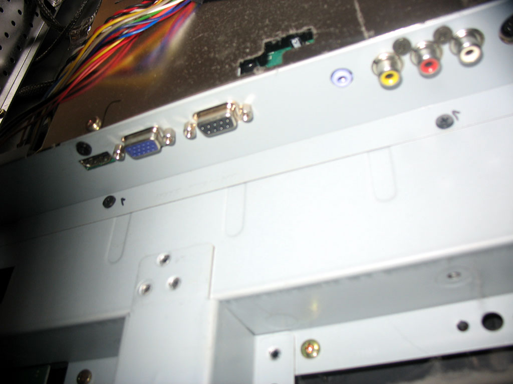

              OK, got the backoff alright
              The hdmi port is inside a silver box casing alomg with other stuff (see pics)
              The port seems tight enough
              I'm a beginner here, what do I do next
                You need to remove that shield.

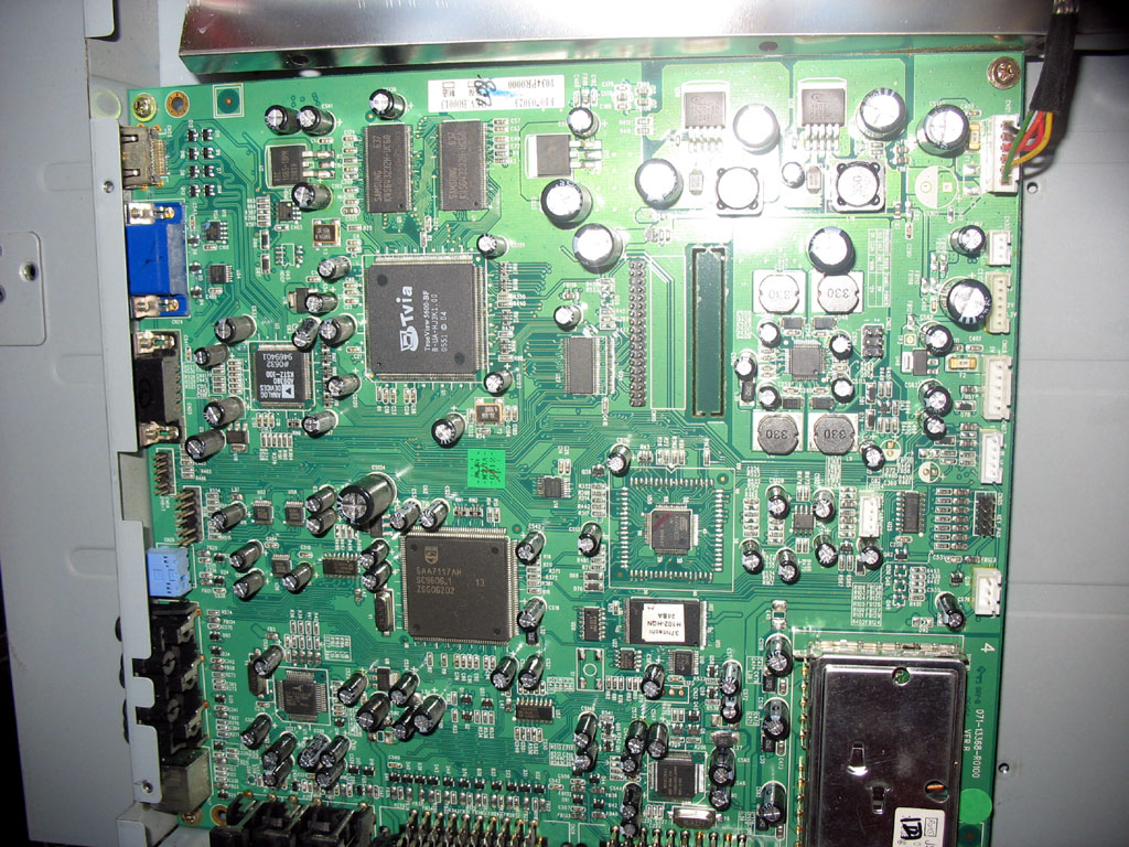

                  OK, hdmi is at the top left, what am I looking for?

                                    i have found the number i think in one of your pictures its used in a few makes of tvs i would look at each make of tv this board is used in ie hitachi etc and try the service menu code and see if it works on your tv then try a factory reset im not sure what else to suggest if not
                                    https://www.google.co.uk/#q=071-13368-r0100
                                    some of these are for hitachi using your mainboard
