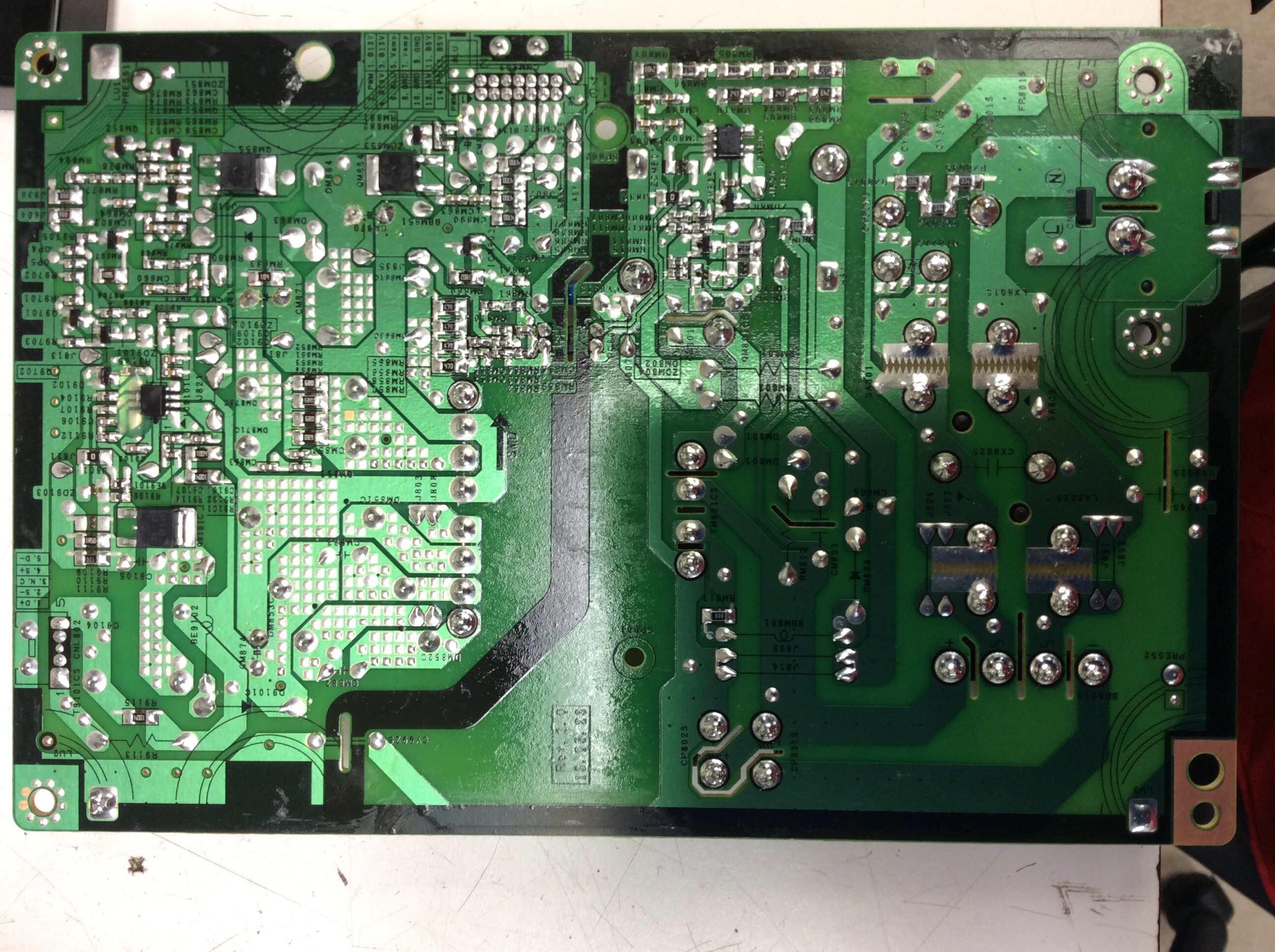

    Have a samsung that will not power up. I get no standby light or nothing. Main caps on ps read 163v, and connector cnm803 I get no readings on any of the pins, need to know where to start looking thanks.

    Re: Samsung un32eh5000fxza no power
    Back side of ps
      This PSU has no PFC booster. 163V is correct at the main cap. I would check the diodes around the main cap.
        do you get any standby voltage on that connector on the bottom?
            Check the DCV BETWEEN the two legs of the startup cap CM806. You MUST BE REAL CAREFUL since you will be working int he deadly primary side of the circuit so I hope you know what the precaution you MUST take when working in the primary side.
              I am getting 10v to 11vdc on cm806, the person I got the tv from says they just went in one day, and it wasn't working. I get no readings on any of the connectors on the power supply
                so problem is in either the feedback or in the primary section. First I would look hard on these square blue caps in the primary. Take them out and measure those.
                  10~11VDC may be too low for the SMPS IC to start. Can you look at the P/N of that 8-pin SMD IC in that section where the cap is?'
                  You can also try heating up that cap to see the STBY power supply will startup, or you can just replace the cap.
                    Replaced the cap, still getting same readings, also checked blue caps and I get 118v on both. Pn is s3310343 on the 8 pin SMS ic. Everything seems to be fine on hot side, but nothing on the cold side, what connects the two?
                        S3310 is on the top then 343 is the second line, if I am looking at the right chip
                          ICM801 is the designator for that SMPS IC.
                          S3310 looks to be the correct P/N.
                            just ordered a power supply from shop jimmy for $30, should be here within a couple of days, maybe Monday at the latest, will update, thanks for all the help
                                  update, got a new power supply from shopjimmy, and everything is working fine, thanks everyone
