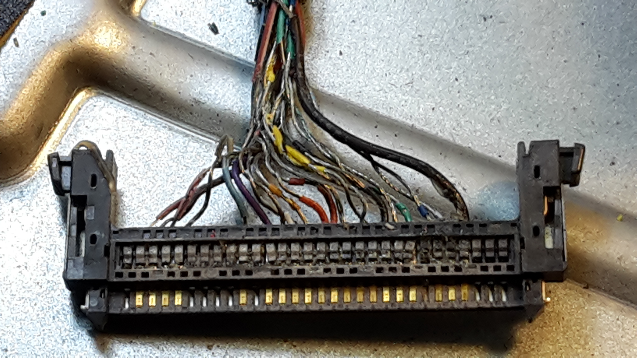

    I have to admit that I find it difficult to walk past something potentially useful in a bin/skip WHY. In this case it was an old Sanyo CE32HW (Vestel) LCD set someone had thoughtfully left sticking out of the appliance disposal bin in the local shopping centre.
    It's clearly had a hard life, but so evidence of ever having been repaired before.
    I powered it up and was rewarded with nice clear sound, backlight, but no picture.
    A quick look inside revealed a few swollen cap's on the power supply panel- replacing those made no difference, which didn't come as much of a surprise really. (the remaining ones checked OK on a ESR meter).
    Having read of a similar problem on another thread I decided to have a look at the T-con panel, skilfully hidden away between the metal panels. And there was the cause of the problem, clear to see. For some reason all the insulation on the last inch or so of the cable from the main board to the T-con board had disintegrated, leaving the bare wires to touch each other.
    I haven't yet got around to 'repairing' the cable, it will have to wait until I am really bored and have nothing more useful to do with my time. Plus of course the possibility that some of the shorting wires may have caused damage to the main board???
    Has anyone seen this before, or have any explanation as to why this may have happened? There is no evidence of water or any other fluid- just the heat off the back of the display perhaps?

    I have seen this before on vestel's when I put the incorrect main board that was for a different panel into the set it burnt the lvds to a crisp like yours. Is the mainboard the correct one for the panel used ?

      If the mainboard was damaged it wouldnt power on at all. This is just a bad cable but it looks like it got burned heavily.... :o
      I would not repair this cable , just get a new one from ebay for 5$.
      I wouldnt be surprised if the T-con is damaged also.....

          It can happen on any tv and you are wrong the mainboard will power on I have had it where the section the powers the lvds burns up due to being in a incorrect panel but the rest of the tv would still power on.

            Also you cant just use any lvds not on these vestels you need to get the exact lvds for the ce32hw if you get a ce32ld81-b it wont work as you HAVE to get everything that drives the panel correct.

              I am pretty sure the correct boards are fitted (assuming Vestel got it right??), as I do not think the set has ever had any attention- going some for a Vestel of this vintage!
              I hadn't thought of the t-con being damaged, as it is 'after' the event, but of course power could have been applied to the wrong pins due to the lack of insulation. Really wondering if it's worth wasting any more time on it, what's it worth at the end of the day? But I do enjoy tinkering so it'll probably happen one day!
              I will post back with the results- even if the boards end up in the panel cemetary!

                I would normally, but where I live (Portugal) the shipping cost is usually prohibitive, especially for small, low-value items. It would be different if the set was worth anything (or if it was a paying job!) but as it's a play thing... you know the rest!

                  What mainboard and panel are in the tv 17mb22 ??

                    I don't think it can be repaired, areas of the connector shell are melted and contacts have been damaged. I would be surprised to not find similar heat damage to the connector it mates with. I'd toss the whole thing.

                      It is a 17MB15E-7.
                      I had a quick check around the t-con board, on of the tiny CP's (CP101) is o/c.
