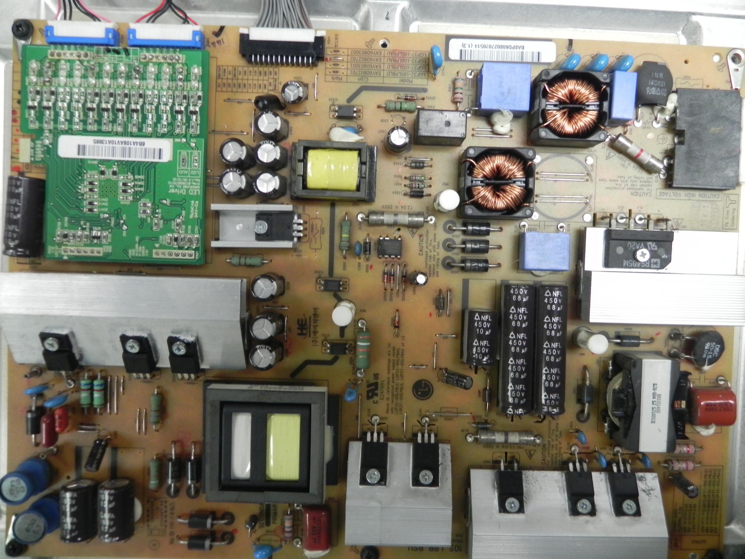

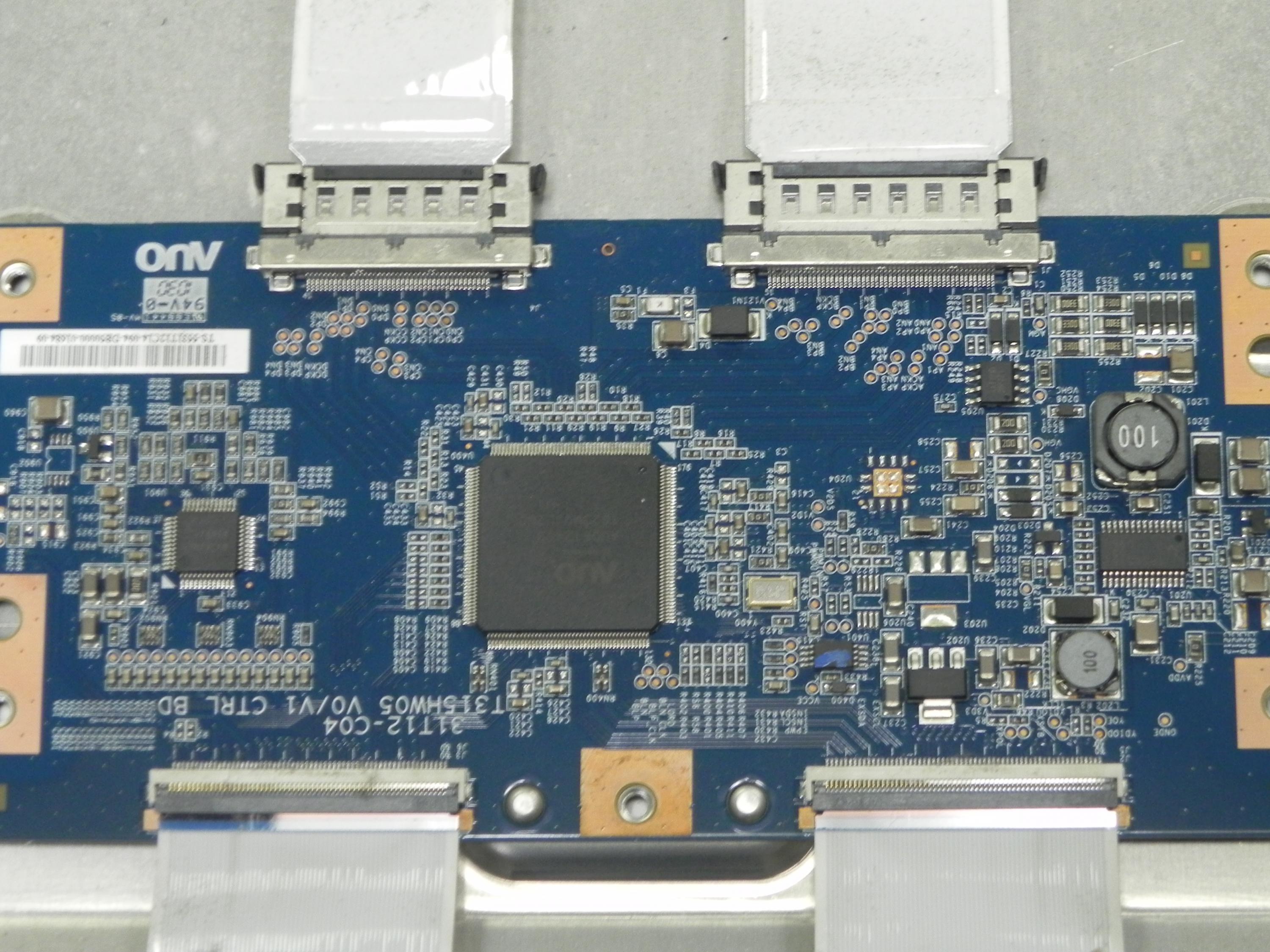

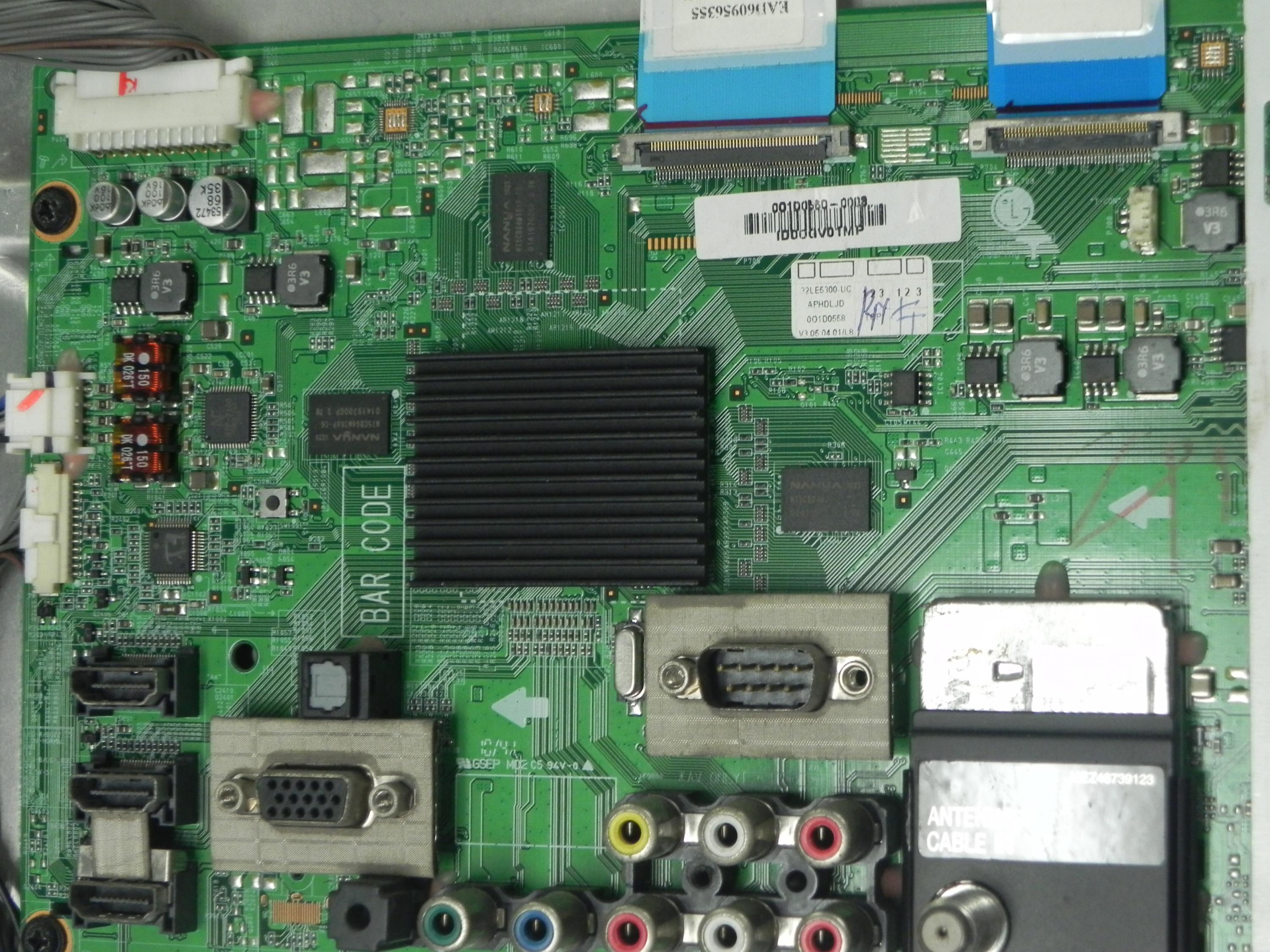

    I've been asked to repair an LED televion 32LG5300 model. Set is fine till it warms up after 20 or so minutes, then the backlight turns off. The main board was replaced twice already for this same problem before, once within warranty and the last one months later at the owner's expense. Is there a design problem or known issue with this model line?

    Probably failed leds again seen it on the 42" version of this set check if what voltage goes to the bulb connectors.

      Re: Any known issues with 32LG5300 LED TV?
      Posting pictures of the back of your tv showing the boards with clear pictures may help you more with fixing your problem
        Beside up loading the pictures, try reducing the backlights level to about 50% to see if the backlights will stay on longer, I will not be surprised if you have bad LEDs.
          Here you go:
            So did you try reducing the backlights level to see if the backlights will stay on longer?
              I do not know exactly about this LG model. I have experience with some Toshiba and Samsung (both models had Samsung screen).
              Whenever two LED strips are connected together there are bad connection between connectors. Some connectors even becomes yellowish color.
              In beginning TV working fine then intermittently screen goes black. And after some time TV screen does not light up at all.
              I bypass those connectors soldering wire and TV works fine then.
                Sometimes, the LED fails (die-bonding failure), this is usually intermittent causing the LEDs to flash on and off but after the first fault the set usually turns off the backlight as a protection.
