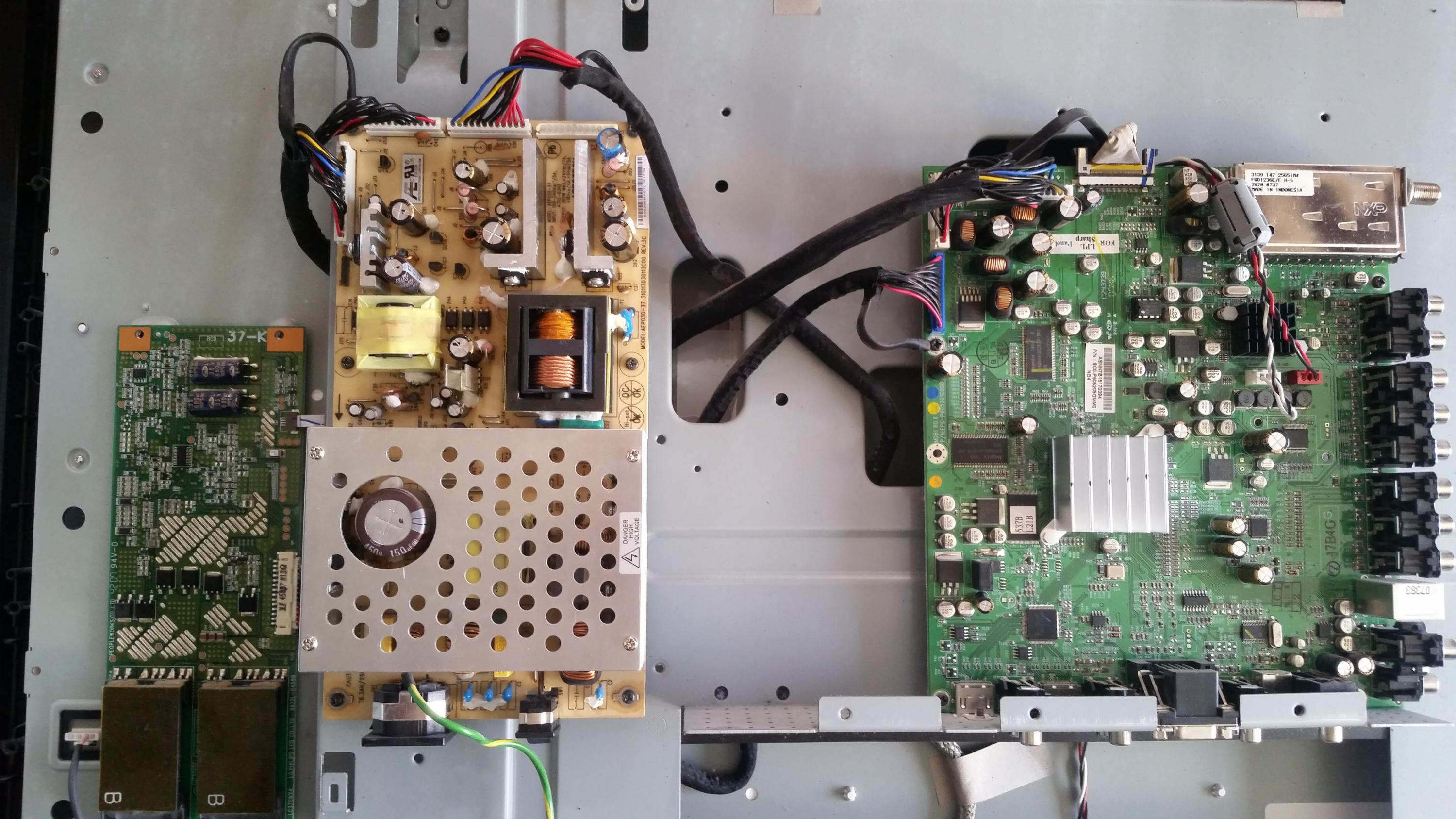

    You also need to upload good clear pictures of all the board and the whole backside of the TV.

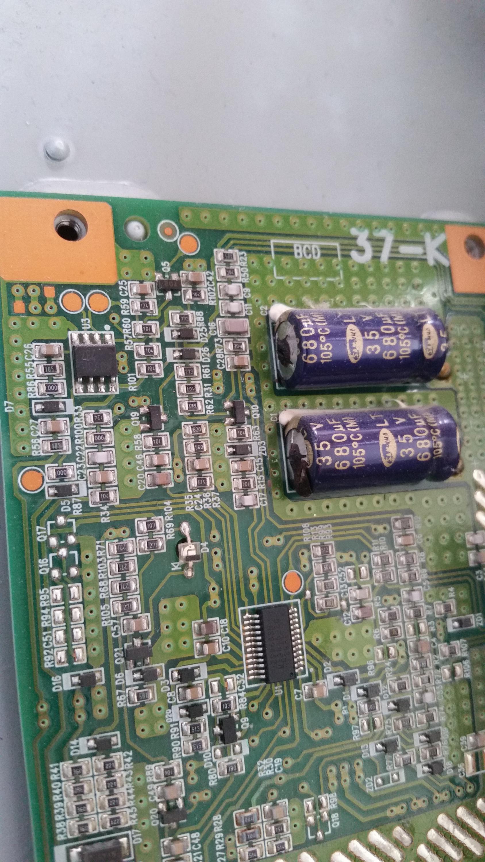

                      Hey guys update is here, all of your suggestions opened my mind specially budm's, and I think I might have found the problem. Here are two pictures, the first with all the boards uncovered and the second one showing two caps blown on a small board to the left of the power supply that is fed by the section of the power supply that I was having problems with. You guys are awesome.
                      As soon as I replace these caps I'll update to see if that fixed the problem
                      Thanks a lot

                            Re: Olevia lcd tv continuously blowing a cap on power supply
                            Good, you found the cause of the problem, make sure to use Low ESR with 105c temp rating for those two caps on the inverter board.
                            This why it is important to show the pictures.
