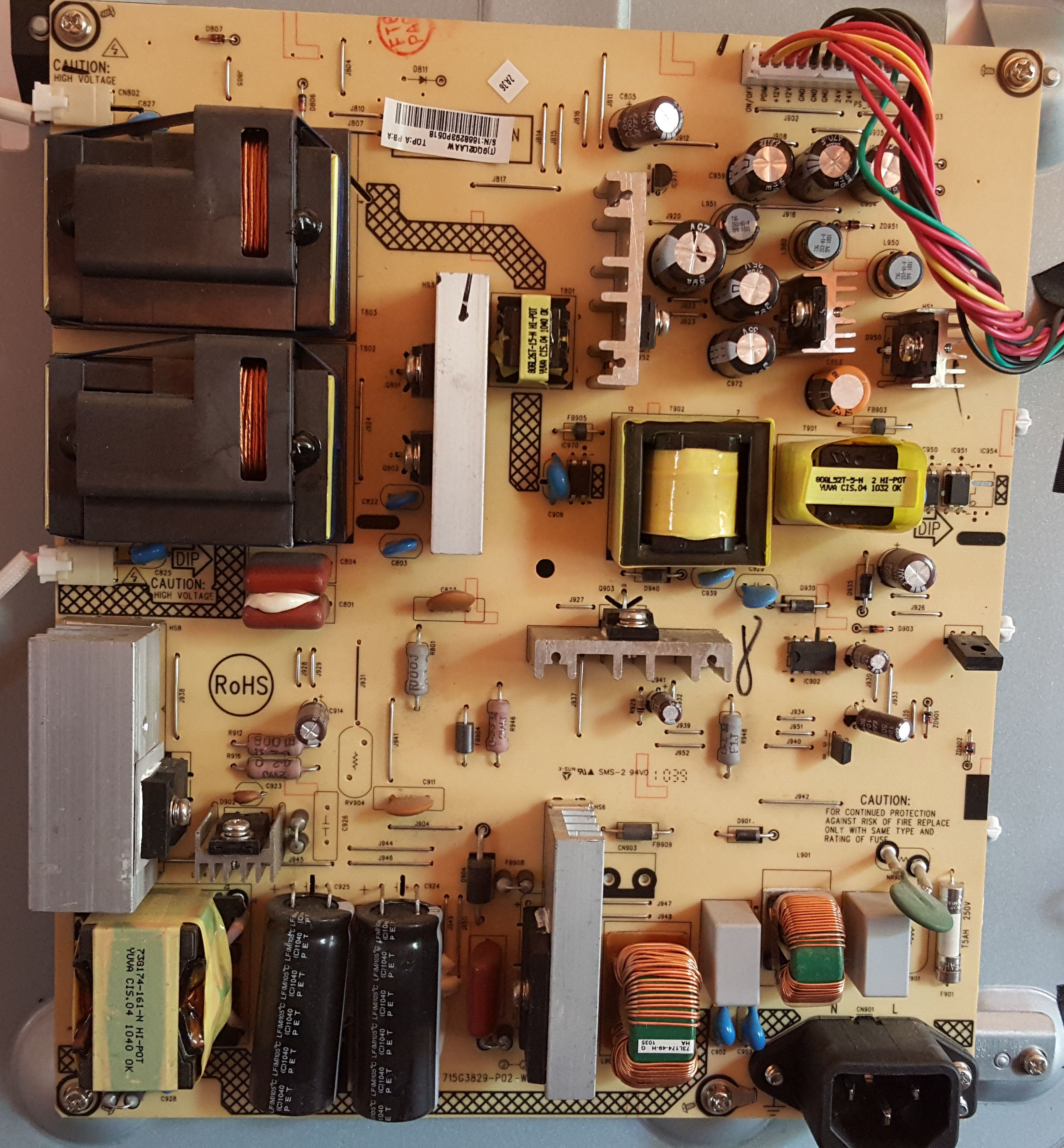

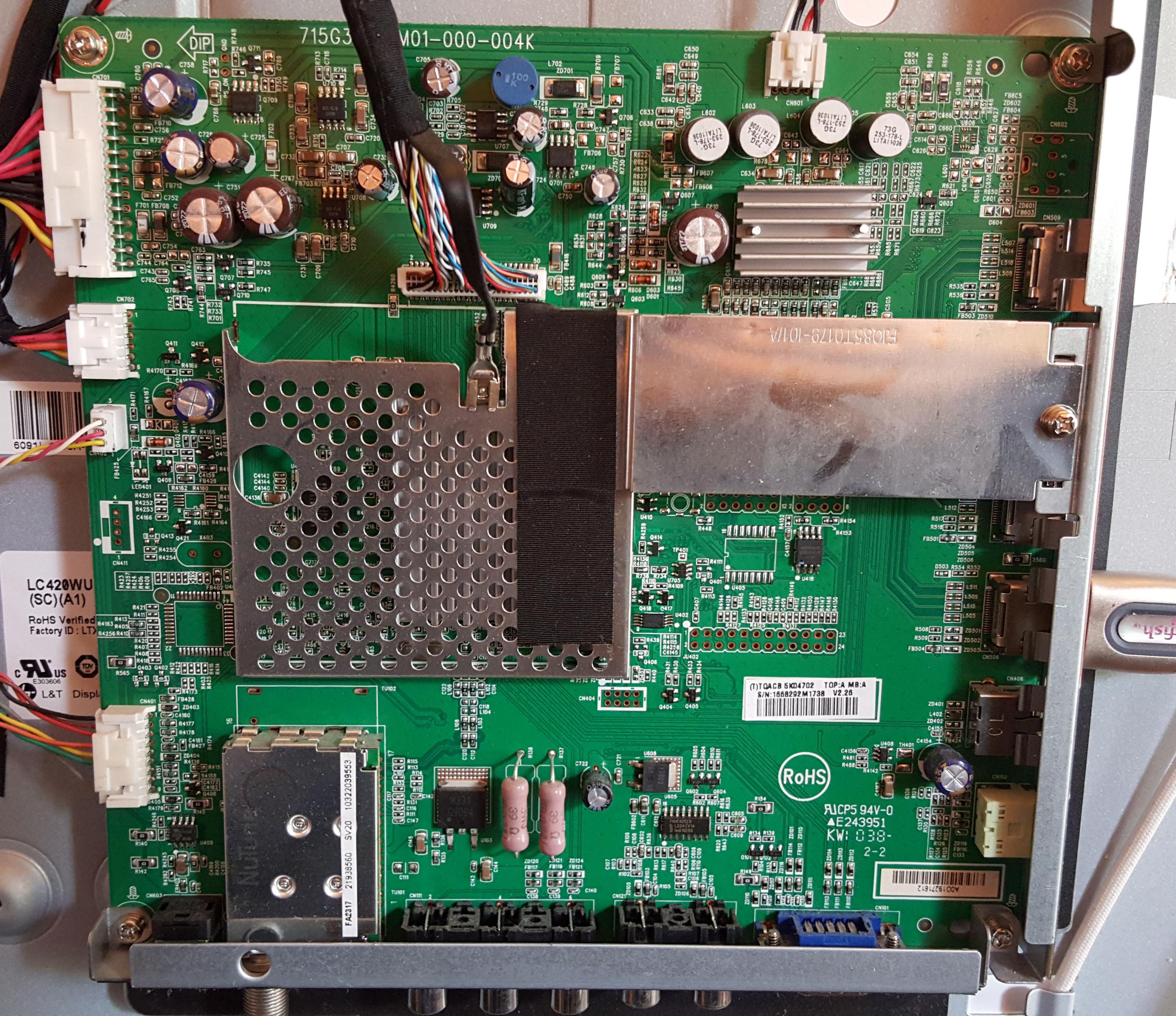

    Here are pictures of the power and main boards. I'm thinking this is a main board issue but am providing a pic of the power board just in case.

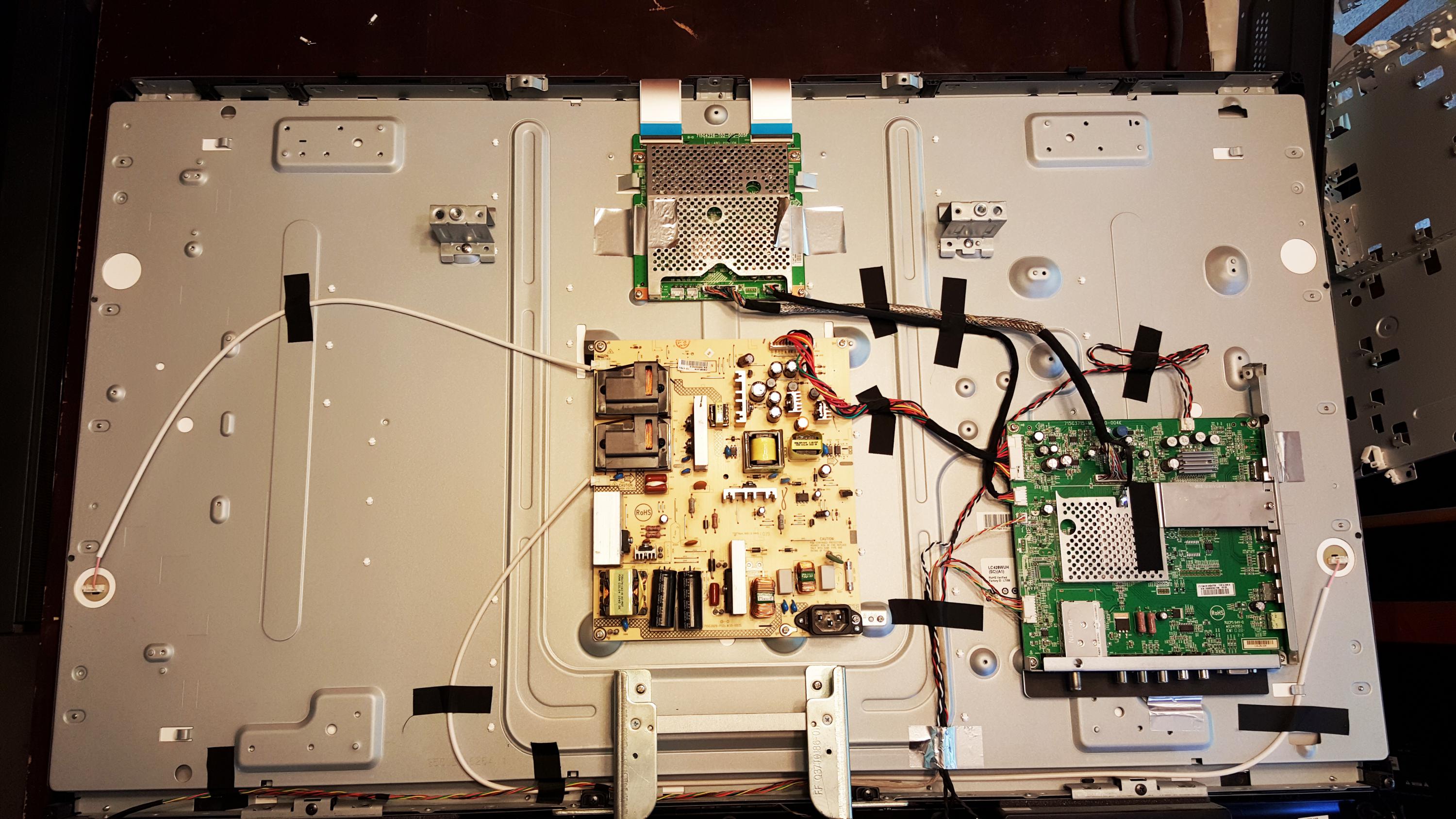

    Pictures of the whole back side of the TV so we can see all the boards?

      Here is a picture of the whole backside of the tv. The T-con has a metal shield soldered to it, so it's someone hard to see, but I'm not having any luck finding a fuse on it. Should I get that shield off there?

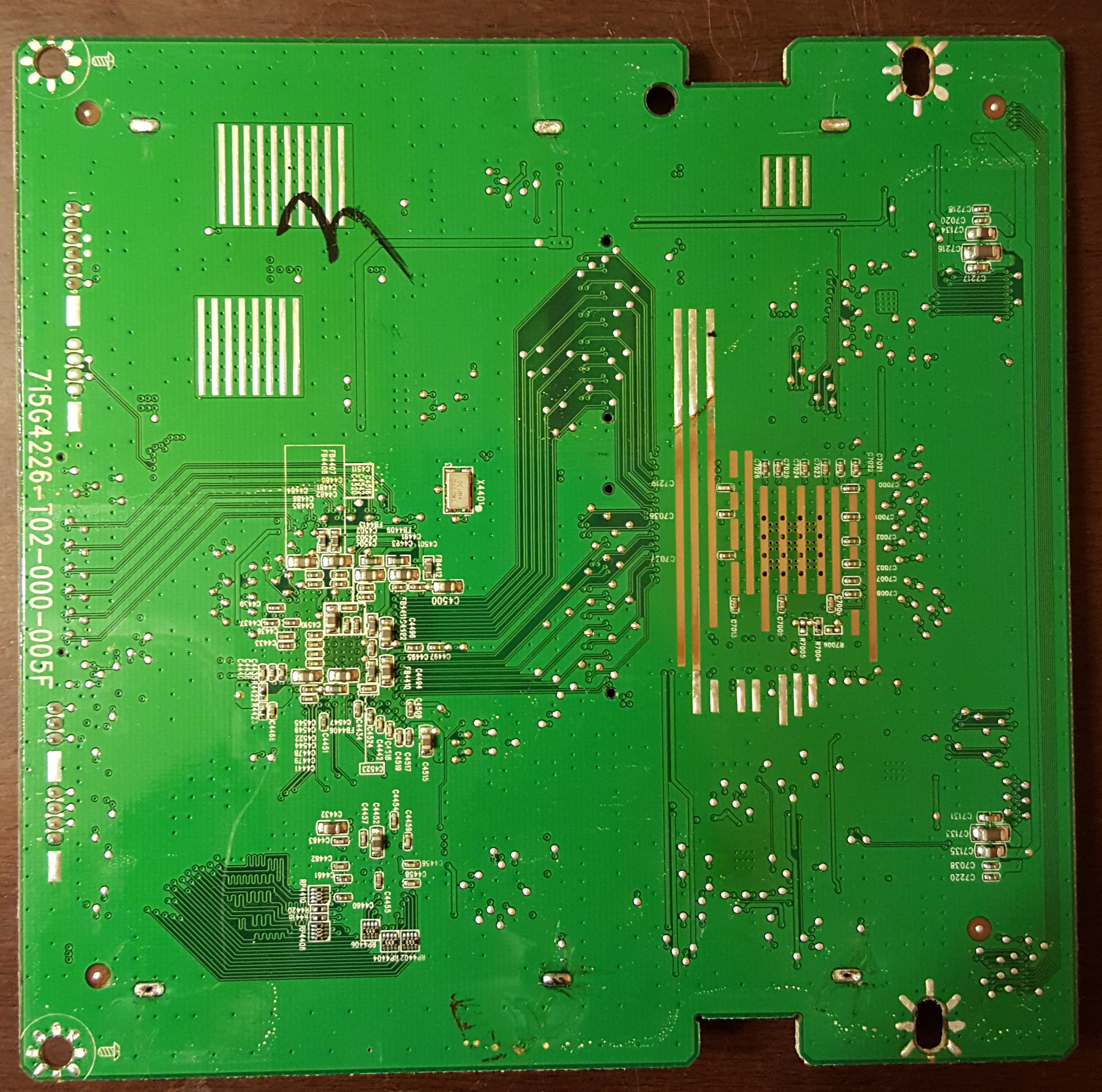

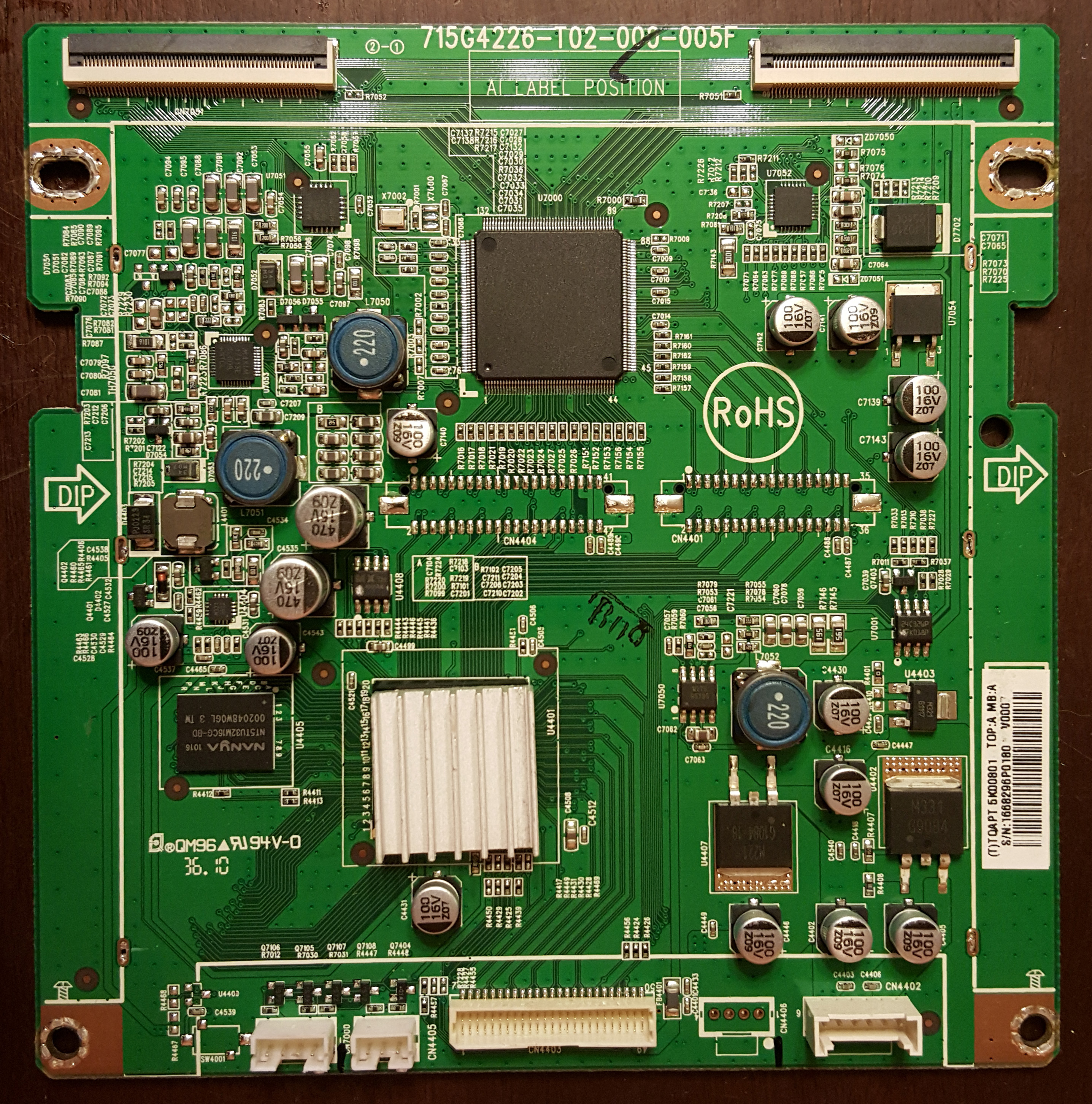

          Alright. I removed the shield. Here are pics of the front and back of the tcon. I still can't find a fuse on it. Am I just missing it or is there no fuse on this one?
          Thanks!
            Re: Vizio E421VA - no picture
            OK, it looks like the Voltages are fed into the connector CN4402 without fuses, I see at least 2 input filter caps: C4402, and C4405, so check the DCV on the positive legs of those 2 caps with ref to chassis GND.
            There is a ferrite bead FB4401 on the LVDS connector so see what DCV you have on that FB4401.

              Alright:
              C4402: 11.93V
              C4405: 5.01V
              FB4401: 11.88V
                OK, you do have Voltages (12V and 5V) to run the board.

                  Yes. On the power board output, the 5V pins read 5.0V, the 12V pins read 11.9V, and the 24V pins read 25.0V

                    Well all the running Voltages are present, so it is either the main board is not sending the signals to T-CON board or the T-CON board is dead even though it is getting the power.
