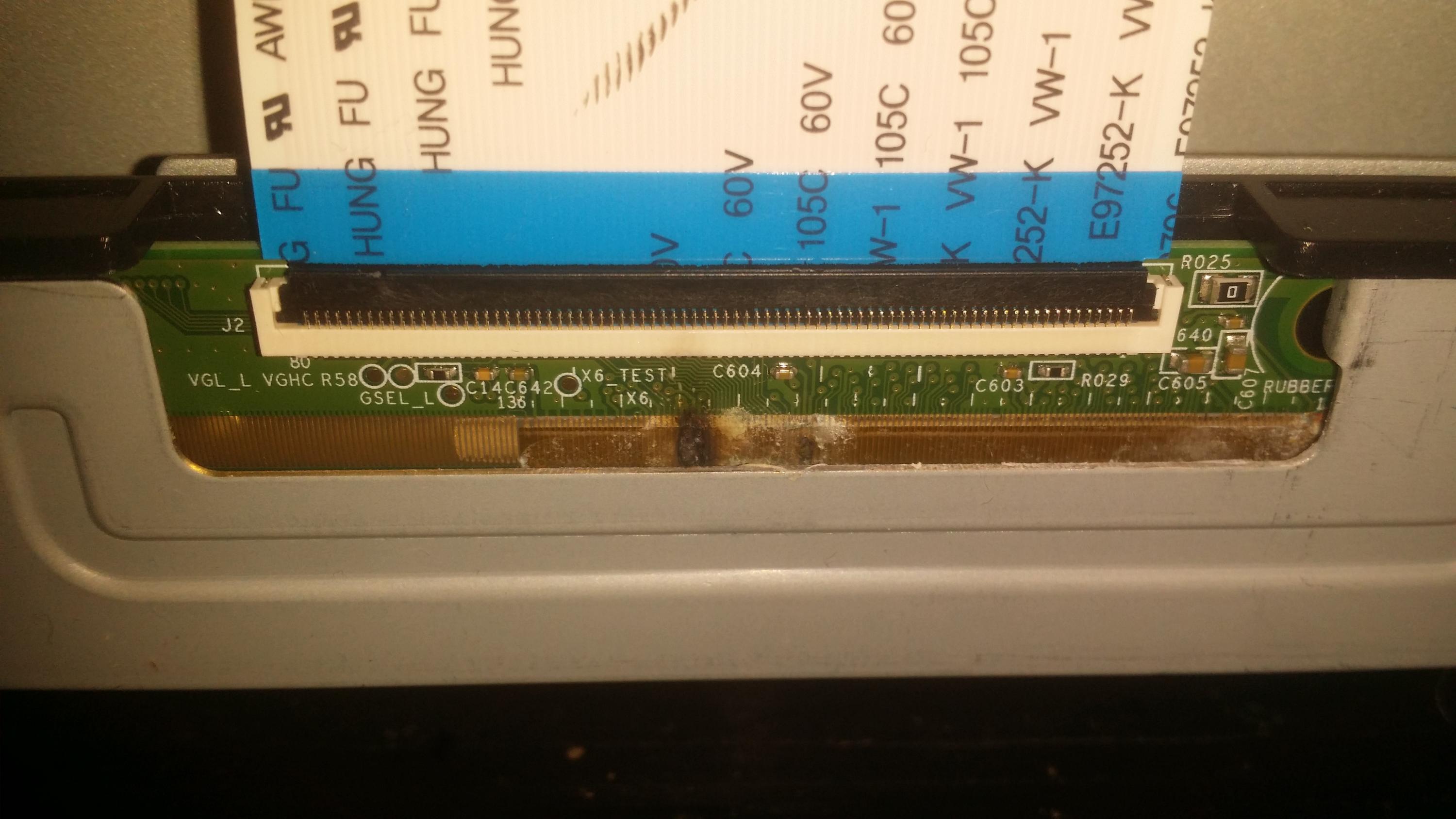

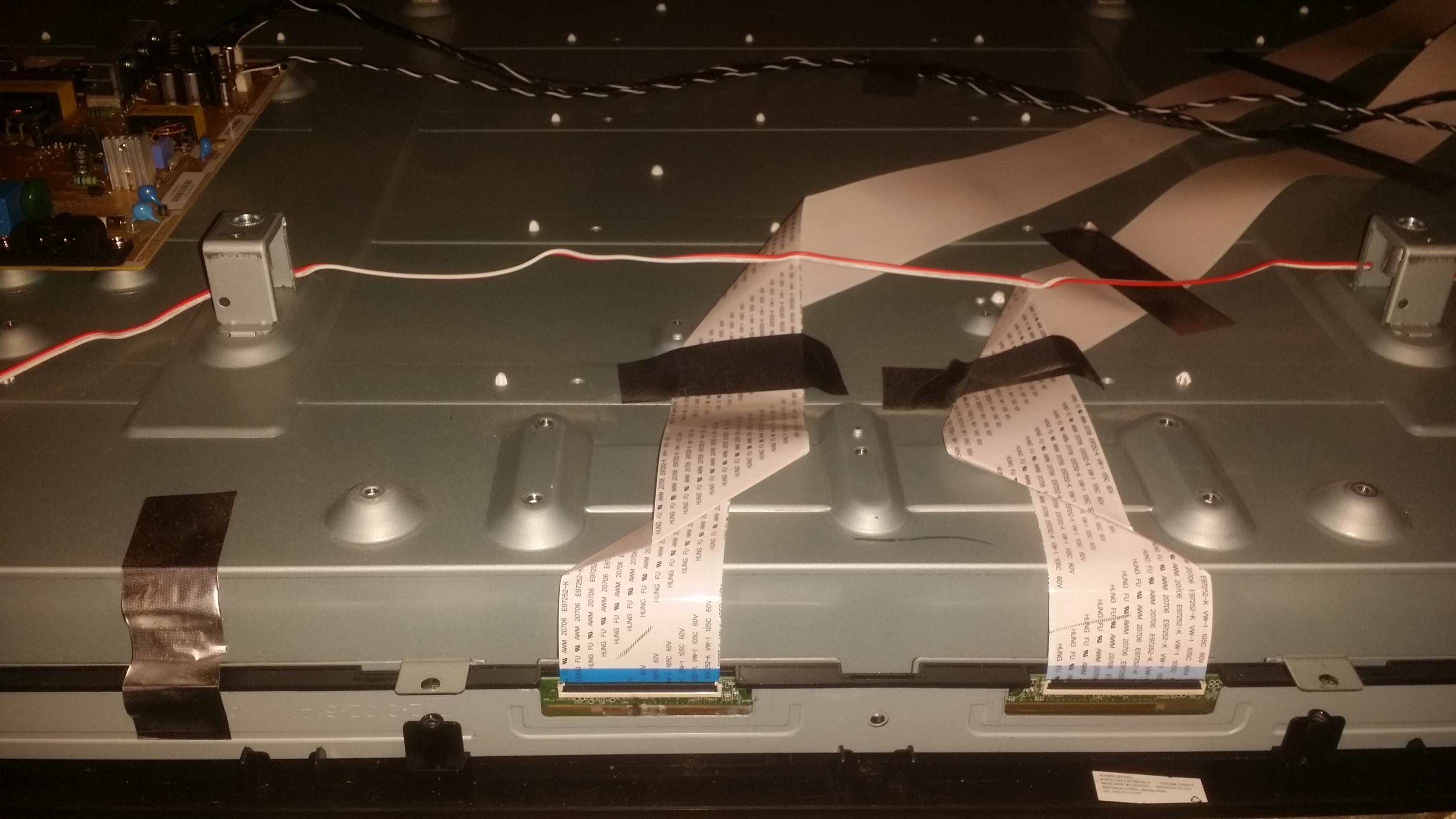

    I will try to get a picture posted. The boards are barely visible, and I've never posted an image to a forum before

      Board in question is probably the T-Con board. To post a photo: when you reply to a post, select "manage attachments" under the "Additional Options" section.

            Do you have 12Vdc at both ends of the SMD fuse on the T-CON board with ref. to the chassis GND?

              #46
              Re: Vizio E550i-a0 no turning on
              water damage... that sux... problem is you just can't switch out that board, because it is tab bonded to the panel.
              • vinceroger69
                • Mar 2012
                • 6714
                • uk
                #47
                Good on spotting that i missed it the first time i glanced at the pictures but as you say fluid damage usually un fixable requires a new lcd.
