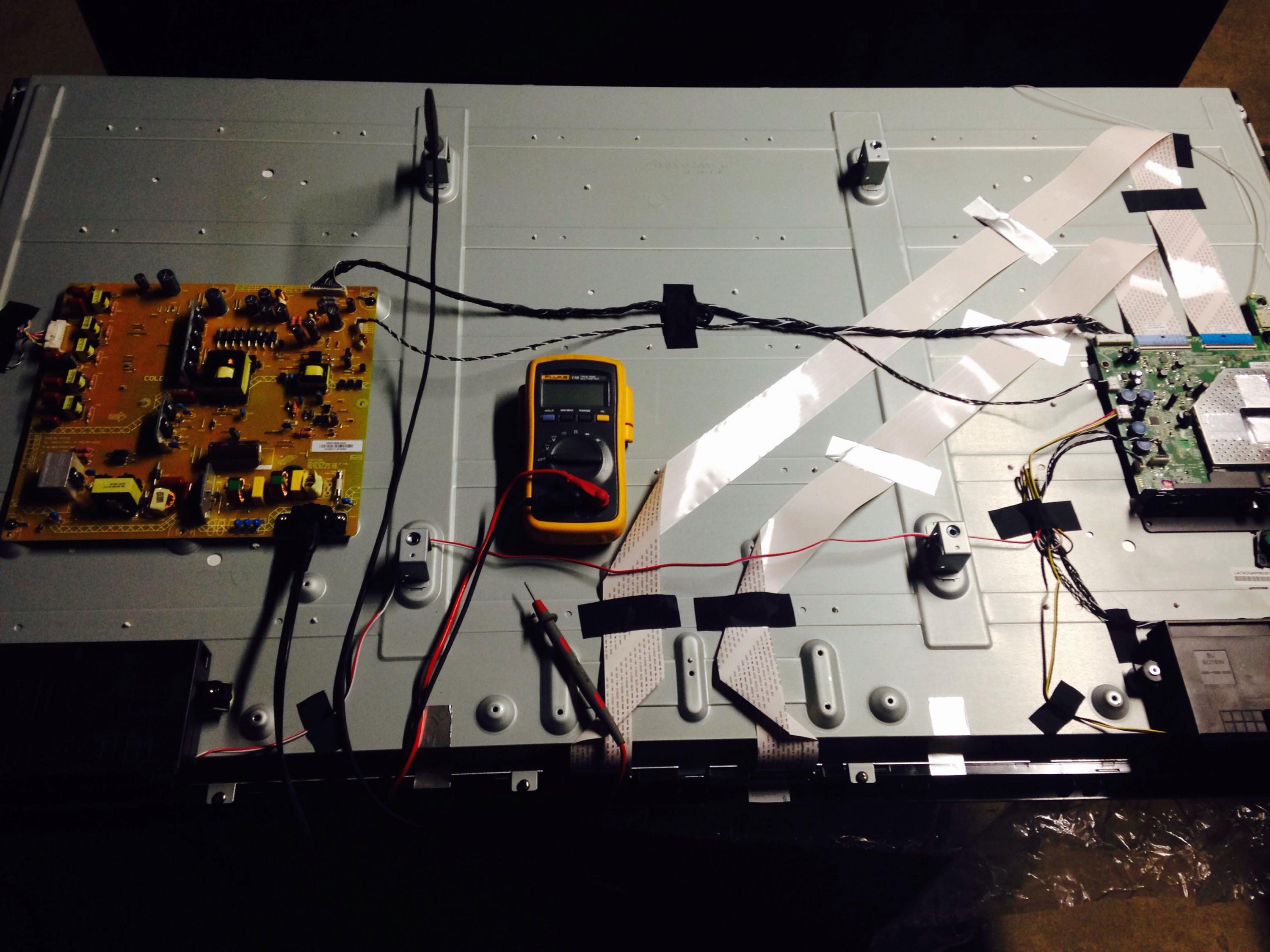

    Hello. I have a Vizio TV model E550i-A0 that went off and is not turning back on. White light at corner responds when pushing power button and stays on for 2 seconds then blinks once and stays for another 2 sec and goes off and basically it continues doing that.
    There is not backlight, no sound. Testing voltages on power supply I get:
    1-2 :5v
    3,4,5: gnd
    6-7: 0v. Board indicates 12v but there is none.
    8: 3.2v
    9:0v
    10:1.6v
    11,12,13,14: 0v
    Replaced the main board as they are well known for having eprom issues but I still have same exact problem.
    At this point I would like to get your input on if you guys think I have a bad power supply board or a bad screen.
    On the power supply/ led connector I get 0v on all pins
    Thank you.

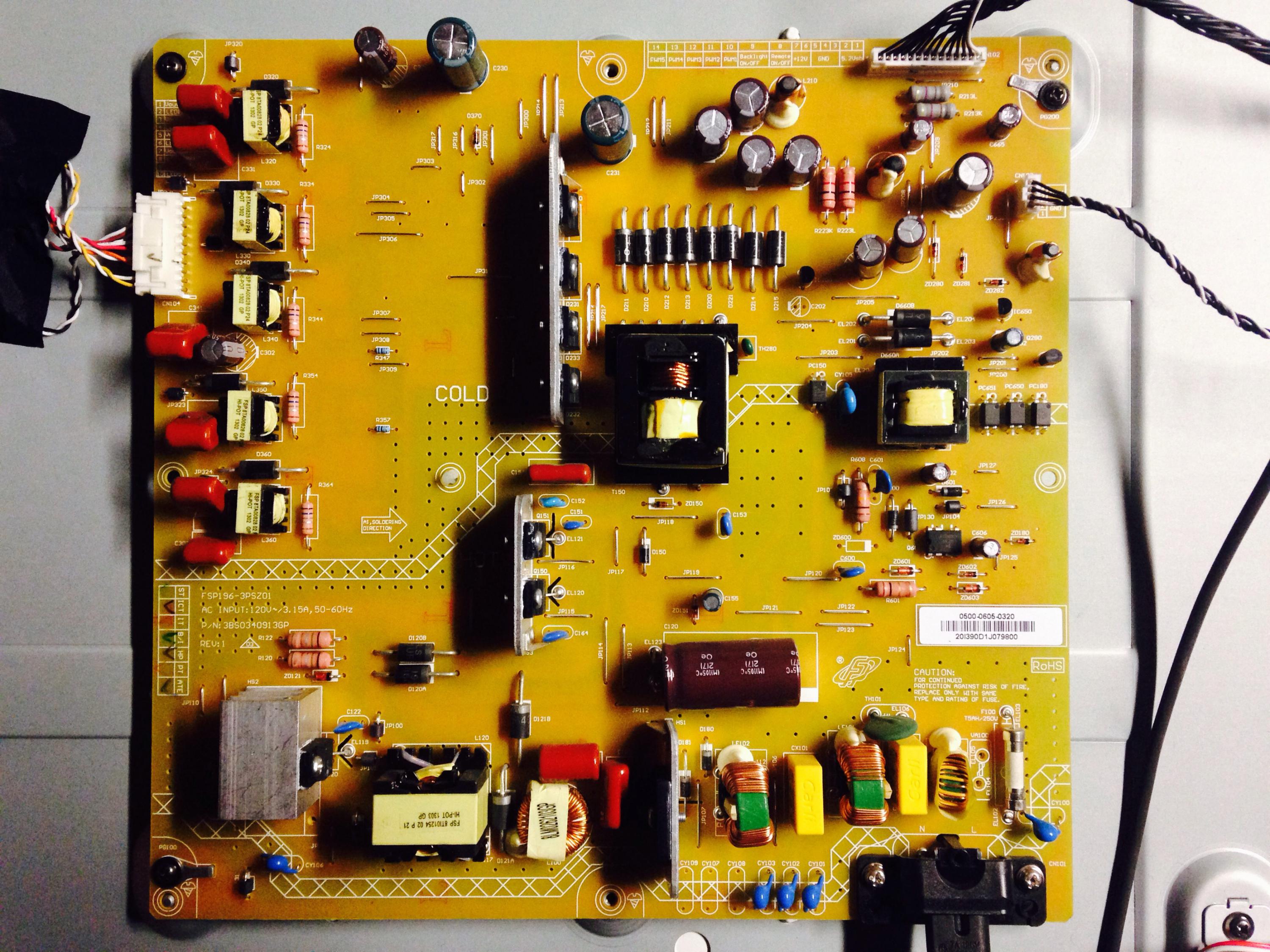

    Picture of power board

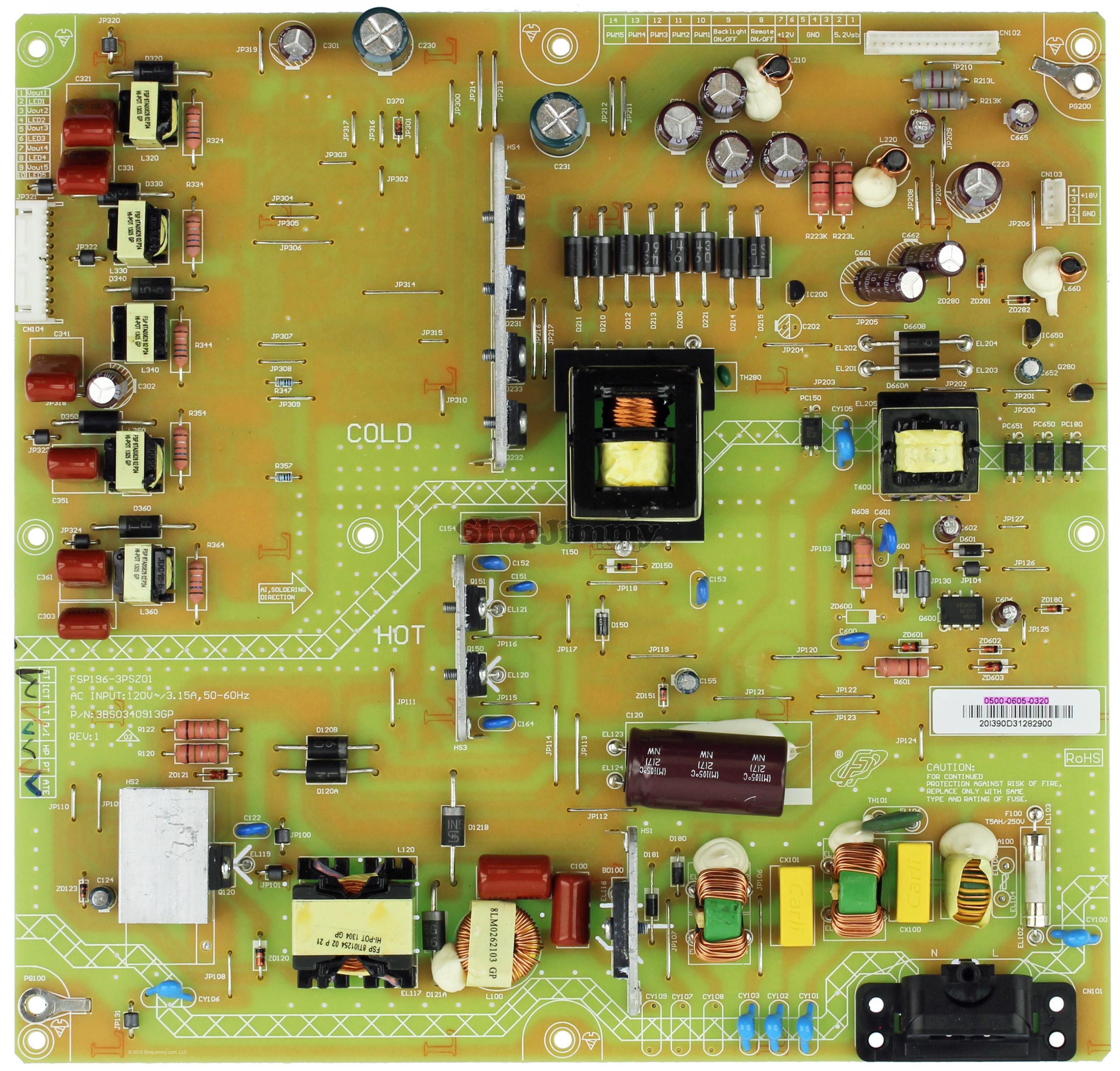

        Please put the pin names for each pin to make it easier to know what signals are missing.
        Right now there is no Backlights ON/OFF (BL-ON) pin 9 signal from the main board to turn on the backlights. PS-ON pin 8 is fine.
        The switched 12V is not working.

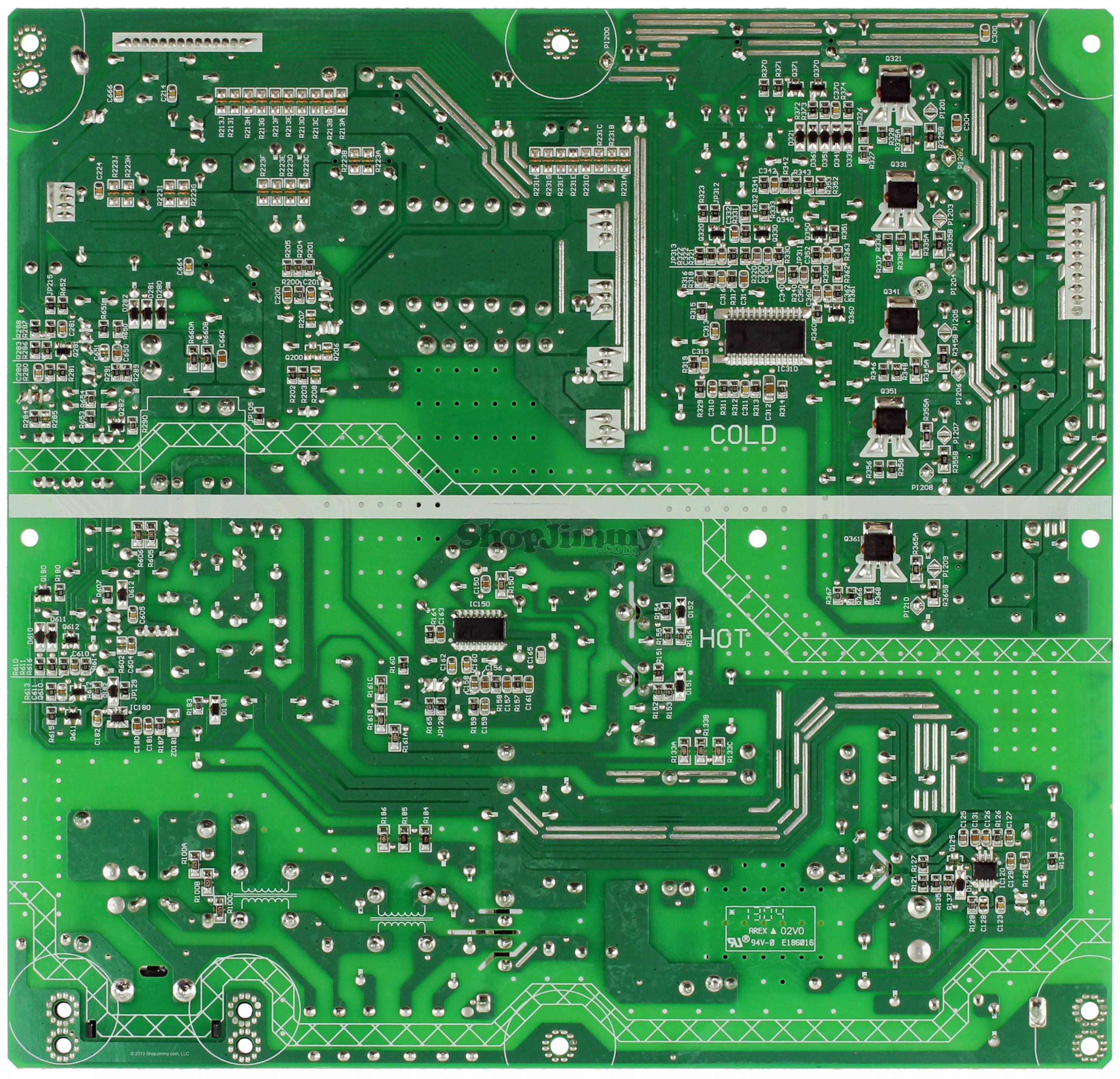

        Is this the same exact board as yours? I need to know for sure before I start tracing the bottom side of the board. FSP196-3PSZ01
        http://www.shopjimmy.com/vizio-0500-...pply-unit.htm#
        Pictures are provided by Shopjimmy.

            OK good, I will have to trace the board to see why the 12V is not present, other signals/Voltages are fine.
              Re: Vizio E550i-a0 no turning on
              Please measure the DCV between the two legs of the main filter cap (big 450VDC cap laying on its side) to make sure we do have >360VDC when TV is turned on, be careful not to touch anything with your hands since we are working in the Hot deadly side of the circuit.
              The boosted Voltage is generated by the PFC Voltage booster circuit, the LED backlights & switched 12V need the boosted Voltage to work.
              MOSFET Q150, 151 drive the power transformer T150, one of the winding is for generating the 12VDC using diodes D215, 215, the other transformer winding is used for the LED backlghts driver circuit.

                  It should jump up to >360VDC when the power switch is activated and the main board sends out the PS-ON to turn on the power supply. If you only see 170V when the TV is turned on, then we will need to find out why the PFC Voltage booster is not working next.

                      If your Voltage reporting is correct which indicating that you do have PS-on but no boosted Voltage, then we know you have bad power supply board. Main board I am not sure until you have good power supply board first.
                      You may have bad PFC diodes, you need to check D120A, D120B, D121A, and D121B. It can also be bad PFC Controller IC, bad cap the VCC for the PFC IC,etc.
