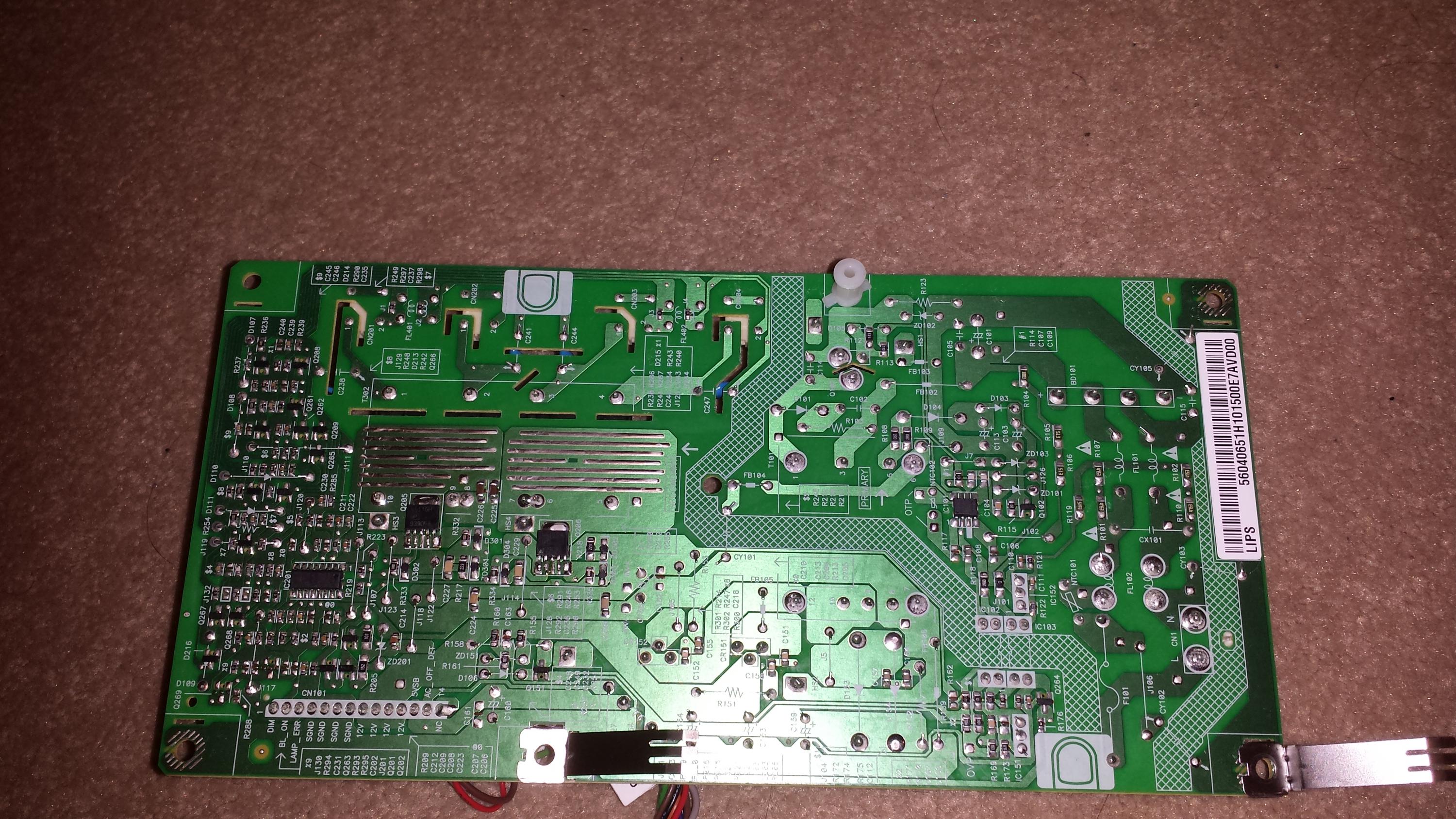

    I have taken a look over the power supply and main logic board, nothing stands out to my inexperienced eyes.
    I was hoping we could first rule out if it's the power board or not? here are my readings of the power:
    DIM -> 0.03v
    BL_ON -> 0
    Lamp_ERR -> 0
    SGND -> 0
    SGND -> 0
    SGND -> 0
    SGND -> 0
    12V -> 12.22v
    12V -> 12.22v
    12V -> 12.22v
    12V -> 12.22v
    5VSB -> 5.01v
    I don't know what's suppose to be the correct voltages, but I would imagine BL_ON should be higher than 0?
    Please help!

    Re: Dynex DX-22LD150A11 please wait, then black screen
    So backlights initially come on then go off, correct?
    Can you still see an image using a flashlight on the screen?
      Pin 1: DIM -> 0.03v
      Pin 2: BL_ON -> 0
      Pin 3: Lamp_Err, Not used, empty pin.
      So the BL-ON and the DIM are basically not there from the main board.

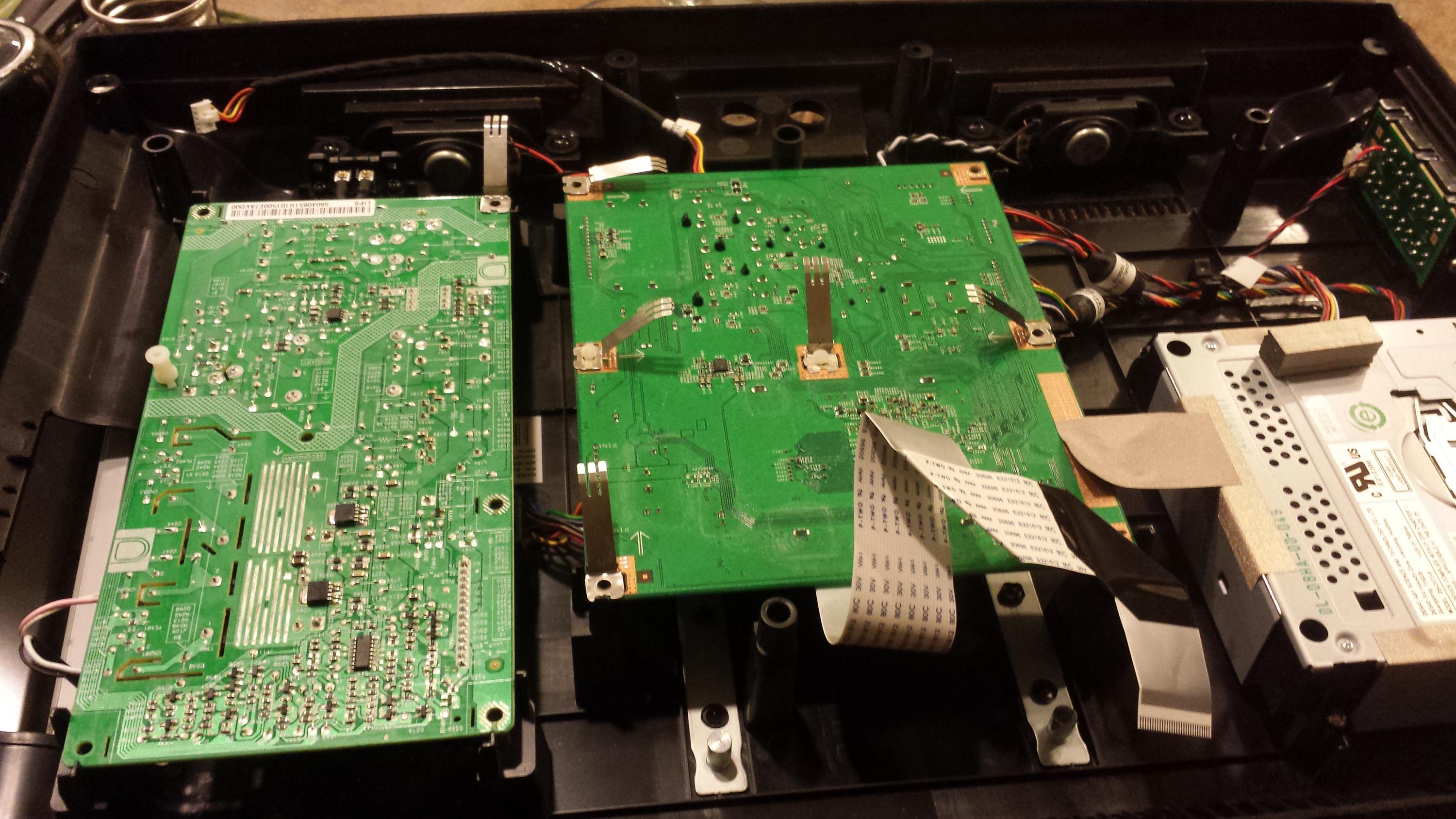

                Originally posted by RogueCapacitor
                Also, I'd like to add that when I took those voltage readings all other boards were disconnected from the power board.
                Oh, That makes a difference.
                Connect all board and recheck pins
                  That is very IMPORTANT info.
                  Hook everything back together, have meter connected to BL-ON pin then plug the TV into the outlet and turn on the TV to see if the DCV is present and then goes away or it stays at >2.5VDC.
                    So I have hooked up my the main board to the power board, and the panel to the transformers? (I'm not sure what they're called, but they're the 4 white little nobs that power the backlight on the LCD.
                    The voltage of the BL_ON is 3.25 when I hit the power button to turn it on.
                    The back light will flicker on for a second, then turn off, then flicker on again and turn off again right away. The power stays constant at 3.25v.
                    The voltage for DIM is also 3.25.
                    As you can see, I did not connect my ribbon to the panel, I hope that doesn't make a difference?
                    Is it possible that whatever is trying to power my backlight isn't getting enough power and hence it goes off and on?

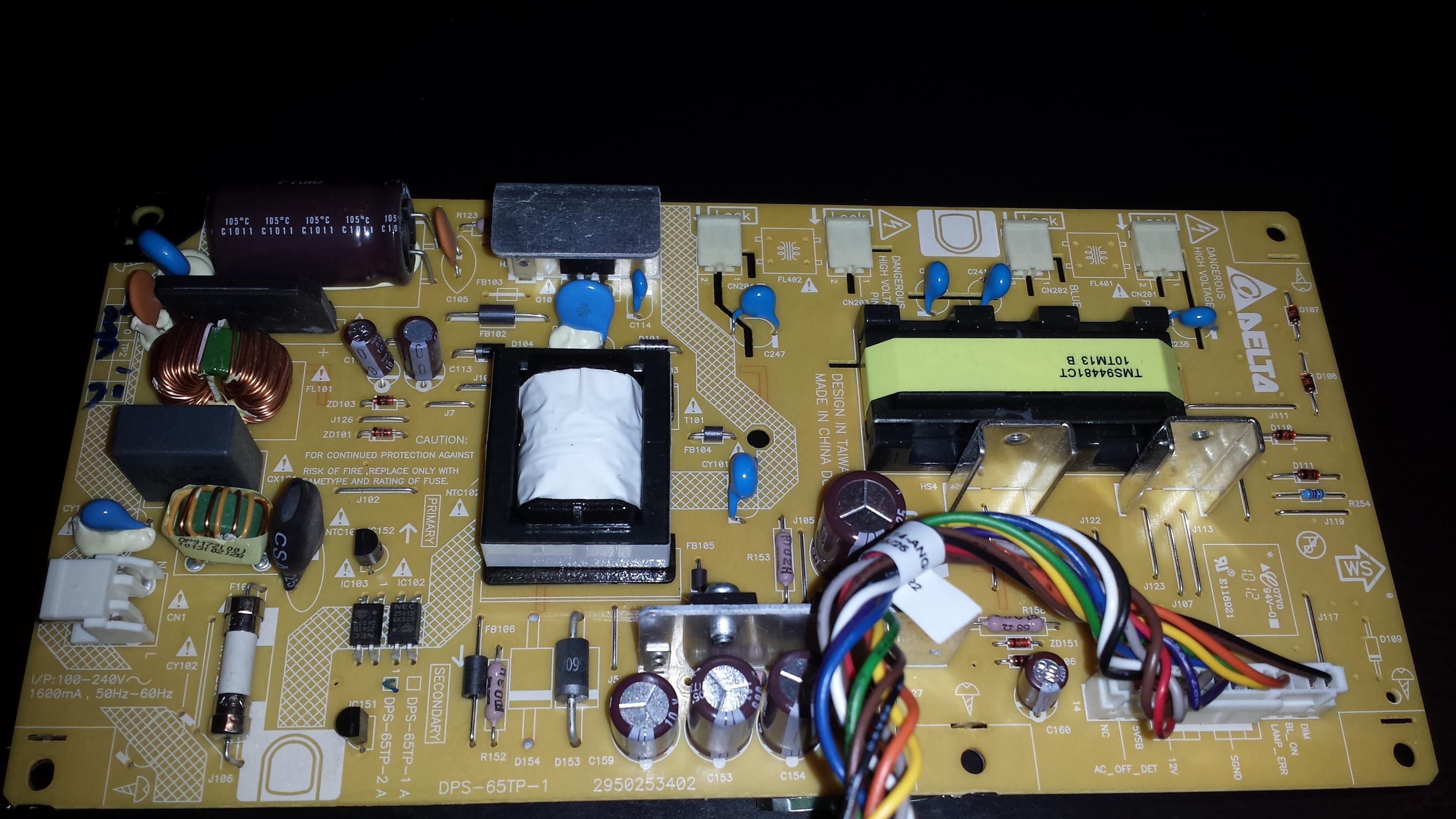

                      opps, sorry, I forgot to upload the photos.
                      As you can see, I did not hook up my ribbon, does that make a difference?
                      I'm wondering if it's my transformer on the power board that's bad?
                      Is the transformer the one with the yellow tape around it?
                      Last edited by RogueCapacitor; 04-25-2015, 02:38 AM. Reason: adding photo of transformer
                        Hi can you check the resistance on the inverter transformer using this link to show you the pins to check
                        http://www.lcdparts.net/TransformerD...ProductID=4010

                            • RogueCapacitor
                              • Apr 2015
                              • 24
                              Hi there,
                              In the picture I highlighted where I think the transformer is?
                              I'm not sure which is P1 vs S1, but looking at the spacing of the pins, I think 1,2,3,4 are S1, S2,S3,S4
                              and 9,8, and 7,6 are P1, P2?
                              Here are my measurements:
                              1-2: infinite resistant (show's up at 1 on my meter)
                              3-4: 960ohms
                              7-8: 0.2ohms
                              On a side note: If you zoom into the picture, you'll see that 7 and 6 are soldered together, but in 9 and 8, there's a small gap between them? Does this matter?
                              So I'm guessing that since 1-2 does not have continuity, that means there's a break in the transformer? and by replacing it, in theory it should fix my issue?
                              Thanks for your help!

                                can you unsolder the transformer and retest does look like pins 1@2 maybe at fault.
                                • selldoor
                                  Slow Learner
                                  • Dec 2010
                                  • 7870
                                  yes you are both correct you should be testing pin1 to pin2 and pin 3 to pin4 with no power to the board and meter on ohms 2000.
                                  Looking at your picture the soldering doesnt look great on the transformer so it will need reflowed.
                                  Also the pins are sometimes lacquered so if you have not yet taken it off try again but
                                  dig into the solder with the point of the probe.
                                    Hey all,
                                    I have finally been able to unsolder the transformer, and pins 1 to pins 2 still read infinity, so most likely this is a faulty unit?
                                    I was wondering, how did everyone know that the issue could be with the transformer by me saying my backlight was blinking off and on?
                                    Also, my transformer says:
                                    TMS94481CT
                                    10TM13 B
                                    What is the 10TM13B? The first line of my transformer is the same as in this picture: http://www.lcdparts.net/TransformerD...ProductID=4010
                                    however the second line is different, what part number do I go off when I order a new transformer? is it possible to repair this transformer?
                                    Thanks,
                                    • selldoor
                                      Slow Learner
                                      • Dec 2010
                                      • 7870
                                      Yes - most likely faulty if you have tried again off board.
                                      One thing - get a magnifying glass and just check the very thin wire has not just broken off where it is attached to the pin. Unlikely but one membre did once find this and was able to repair. otherwise it is not really repairable.
                                      We have seen this problem many times before.
                                      The second part of the number is just maunfacturers info batch number
                                      production date and so on.
                                      If you can wait they are available on ebay here is one - think I have used him before.http://www.ebay.co.uk/itm/1PCS-Trans...#ht_3767wt_838
                                      You may be able to find others in US
