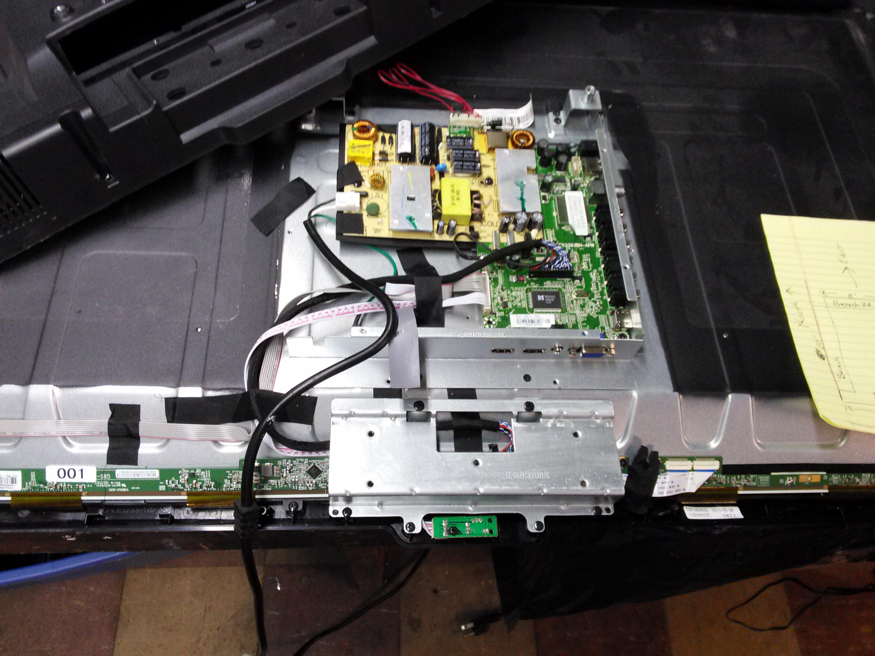

    Re: proscan PLDED3996A-C2 NO PICTURE POWERS ON
    Can you completely remove the back of the TV and take straight shot pictures of the whole back side of the TV, the power supply/LED driver board (both sides of the board).
    That power supply/LED driver board looks familiar.
    I would say bad LEDs like this one:

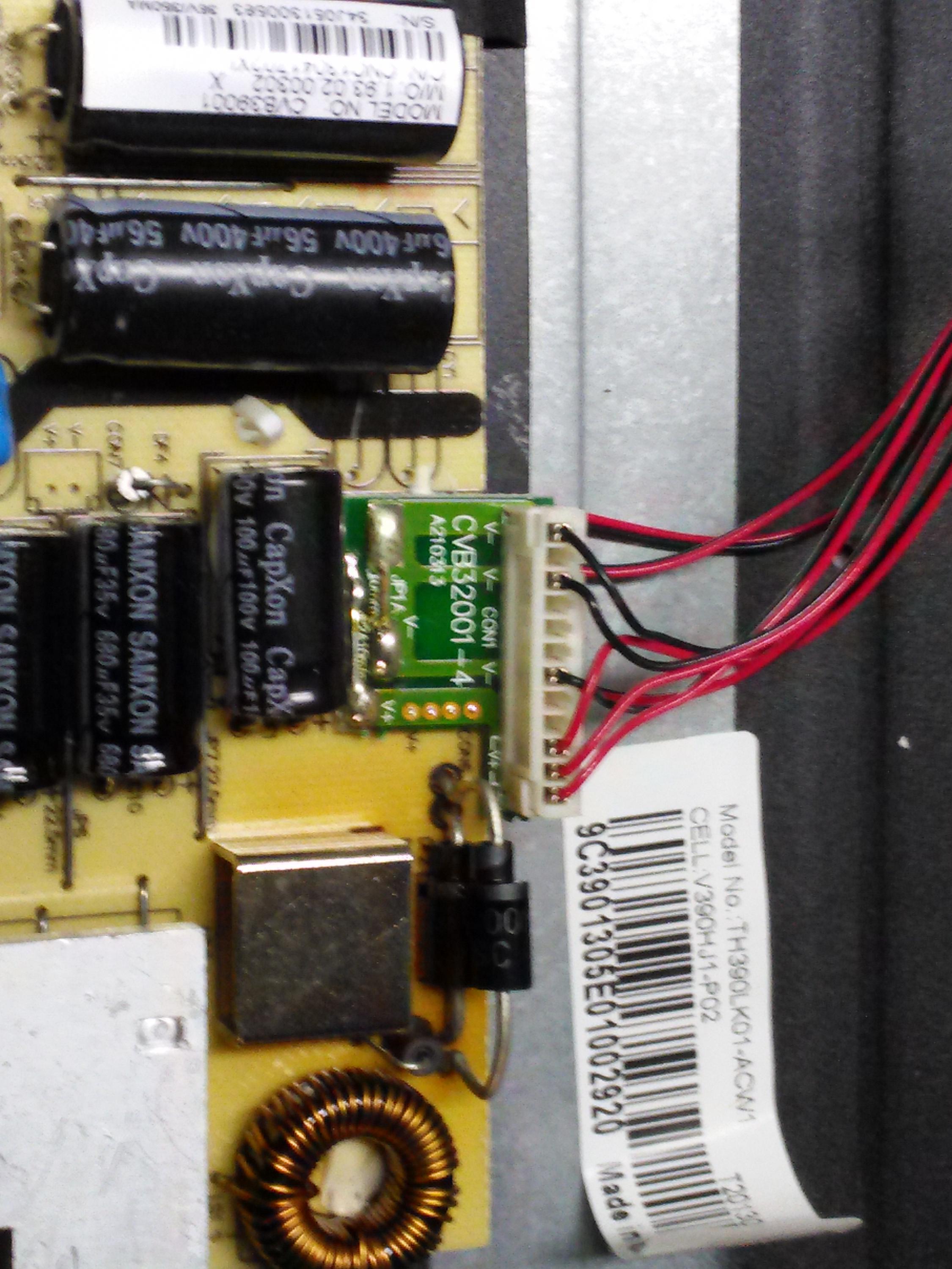

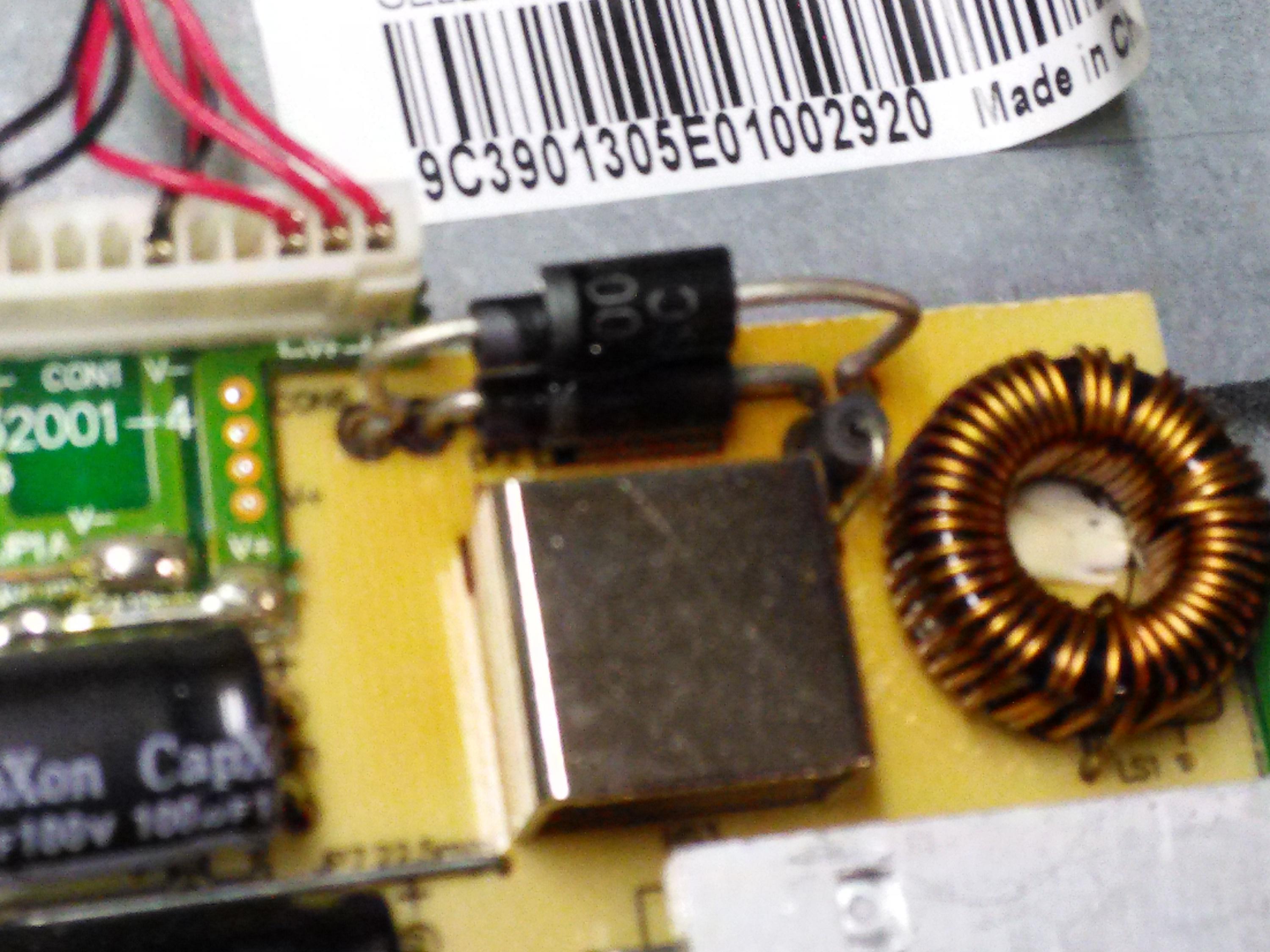

      I tested them red wires on the connector. They all read 20.7 volts. I think them wires are going to the leds? And shouldnt they read 24volts? Also i took picture of this diode. The board looks really brown burned up right under them 2 big diodes, the picture doesnt show it so good but it looks more burnt then shown in picture. But im thinking if them 20 volts is correct then i proly has bad led lights
        Did you check both diodes yet? They are connected in parallel.
        The 20.7VDC readings on the red wires are ref to the chassis GND, right?
          Yes bud the readings are done as you said, and also not sure what diodes connected in parallel mean but they both read 252 and checked them other way they say 1
            If they are in parallel they are supposed to share current equally between them. At least they don't look shorted . If you want to be absolutely sure, lift one terminal and measure again.
              I just repaired a proscan PLDED3273A-E, that has a different power board but the circuit may be similar. The voltage from the power supply for the led circuit was around 25-30 volts off the diodes, it then goes through the coil and is boosted to around 70 volts, I suspect that boost circuit is not working, if it is the coil should be getting quite warm. if its not getting warm check the boost circuit.

                                    What Voltages did you check out so far?
                                    We also need you to upload good clear pictures of the whole back side of the TV showing ALL the boards and then the pictures of the power supply board top and bottom side.
                                      It's been about 20 years i graduated from electronics school but unfortunately i never worked in the field, went straight to I.T.
                                      I tested the 2 diodes which are in parallel and the 110v input from the connectors on the PCB..I wiggle the PCB back and forth while off and the tv works, i wiggle it back some more and it stops..would be indicator of bad solder, but i redid most of them..
                                      I can post pictures of the power supply back and front but nothing seems darkened or unusual
                                        Attached are the pictures you requested
